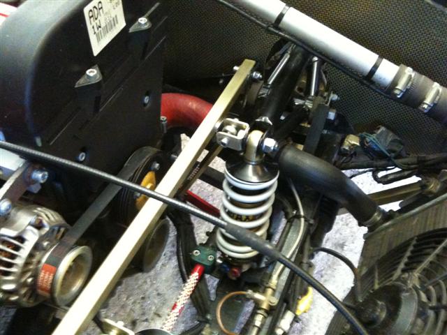

                Decided to strengthen the front suspension towers that hold the inboard rockers so have put a 20mm square tube (it was already in my shed) between the top rear of both towers , bolted , not welded. I'd have trouble removing the engine if welded and I couldn't use the rocker pivot bolts for the brace because my ARB is in the way. I could have moved the ARB to the 25 x 50 mm's tube behind the shocks to pull the links back out the way but now the engine's back in it's bloody awkward --- hence the compromise.
                Whether I'll actually feel the difference in the front end depends on whether it '' WAS '' flexing --- we'll see .
                Also fancied another tube from the bulkhead to the bottom of the rocker tower --- there's one on the driver's side but not the passenger side , mainly for easy exhaust manifold pipe fitting . I might attempt a bolted in type if I can get at it . Should have thought about these two mod's while the engine and box was outClick image for larger version

                          The front suspension tower strengthener tube certainly changed the car's behavier on turn in , very twitchy and required careful steering input , so now there's an opportunity to lower the rear a touch/lessen the rake , for better rear grip without inducing understeer.
                          This made me 10th fastest overall with Simon at 8th then Nigel 18th ----- a good day and am really amazed at my huge jump in lap time --- just not absolutely certain where it came from.
