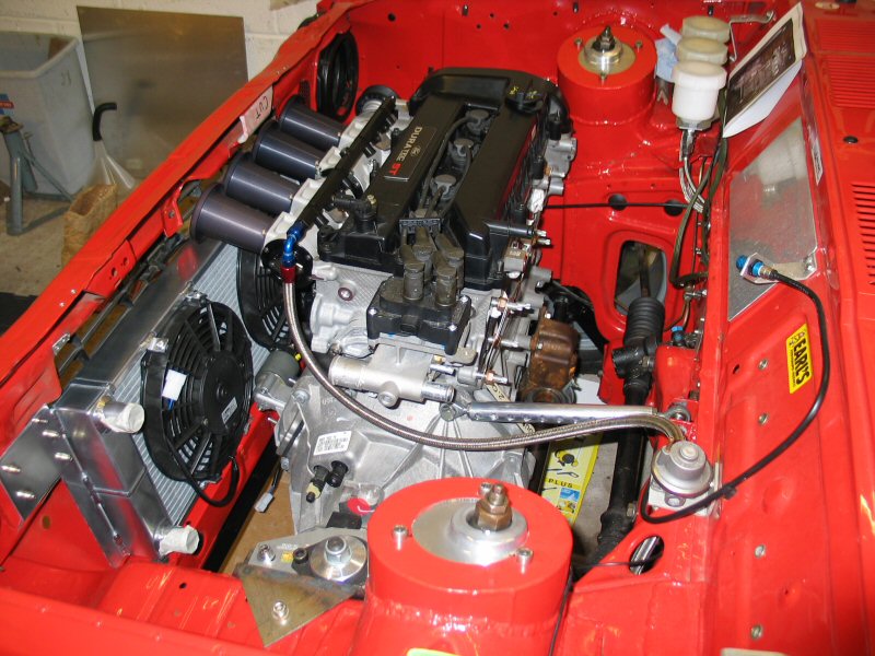

                  She's back on her wheels again, having sat on axle stands since last August. I forget how damn low she sits.
                  See the Web Cam picture here
                  I've fitted the 275lb springs at the front (were 300lb), and the brakes, and driveshafts are all on too. Now I can measure the length of the driveshaft I'll need for the drivers side. Recoprop said that they dont shorten driveshafts, because of the heat treatment applied makes then difficult to modify and harden. So I'll get a short shaft made up with IB5+ trilobe joints on both shafts.
                  The D-Tec looks very 'at home' in the engine bay. And I've more ground clearance than ever, so I can lower her a little more than before.

                      Had 2nd thoughts about the 2mm steel, seems way too flexible, so I'll prototype the engine steady bar bracket in 2mm, and then make one from 3mm when happy.

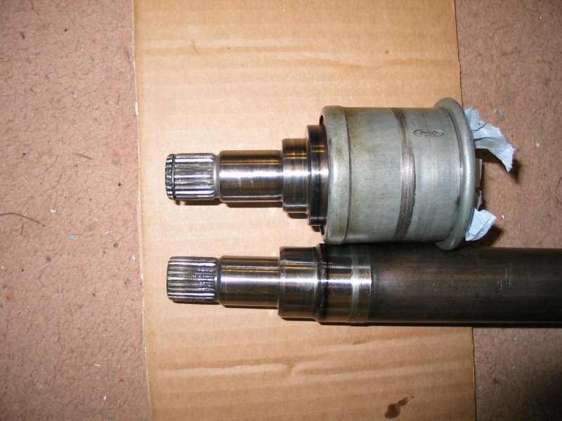

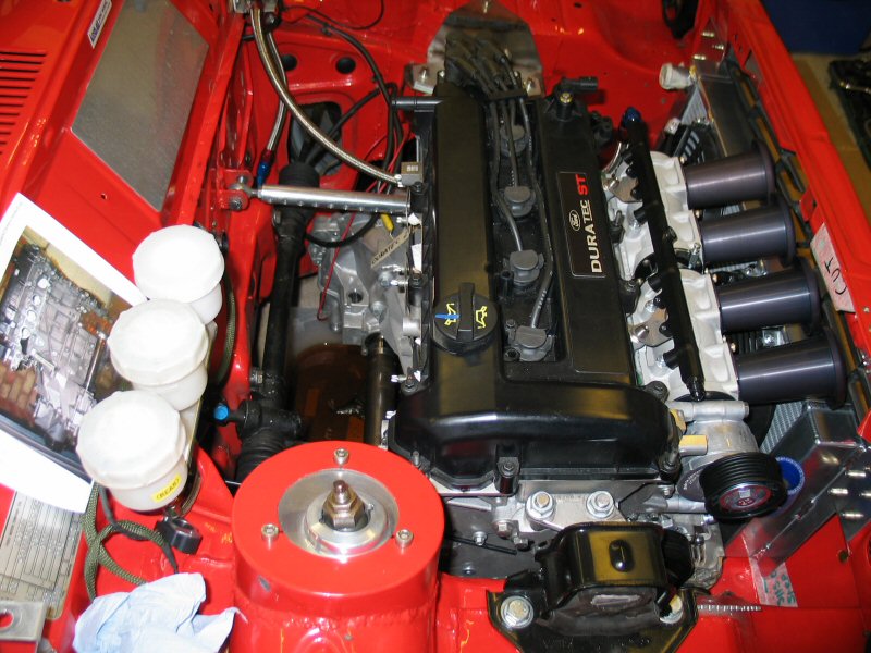

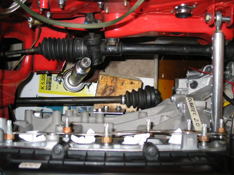

                      The following two pics show the output flange (gray) from the BC gearbox, alongside the intermediate driveshaft from the Duratec, which allows you to see the difference in the cup size, and therefore the fact that the IB5+ flange requires larger tri-lobe bearings, which is why I'm going to use the IB5+ parts. Biggger must mean stronger.
                      And here are some shots of the engine / box in the bay.
                      The final picture shows the long zetec shaft, in situ, which I cant use because I cant get the BC flange (top picture) in the box, because it hits the duratec block.

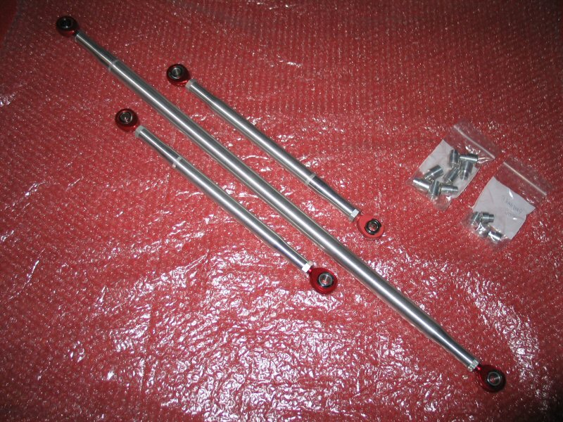

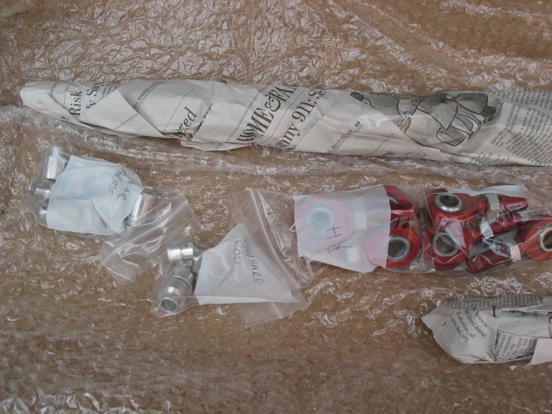

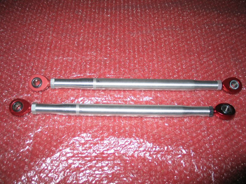

                        No progress this week due to the throat infection, but some new shiny parts have arrived from America. Typical, I had a week off between contracts, tonnes of stuff to do, and I'm too poorly to do anything. Now wifeys caught the bug, so even though I'm better, I'm looking after the kids. D'oh!

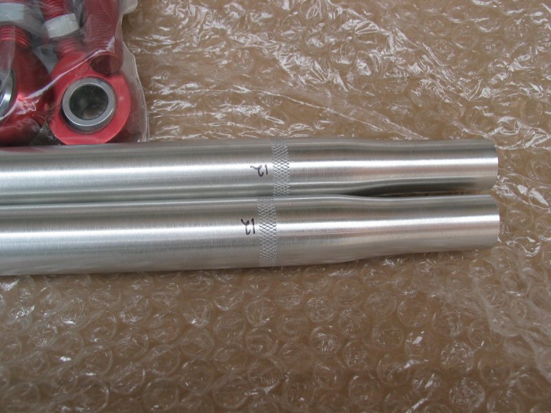

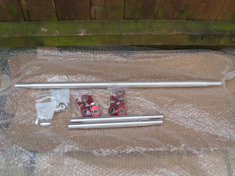

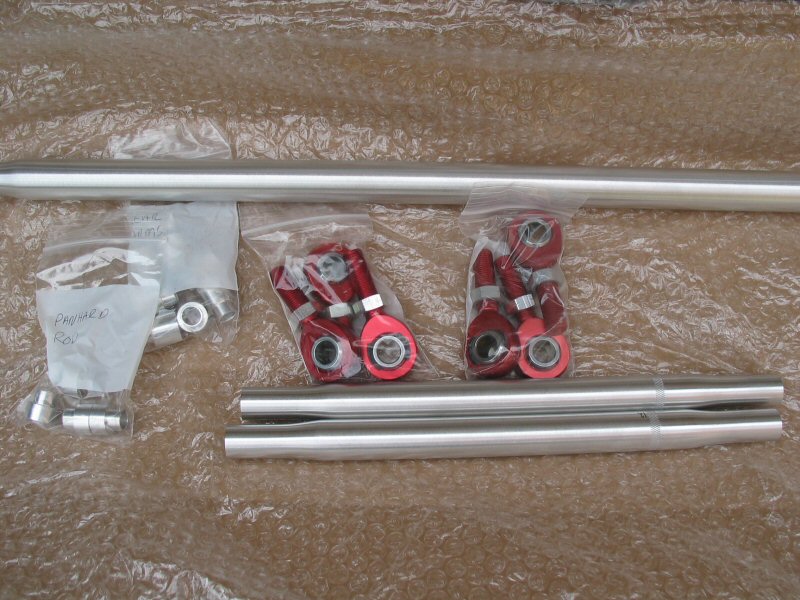

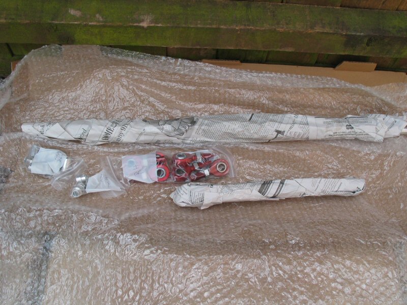

                        This is the rear trailing arms and panhard rod kit that www.KustomEngineering.com are marketing for the Mk1 and Mk2 Fiesta's, and the total kit weighs in at just 1135grammes.
                        That is, all the tubes are just that, tubular, and the rod ends (or heims) are alloy too, so the combined weight is a huge reduction over standard or even uprated aftermarket equivalents.
                        Go to http://www.kustomengineering.com/eShop.htm for pricing

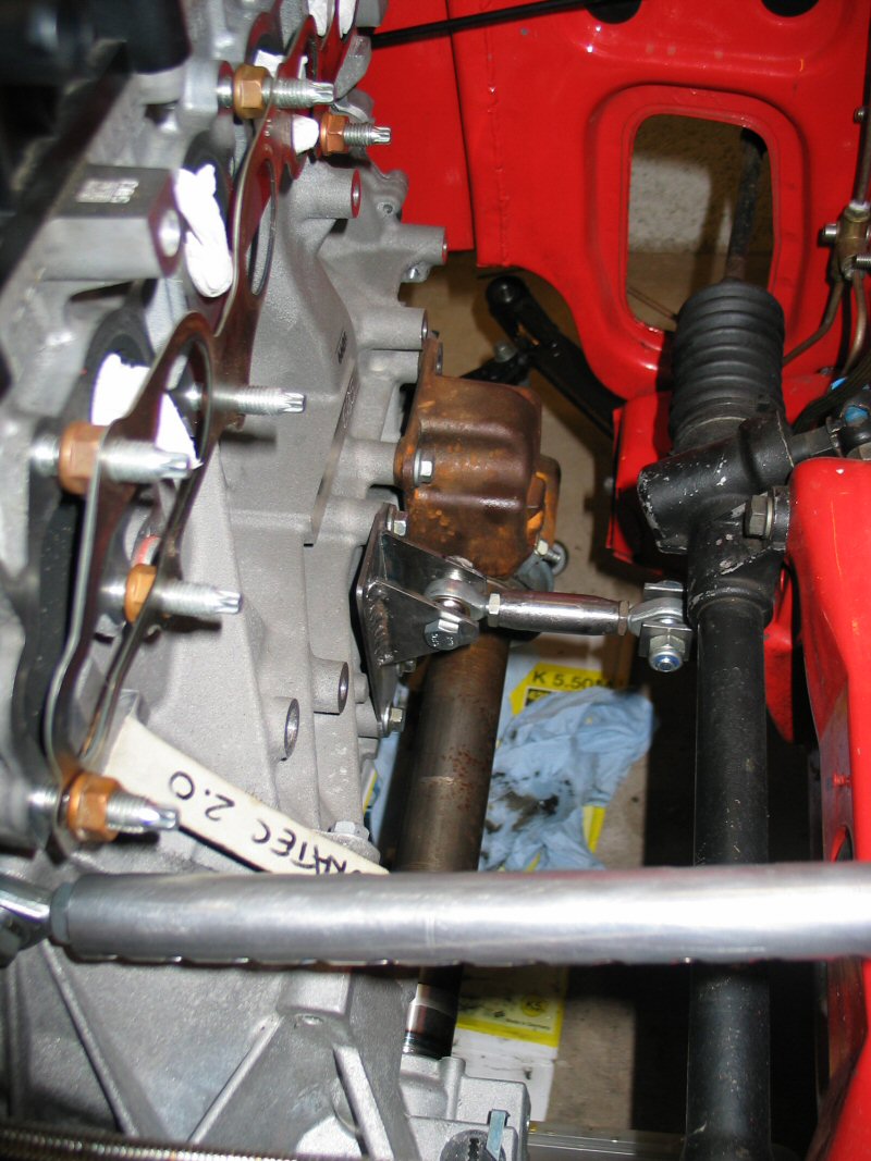

                            Finished the tie bar bracket and the tie bar last night, and its now fitted to the car. The engine is now rock solid.

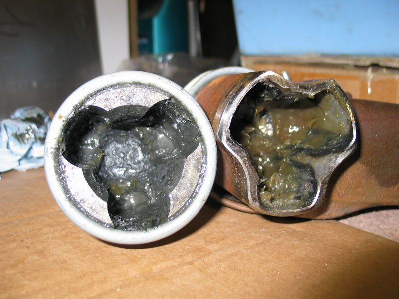

                            Removed the drivers side driveshaft and spent 20 mins trying to remove the driveshaft from the outer CV joint. Will try again tonight. I cant keep the circlip apart and pull on the driveshaft at the same time.

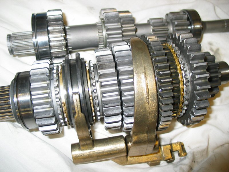

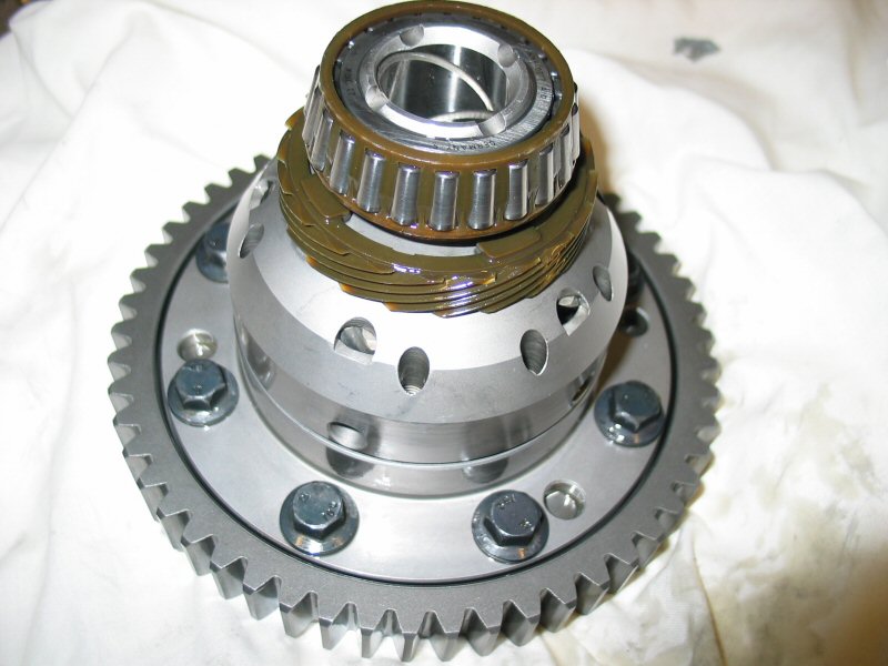

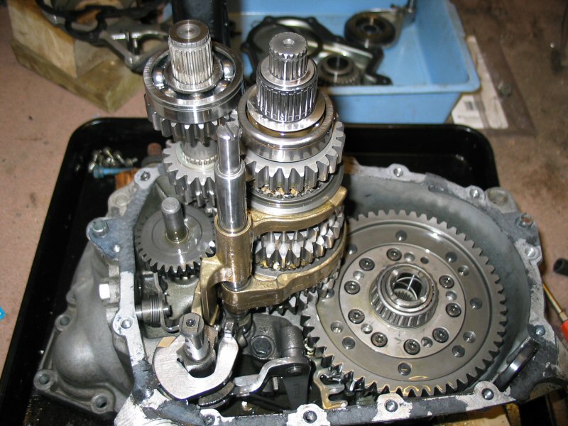

                              Stripped my 1st Fiesta box tonight. Was quite interesting, and didn't have any bits left over when I reassembled it, apart from the LSD of course, but that was the point of taking it all apart in the 1st place. Nice shiny Quaife internals. Yummy. Box is sold, minus the LSD, and the LSD will be installed in the sequential box when thats built in next couple of months.
                              And this is the 2nd tie bar and bracket, that now prevent the engine from rocking. Needs paint, but you get the picture. The first tie bar I made from ally bar (bottom of the picture), I'll remake this in steel so its the same as the newer one. I decided I dont like the ally version. Looks naff.

                                Updated my gearbox page on the dot com site to show the steps involved in taking the BC box apart
                                Tonight the driveshaft is parting company from the outer CV joint (by hook or by crook) and the car is then going back on its wheels so i can measure the required driveshaft length for the new short shaft.
