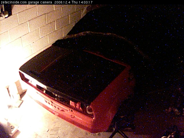

                                The web camera is back on-line now. Still flashes all the time, because of all the bot attacks, but its working.
