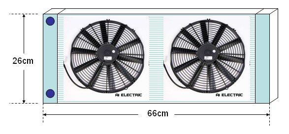

      Measured up the radiator tonight. I'm going to squeeze it in below the throttle bodies, but this means I have only 26cm height to play with. I'm going to go for 66cm wide, but to leave room for the alternator, I'll have to offset the radiator to the nearside, and maybe cut some more holes in the front to let enough air through. Should look ok.

          PPT drawing of the radiator.
          Does anyone know where I can get the shorter black plastic thermostat outlet pipe from? The one on my engine seems rather long. Or are there other alternatives... Like a right angled outlet?
          I'm going to feed the water from the outlet at right angles to the block, across the front of the block to the gearbox end of the rad. So both inlet and outlet are on the same end.

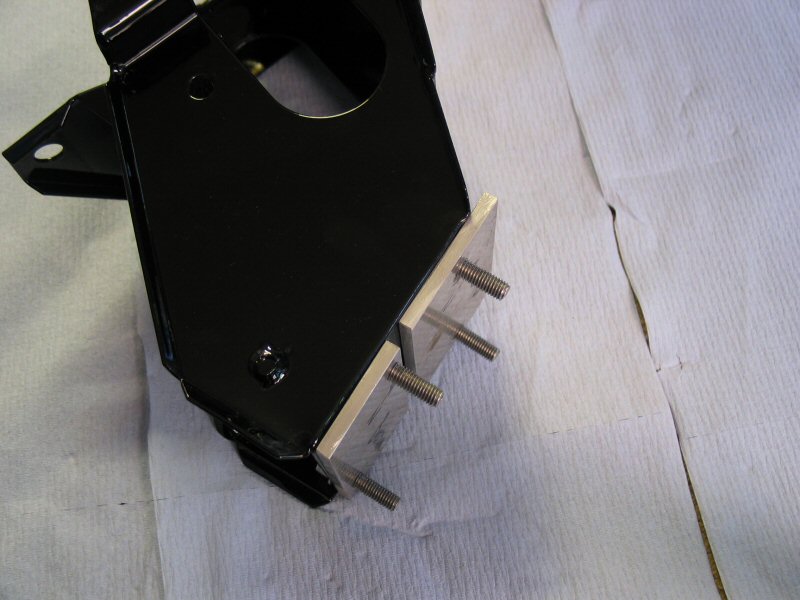

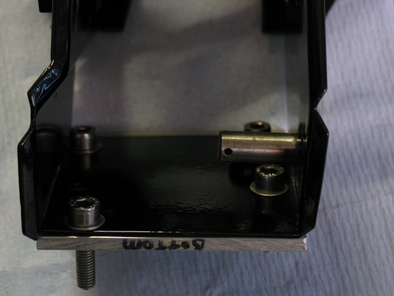

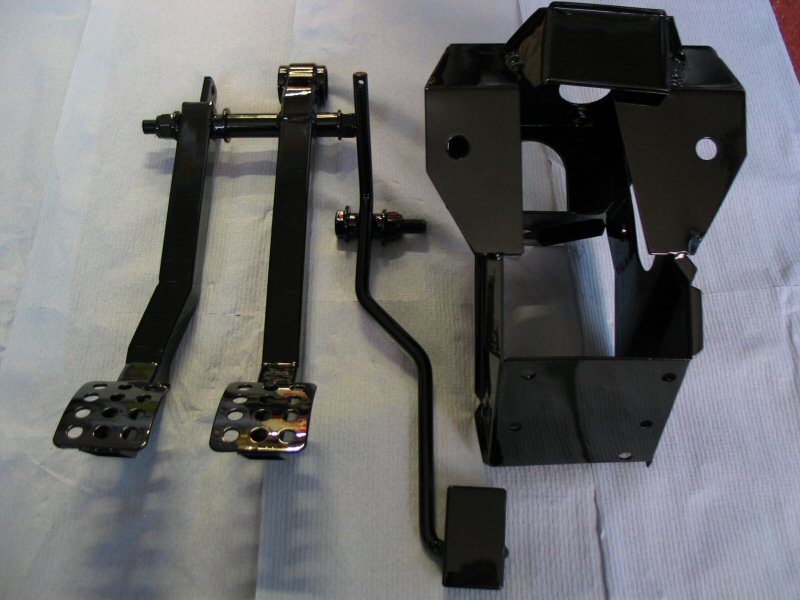

            Pedal box is re-assembled, and looks very bling with the two pack black paint applied. Throttle pedal and return spring still need to be fitted.
            So how do I now supply the hydraulic slave on the gearbox, given that the master cylinder requires a threaded pipe, and it looks like the gearbox accepts a push in plastic pipe.
            Off to Sunny Glasgow in the morning for a few days, so plenty of time to research a solution.

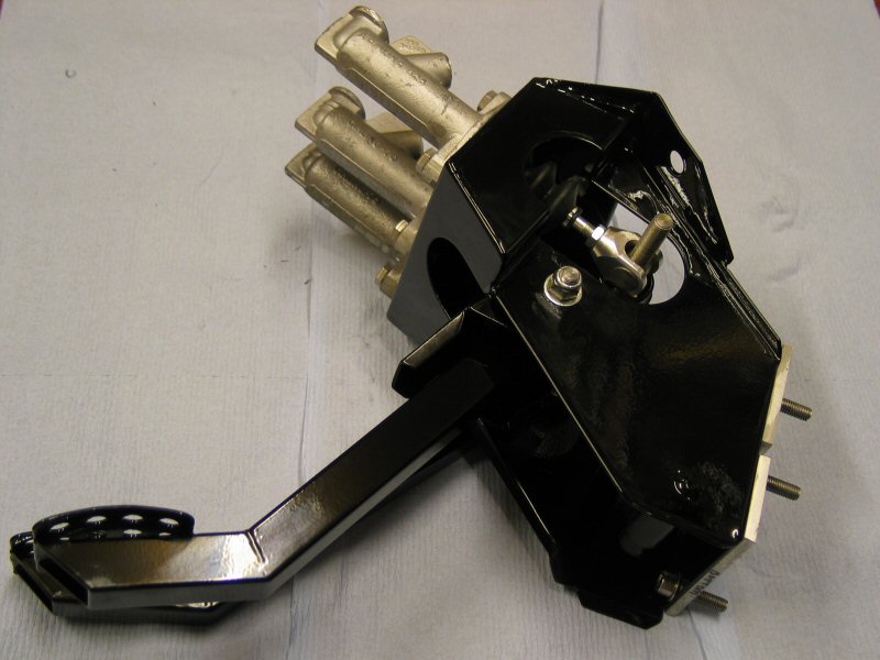

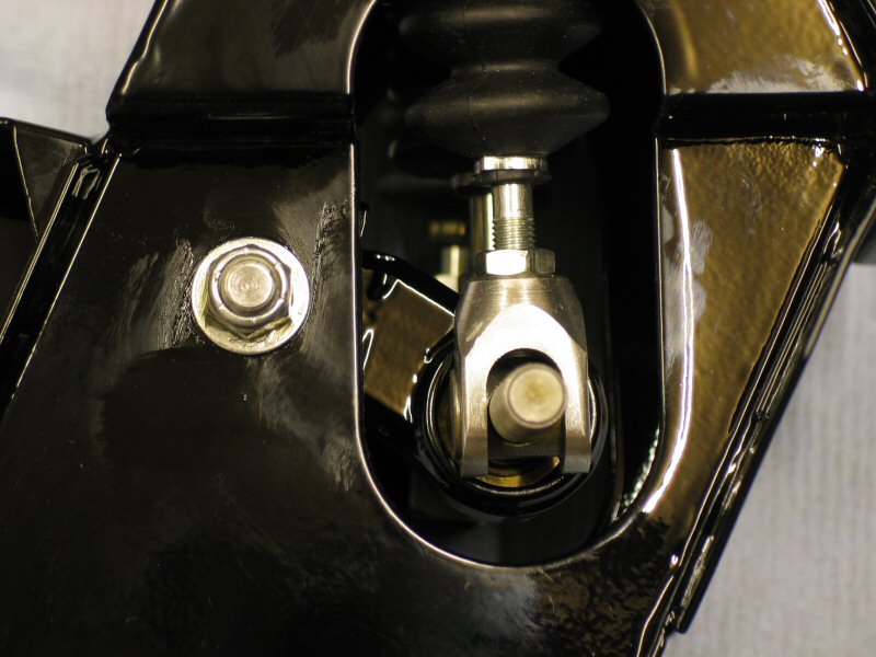

                  Pedal box fitted. I need to get the flaring tool out as I have to run a new pipe from the clutch master cylinder to the slave in the gearbox. M-Sport confirm that they just use standard plastic pipe from Ford for the clutch slave supply on the GpN ST150's.
                  Raldes supplied an extra fluid reservoir and drop pipe, so I need to fabricate a new reservoir mounting bracket to take the 3rd reservoir. Shame they cant be mounted inside the car. That'd make the process far simpler.

                            Radiator ordered.
                            260mm (h) x 660mm (w)
                            40mm core, 50mm headers
                            32mm inlet and outlet
                            Twin 9" fans (pull) with welded on mounting bosses.
                            Polished aluminimum.
                            Just need to find a decent looking alloy header tank.
