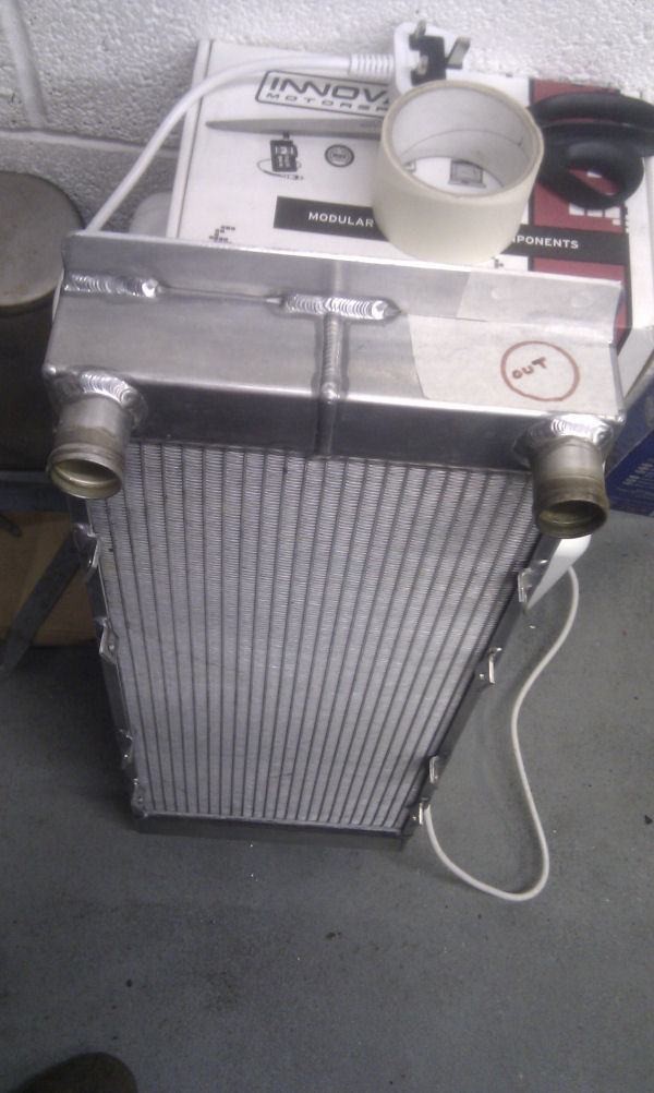

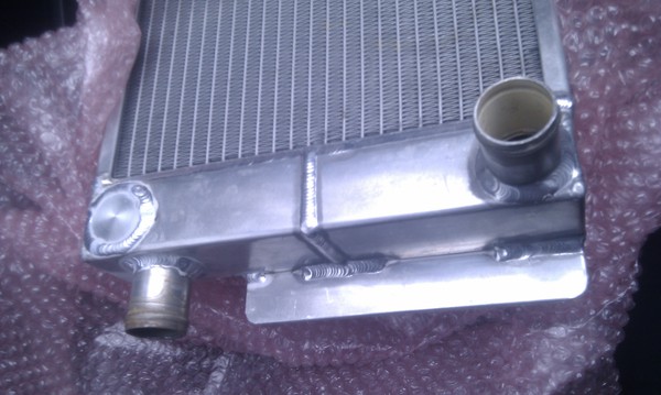

              Dropped the rad off at Altiss.com for the modification.
              • team_zi
                • 1637
                #937
                Radiator is done. I'll collect it today. Pics to follow.
                • team_zi
                  • 1637
                  #938
                  Done

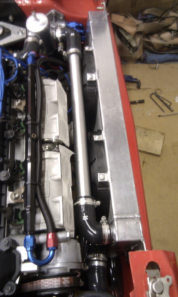

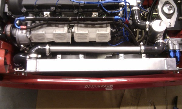

                      Radiator is in, and almost ready for testing. Just a couple of jubilee clips to do and I can fill it with water.
                      Fits ok, no issues with clearance, lots of room around the alternator for the new bottom hoses to run.
                      In an ideal world, I'd go back to square one, and design the rad without the horizontal split, and then I could run the hot water from the top of the block straight in to the top of the rad, and do away with the ally pipe that runs across the length of the top of the radiator.
                      I'll test it at the weekend.
