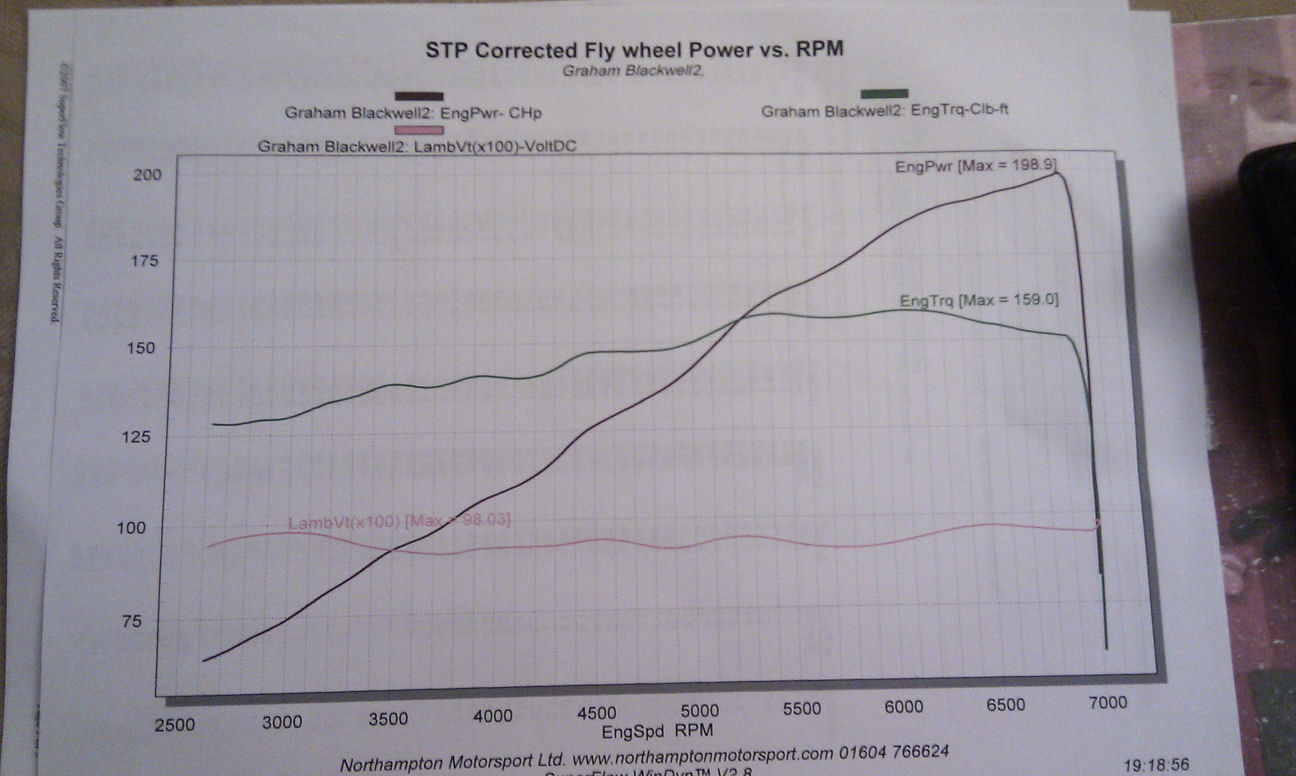

                        This was a 183bhp run, and Troy continued mapping for another 15 mins which finally realised 198.9bhp

                          #852
                          Yep, that power curve confirms it wants more revs alright! Steve Broughton managed 205bhp on standard internals at 7,250rpm, the standard cams aren't up to much more than that. A pair of cams should see you up to about 215bhp.

                              That's going to be a wicked motor in such a light shell
                              Got any dyno graphs at all?
                              • mervhill
                                • 1268
                                #855
                                Like this one?
