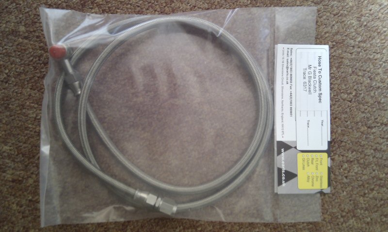

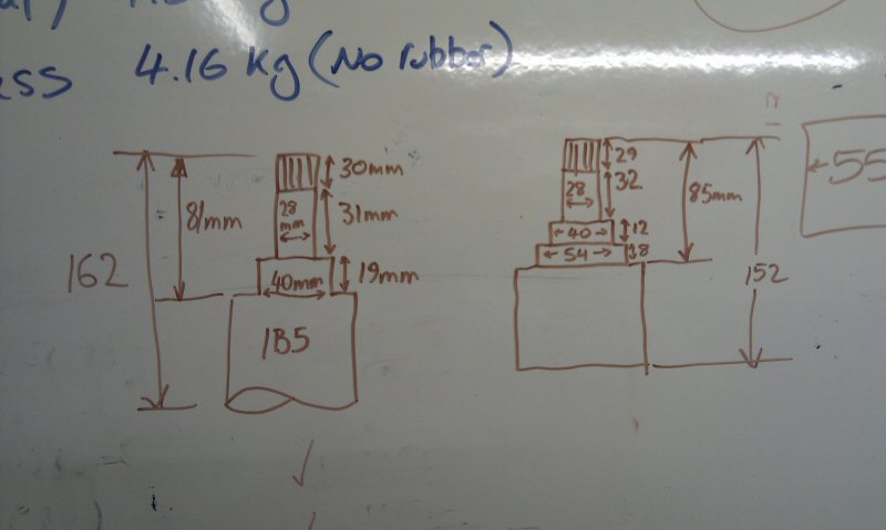

    Custom made Clutch hose from Earls. 3/8 banjo and 7/16 female to fit on the M-Sport adaptor on the slave.

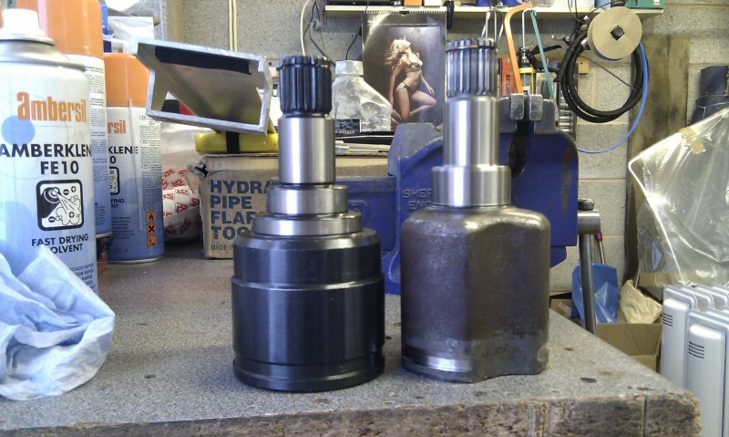

    The Mk6 Fiesta ST IB5+ output cup from the ST and the BC output cup from the RS1800i Fiesta gearbox, side by side. I tried fitting the BC cup in the box, but the shoulder is totally different, and it would result in reliability issues, oil loss etc. And the ST cup is lighter anyway 8-)

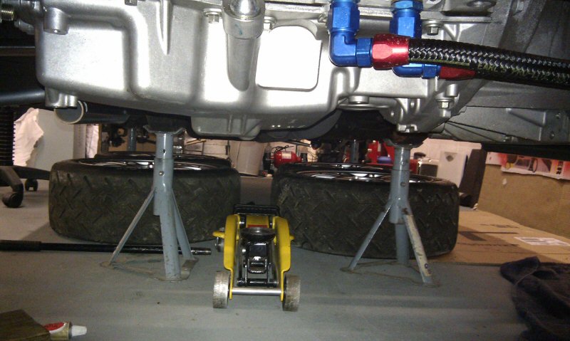

    The car off the ground.

      I've fitted the 2nd new axle-bar, on the passenger side, and its a little bit tight. I've around 5mm space between the end of the shaft and the inside of the output cup on the gearbox. So I'll try lengthening the track control arm a little bit more, to push the wheel out further, to pull the driveshaft out a bit more to increase the gap, and then rotate the adjustable strut top to push the top of the strut outwards to keep the front wheel from running too much camber (which also increases the gap between the axle bar and the output cup). I can pull the wheel forwards using the adjustable tie bar, to give me back any castor I loose from rotating the strut top.
      Its so nice working with this suspension from Karl Hacken. So easy to make adjustments.
      And the Fiesta wont suffer if I widen the track at the front. At least it'll fill the wheel arches better than before. And I can run wider tyres hopefully too as they always used to catch the inner wing, even with lock limiters.

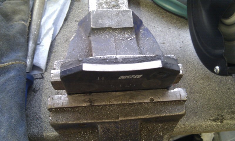

                      Modified the rear pads for the 2nd time, to fit in the calipers.
                      Ground a radius on the inside edge of two of the pads, so that they clear the disk bell when fitted in the calipers.
                      Next I need to modify the pins that hold the pads in, because I've got the wrong ones for the calipers (pins are too long so I need to drill new holes for the retaining R clips)

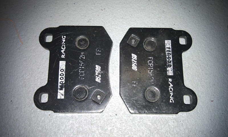

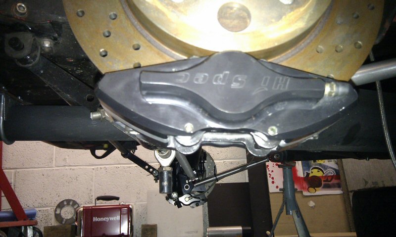

                            Went to the ford dealers in Leicester yesterday, and they found me a spare hydraulic clutch hose retaining clip for the slave cylinder, so last night I fitted the clip and I can now finally bleed the clutch.
                            I've also finished fitting the Ferodo pads in the rear calipers. The four long sliding pins that hold the pads in place on both sets of calipers, were too long for the width of my calipers, so I drilled new 1.5mm holes in the pins for the R clips to hold them in situ (well I did two 1.0mm holes in two of the pins, then broke the sodding drill bit in the third pin, and after persuading the broken piece of drill out of the hole, so I used a 1.5mm drill bit to make the hole in the remaining two pins)
                            The pins were then cut to reduce their overall length, and are now holding the pads in place on both calipers, and the hoses are reattached. So I can also bleed the brakes (finally) and see if the raldes pedal box (so far untested) works with the hydraulic Fiesta ST clutch.

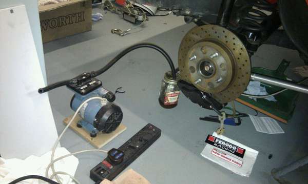

                              Bled the rear brakes last night. One man operation using a vacuum compressor rescued from the WEE skip at work.
                              Draws the fluid through from the reservoir, and works reasonably well. I had to take the calipers off and orientate the bleed nipples to the top to make sure that all the air was expelled.
                              And at first I couldn't draw any fluid through, which baffled me for a while. Then I realised I'd pressed the pistons fully inside the calipers, which prevented any fluid from travelling around the inside of the calipers. Soon fixed by pressurising the calipers using the compressor, to force the pistons back out, and the once reconnected, bleeding commenced.
