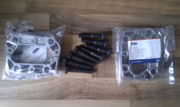

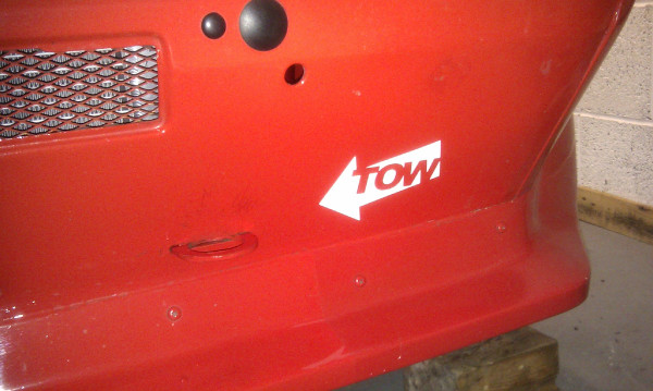

                            Fitted the JDM style Tow sticker from stickeroo (ebay)

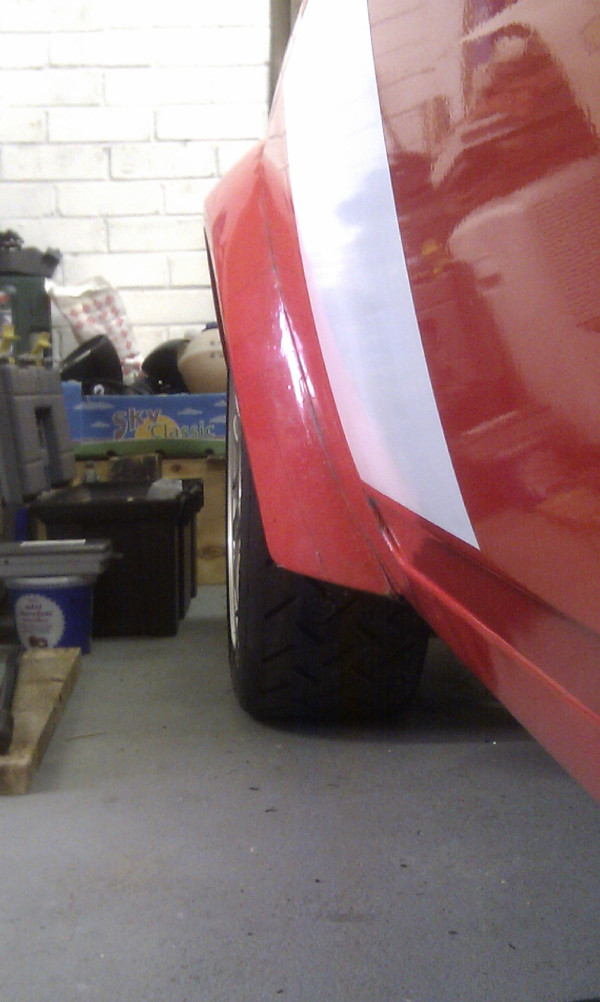

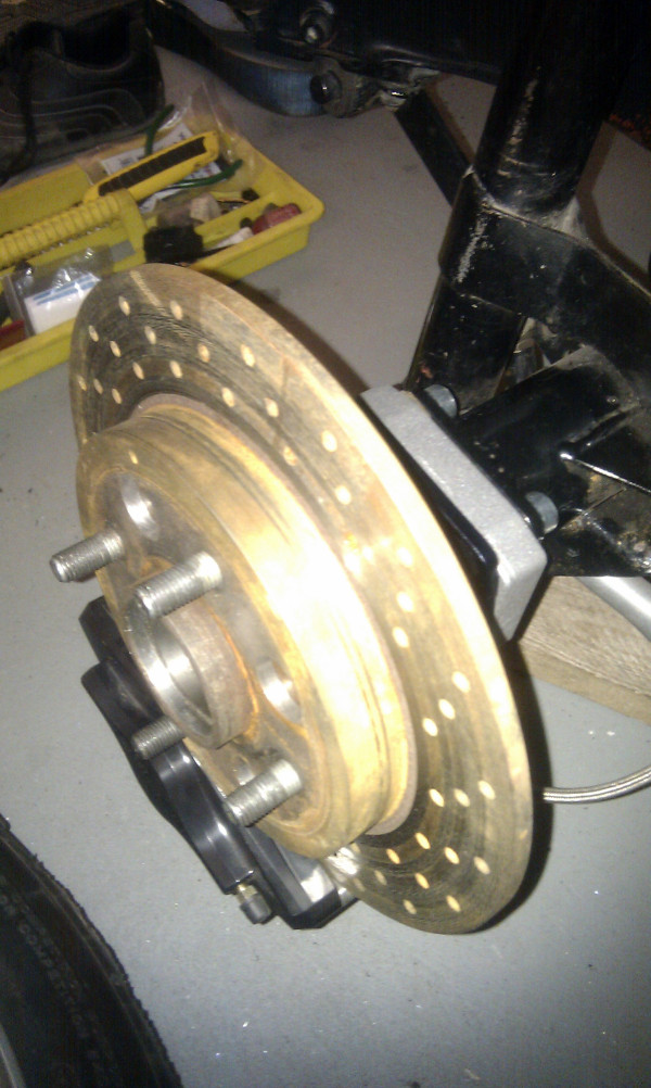

                            Ford Puma 20.5mm rear axle spacers from coordsport
                            Fitted. I needed to get 8x 12.9 M10 socket head screws (£1.50 bargain), as the hex head ones wouldn't turn against the Fiesta axle.
                            15.5mm wider each side, as I no longer run the 5mm spacer that sat on the hub itself.
                            Just the passenger side left to do.
