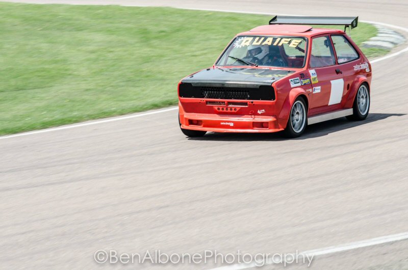

                            Hi graham, great video.
                            I can't help noticing there is a serious amount of lift going on at the front edge of your bonnet foward of the pins. I was a bit concerned it might let go!
                            • team_zi
                              • 1637
                              Ditto. Never noticed it before. I'll reinforce it.
