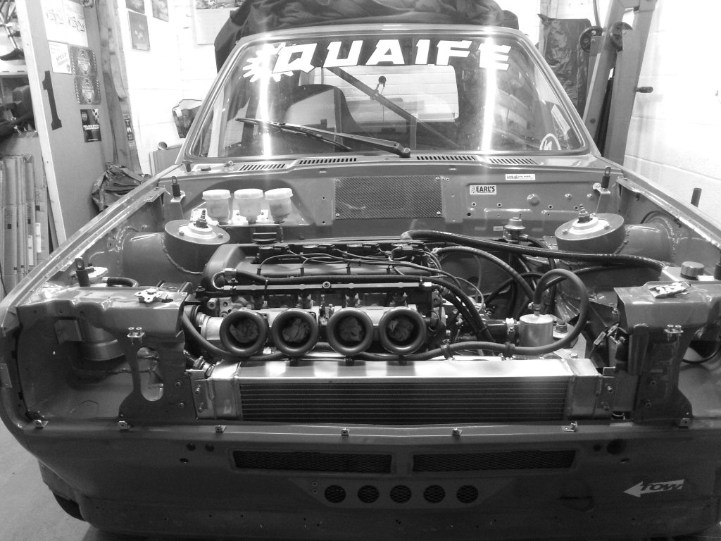

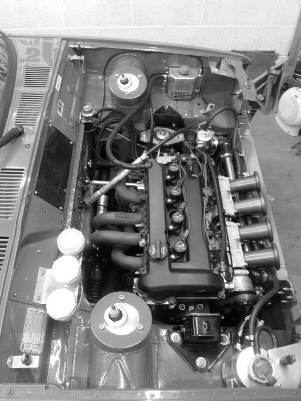

                  Some progress at last.
                  The sequential gearbox is off the engine, and I've fitted the replacement 'circular' clutch, and will be selling the paddle clutch plate if anyone wants it. The flywheel and cover have slight polished marks on them where you can see the paddle clutch was biting. This would explain the judder. I'm not getting the surfaces skimmed, as time is too tight at the moment.
                  Refitting the box tonight, and getting the engine and box back in to the car. I have to get the car back on the trailer for the weekend.
                  • team_zi
                    • 1637
                    Engine and box are back together and in the car. Tonight I'll refit the engine mounts, clutch pipe, etc, and get it back on its wheels hopefully.
                    • team_zi
                      • 1637
                      Picking up the pace a bit now, the engine and box are in the car, zorst is on, should be back on her wheels again tonight.
                      New high ratio steering rack is also fitted. I have two complete turns lock to lock now (3.1 std) so with the steering wheel central, I have one complete turn either direction to get full lock.
