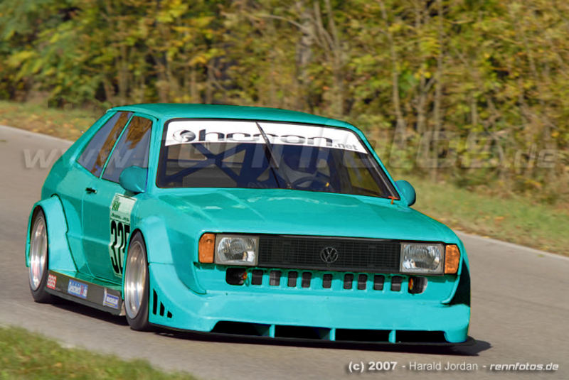

                              This is the rare Kamei front spoiler I bought from Germany 5 years ago. I'd like to fit it, but have enquired with TK Motorsport in Germany about the Scirocco front spoiler, as that could be made to be removable (for trailering). The existing MCR front spoiler in the shot below would need to be removed, and the front wheel arch extensions fitted, modifed suitably.
                              Here is the scirocco front end I'd prefer to use.
