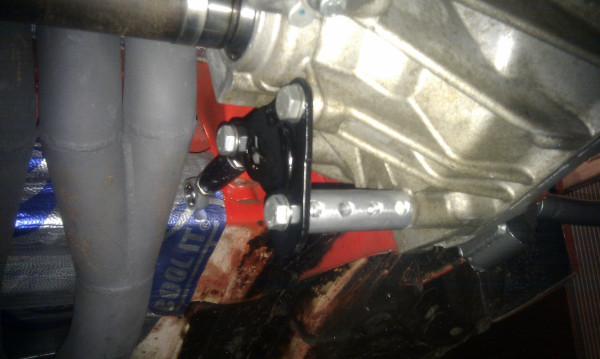

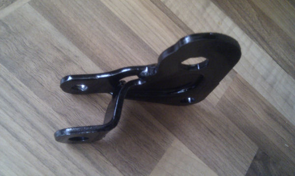

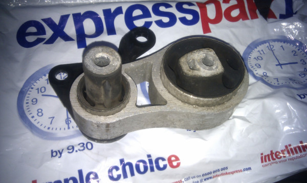

            The standard lower rear gearbox mount from Ford
            Removed the damper section, and welded an additional arm to the outside of the bracket.
            The modified arm bolted to the gearbox. I'll be sure to threadlock the bolts.

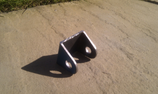

              Welding this to the engine bay floor this evening. This will then allow me to connect the gearbox steady bar to the floor. Made this from a piece of 1.25" box section steel.
                Good luck Graham, try to make sure its not just in the middle of a flat section of floor or it'll just flex and crack. Curves and double skin/box sections are best as they offer natural strength.

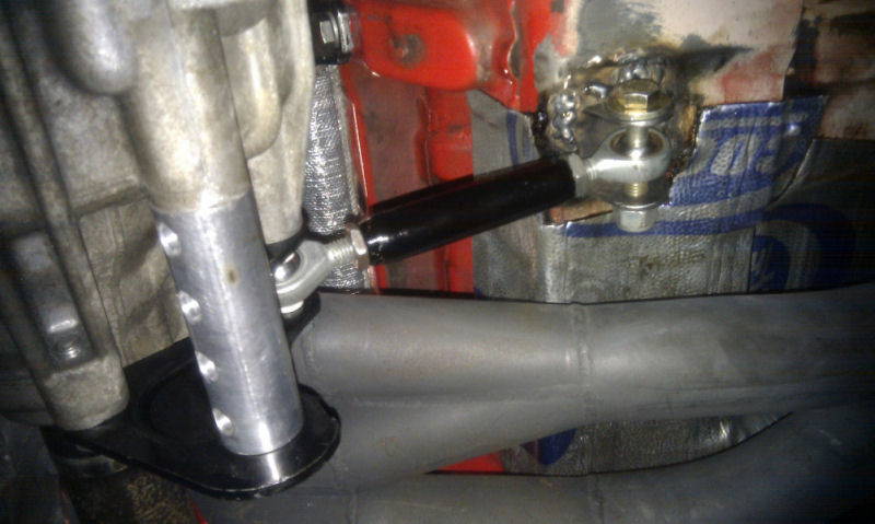

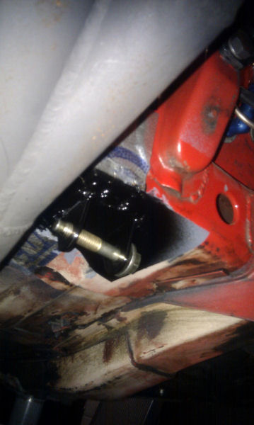

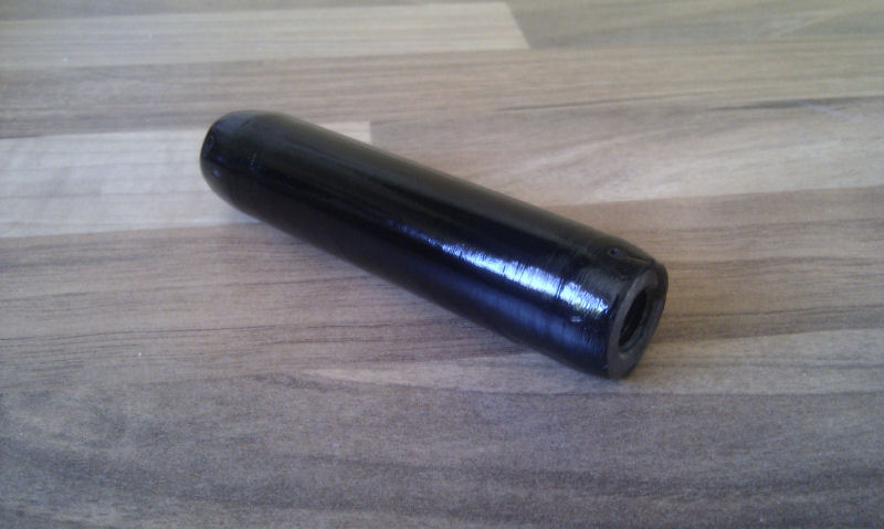

                  Made the drop link/steadybar from some steel tube that I welded two M10 nuts to the ends, and ground the welds down, then painted with black gloss spray.

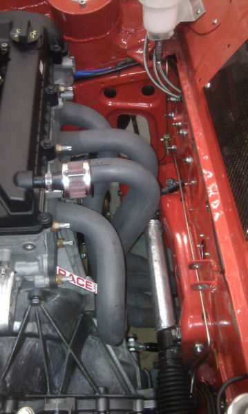

                  View from above of the gbox mount. Its so sturdy now I can run without the old top steady bar that ran between the top of the box and the bulkhead.
                  View underneath. The steady bar uses two M10 rod ends and the spacers are made from aluminium tube cut to length with a pipe cutter.

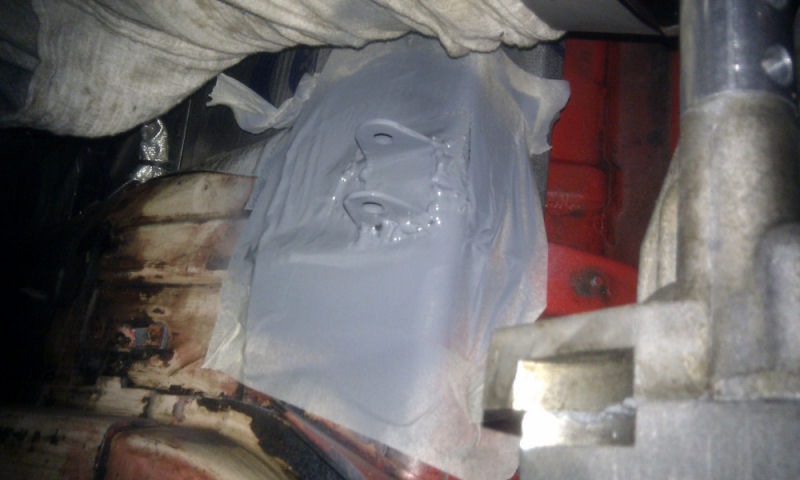

                  Then with it all removed, I've masked off the Coolit shield, and sprayed the bracket with primer. I'll spray it black today, then use Dinitrol to finish off the rust proofing on the floor.
                  The floor where I've welded the bracket to, is double skinned, and around 2.5mm thick, as its actually a box section that runs across the width of the car. Strength is going to be more than adequate just there.

                        Sprayed the floor with primer then gloss black, just need to re-apply the Dinitrol 4921 wax to protect it. Dinitrol is quite hard wearing, and comes off with solvent cleaner when you need it to. The underside is wearing well considering its 28 years old this year. I'd really like to remove all of the Dinitrol and get it sprayed professionally underneath, but this'll do for the time being.
