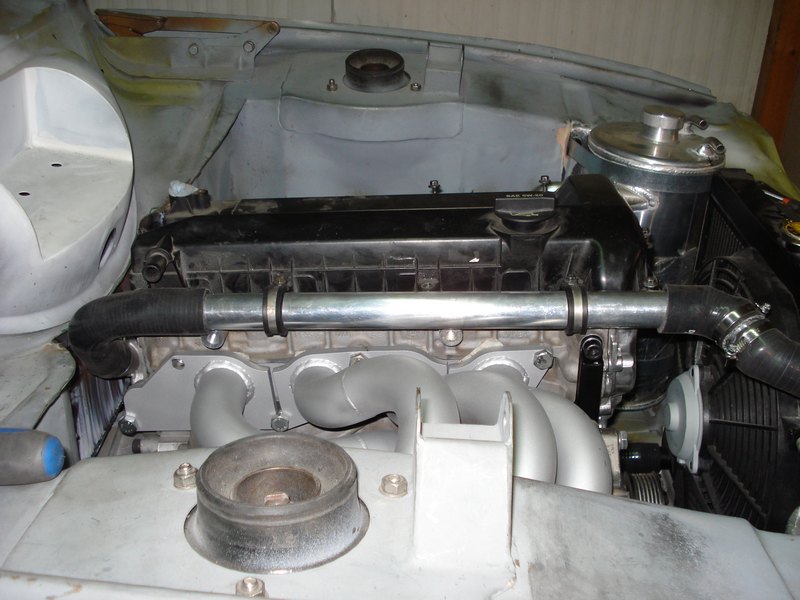

                The engine gets up to temp nice and quick (<5mins). The header tank and swirl pot are both the first two items to get too hot to touch, suggesting that the flow of water from the swirl pot to the header is still too great, despite the 2mm restrictor inside the 8mm hose. When I raise the revs the radiator starts to flow.
                So: EWP looks like a go-er.

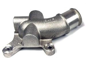

                But, before I do that (you can tell I'm determined to get to the root cause), should I block off the large diameter bypass hose that runs across the front of the block from the thermostat housing to the sensor housing?
                Does anyone else running a RWD Duratec in an Escort run this pipe? If you run a water rail kit on a Duratec, what changes are made to the plumbing?

                  I keep mine as simple as possible with only 2 hoses, no other hoses needed unless you are running a heater, but I have no worries about engine running too cool, due to the climatic conditions. You could of course run the EWP with either it's propper controller or relay switched by an ECU.

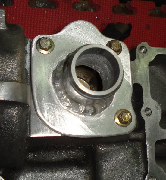

                  1: Remove mechanical water pump and replace housing with 5mm Aluminium blanging plate held on with the 3 screws and silicone
                  2: EWP from bottom hose to home made ex-thermostat housing inlet
                  3: Cosworth outlet at rear of engine to radiator top inlet
                  5: Permanently switched on EWP with no controller or thermostat
                  This is the idiot proof set-up I ran on my Caterham, with the exception that I had a Raceline Water rail, again with no thermostat, but otherwise identical. It has been bullet proof for 6 years now.

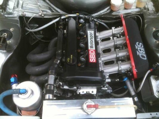

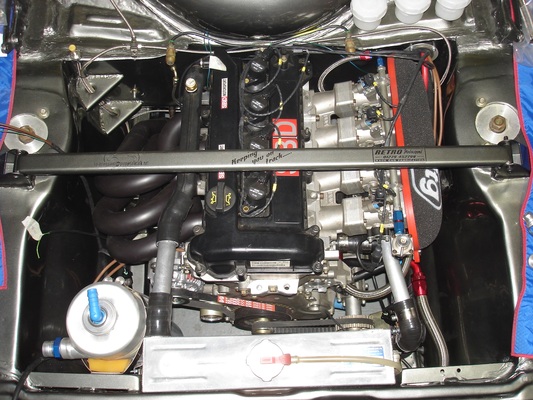

                    Looking at your pictures, it would do no harm to run your swirl pot as well, I have no used one, but a lad who runs an Astra 2.0 out here needed one to sort out his aeration problems in his FWD install

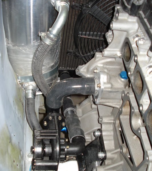

                        My plumbing is basically identical to Neil's. I take the cooler coolant out of the bottom of the rad, through the pump mounted under the T/B's right by the L/H engine mount and into the block with a fabricated plate (32mm bore pipe).
                        The water pump is completely stripped down and all of the guts removed, all of the crap machined off and an ali bung pressed and bonded in so you can still use the oring detail and it's easily removable. The outlet to the top of the water pump chamber is also blanked off from the inside.
                        I then run a retroford water rail from the back of the head to the top of the rad which also houses the ECT sensor and stack gauge sensor. No stat or swirl pot as the rad cap is the highest point on the system anyway.
                        The water pump is run from the ECU on a very simple hysteresis which s basically 20% up to 70degC and flat out 100% after that.
                        If you let me know you email address mate I'll send you the pics I have of my install.
                        Here's a couple of pics to give you an idea of mine.
                        First time install
                        And how it is now, identical plumbing wise.
                        Give me a call if you want to chat about it.

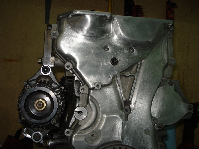

                              Could you try and junk that massive serpent of a belt and just run a tiny one just to the alternator like me? Go and see Steve Broughton on the Kent Cams stand on thursday and see the little belt tensioner on the display engine, the alternator is fixed with a really neat small idler.
                              You can just cut the impellor off the rear but you still need to do soemthing with the other outlet from that chamber, I'm pretty sure Steve sells them off the shelf. I could turn one up if you want anyway.
