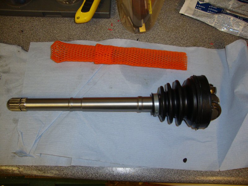

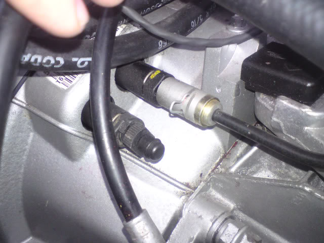

M-Sport sells a push fit -4 adapter for the new Fiesta R2, that fits the same gearbox as mine, so I'll get one ordered in the morning.

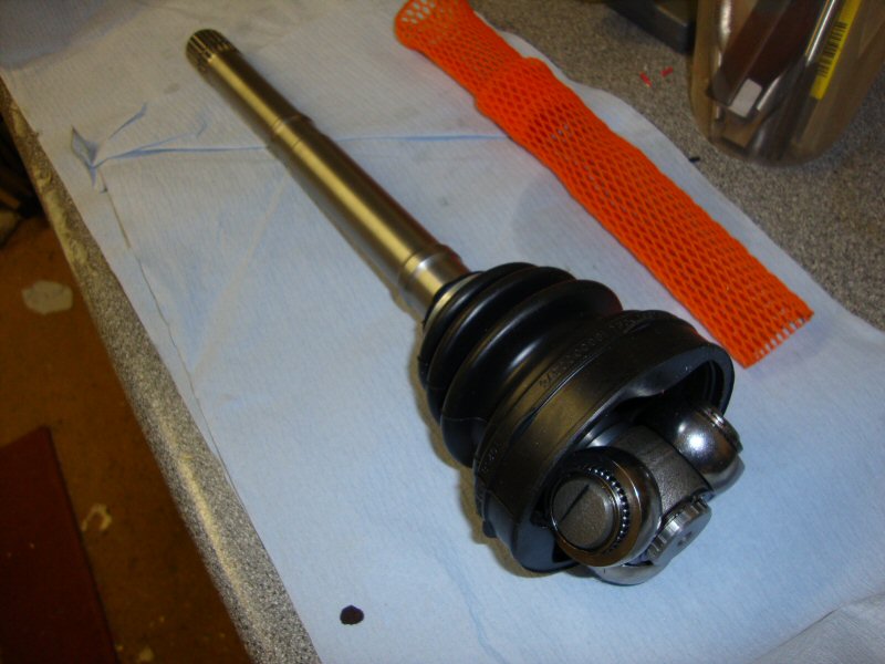

Fitted the driveshaft this evening. Fits perfectly.

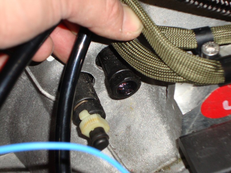

Started aligning the crank posn sensor, using the tool that adam loaned me, but I need to borrow my dad's dial gauge which he's dropping off tomorrow. So I'll set it up tomorrow evening.

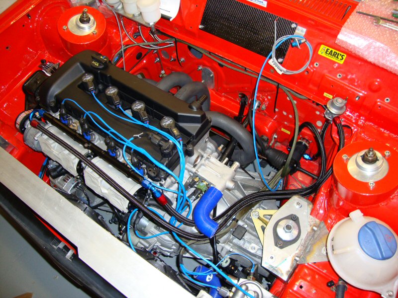

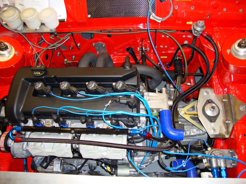

First time since installing the duratec that I've had both front wheels connected by driveshafts so its another milestone reached tonight.
Those driveshafts look great! And its always nice to be able to fit something straight away without having to modify it or everything around it.
Now its only the water hoses and you can get the engine running.
