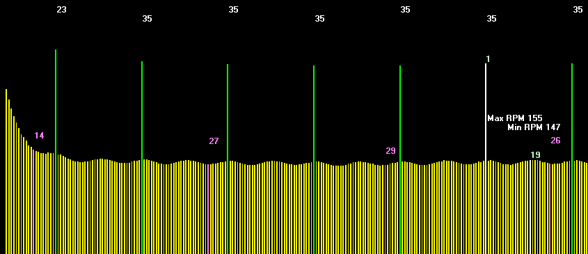

            This is the oscilloscope output from the DTA software showing crank and cam signals from the sensors. Not sure what the pink number mean, would expect them to be the same for each cycle of the crank maybe?

              At a guess, is the green line the pulse from the crank sensor, and the pink ones are the cams at half engine speed?
