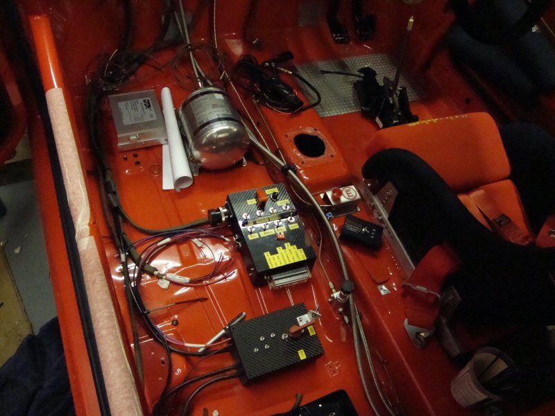

                            #523
                            Shot of the interior tonight
                            • team_zi
                              • 1637

                              My Carbon Dash is finished! Hansell Composites are sending it today, so I may get it tomorrow. Even they think it looks fab. They've used a gloss finish on the front panel, and the rest is matt finish.
                              Finished the goddam wiring last night. No more wires to run inside the car. Now its just a case of crimping 70 or so pins on the ends of the bare wires, and inserting them into the connectors.
                              I cant emphasise how much I've enjoyed this part of the project, but I'm just so f*cking pleased thats its coming to an end, so i can move on (and get some bl**dy sleep again)

                                #525
                                lol thats the joys of DIY! At least you know it's right tho . Re the 'screen demisting , do you think there's enough heat off the dash box?
