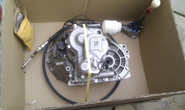

                            The Quaife sequential dog box arrived today.
                            The selector cable goes to the front of the box, in roughly the same place as the selector on the std IB5+, so that's a real bonus as I was worried where it was going to sit on the box.
                            Its come with a brand new 7 segment display (in the Jiffy bag), but I already have the www.geartronics.co.uk display, so I'll weigh up which is best and fit the right one.
                            I'll need to remove the existing Mk7 gear selector from inside the car, and see how to fit the sequential shifter lever. The lever is quite short, so I may have to fabricate a cage for it to sit on, to raise it up.
                            They also chucked in a couple of T-Shirts, and a new sun strip for the Fiesta. Shame about the new rule on 13cm tall 'adverts' on clear surfaces. Or does that count on a sunstrip? Sod it, who cares anyway?
                            I'm confident that I can make this work in my Mk1. Just need to get my arse outside to start swapping it all over. What blows me away, is how tiny the Quaife box is! Its a great bit of engineering.
                            I believe that they've only made two of these boxes, one went to Ford and this is the one from the ST demonstrator, or vice versa. Rarer than hens teeth!

                              #989
                              oh man...I just destroyed the place drooling... I want one of them , bad!
                              • jonboy
                                • Jan 2005
                                • 1020
                                #990
                                That is a nice gearbox !
                                Look forward to seeing the videos once thats in and being used
