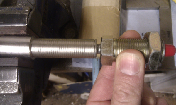

      Made an ally plate last night to fit over the hole left from the previous gear lever. Sprayed it sunburst red, and I'll stick it down with silicon sealant tonight. Then I'll finish fitting the new tower to the floor. The steel threaded barrel from Quaife should be with me today, so I can get the cable assembled and tested. Then its time to take the engine and box out again, so I can change the f/wheel and clutch, and then when the suspension arrives, its all going back together.

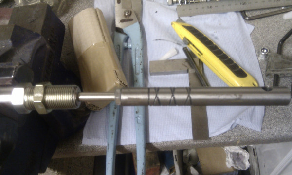

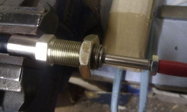

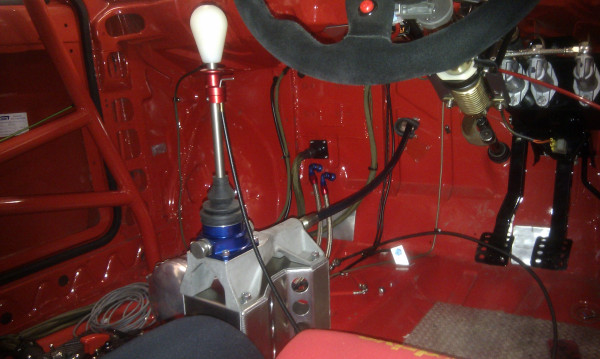

        The missing threaded section turned up from Quaife, so I fitted it to the cable last night, then assembled the shaft that sits inside the gear lever housing, and assembled the gearlever back together again.
        Next job was to secure the gear lever tower to the floor of the car. I used 4x M6 rivnuts in the base of the tower, and bolted it through the floor using stainless socket head screws.
        The gear lever now sits on top, with the cable passing through the bulkhead in to the engine bay. I'm going to relocate the hole, so the cable avoids the exhaust manifold on the other side of the bulkhead.

          all looking super tidy graham
          and the pic links seems to be fixed now, so doing it the normal way should work

            Nice tower you've made there
            • team_zi
              • 1637
              Looks better in ally I reckon

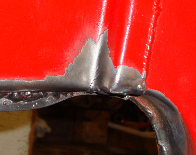

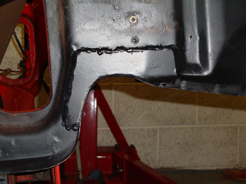

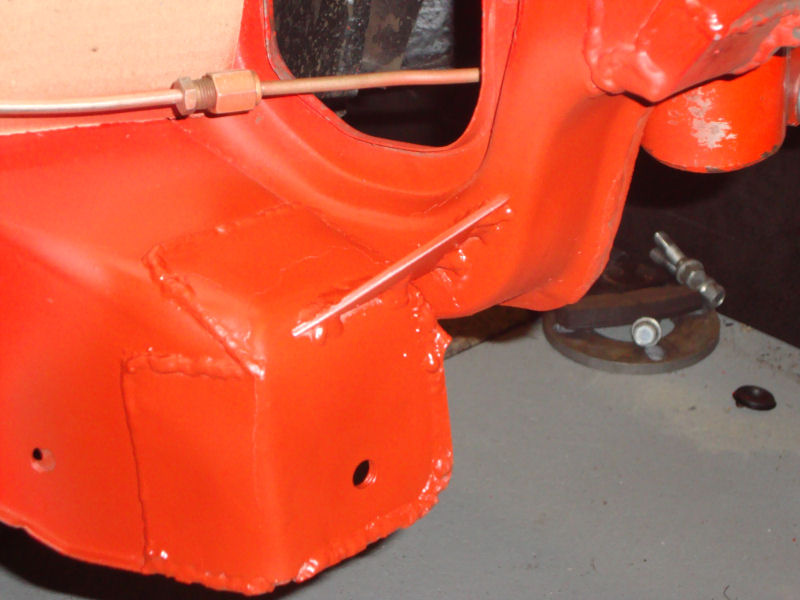

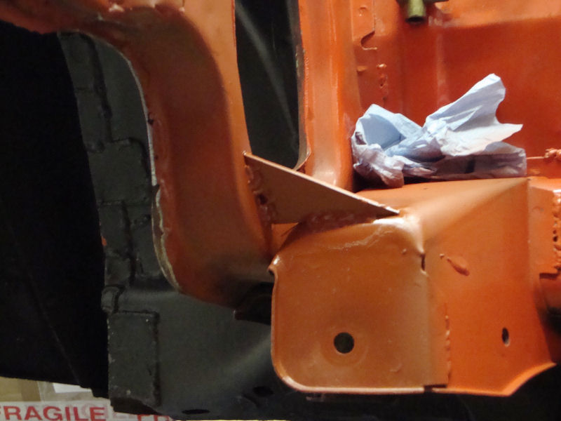

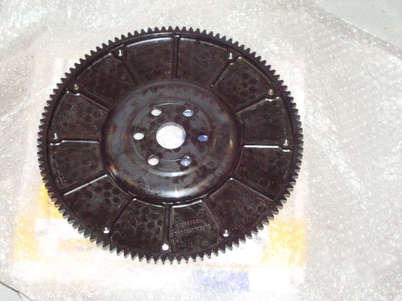

                  Removed the engine and box last week, and discovered a crack in the chassis rail on the drivers side where I'd modified it to clear the crank pulley (10 yrs ago).

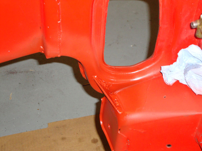

                  So I took the opportunity to brace the chassis, and also add gussets to the TCA box section to add some rigidity.
                  Quite a scare, but spotted in time I hope. If I hadn't removed the engine and box, I'd never have spotted it.

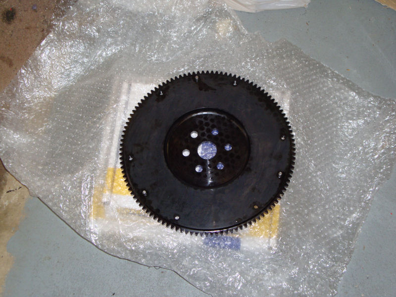

                  The Titan flywheel has also turned up, only weighs 3.7KG and is the lightest flywheel I've ever held. Also gone for an AP Racing 8.5" clutch and cover, and ARP rod bolts. Fitting these at the weekend and then the engine is going back in.

                    whats the idle speed likely to be , with such a light flywheel?
                      • 25249
                      tbh, flywheel weight doesnt have a massive effect on idle speed, most full race engines on ultra light flywheels will still idle ok at about 1000 rpm on one, more of an issue is trying to pull away without stalling or lighting the tyres up when your not "going for it"

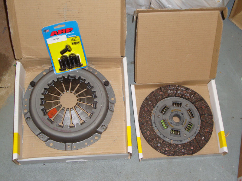

                        I've accomplished feck all this long weekend, after I discovered today that the wrong clutch has been supplied by Raceline. Its centre is too large to fit on the Fiesta gearbox input shaft.
                        But I did find that after discovering that fitting the gearbox, I couldn't turn the crank by hand, I needed to Dremel some ally away from inside the gearbox, because the larger diameter Titan flywheel hits the inside of the gearbox.
                        Then I realised that I needed to make 3 x 2mm spacers to move the starter motor out from the larger Titan flywheel to allow the starter motor pinion to engage/disengage correctly. Why on earth does the Fiesta ST have a smaller flywheel, clutch cover, and different starter motor to the Focus/Mondeo!

                        And the new f/w is 5kg lighter than the one I removed, so its not all bad news.

                          Just been on the phone to Burtons, and purchased an AP CP5354-15 paddle clutch to replace the Type 9 clutch that Raceline provided me with. Burtons say that the 5354 clutch will work with the CP5905-500 cover. Delivery by the weekend.
                          Raceline have asked me to send the Type 9 clutch back for a refund.
                          So I'm sticking with the taller flywheel, but changing to a paddle clutch to avoid any slip.
                          And just to confirm, yes the Fiesta ST uses a 4mm shorter flywheel than the Duratec engined Focus and Mondeo. Nice!

                                The cerametallic Paddle clutch has arrived, Burton are as good as ever in delivering on time.
