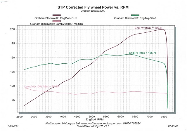

          Here is the power plot from Tuesday
            Fantastic torque spread there, should be real nice to drive
              • 25249
              For Aintree I might just turn the rev limiter off
              well looking at the power plot it would happliy run onto 8K in top, undergeared is usually faster than overgeared,
              better to reach a lower top speed fast and hold it than only just hit your top speed as you brake
