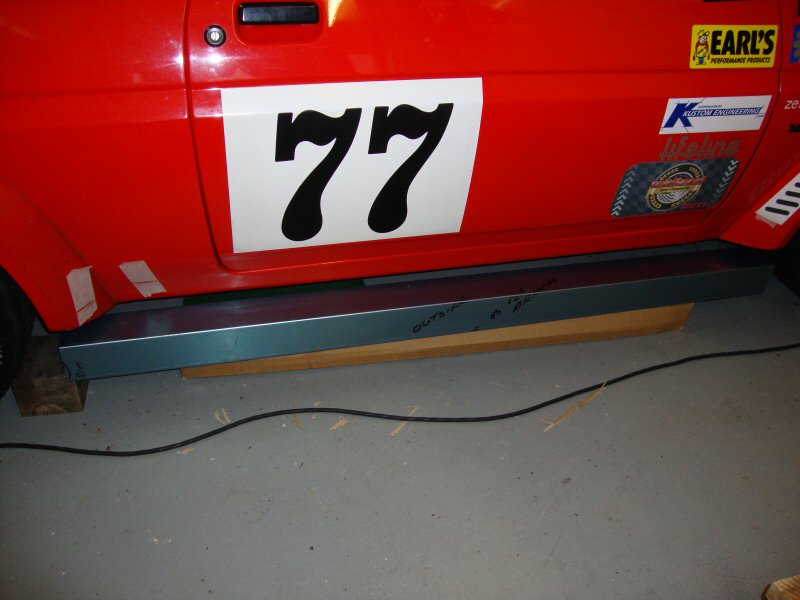

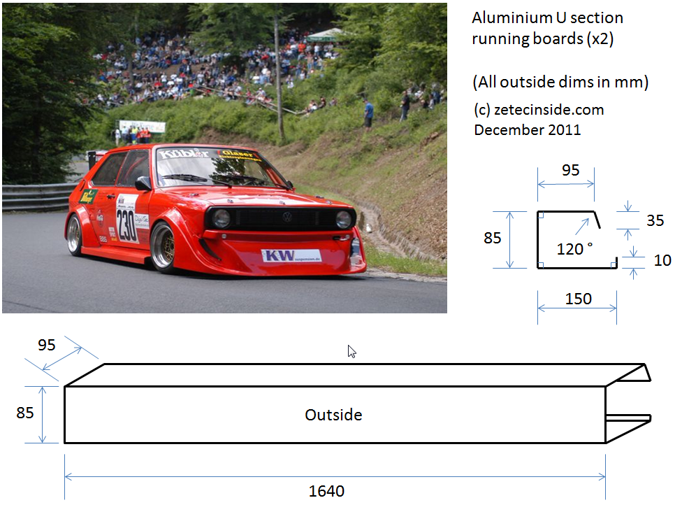

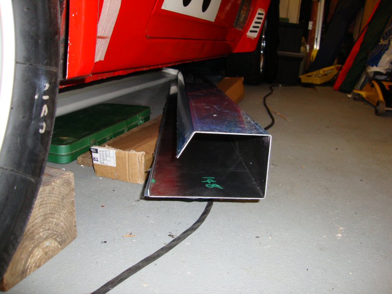

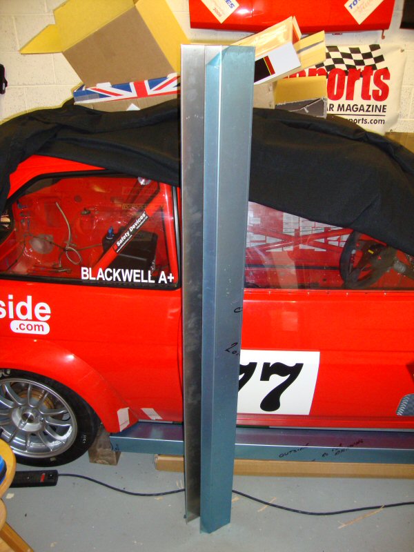

    Altiss are making up a pair of running boards for the XR2. Should get them in the next week or two.

      good stuff, one question though whats the point of the running boards? they look too far off the ground to be of any areo use

        Theoretically, if I prevent the air passing underneath from washing out the sides of the car, I can use the air to assist with an Increase in downforce. I'll be lowering the car further, and using flexible door draught exclude rubber strips underneath.

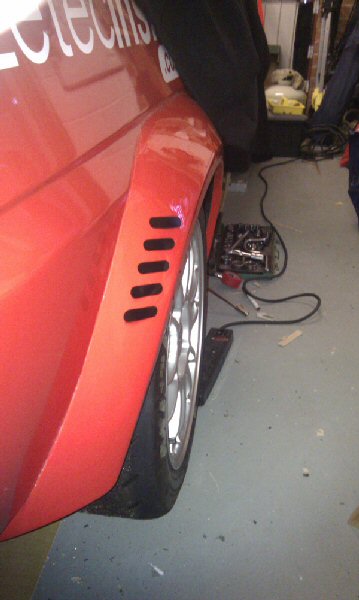

          Rear slots/louvre progress.
          These have been sprayed on to the rear wheelarch. I made a template by using Powerpoint to position the shapes, then printed to A4, sealed the paper with wide clear tape, then cut the shapes out using a new stanley knife blade. Then it was a case of taping the template to the wheel arch, and masking the rest of the bodywork out. A quick couple of passes with the rattle can and then remove the template and paper, and this is what is left.
          I can now clearly see how they'll look, and I just need to carefully cut the black sections out using the dremel to turn them in to slots.

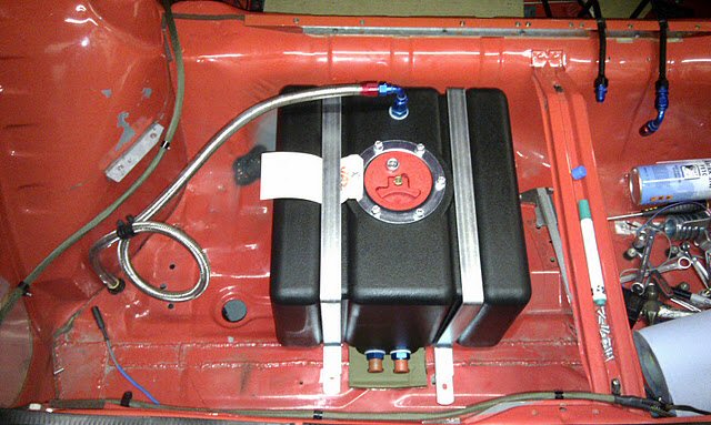

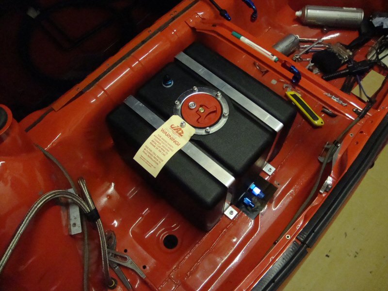

            Ordered a Jaz fuel cell from Raldes. http://www.rallydesign.co.uk/product...oducts_id=1867
            Gone for the 5 gallon version, as its only 13"x13"x8" and should weigh a lot less than the 30litre ATL saver D-cell.
            I'll sell the 30 litre ATL D-cell on ebay I cant use it any more as it has exceeded the lifespan for plastic fuel tanks, and is a bit too big for what I need now anyway. Not that anyone has ever asked about the age of my fuel cell....

                whats the point in the louvres?
                i have to say im not a fan
                  air gets trapped inside the wheel tubs and creates drag, the louvres let this all out and helps reduce drag. or something along those lines.

                    A new Bosch 044 pump turned up today, together with various adaptors and fittings. I'm currently fitting a JAZ 5 gallon tank to replace the ATL D-Cell, which goes on to ebay tonight at 8pm with an 99p starting price.
                    It was £112 from raldes, and weighs 2.8Kg dry, which is approx 6 Kg lighter than the old ATL cell it replaces.

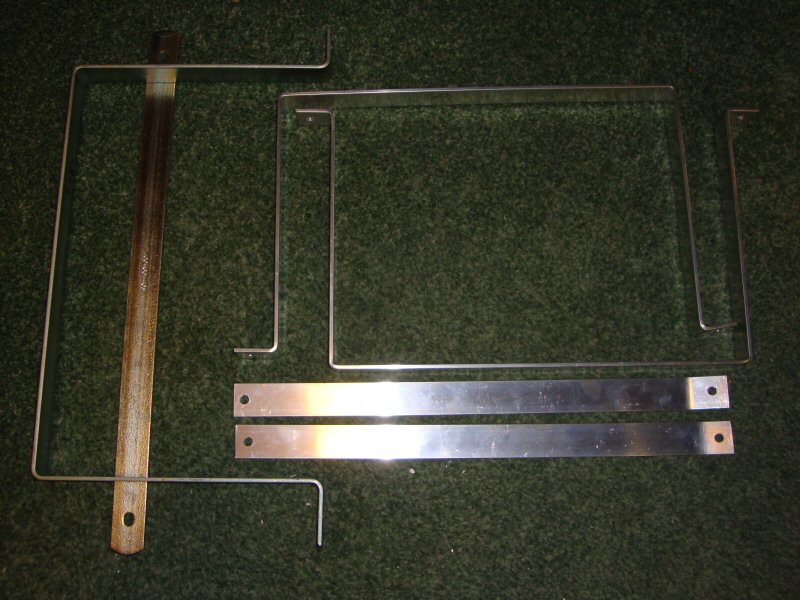

                            Making my own brackets in aluminium saves 1Kg over the weight of the standard brackets. (464g vs 1.48Kg)

                              Running boards now safely tucked away in the garage. Very pleased with them. I'm going to use s/s q/r sliding latches to hold them on, so I can remove them when loading / unloading the car from the trailer.
