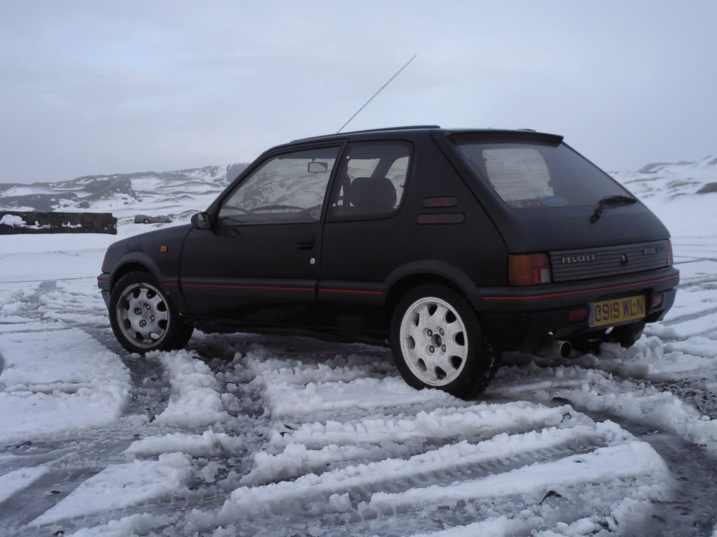

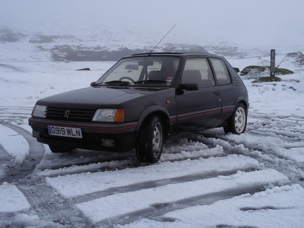

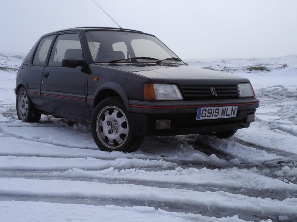

    So far its had a new airflow meter, track control arm each side, sorted rust on bottom of the rear quater, stuck on a Green cotton induction kit, sportex exhaust from the manifold back and group N engine mounts. We also serviced him so he runs pretty well now. Oh and currently has one white wheel that we ve refurbed. We have 9 wheels altogether which will be going white soon. So here is Pugsley as he stands at the moment
    In the new year it'll be set up as its a bit rich at the moment, also a knocking from the rear which will hopefully go away when it gets new suspensipon all round too, failing that it could well be a new beam time. Also there'll be a cage on order and these will go in at the same time.

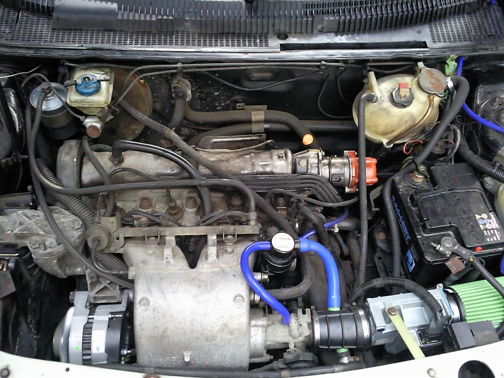

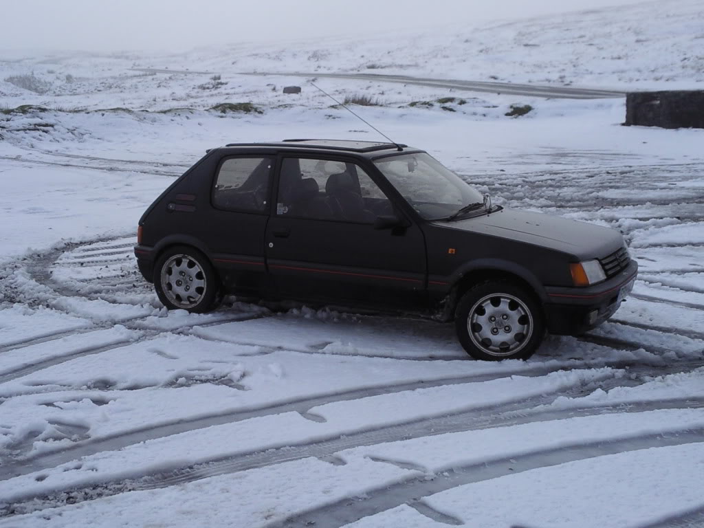

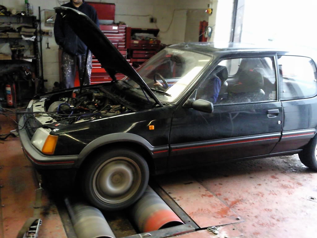

                  Spent the morning up in Abercynon today at Willfield motors aka Tommies. He fitted the power boost valve then ran the car on the rollers. He made some tweaks to the idle speed, the air/fuel mixture and tweaked the ignition timing. Did another 2 runs and some minor adjustment untill we were all happy. So a 20year old car with 157,000 miles on the clock achived an impressive 119bhp. Engine is nice and solid and healthy too. Cost me £95 altogether which isnt bad considering the time that was spent adjusting things and time on the rollers.
                  Pugsley is now much more smoother and more responsive to drive. Here's a cheeky pic from today.
                  Picked up some second hand fuel tank guards Sunday too. Dont look pretty but they'll do the job, so thats another item off the shopping list.
                  Next up is a visit to Longlife for the exhaust to be made a bit quieter as at the moment I doubt it would get through scrutineering. MOT is also booked in for the 19th but before then we'll hopefully have new suspension and some subframes for the Cobra's and also an out side chance of a cage.

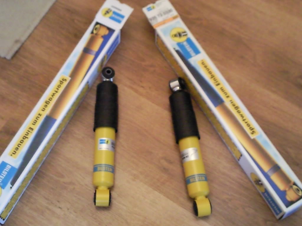

                        Added bonus of the day is that these turned up
                        They will be fitted once the matching front struts and gravel springs are ordered so they can all go on together. Also the seats are now in the car and so will the harnesses soon. Pics of them to come once all fitted nicely.

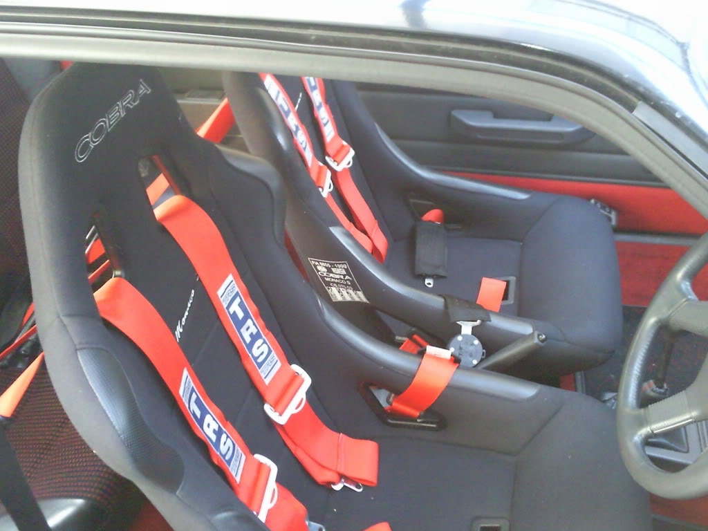

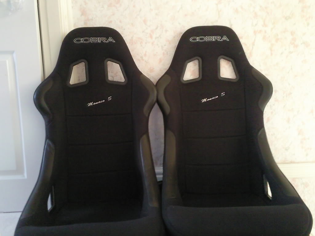

                          Here we are as promised. Seats and harnesses in place, feels much better to drive now, actually feel as if im in the car rather than sitting on it.
                          Front struts and gravel srpings next month and maybe...just maybe a cage.
