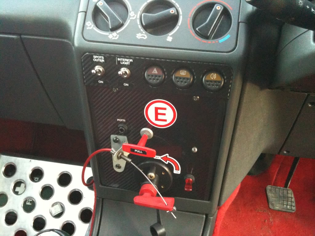

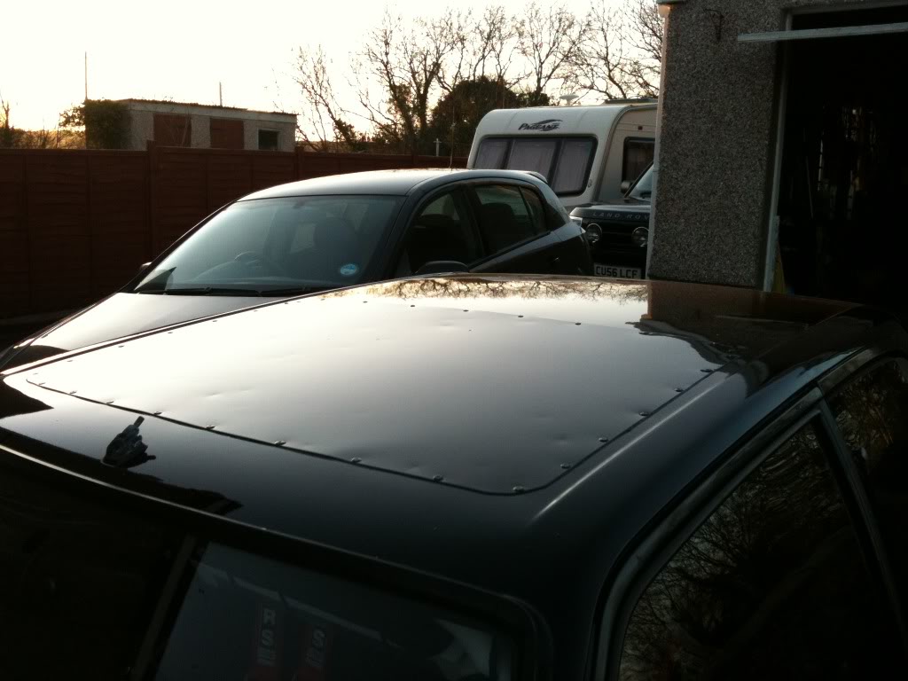

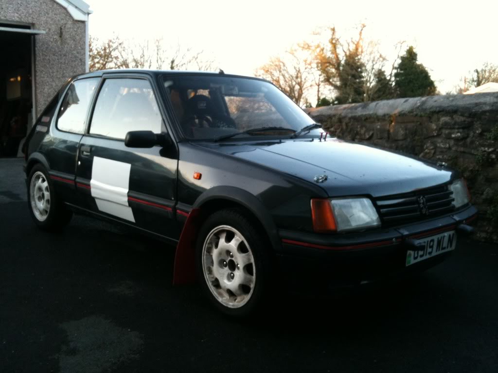

    Little Pugsley will be getting logbooked on Sunday so we have been busy lately with getting sorted and upto standard. The main thing is that the sunroof has gone and a nice plate has been fitted in its place. Everything is sorted inside now with cut off switched and pull cords for the plumbed in. Door squares have also been added and a few other small details. All it needs now is a wash and re fit rear mud flaps and it should all be ok.

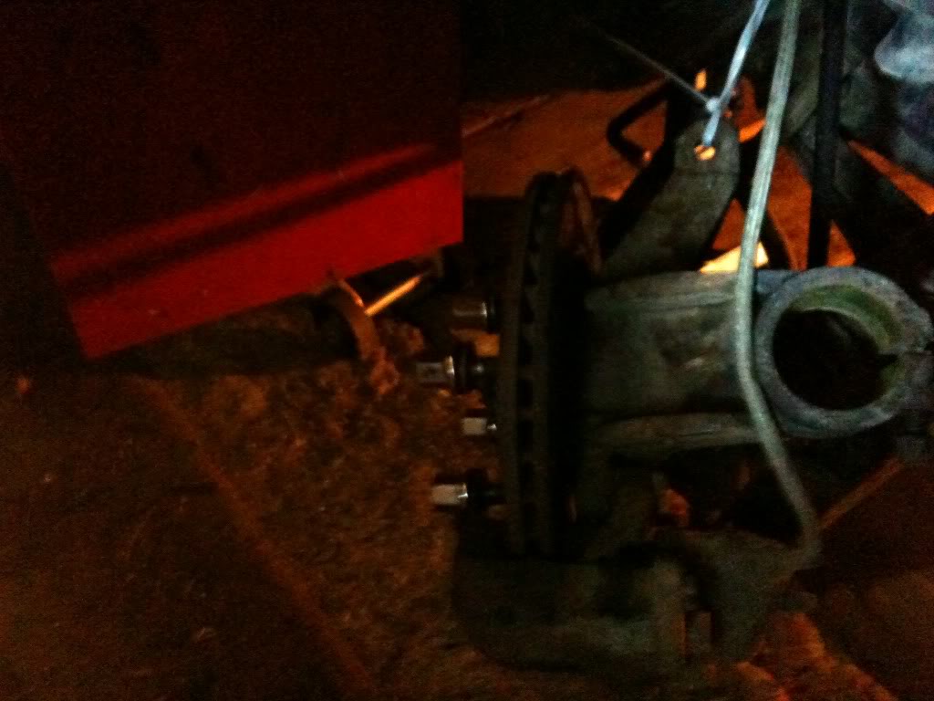

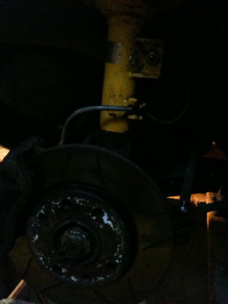

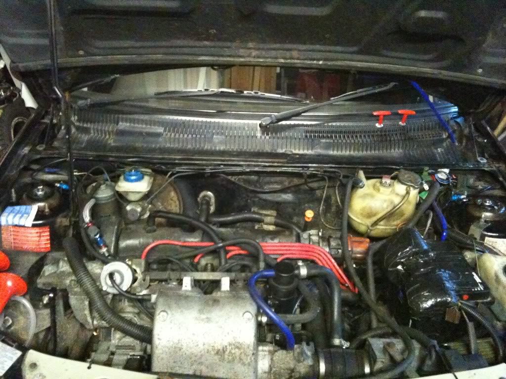

            First stage event coming on Wednesday 28th. West Wales Rally Spares Christmas Stages down Pembrey Race Circuit. Last 2 road rallies we did we notice a slight little knock/rattle. On investigations it came to light the bushes were a bit worse for wear in the bottom arm so a new one was sourced and fitted. Quick test drive and noise was stilll there. Phone call to Neil, who's helped out all the way, and he came down for a nose. Turned out that the gear selector had come loose and was rattling around so nipped that up. Neil also noticed that our strut tops were a little higher than they should be and that one had even started touching the bonnet so the struts were removed to have new rubbers installed.
            So as it stands the car is currently leg less. Should be back together this afternoon. Some pics to follow.

                Spent a bit of time yesterday sorting the car out. Refitted struts after tops rebuilt and changed over plugs and leads. Quick swap of wheels tomorrow and a little bit of testing and we should be good to go for the Christmas stages down Pembrey on Wedensday. Qucik pics below.

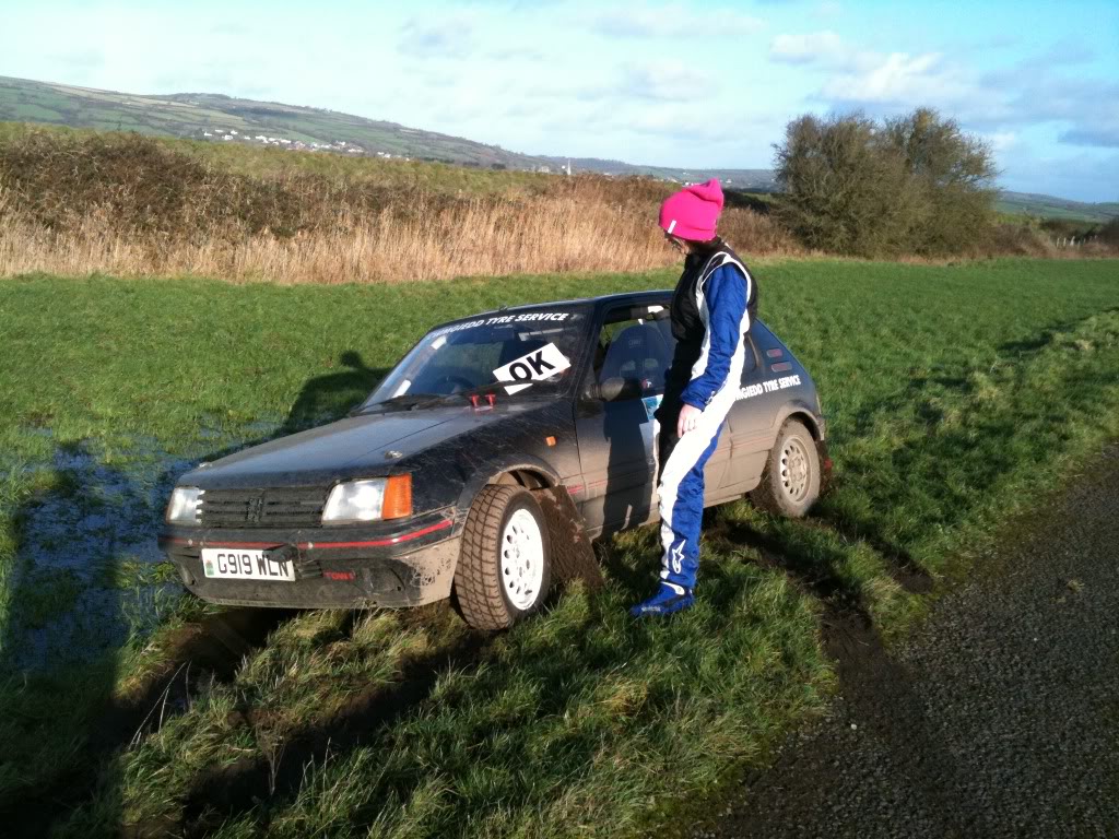

                  Did Chirstmas stages down Pembrey yesterday. 1st stage event for me driving so was interesting. We took it easy on stage 1 just to see how slippy it was. Pushed a bit on stage 2 trying to catch my mate in car 68 and had a big spin at about 80mph on the back of the circuit , had a slight off on stage 3 on beach road, either a bit to quick into a right bend or just caught a bump on the inside which upset the rear of the car. Back end stepped out and touched the grass, caught the slide but had a tank slapper the other way, hit the grass on the other side of the road then spun off the road and ended up in a ditch half in water. No damage, just couldnt get the car out. :blush: I ll put a pic up later on that i took once i got out. Stage 4 took it easy to get my confidence back and then went 29 seconds quicker on stage 5 which was the same as 4. Not a bad first stage event, big learning experience and we were going ok. Before our off we were something like 48th overall and 11th in class so going ok. Finished last but one in the trophy rally but when Peter Lloyd was in there in his Impreza WRC then there was no chance so it was just to gain experience. Looking forward to next year now.
                  Some little chages to be made to the car before next year which will be kept updated on here.
                  Quick pic of our little off on Beach road.
