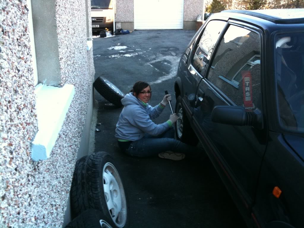

    More tyres meant we needed some more wheels, so another 2 were purchased via ebay again for £20 for the pair. They are a bit tatty and have a nice spodge of red on them but they'll get blasted and then painted white along with the others. So we now have 11 wheels. 4 road wheels and a spare and we'll have 4 rally wheels with 2 spares. Claire, the misses, is doing the painting as Im no good at it and we currently have 3 wheels done in white.

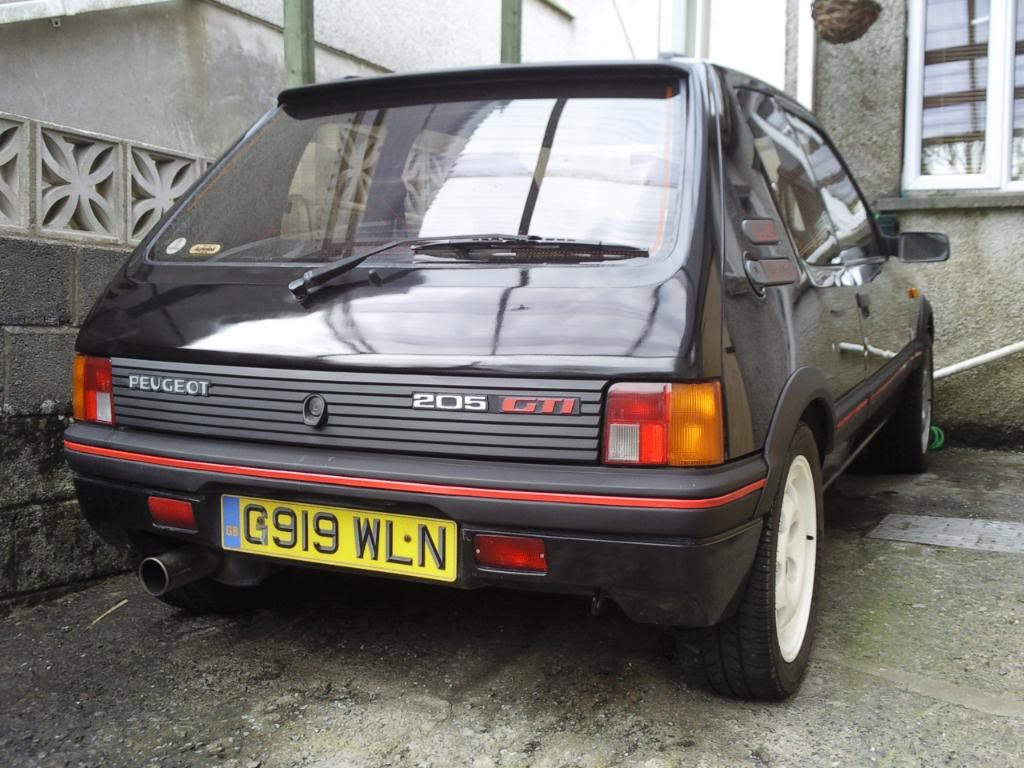

    Last week we both had a week off and the aim was to re paint the boot as it looked pretty bad and there was a small rust scab starting to form. So we got that done through the week and we decided we that the gray plastic trims were making the car look older than it really is so we decided we would give them a coat of matt black. Pics are below, so compare them to the pics at the start of the thread it looks like a different car, amazing the difference a bit of matt black does.

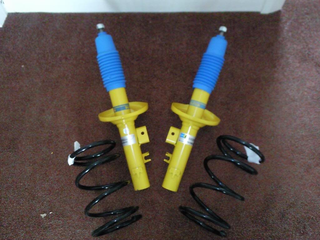

    Next was the front struts to go with the rears so another visit to ebay and these turned up
    The springs in the picture are gravel springs that were ordered from Peter Lloyd Rallying. So once all the suspension is fitted it should feel like a different car too. The final new toy that arrived was also order from Peter Lloyd on Tuesday. I was told it would take 2-3 weeks as it was out of stock... Next day this was waiting for me.

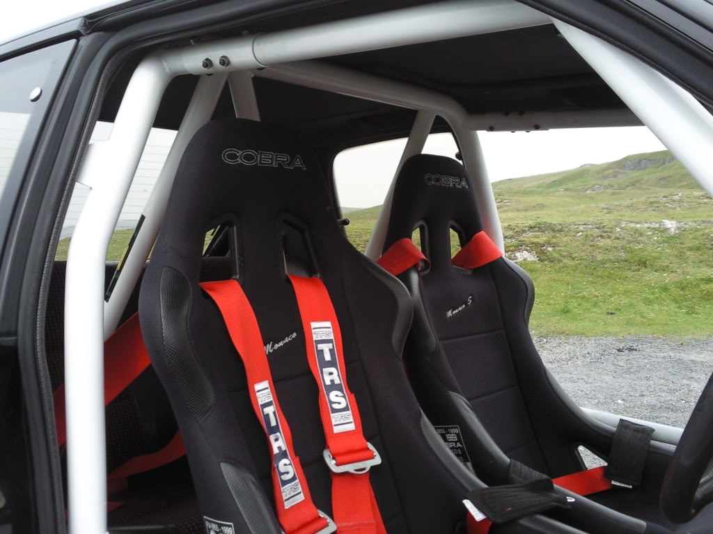

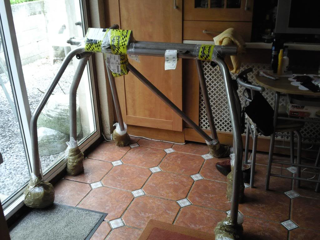

    I finally got my hands on a cage, after several nearly 2nd hand buys we decided to bite the bullet and order a new one.

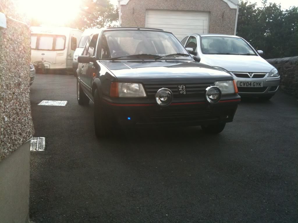

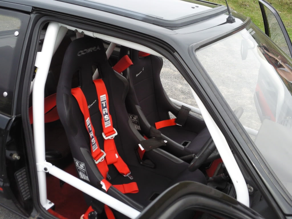

      Car has spent most of last week over at CAM Sport. Their a local company who mainly deal with rally prep but can do pretty much anything. So it now has the Billies fitted all around as well as the gravel springs and of course the cage is in. So here are a couple of pics.
      It feels 100% better. The shocks that came off the rear were completely dead. I can compress them by hand and then they have to be pulled back out so that seems to explain the noise i used to get on the rear when going over bumps, touch wood, but it seems to have sorted it.

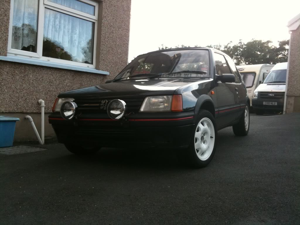

          So for the last 5 days the car has been in having some wiring done. So we had it back Friday but havent had a chance untill today to do some work on it.
          We have an entry for our fierst event on 21st of August so we have been busy. We fitted new tyres, padded up the roll cage and fitted the spots and a few other things around the car. Few jobs left now before the 21st like fit the sump and fuel tank guards and sort out a spare wheel holder.
          So here are some pics of how it stands now.. ignore the lack of number plate.. it sort of broke as it was a bit old.. so new plates needed too.
