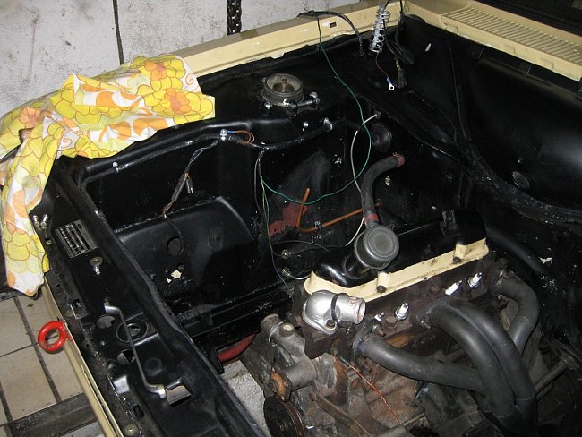

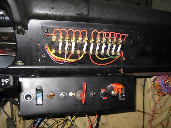

        A little update:
        Wiring done
        exhaust done
        exhaust tunnel done

        waiting for my paket from evodave (classic and rally spares)
        putted a standart engine in today to testdrive the new suspension and the new brake system

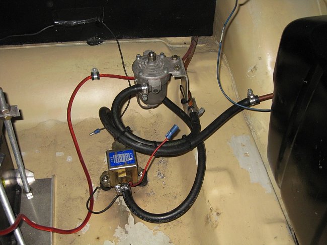

        put the fuel regulator in the back
        still so much to do don´t really know if I get all done
        • Miniliteman
          • Feb 2004
          • 5070
          #34
          Re: Escort Mk 2 1300 Slalom
          Hi, these wires connected to the fuseholders will come loose due to vibrations ...
          And if you connect the common +12V like that the first wire has to take all the current of the subsequent fuses so it will get hot.
          • max0815
            • Aug 2011
            • 676
            #35
            I drive this fuse system the 3 season this year without any problems

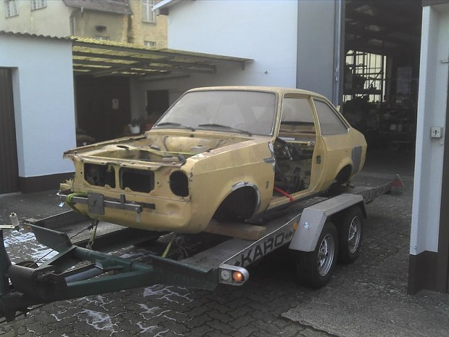

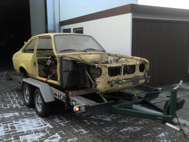

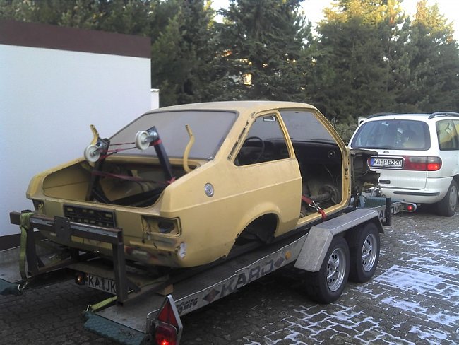

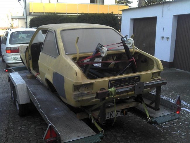

                  We bought a new/ old shell
                  nearly a complet car. it´s a 75 1.3.

                  • robrs2
                    • 2406
                    #39
                    That looks to be in good condition
                    • M11rf
                      • Apr 2004
                      • 4346
                      #40
                      What is the plan for it? Use all the 4 door bits on it? Or use the bits off this one for the 4 door?
                      • max0815
                        • Aug 2011
                        • 676
                        #41
                        the body is pretty solid. we have all the rusty parts as new panels.
                        The plan is building the 2 door shell as new racecar. Building the shell up over the year and put all the spares from the 4 door in it at the season end.

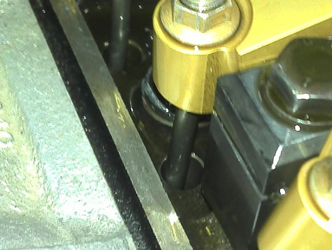

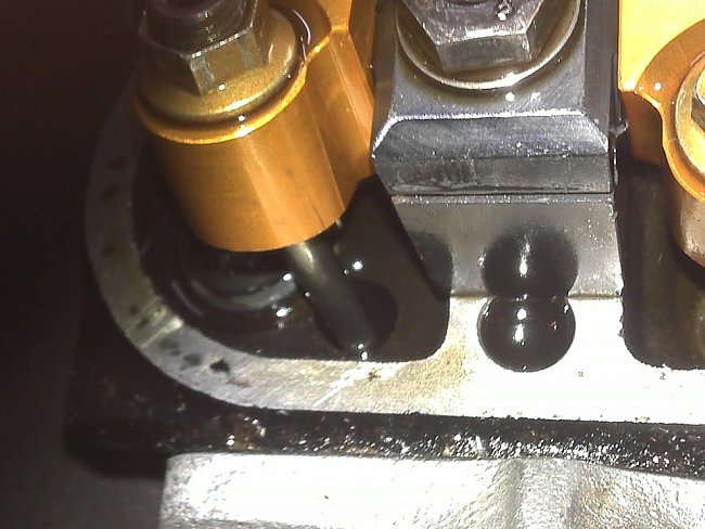

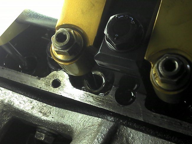

                            Today we had everything we need and all the stuff done. So we started the engine. Nothing happend fuel was there, had a spark etc. So we checked a few things on the engine. So we liftet the engine cover checked the timing and the valve adjustment. And look what I saw:
                            the pushrods hit the hole
                            I think we need another engine builder
                            • Hoogi
                              • Jul 2008
                              • 1590
                              #44
                              At first glance it looks like the rocker arms are in the wrong position...............but I know next to nothing about X-Flow Engines.

                                #45
                                We tried a few things with a orginal roller cam the pushrods are correct. The one we have fitted is from burton power. Standart lift.
