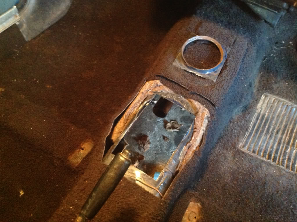

    Re: four door mk2 road rally project
    Cut out gear lever hole today got to move it back 70mm will weld it back in and plate in front

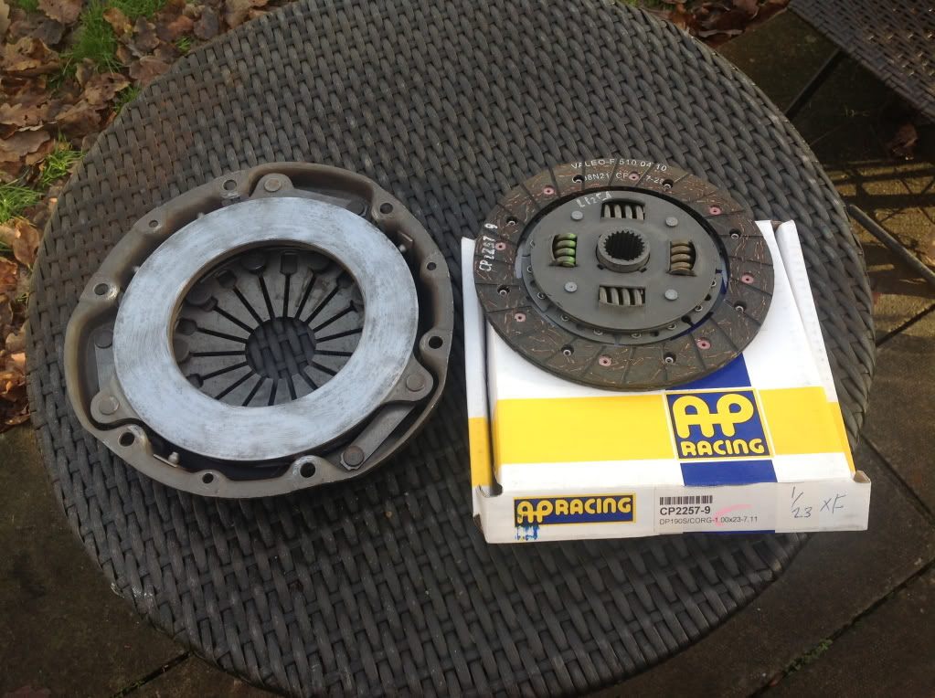

      Went to r.a.c.e today mick sorted me out with a pressure plate,fitted it been trying to get box back on going to have to drop crossmember I think

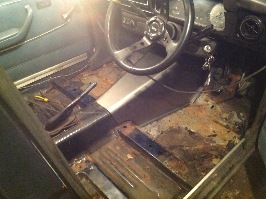

          #19
          Took carpet out very pleased with floors only a bit of rot at the side of the foot wells original floors 33 years old tried the big tunnel in place have trimmed heater plastic at bottom time to cut a big hole now!

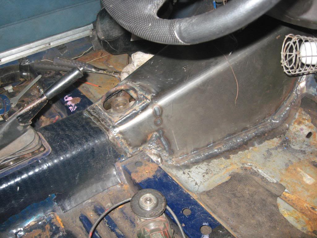

            #20
            All welded in now just need to sort out the crossmember mounts

              #21
              Drilled out the spot welds on the heater bulge found a bit of rot knew it was holed

                #22
                Fair play your tunnel went much better than mine I couldn't mate mine up to the original tunnel because it had been butchered before so i will have to fab that piece up. And the welding on mine isn't too clever.

                  #23
                  Yours looks fine mate, mine would have been easier if it had a flange all the way round like the one pictured on plr website!

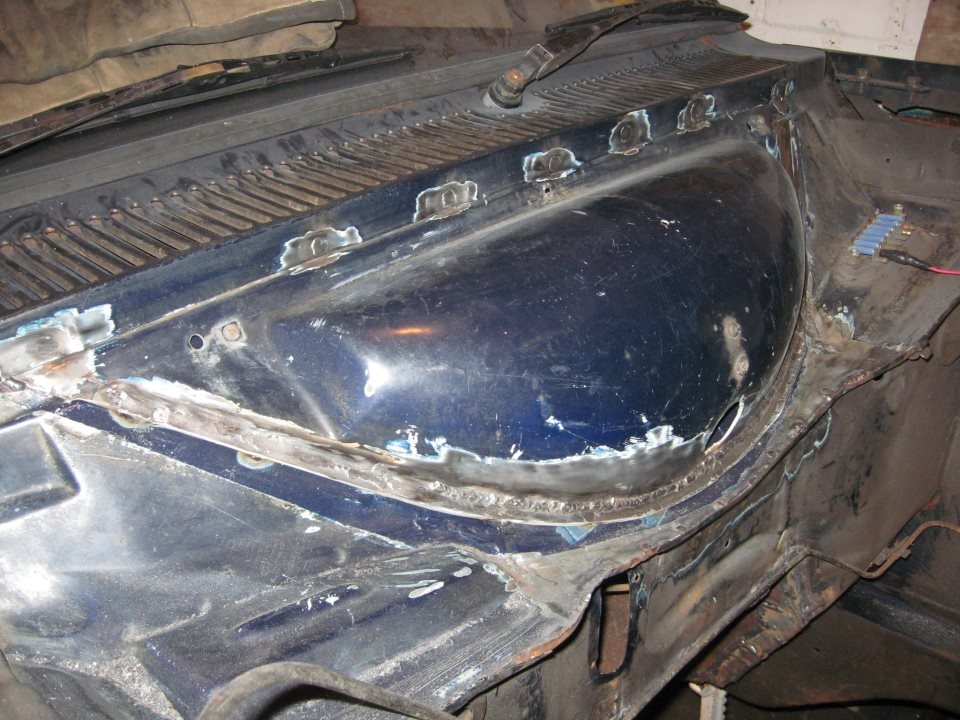

                    Made a start repaired the top of the vertical bulkhead and welded in the repair panel
                    • danknight72

                      #25
                      Then repaired the bits under the edge of the bowl

                              #29
                              Bulkhead and heater bowl done just needs a little bit of filler
