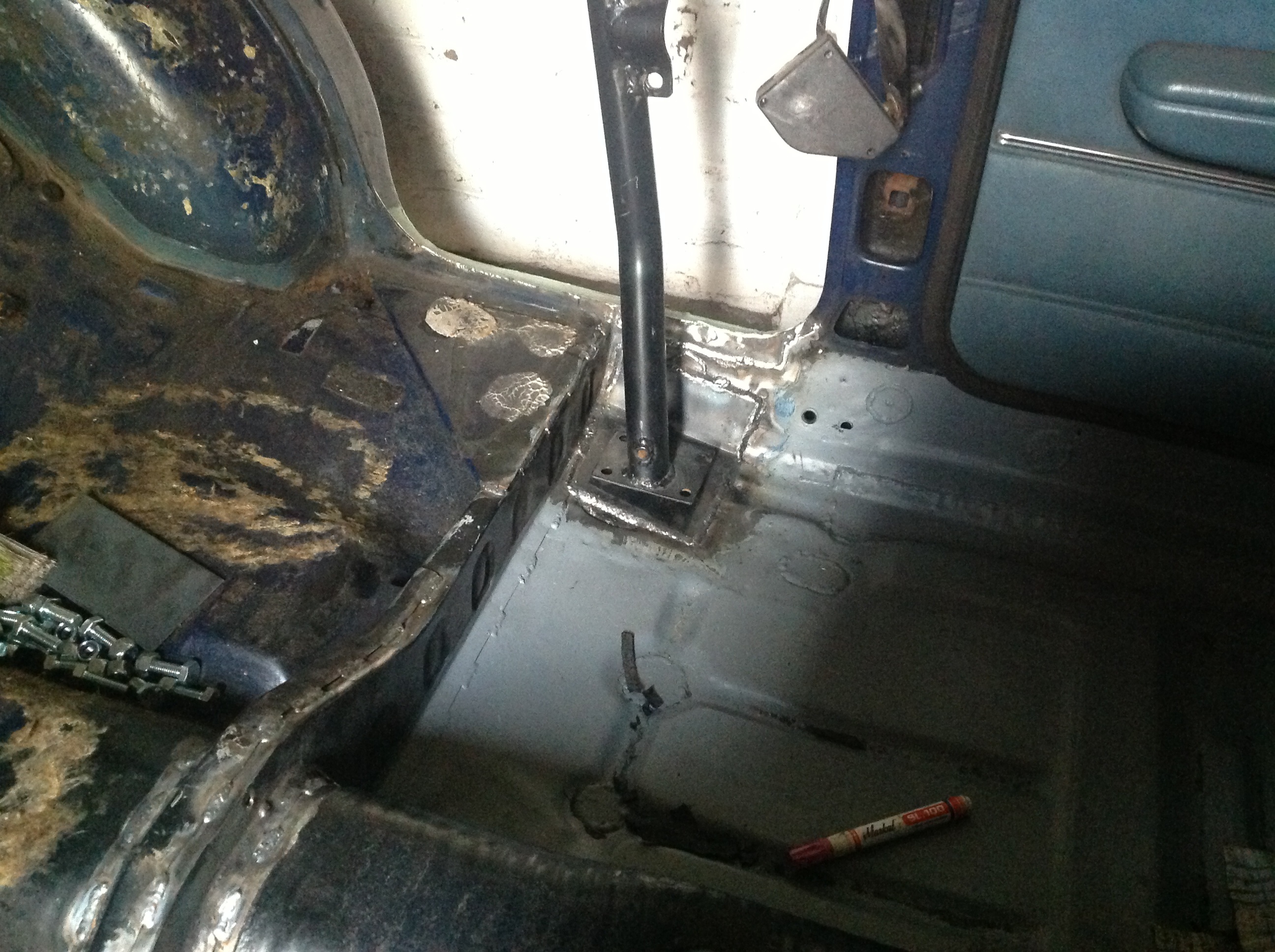

    Made some oversize floorpan plates for the roll cage and welded them in

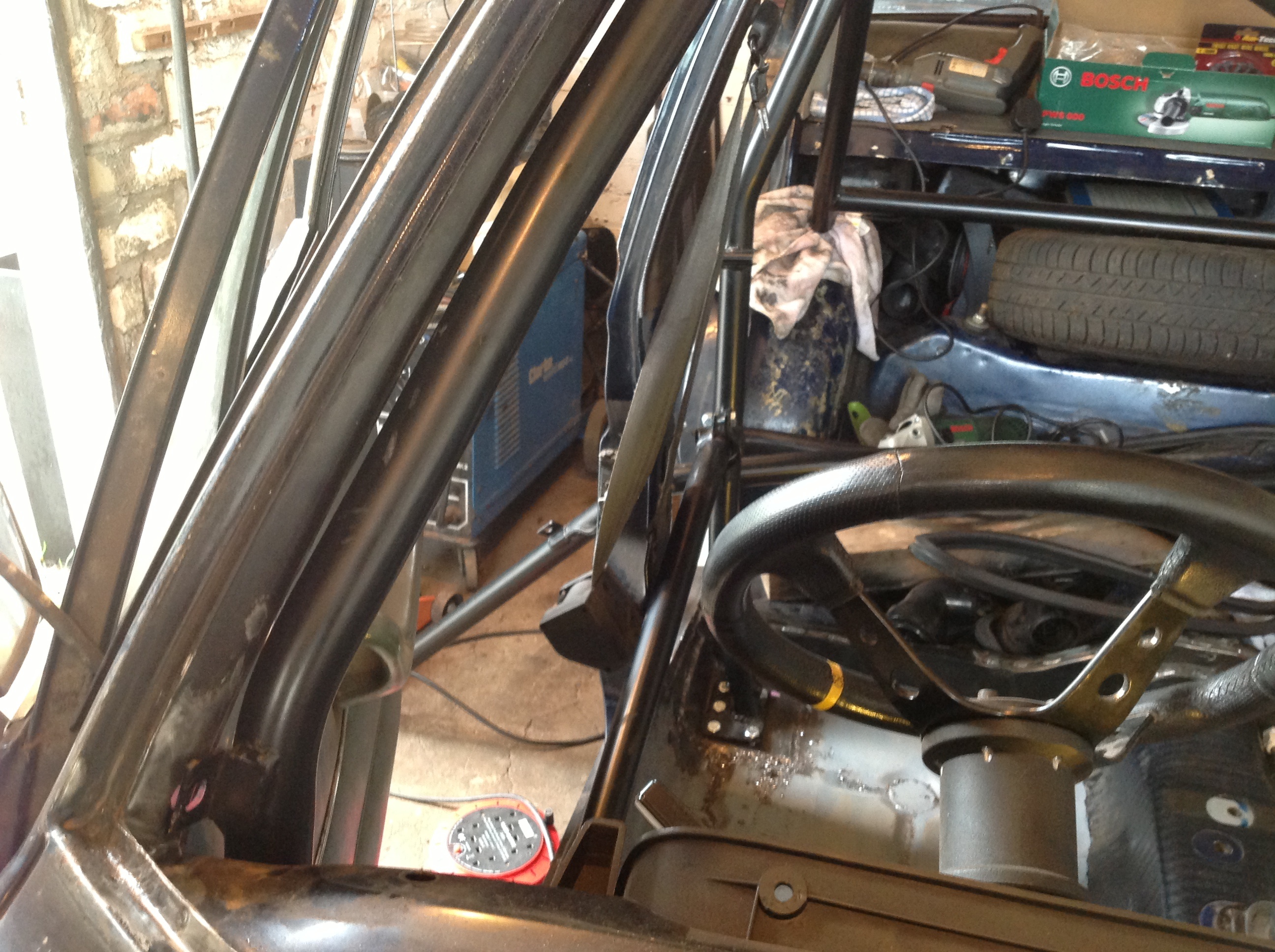

      Re: four door mk2 road rally project
      Been getting the cage multi points ready for welding its a nice tight fit

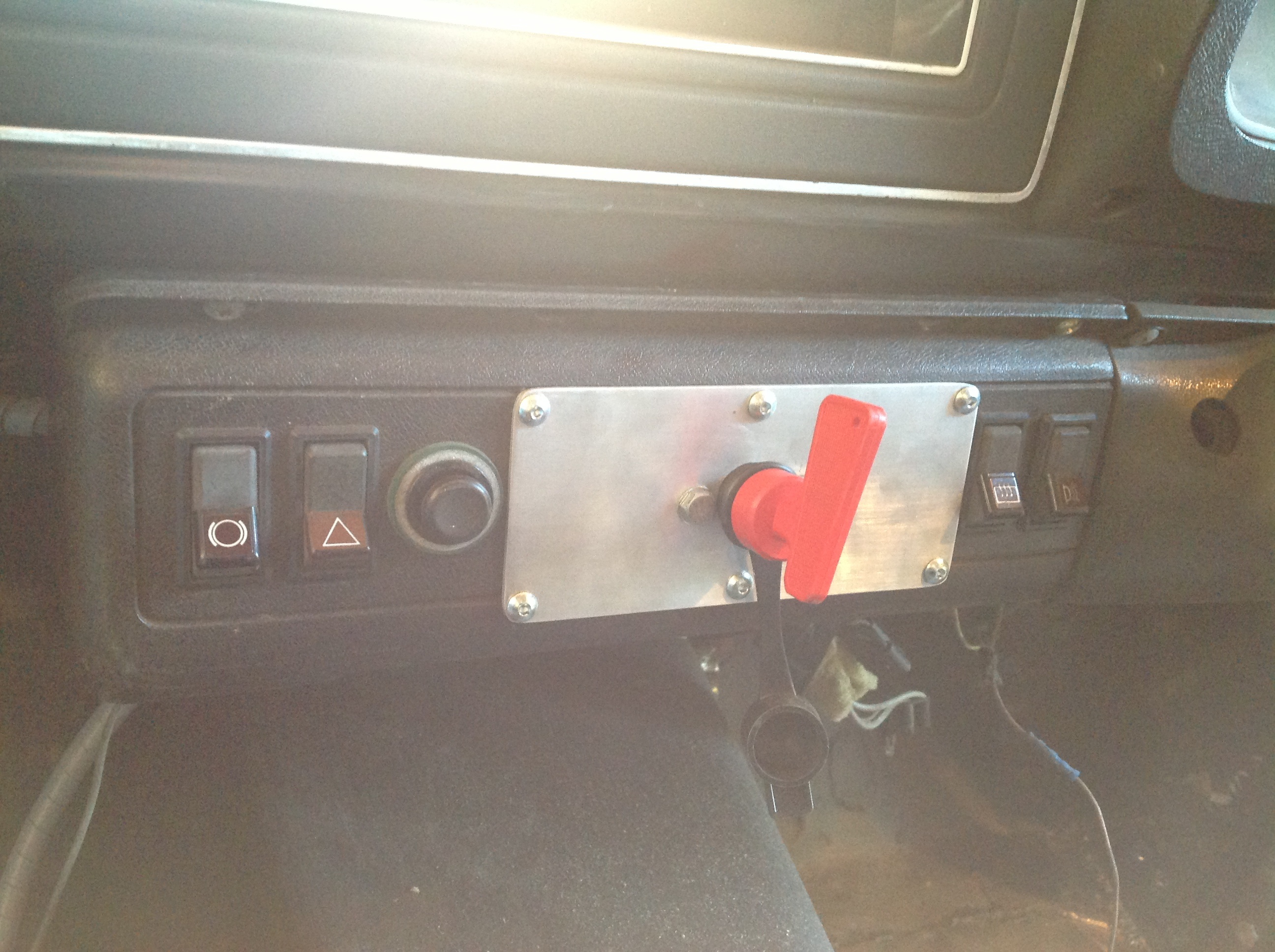

        #63
        Battery cable from boot to master switch then to starter, switch mounted where ashtray was

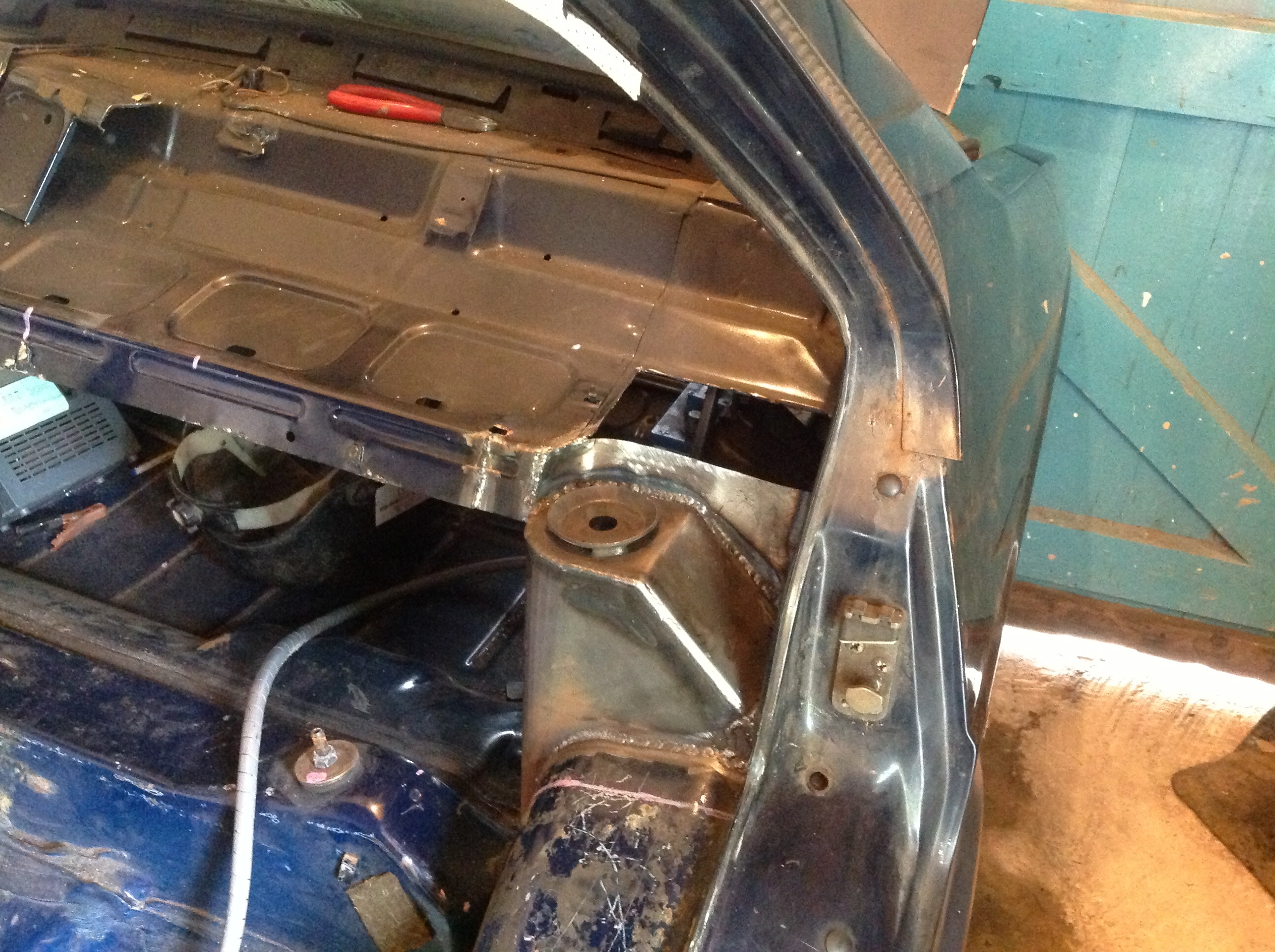

          Made a start on round turrets looking good so far
              Filled in around turret just got to do on top

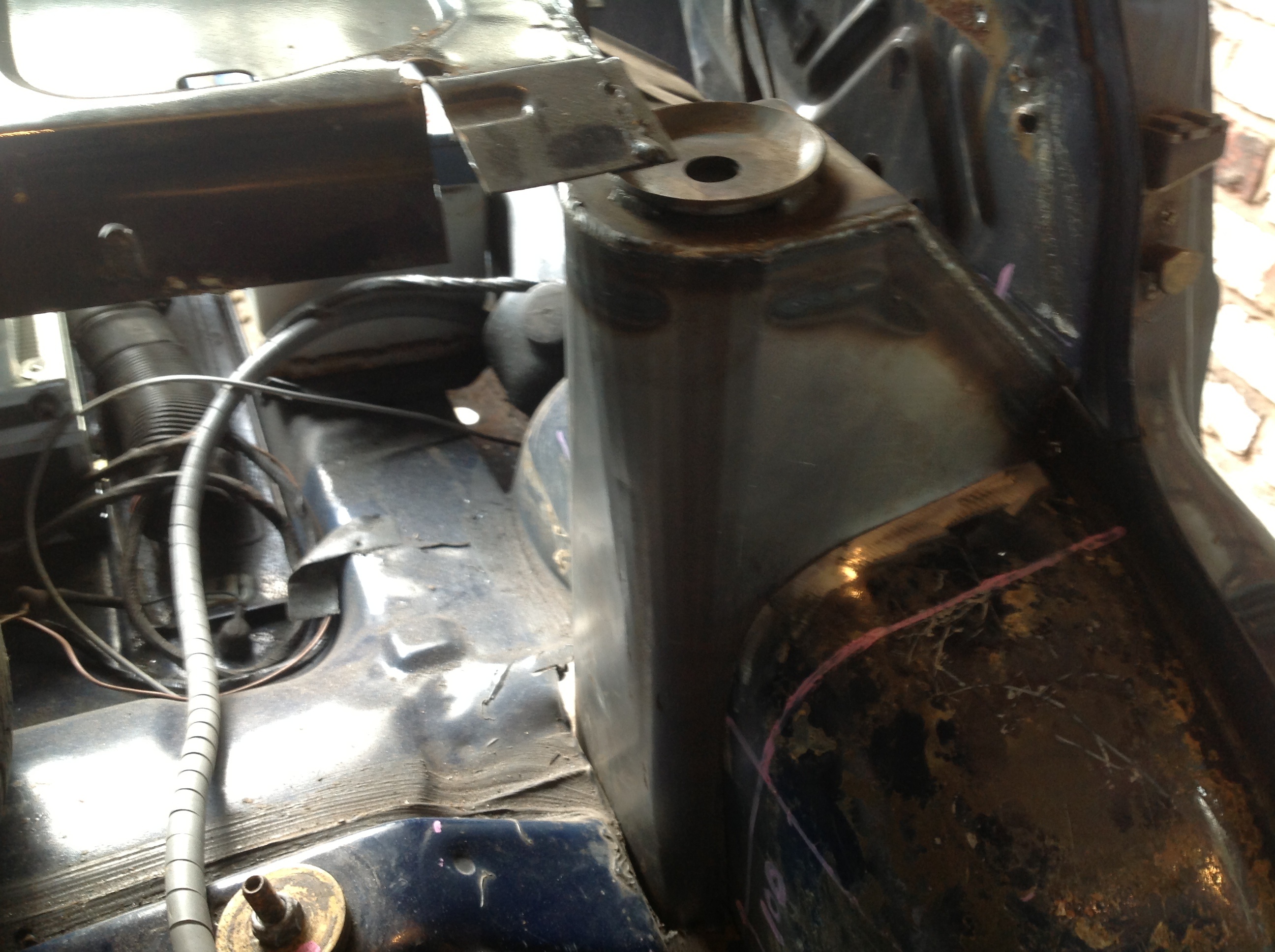

                #67

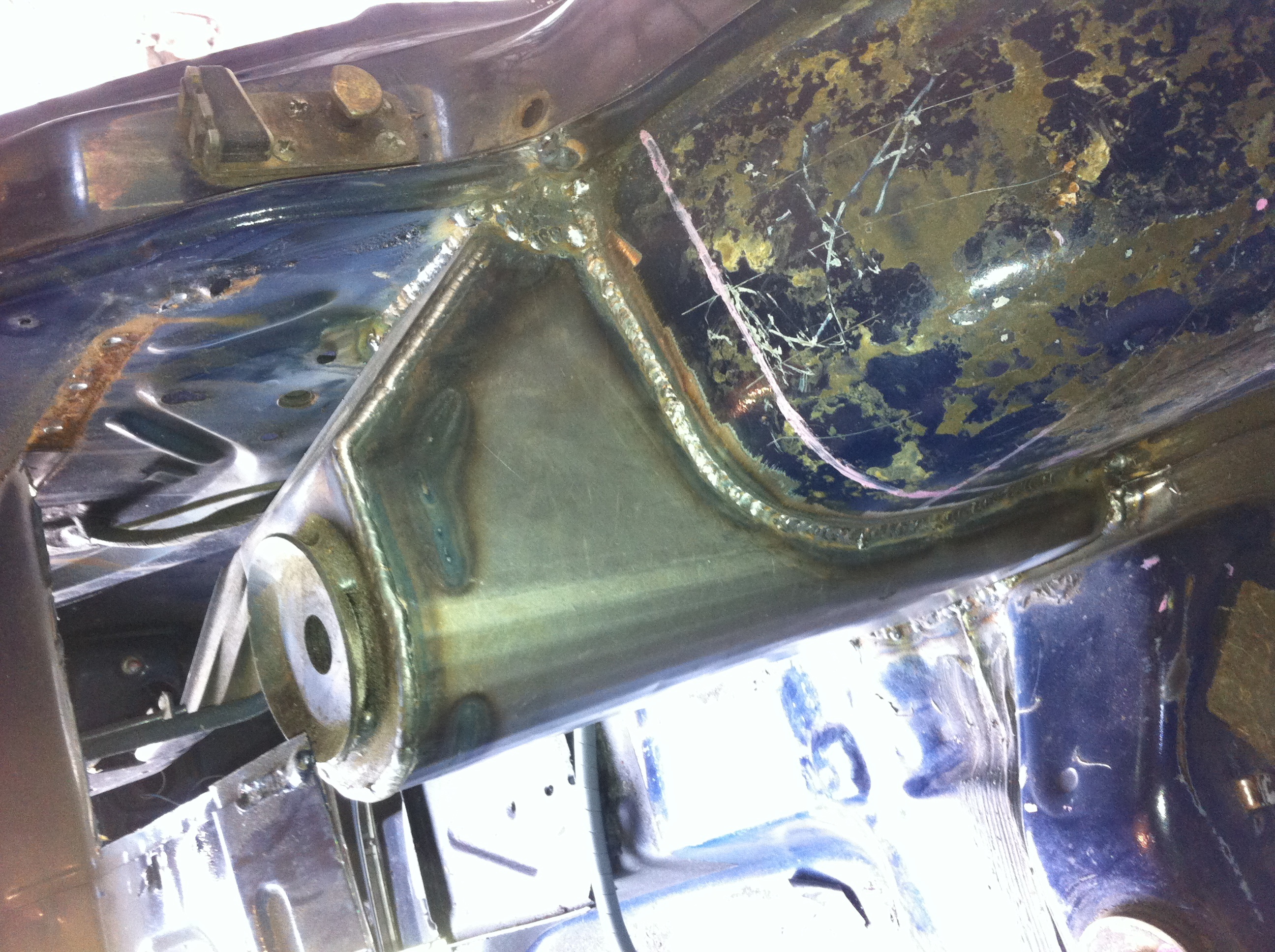

                Turrets all finished firewall and parcel tray done

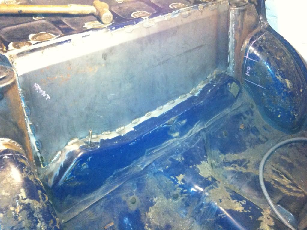

                  #68
                  • danknight72
                    • Nov 2011
                    • 584

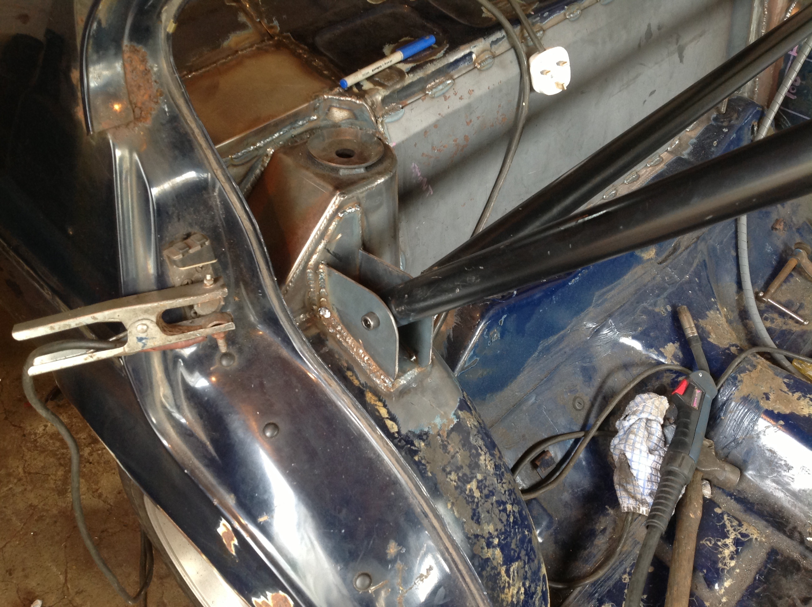

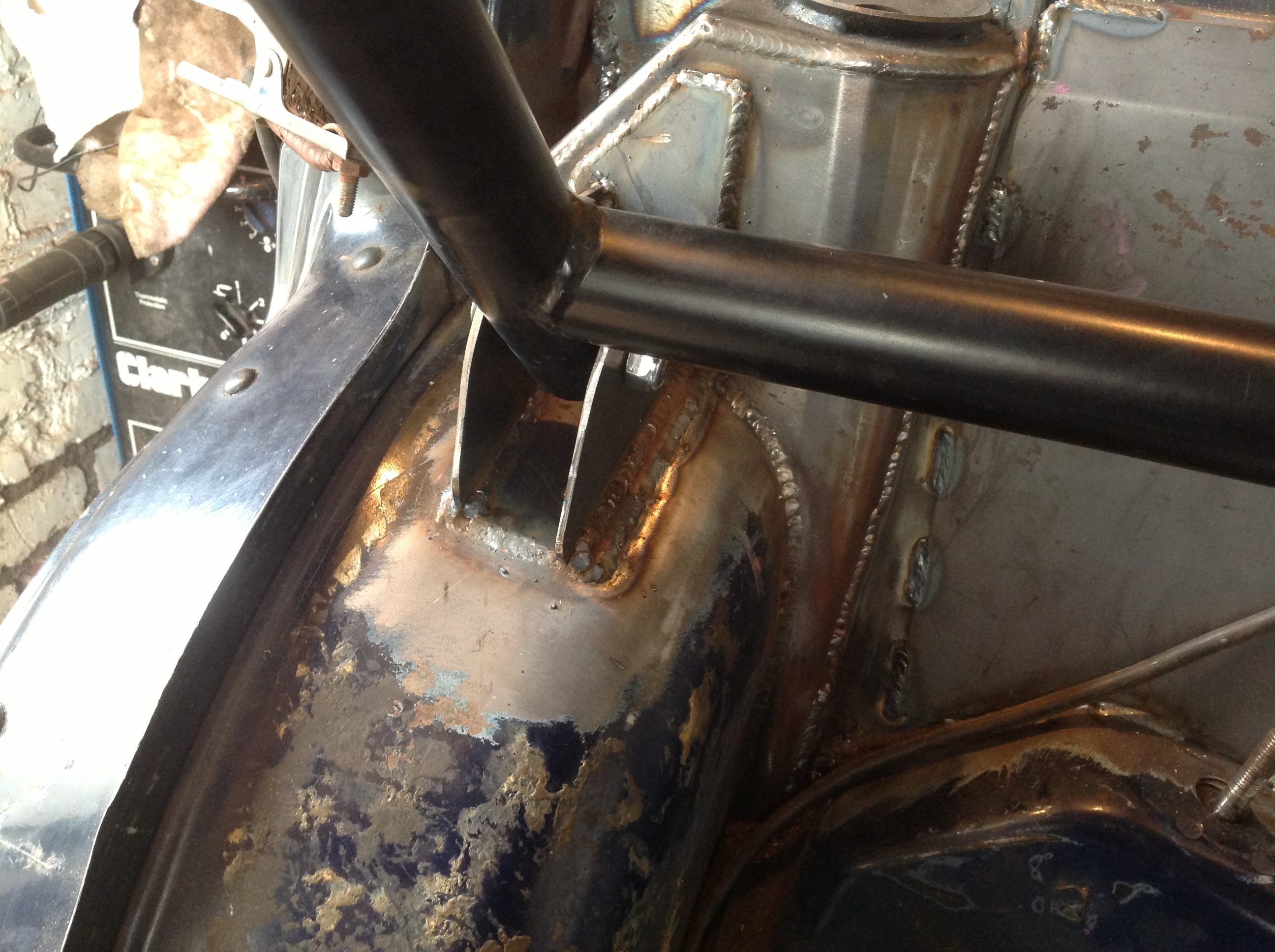

                    Made turret mounts for cage

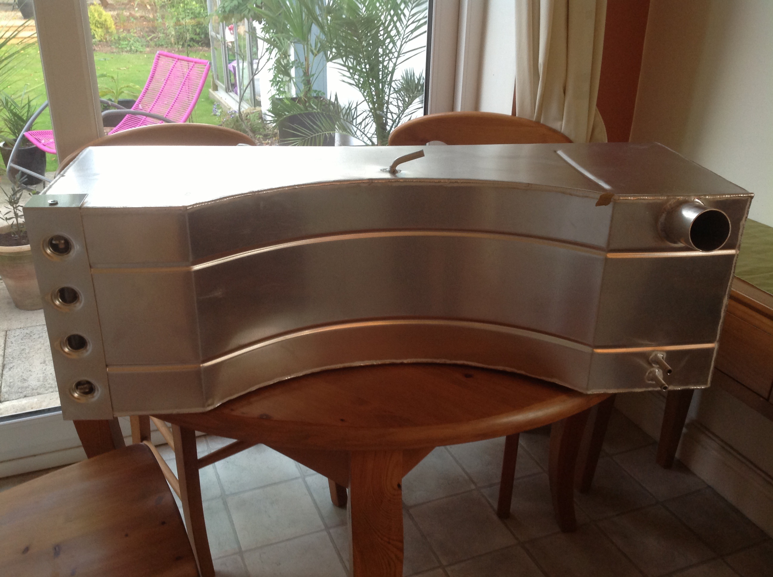

                      New tank arrived need to crack on and get base fitted

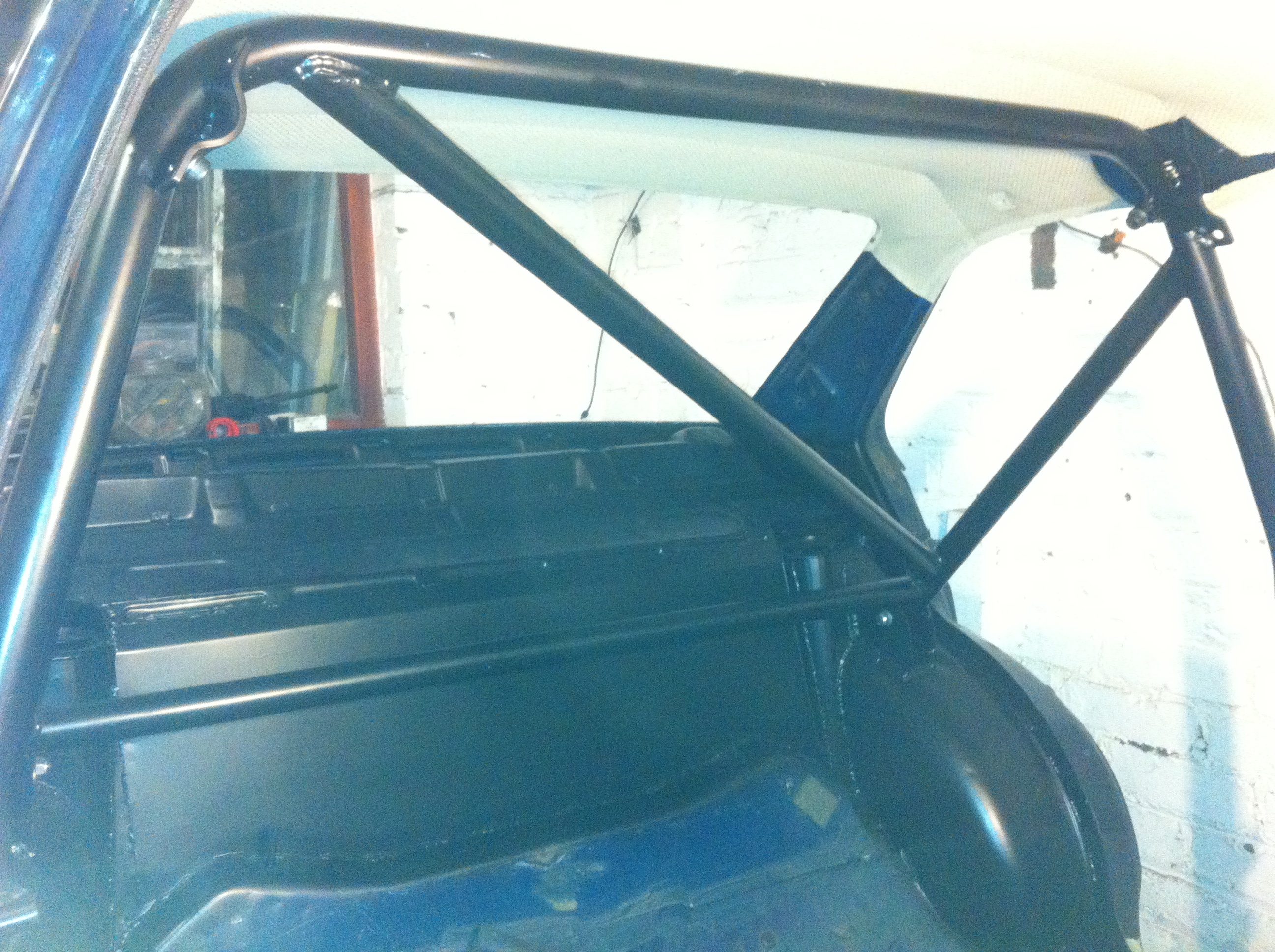

                          #72

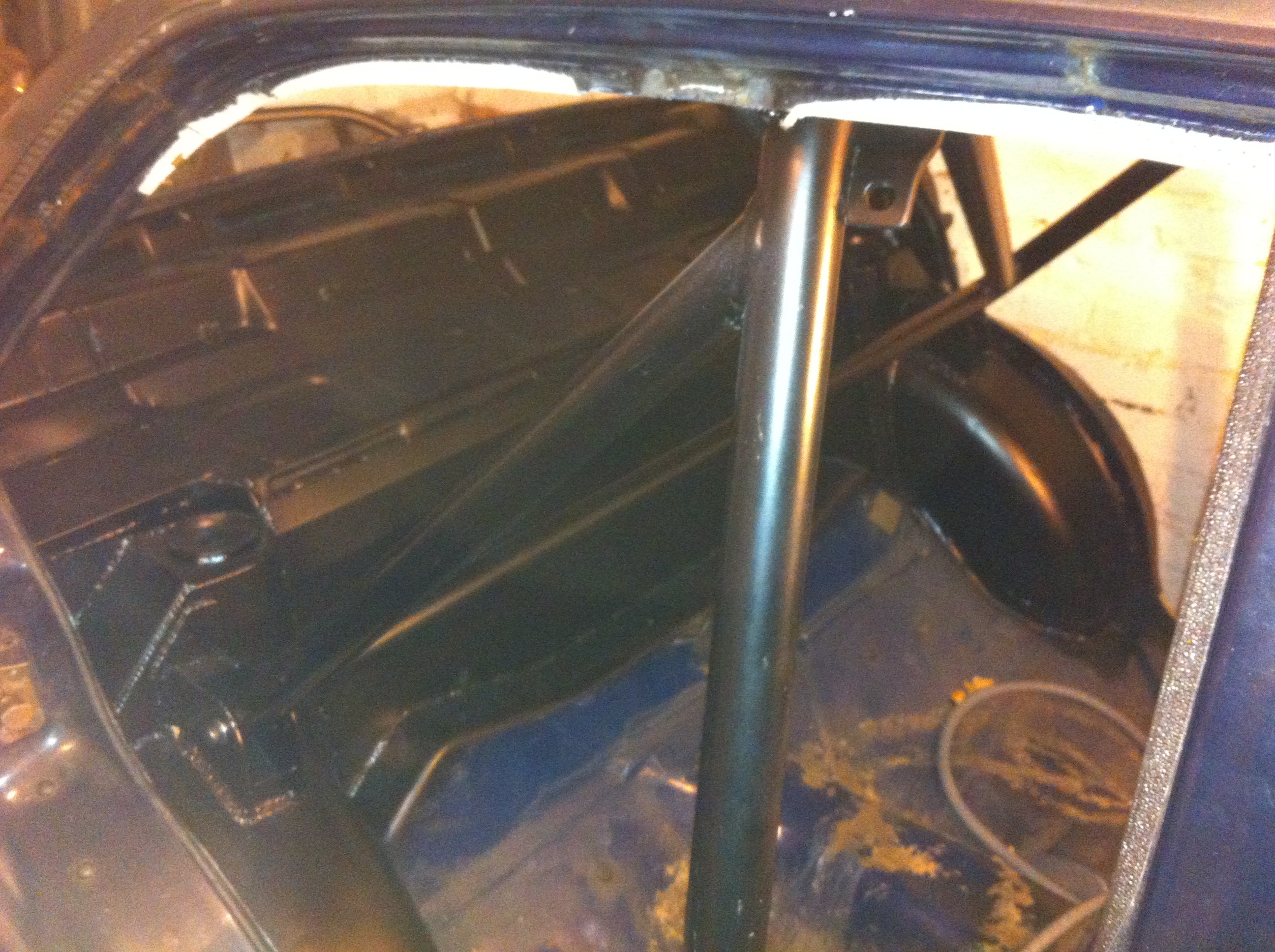

                          Fitted rear cage hopefully for the last time

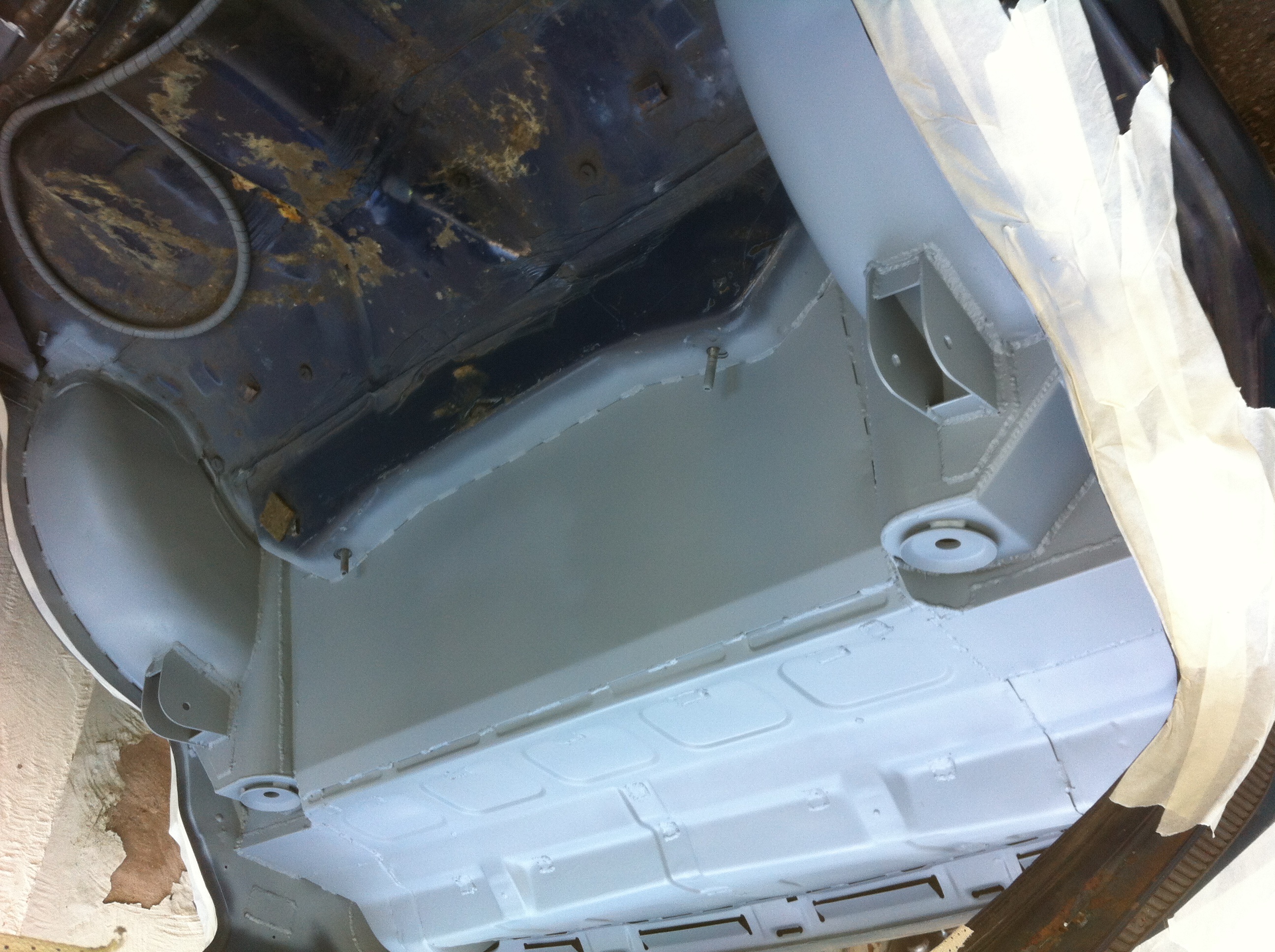

                            #73
                            Tank stand welded in, when its painted can mount tank and run fuel lines

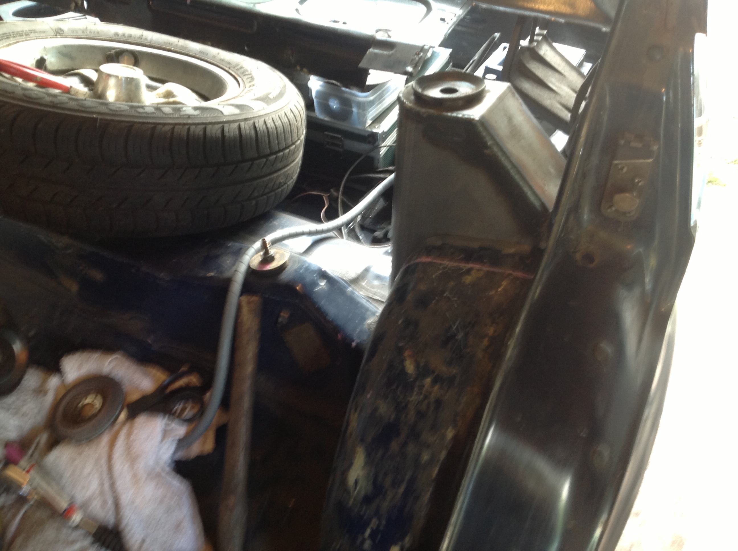

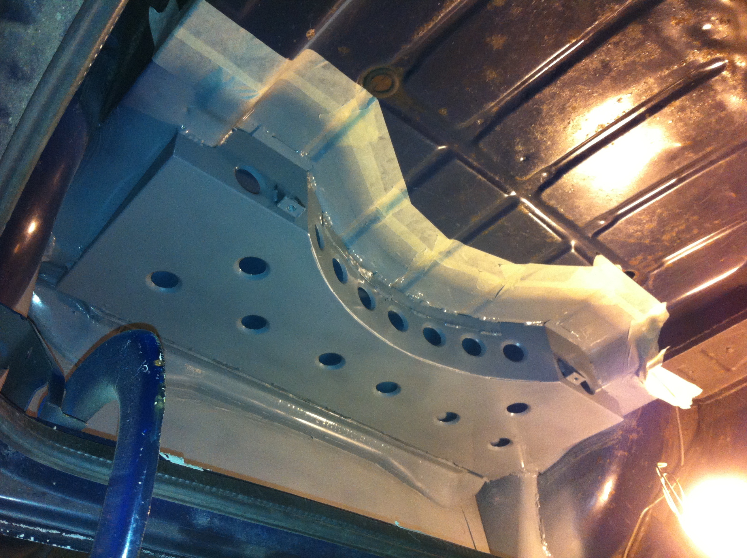

                              #74

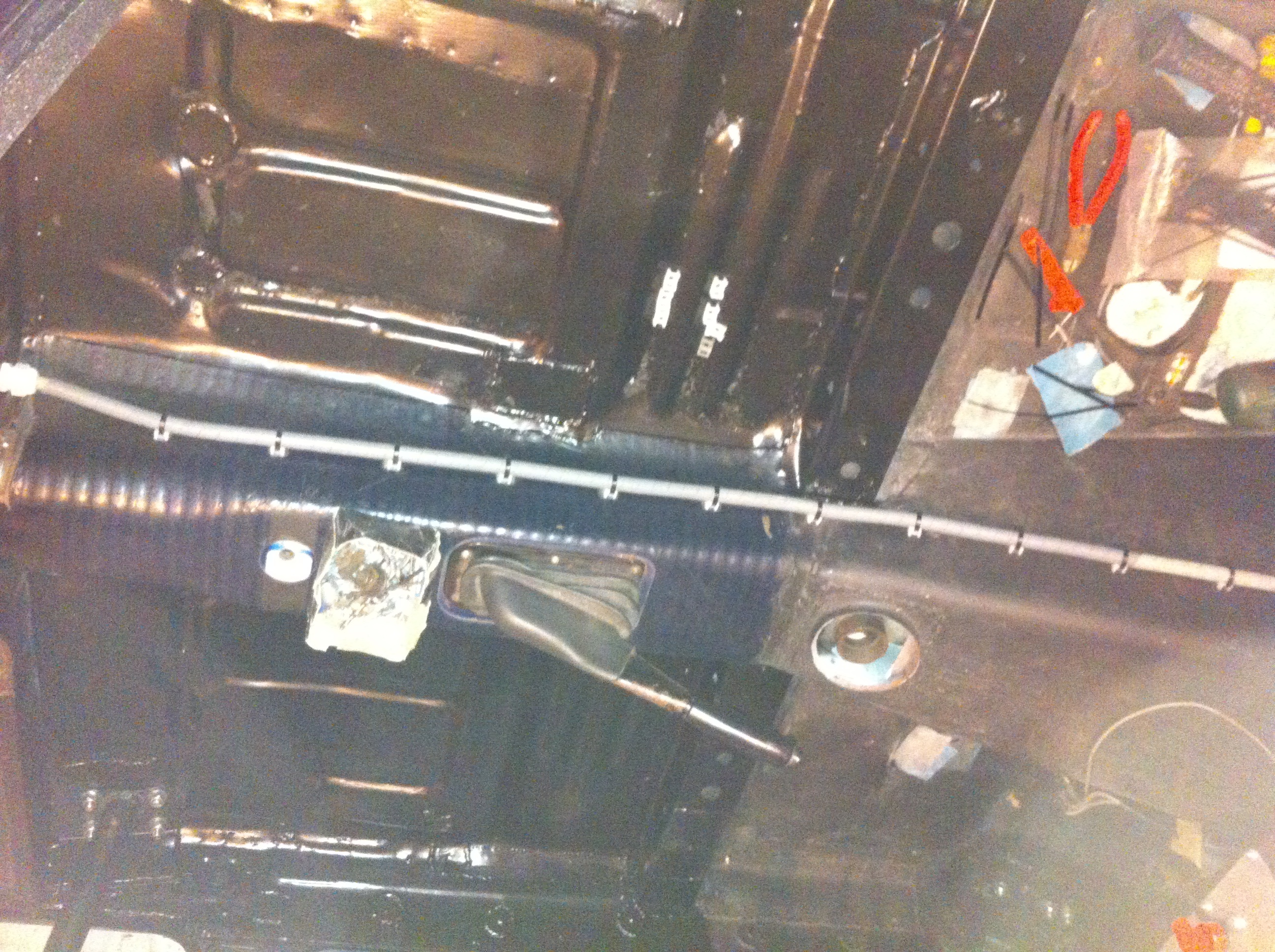

                              Ran battery cable and clipped it to floor
