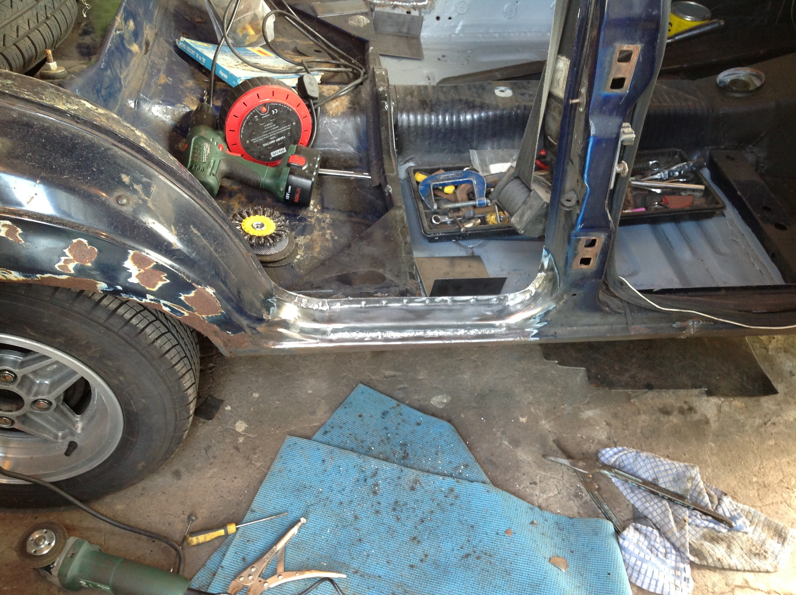

          Re: four door mk2 road rally project
          Re fitted bonnet to set gap for welding drivers side wing on, had to repair front half of sill and inner sill

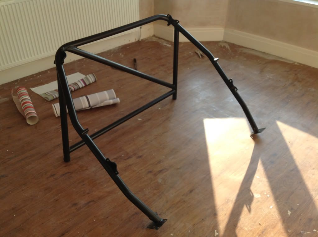

                      Picked up my roll cage today it's a 14 point turret mount safety devices
                      • danknight72
                        • Nov 2011
                        • 584

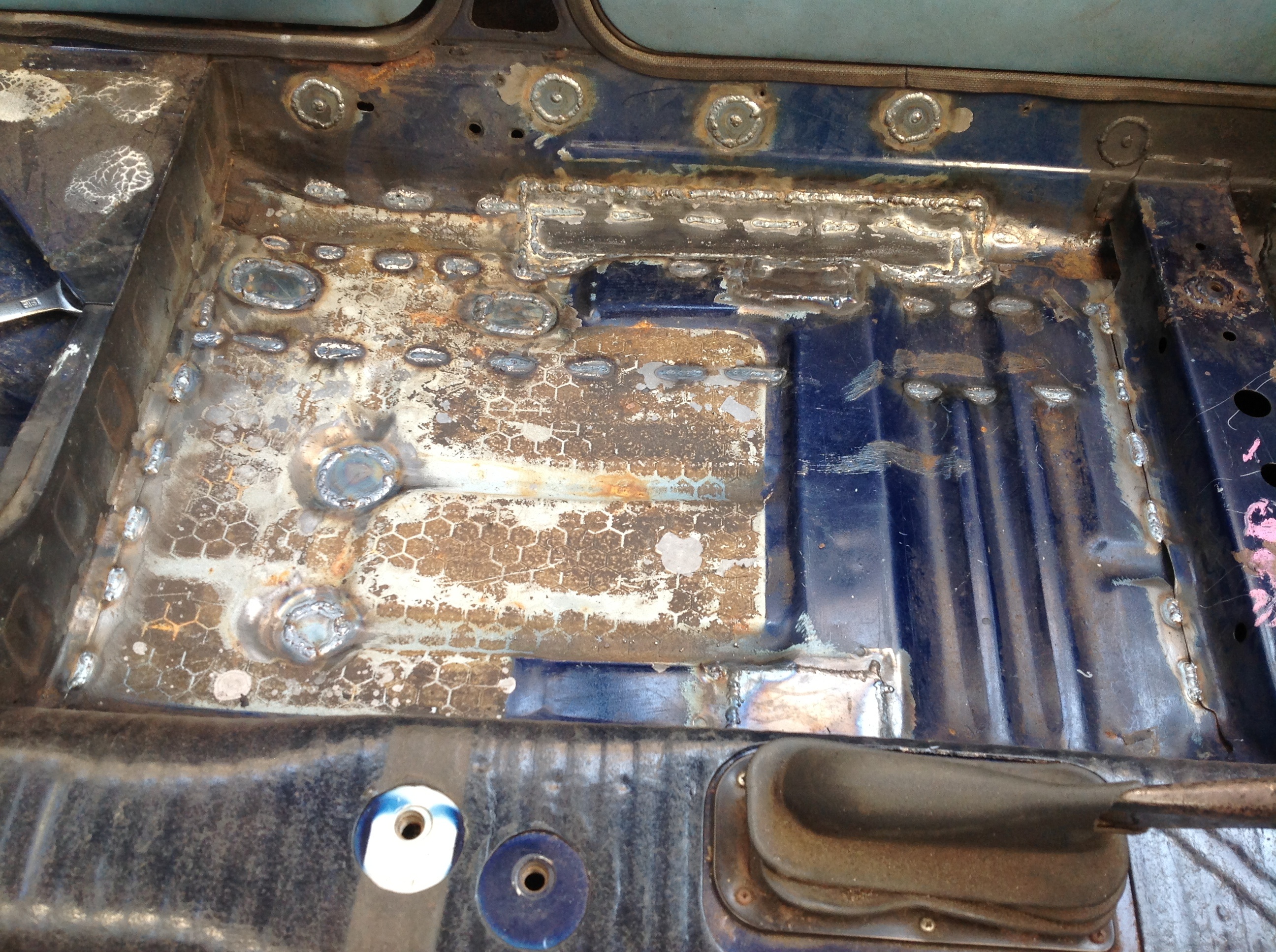

                          Have filled in drain holes and seam welded chassis rails to floors on both sides plus a little repair to the inner sill

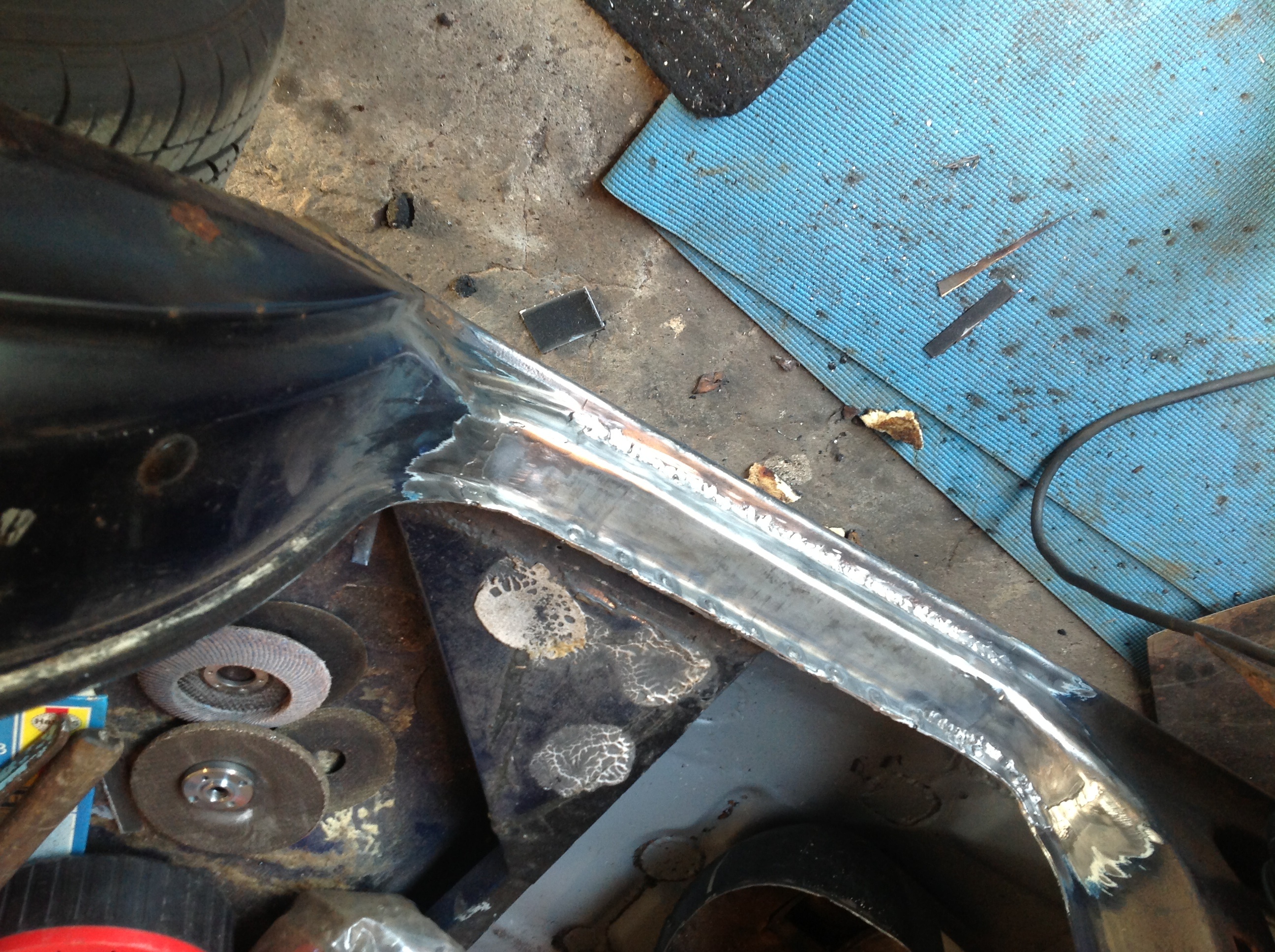

                              Repaired sill step under back door just need to do other side

                                #60
                                Other side done, trial fitted cage
