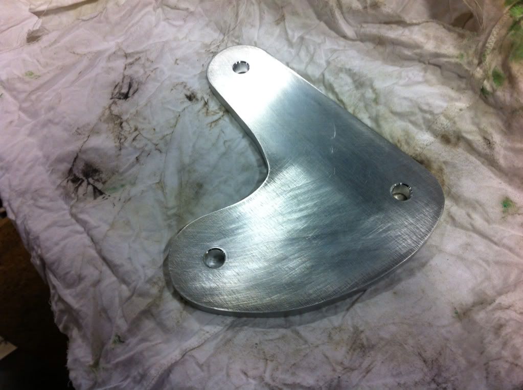

                Re: four door mk2 road rally project
                Fully assembled pedal box have used gen girling cylinders and fitted the dash adjuster, I am using banjos for the feeds to the front and rear. The front goes to a bulkhead mounted tee piece then through the bulkhead and down the spring pan rails.
                Mounted the bottles on a alloy bracket I machined, have space for an extra cylinder if I go hydraulic clutch

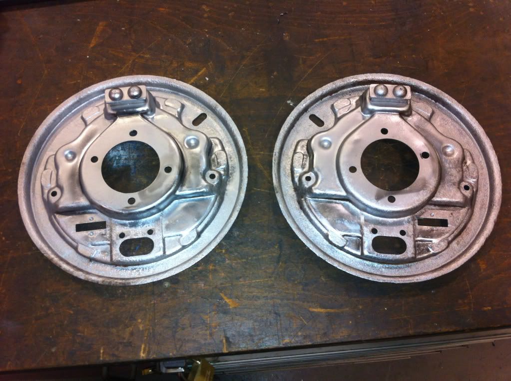

                  #98
                  Got a pair of 2.8i rear brakes cheap so
                  Stripped them and shot blasted them. Going fit new cylinders as they are only 7.50 each

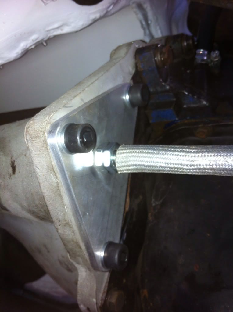

                    #99
                    Made a clutch cable bracket as I'm running a crossflow with an rs type alloy bellhousing. I'm using a long rs2000 clutch cable that came ready with heat shield from rally and competition equipment.
                    Tried the clutch and feels ok if a bit stiff

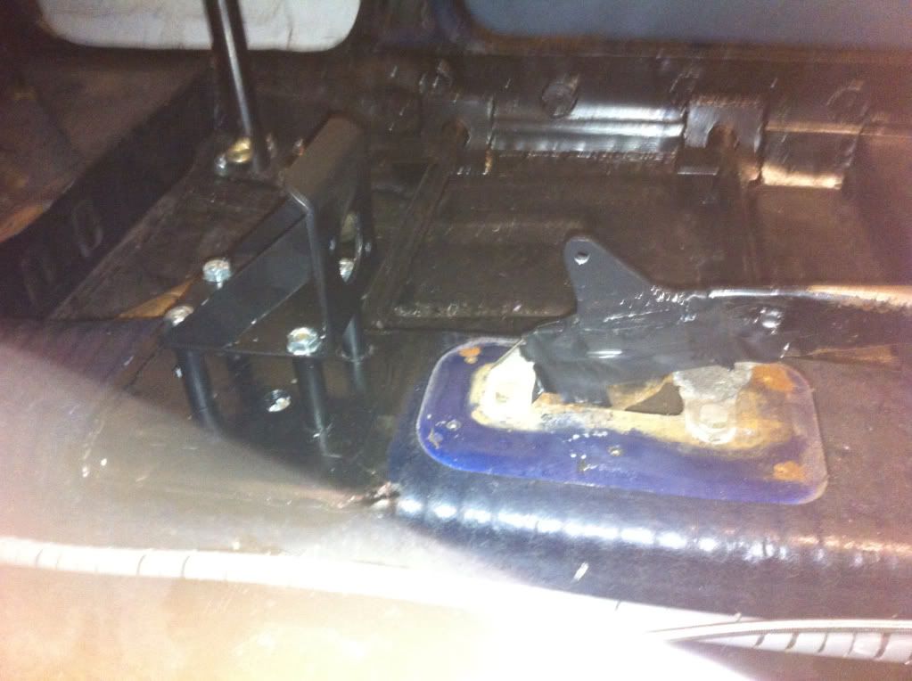

                      #100
                      Fitted handbrake bracket and modded handbrake lever

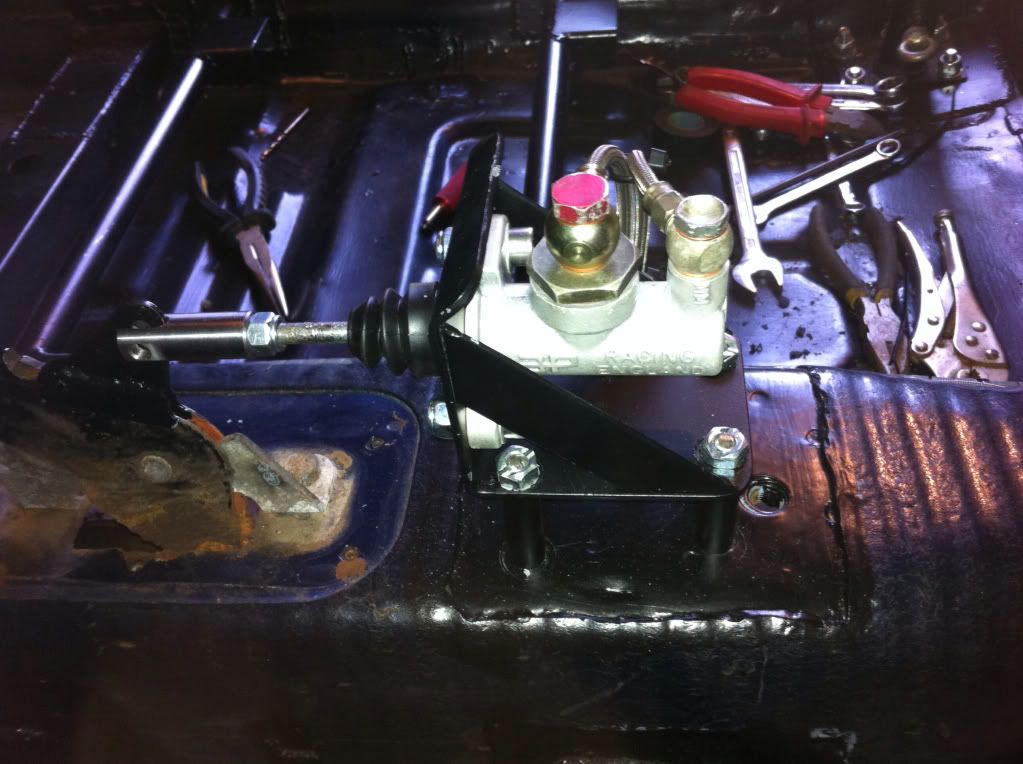

                        #101
                        I stripped the second hand ap master cylinder I had got cheap took it into work and cleaned it in the ultrasonic bath, came up well. I then fitted the seal kit i got from tweeks for 8 quid and mounted the cylinder. Fitted it to the bracket and attached the brake pipe with new copper washers.

                          #102
                          Your handbrake looks like it's plumbed in the wrong way round!.
                          • danknight72
                            • Nov 2011
                            • 584
                            #103
                            ap work the opposite way to girling with a m12 inlet at the front and a m10 outlet at the rear
