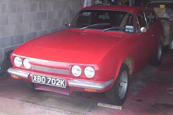

    As some of you know, I've spent 18 months turning a neglected 1971 Scimitar into something I could use for Historic Road Rally's
    Scimitar Restoration
    After a slightly rushed paint job, everything was ready for my first event last weekend...

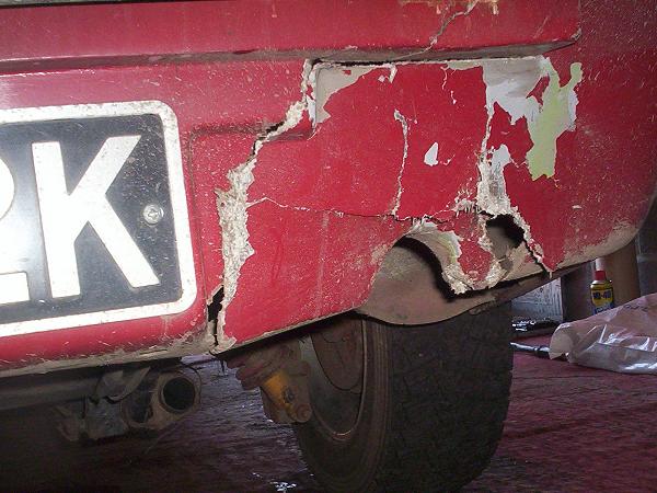

          When the exhaust came off, it damaged the rear valance, but luckily nothing fell off, so it was just a case of glassing it back together
          This is how it looked after the event, but it looks a lot better now and the rear silencer has been replaced thanks to a spare from a fellow Scimitar owner

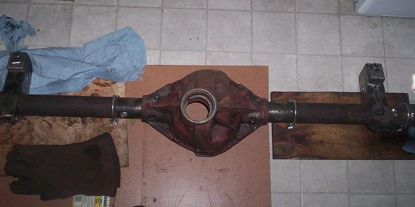

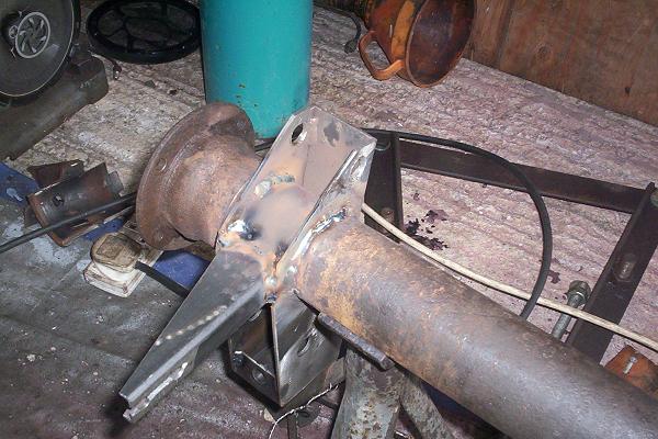

          As my next event is in 2 weeks, I've been back working on the axle again, cleaned up the other tube and cut the new brackets to shape

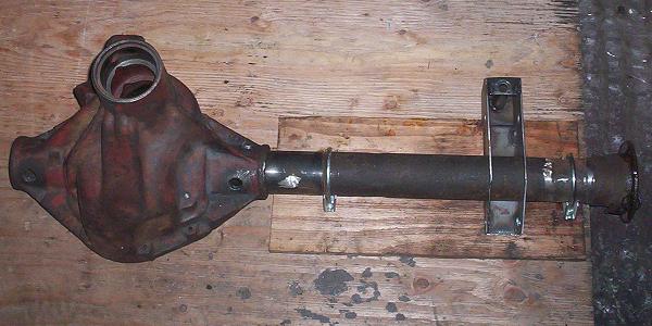

          With the help of some wood and exhaust clamps it was easy to line up the tubes and diff housing
          After some research on the web, it looked like the best method was to stick the housing in an oven and the tubes in a freezer before knocking them together. The housing just fitted in the oven, but the tubes didn't fit in the freezer and after heating the housing it was still very hard to knock the tubes in so once they were in about an inch I left it at that, not wanting to distort the housing
          Today with the help of an old pulley, a very large socket and lots of extension bars, I managed to support the bearing face through the other tube while I used a FBH to knock the tubes in. It took about 3 hours but they're both in the right distance and very solid. Tomorrow's job is to plug weld the tubes and also weld the brackets in the right place before trial fitting the diff...

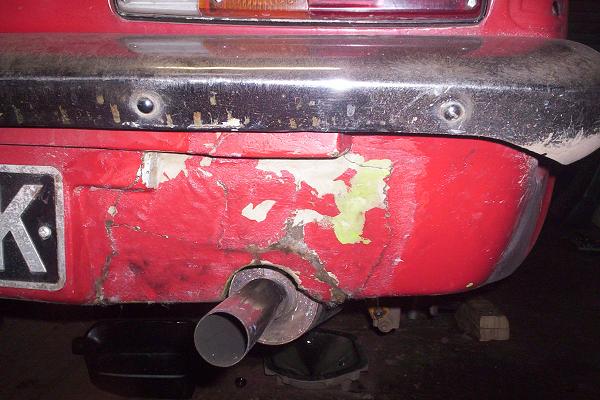

                Rear valance glassed up

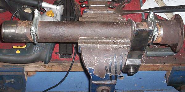

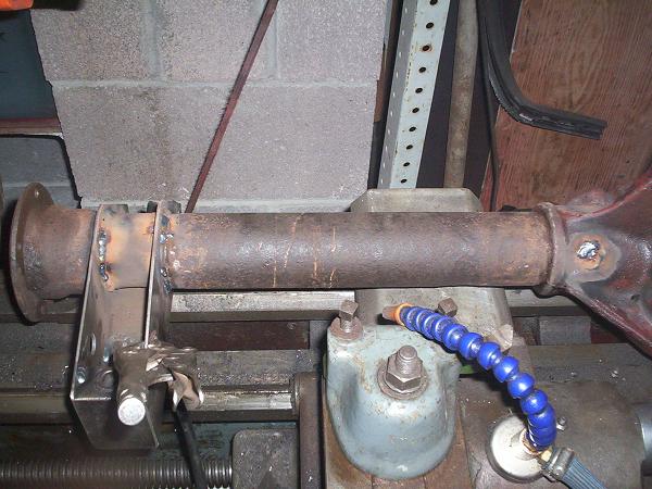

                Used the lathe bed to line up the brackets before welding them in place and plug welding the tubes

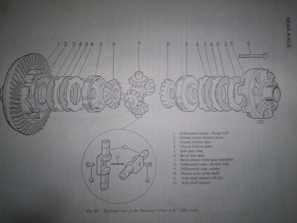

                So that's what a Thornton "Powr-Lok" diff looks like inside - slightly different to a ZF LSD (which I run in the Escorts) as the bevel gears and the side gear ring are separate, and also there's an axle shaft spacer in the middle as the shafts run in taper bearings so need a certain amount of end float
                Nearly forgot to make some handbrake cable brackets
                Now it's all done and fitted and seemed to work on the test drive last night, I've no idea if the CWP mesh is correct but it seems quiet enough at the moment and the acceleration is definitely better (the original diff was 3.31 and the Jag one is 3.77 ) The LSD plates were replaced with new ones so it's a bit tight but that should help on the tighter tests. I've also fitted some Mintex Competition brake shoes to try and improve the handbrake but it hasn't made much difference.

                    Hi - unfortunately hydraulic handbrakes are banned. I think the problem is the angle of the brackets not lining up with the handbrake lever in the back plate. I'll have to cut off the brackets and start again but that's a job for the next event. This one I'll just have to boot it round on the diff
