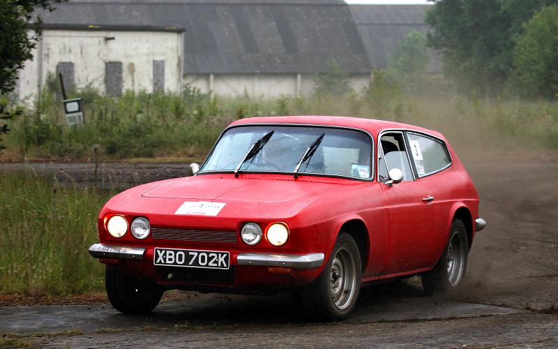

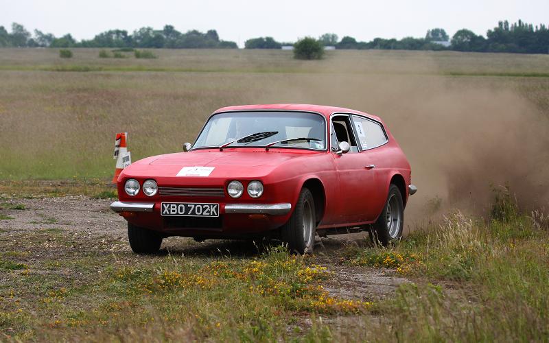

    Pic from Andy Manston - there's a cone just out of sight on the left and George is pointing to the next one!

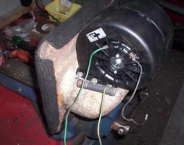

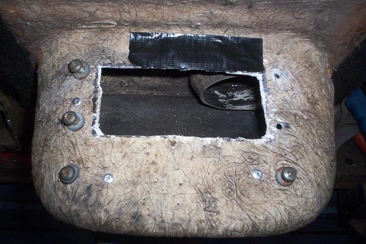

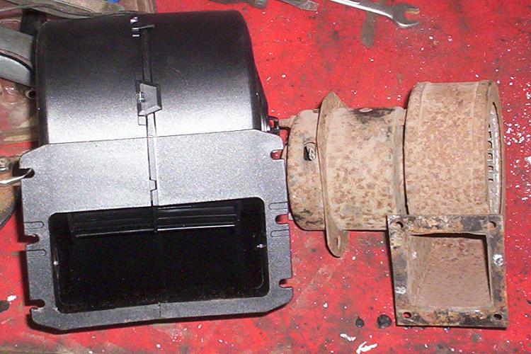

                    Before then I had a few jobs to do including sorting out the demisting, a loose wheel bearing and a spongy brake pedal
                    The original demisting fans (one in each footwell) never worked so I'd fitted some small blowers but they weren't powerful enough to demist, so this time I bought a pair of the largest ones I could fit
                    Cut a bigger hole and riveted some captive nuts to the fibreglass housing
                    Then re-used the original resistors to make them 2 speed
                    I haven't been out in the rain yet but I'm sure they will be fine
