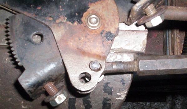

            I had some spare time last weekend so thought I'd start by removing the handbrake lever and cables
            The cables moved reasonably freely but are well greased now so they slide even better - they are a good design with a grease nipple half way down the outer casing
            Looking at the lever itself, there are 2 holes for the cable adjuster and I've been using the bottom one, changing this to the upper one should give more leverage but I will reinforce the hole with some washers first as it's a bit close to the edge and already worn

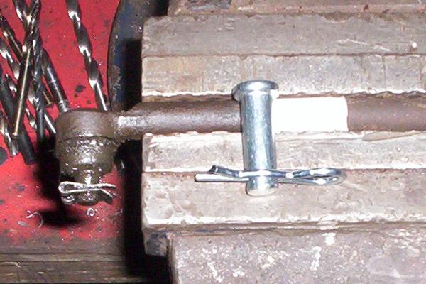

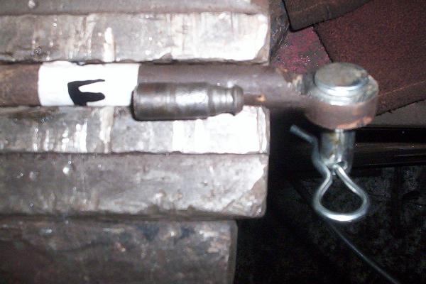

            I also removed the gear linkage rod and discovered the pins were too hard to drill into, so I ordered some 3/8" x 1.1/4" clevis pins off eBay which arrived yesterday
            This is the current arrangement that proved unreliable and the new pin alongside
            The original pins are welded in from the outside, but after grinding off the welds I could knock them out. I then enlarged the holes to just under 3/8" and hammered in the new pins. I was going to weld it in place but I don't think it needs it as it is a good tight fit. Next job is to machine some more nylon bushes and it can go back together

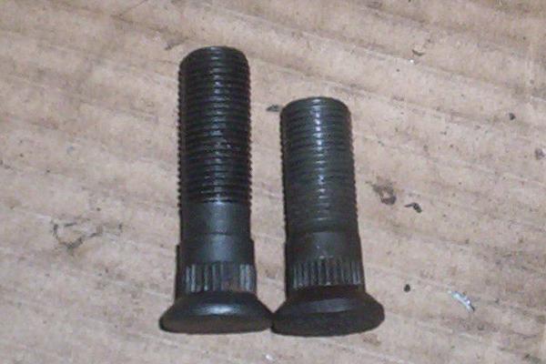

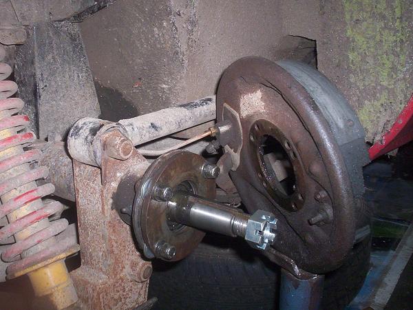

                    I'd bought new longer rear studs last summer, but had been unable to fit them as the rear hubs are very difficult to remove from the axle shafts. Eventually, after borrowing a 12 ton hydraulic puller, I got them off and also removed the hubs from 2 spare shafts while I had the chance. Because of the forces involved, the thread on the end of the shaft can get damaged so I put them in the lathe to rethread them, only to discover the drivers side shaft was very slightly out of true
                    By eye, it looks dead straight, but it seemed sensible to fit a spare one. While I had everything apart, I fitted new wheel bearings and set up the endfloat to 5 thou, something which is also a lot easier with the hubs off which allows the back plates to be removed and the shims replaced as required

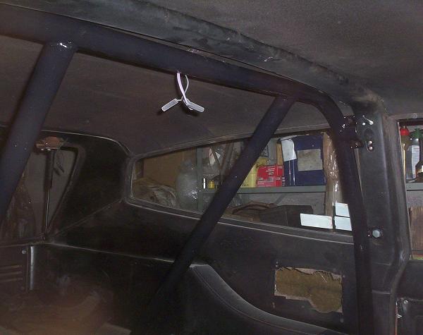

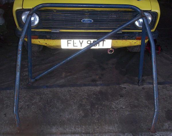

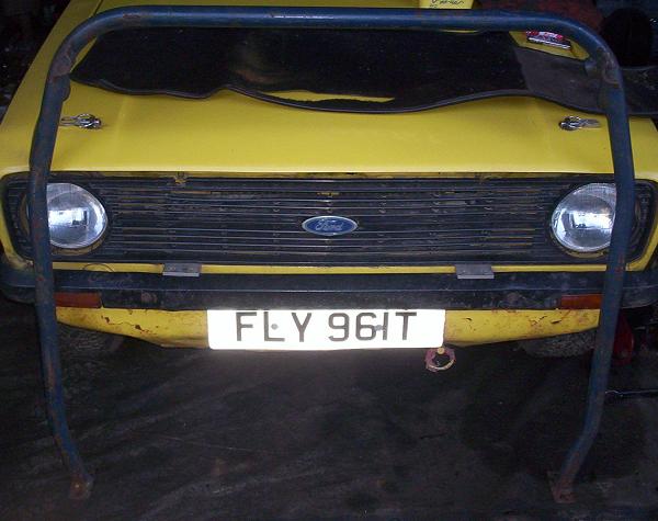

                    I also wanted to fit a roll cage for added safety, but you cannot buy a Scimitar cage off the shelf and after receiving a few quotes of around £1k just for a rear cage, it was time for some lateral thinking
                    After some careful measuring, a search on eBay and a trip to South Wales, I ended up with an old Safety Devices rear cage for a Mk1 Escort for £75
                    The paint wasn't good, even the diagonal was welded on the wrong way, but perfectly solid

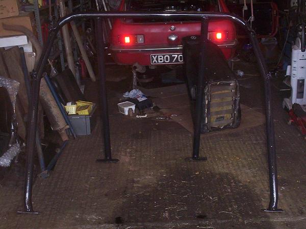

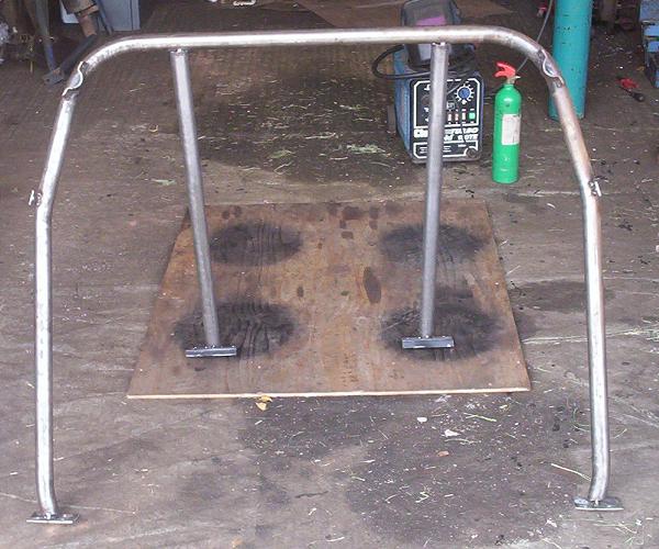

                    First job was to remove all unnecessary bars such as the rear stays and the diagonal, leaving the main hoop
                    Remove all old paint, shorten the legs by a few inches, add new 4mm base plates, make new back stays from 2m of roll cage tube, and a couple of B-pillar tags - this is before final welding, everything just tacked together

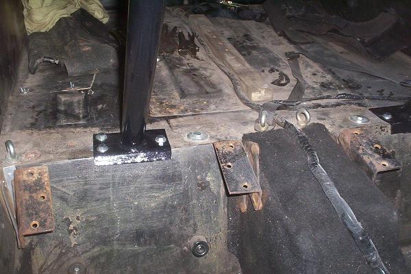

                    After carefully welding all the joints, apply 2 coats of smooth hammerite and leave to dry for a few days
                    All bolted into place

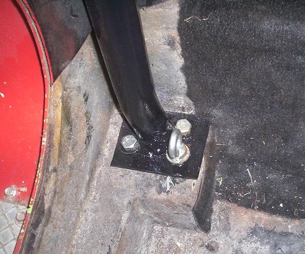

                    Under the body at this point is a nice flat plate forming part of the chassis and the original seat belt mounting point, so very strong
                    The rear stays are lined up with the main rear chassis members, so the mounting plate has to be quite wide to get bolts either side of the chassis rails. The rear coil over mounts are also a few inches behind here adding to the strength
                    I'm pleased with how it's come out, total cost about £125

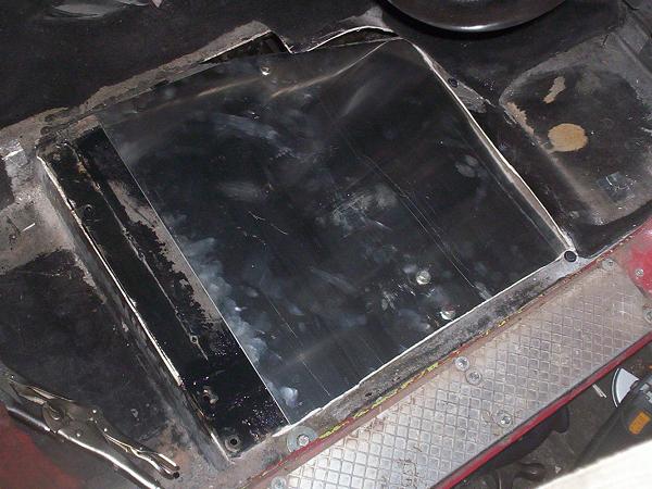

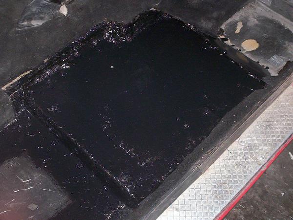

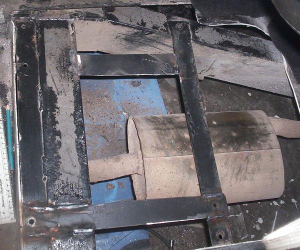

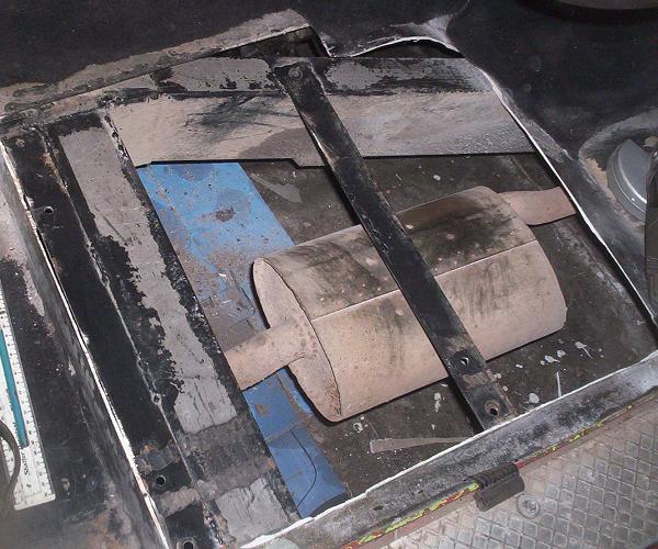

                      I tried the bucket seats in but the subframes didn't line up with the cross bars I'd fitted to the chassis for the normal seats, so I removed the floor for better access
                      Welded some longitudinal strips of 4mm flat bar to bridge the gap

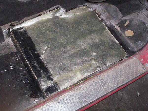

                      Ally sheet to reflect heat from the exhaust and provide a solid surface to lay the new floor on
                      First layer of fibreglass added, a few more layers to follow
                      I've got to the same point on the passenger side as well

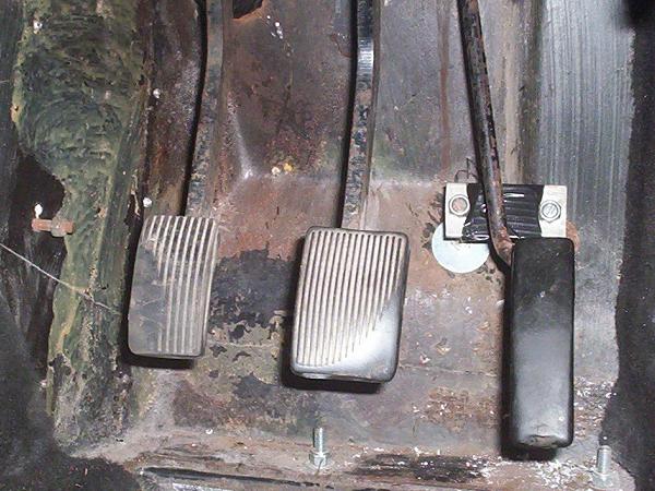

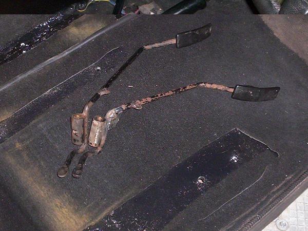

                        Also showing my modified throttle pedal - I'd never been happy with the pedal sitting 4" lower than the brake pedal as it doesn't feel natural there, so I'd bought another pedal box earlier in the year, bent it to a better angle and welded a plate across the bend for strength
                        With the seats out it was a good opportunity to lie upside down in the footwell and swap over the pedals - it now sits level with the brake so I can heel and toe
                        The throttle stop used to be the bulkhead so I made a new one out of threaded bar and 5mm ally plate

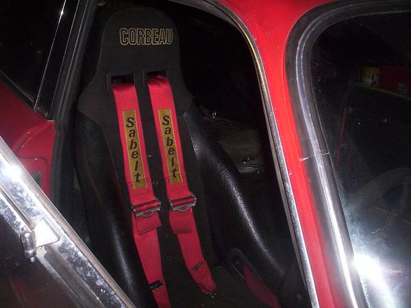

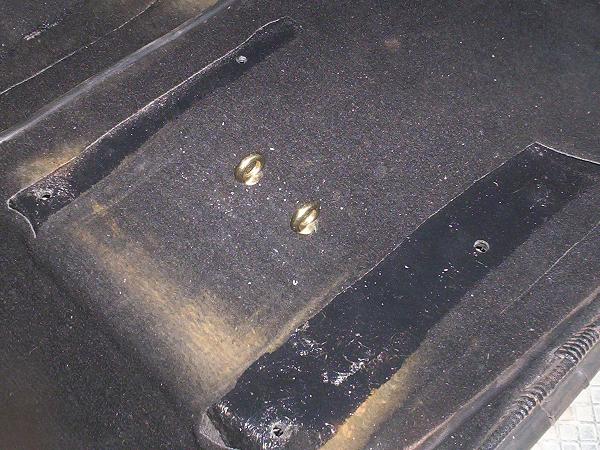

                        As I was fitting bucket seats, a better set of harnesses seemed appropriate, so I added a couple more eyebolts for a 6 point harness. Under the floor they are bolted to a 12" length of flat bar which spans the new seat rails
                        Seat and belts installed, passenger side was done a few hours later - the harnesses are out of DVY, but as they expire at the end of the year, they will end up in the Scimitar permanently next year

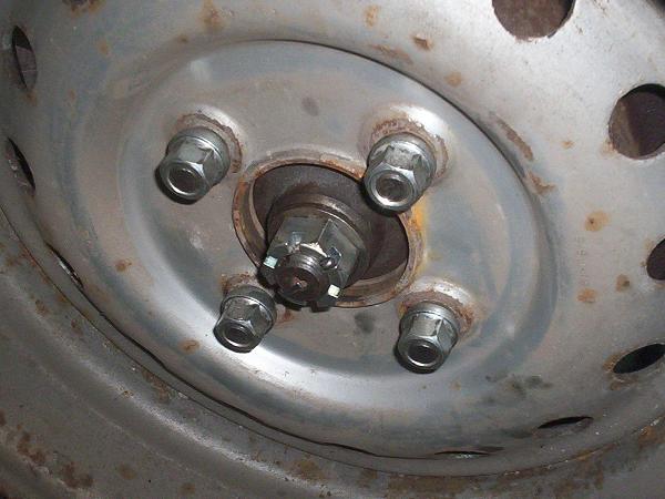

                        Finally, rear end finished, the new studs are a perfect length, flush with the end of the nuts
