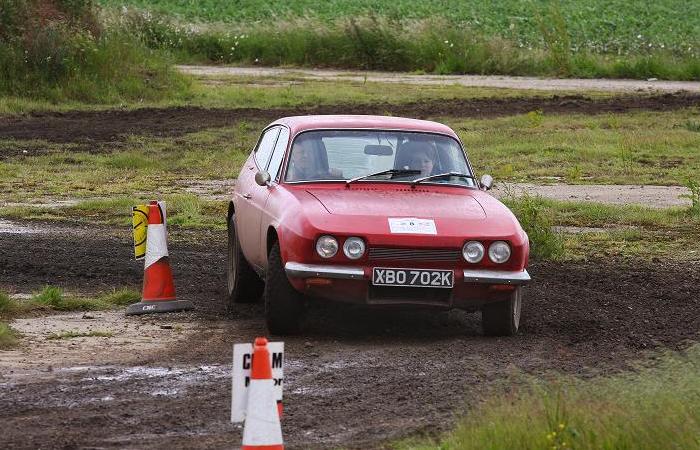

        Pictures of us enjoying ourselves

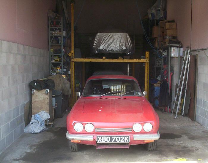

                    I'd never been happy with my previous aerosol paint job, so this time I wanted to try and do a better job

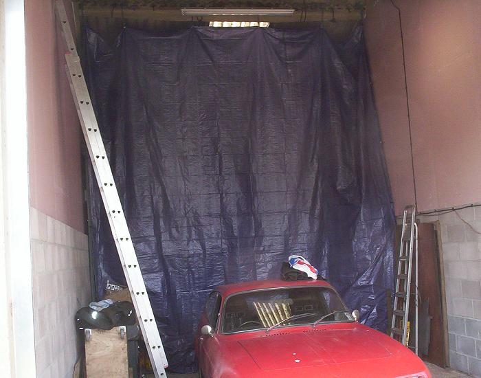

                    First, I had to clear some space in the workshop by stacking 2 cars at the back...
                    Then partition it with a large tarp to try and stop the dust getting everywhere

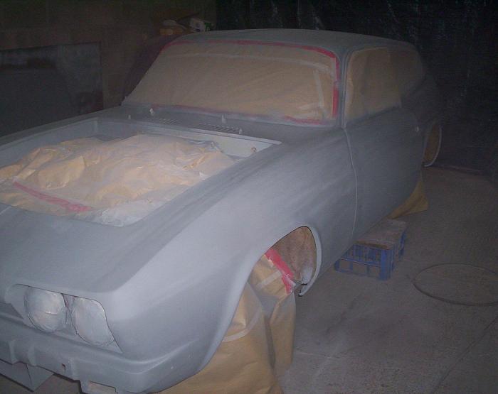

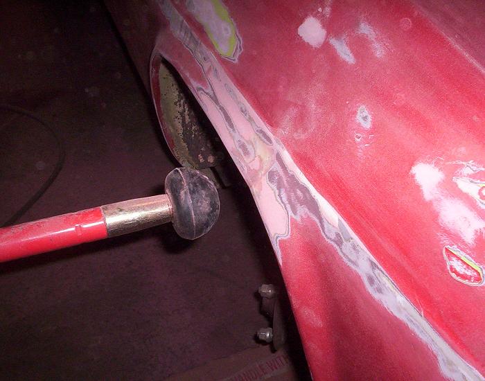

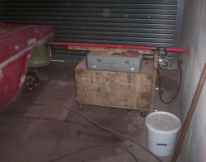

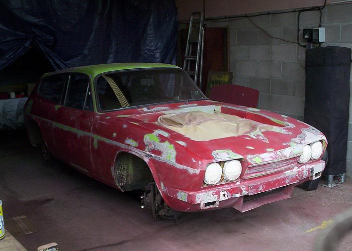

                    I started sanding down and investigated a crack in the front wing which has been there for a while, and the wing has bulged out. The inner wing has come away from the outer wing and underneath I could see where the fibreglass had separated, and it didn't take much force to push it back to where it should be, so I rigged up the portapower to hold everything in place while I added more fibreglass mat to reinforce the inner and outer wing joint
                    Left it a couple of days to set and it stayed in shape after releasing the hydraulics It's a fraction further in than required so I can build it back with a little filler

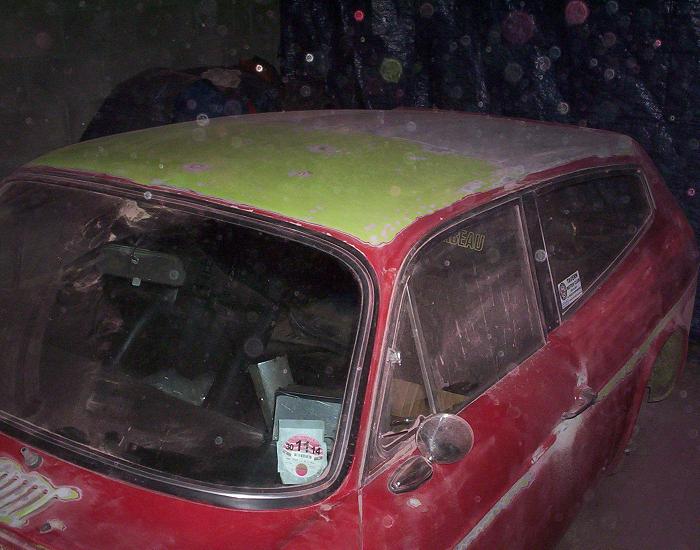

                    The roof is probably the worst area with hundreds of blisters, so I spent 2 days sanding through the top coats to get back to the factory green primer, or so I thought. Only the front section to the b-pillars had this green primer on it, everything else was a mixture of fillers under a few layers of red paint and other primer. Curiously the roof above the green primer was pretty good with most of the blisters over the filler. Presumably it didn't come out of the mould too well, so Reliant had to skim the roof with filler before painting it Anyway, it's a lot smoother now and just needs a bit of filler in a couple of places where I've reached the fibreglass
                    Plenty more to do on the rest of the body, mainly around the front where I believe she has been repaired previously, but I won't need to sand all the paint off like the roof, just add some more filler

                        It's when you line up at the start and the other 40 cars are a lot shinier than mine, so I'm going for a 10 yard paintjob not the current 50 yard one
                        Now what were you saying about high build primer, I've got 10 litres here, hopefully that will be enough...

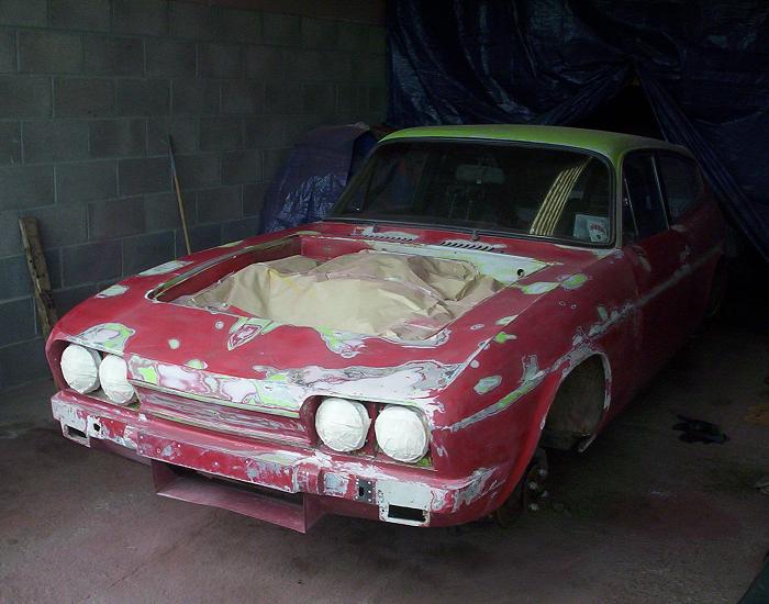

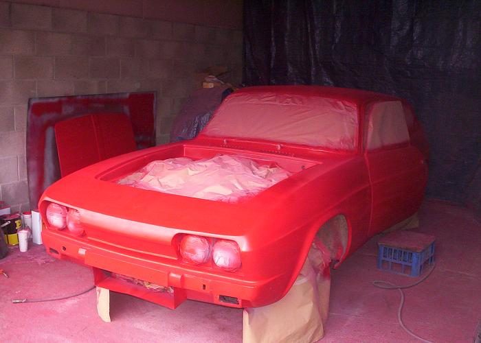

                          Well she's now redder than before...
                          More sanding

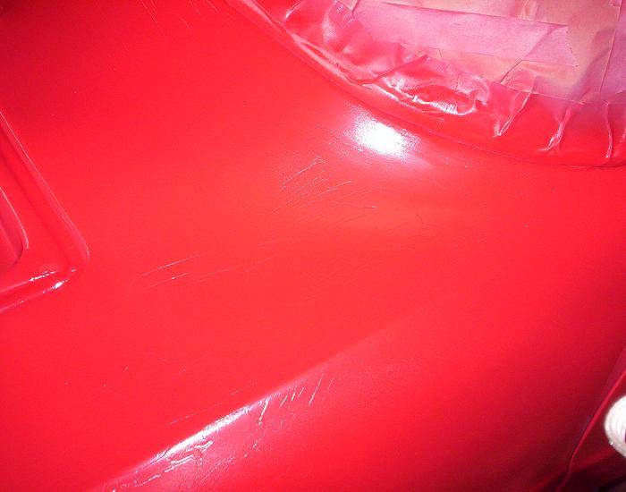

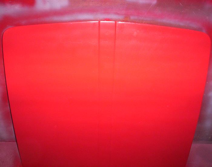

                          Lots of filler and many hours sanding I was happy enough, then complete disaster when I put the first coat of cellulose primer on as it reacted with one of the previous coats of paint. The roof was fine as I'd gone back through the previous coats but on the front, sides, doors, bonnet, etc, where I had only sanded the bads bits, there was lots of crazing in the primer. I don't have time to start again, so after reading about similar problems on the internet, I went to Halfords and bought 5 x 500ml aerosols of their grey primer (which is acrylic so seems to cover anything) and used up 4 of them to cover the crazing, which worked but obviously the crazing can be seen through the halfords primer
                          4 top coats of Radiant Red, some bits have come out shinier than others (it was difficult to see while spraying, I could have done with an extraction fan or two!)
                          Crazing effect

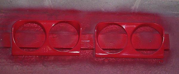

                          Did the headlight surrounds and bonnet as well
                          Just got to bolt everything back on ready for Saturday's rally...
