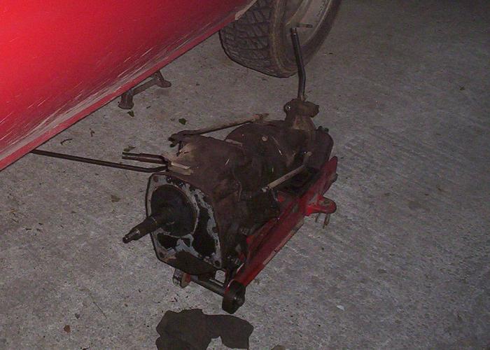

      Gearboxes...

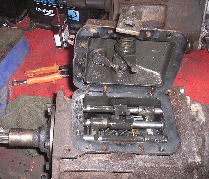

      I started by removing the gearbox and dismantled it on the bench, taking a few pictures as I went along

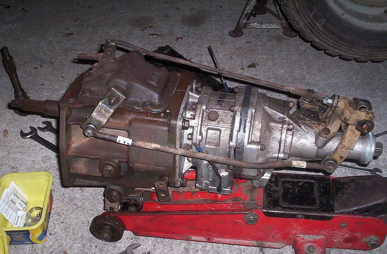

      One rather heavy gearbox - this is a Type 5 with overdrive. The Type 5 was fitted to 3 litre Capris and before that to Zephyrs and Zodiacs, some of which probably had the overdrive and 2 rod gear change mechanism seen here.

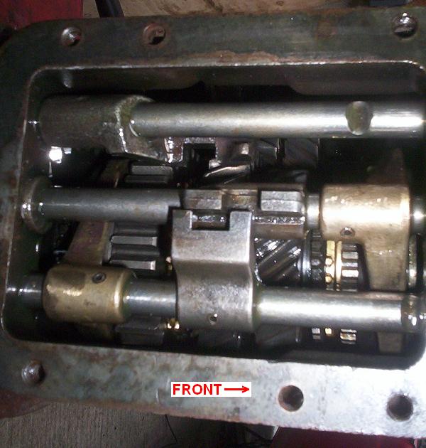

      Top cover and selector mechanism, showing the 3 selector rails and the 2 levers in the top cover. The longer lever is for reverse and the spring next to it provides the resistance to moving the gear lever into the reverse position. The shorter lever engages with either the 1st/2nd selector rail or the 3rd/4th selector rail and is moved from side to side by the other lever which pivots in front of it. At the front of the casing are 3 holes for detent balls and 3 springs sit above them in the top cover. This is in Neutral, so you can see the notches in each of the rails where the balls will sit in either 2nd, 4th or Reverse. Notches for 1st and 3rd are hidden inside the casing. The Reverse notch is further back as the lever is longer, the selector rail moves further to engage the gear.
      Unbolted and removed the overdrive - this was difficult as the splines were stuck tight to the mainshaft. The manual suggests running the car in overdrive then dipping the clutch which will release the loading on the splines, but the overdrive hasn't been working recently so I couldn't do this. So I resorted to using the large bolts holding the adaptor plate to the main casing as mini screw jacks and it came apart. This shows the adaptor plate still attached to the main casing, with the main shaft nut lock tabs unlocked ready to remove the nut. Also on the mainshaft there is a cam which drives the overdrive oil pump which provides the hydraulic pressure to enage the overdrive gears. The cam just slides off and this picture shows a tiny slot where a woodruff key sits to drive the cam.
      With the adaptor plate removed, showing the ends of the 3 selector rails on the left, the end of the layshaft middle right, and the reverse idler shaft just below it. These 2 shafts are prevented from spinning by the rectangular ends fitting into slots in the adaptor plate. The rear bearing sits in the adaptor plate.

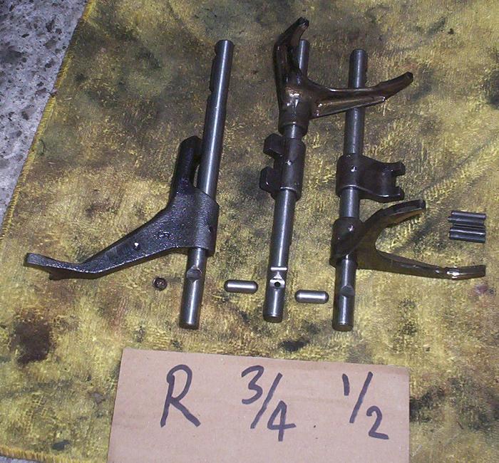

      After removing 5 roll pins, the selector shafts can be removed rearwards, 1st/2nd comes out first, then 3rd/4th and lastly Reverse. In the back of the casing, shown at the bottom of the picture, are 3 interlock pins which prevent more than one selector shaft being moved at one time, thus ensuring you cannot select 2 gears at once. The interlock pins are in a cross drilling and there is a bung closing this off. The bung is like a tiny core plug, but I managed to get it out without any damage by using a 3mm allen key from the inside pushing out with a screwdriver for leverage.

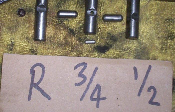

      Here is a close up of the interlock pins. There is a very brief mention of these in the manual, but no pictures or diagrams. The tiny pin in the middle, sits in the middle selector shaft and moves from side to side when pushed by one of the bigger pins being moved by the notches in the outer selector rails. When I got everything apart, this tiny pin was not moving freely in the middle selector shaft and I think this is what caused the gear selection problems.
      When I could not get reverse, it was stuck off centre thus holding the reverse interlock pin in the notch on the reverse selector shaft so it could not move. But when I found reverse, it then got stuck off centre the other way, preventing the 1st/2nd selector shaft moving. The hole the tiny pin sits in is 3mm diameter so impossible to see inside it, but if I put some wire up it, it is not smooth as if it is going rusty. Everything else in the gearbox looked fine - gears and synchros all nice and shiny, but I did not want to put it back in without getting a replacement 3rd/4th selector shaft.

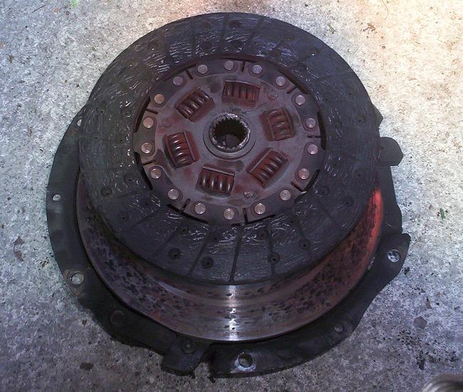

      I also removed the clutch to see what damage I had done to it - there was scoring to the cover plate and signs of everything getting hot, and similar marks on the flywheel. I'm not going to replace the flywheel as that is lightened and balanced but did order a new clutch cover and plate.

      I swapped the gear change mechanism from the old one and even replaced the detent balls with new 5/16" balls. I also balanced it vertically in the vice and squirted oil around where the selector shafts go into the rear of the casing in the hope of getting some oil to the interlock pins.
      After quite a few hours struggling, the box was back in, bolted to the engine and the gearbox mount on and I left it like that last night. So today I just had to finish connecting everything and fill it with oil. I'd also serviced the engine and replaced both engine mounts and the gearbox mount as they were all tired, despite being replaced when I rebuilt the car. Anyway, after I had added a litre of oil to the gearbox, I noticed it was dripping oil from behind the gearbox mount, under the overdrive. Hoping it was just the overdrive bottom plate gasket leaking, I removed the gearbox mount for a better look, but it was worse than this - it was coming from where the black brake band is sandwiched between 2 parts of the overdrive casing. There are 8 studs and nuts which hold this together, so I went round and did them up only to find one stud was snapped underneath near where the leak was. Maybe this was why the gearbox was a spare one.

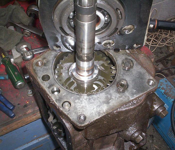

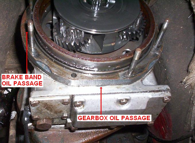

      I got out the old overdrive, which has a full complement of studs and took the 8 nuts off and the casings came apart quite easily and nothing dropped out, so I removed a stud for use on the new one. This gave me an idea - if I could do the same on the new box with it in the car, it would save a day taking the whole box out and fixing it on the bench. Some of the nuts were difficult to get to, but by lowering the box slightly I got the 7 nuts off and split the casings far enough apart so I could get some mole grips on the broken stud and extract it. (While dismantling the old overdrive, I discovered why it has not been working recently - the pump plunger was stuck down having picked up on the overdrive casing - there's a flat section which stops the plunger twisting and this section had rubbed against the casing for enough years that it had worn enough to get stuck - a few minutes work with a file and it was free again - with the plunger stuck there would not be any oil pressure to engage the overdrive).

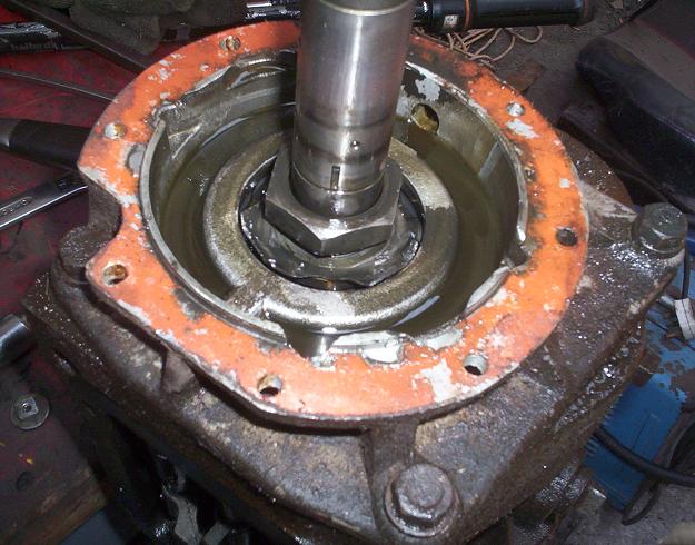

      While underneath doing this, I discovered the real cause of the oil leak - the brake band had been fitted in the wrong orientation!!!
      The oil passages should line up, otherwise no oil will get to the overdrive gears and output shaft bearing...
      The brake band cannot be removed without removing the 3 sets of smaller gears and the brake ring, and I thought if I tried this it would all come apart, so I removed the other 5 studs (the top 2 go the other way so were on the rear part of the casing), and then I was able to rotate the brake band into it's correct position, refit the 5 studs and the replacement for the broken one, refit the rear casing and everything was back together.
