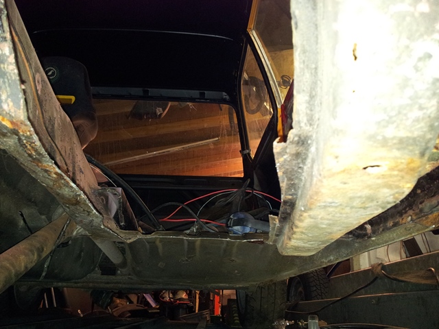

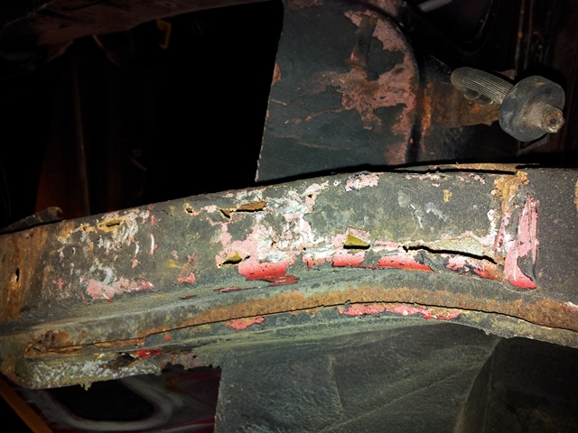

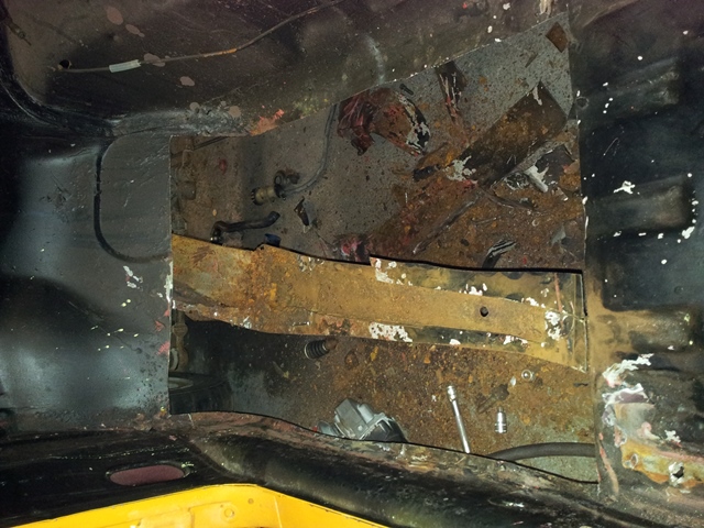

                i had a poke around at the better? n/s chassis rail
                the lower sections are relatively straight and wouldnt be too hard to replicate or adapt universal sections, unfortunately middle section is quite heavily contoured and joins to a reinforcing section that carry's the front x member, i didnt fancy patching this section and in particulary feared i wouldnt be able to restore it to full strength
                i cut out a grotty section of floor, then way enlarged the incision and exposed the inside of the lower rail section, although not as rusty as teh other side its definatly mach thinner than it should be,
                ive since found i can get new rails from bmw, full rails from front to where they finish under the front floor pans, lots of work to fit, but probably the best way to go, the only down side is they are over £500 a pair PLUS VAT. so for the moment im just thinking on it
