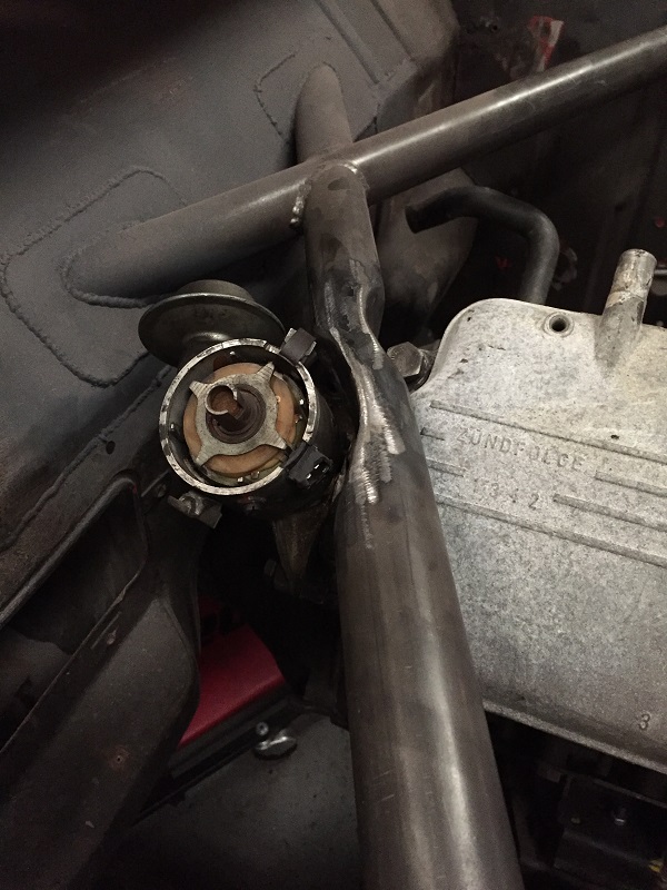

    at this point i realized i might have an issue with the roll cage, or more correctly the strut brace section of it. when the cage was done there the shell was bare, and the tubes were positioned from memory only, i wasnt too worried at the time, as i never intended to run an engine with a distributor, but building it to a historic spec thats exactly what i need to do. as soon as the block was on the x member i knew we were short on room, the head fitted, but it was clear there was no room for the oil switch, but thats easily relocated to the main oil gallery, in any case i think its better to know what the oil pressure in the main oil feed is, rather than at the furthest point from the oil pump at end of a rocker shaft, more concerning was that as it stands there was no way i was going to be able to fit a distributor! after a lot of thinking i got out the Oxy-acetylene torch and a hammer, heated up and reshaped the tube to clear the dizzy, whilst i was there i also reshaped the tube to give me access to a head bolt without taking the engine out first

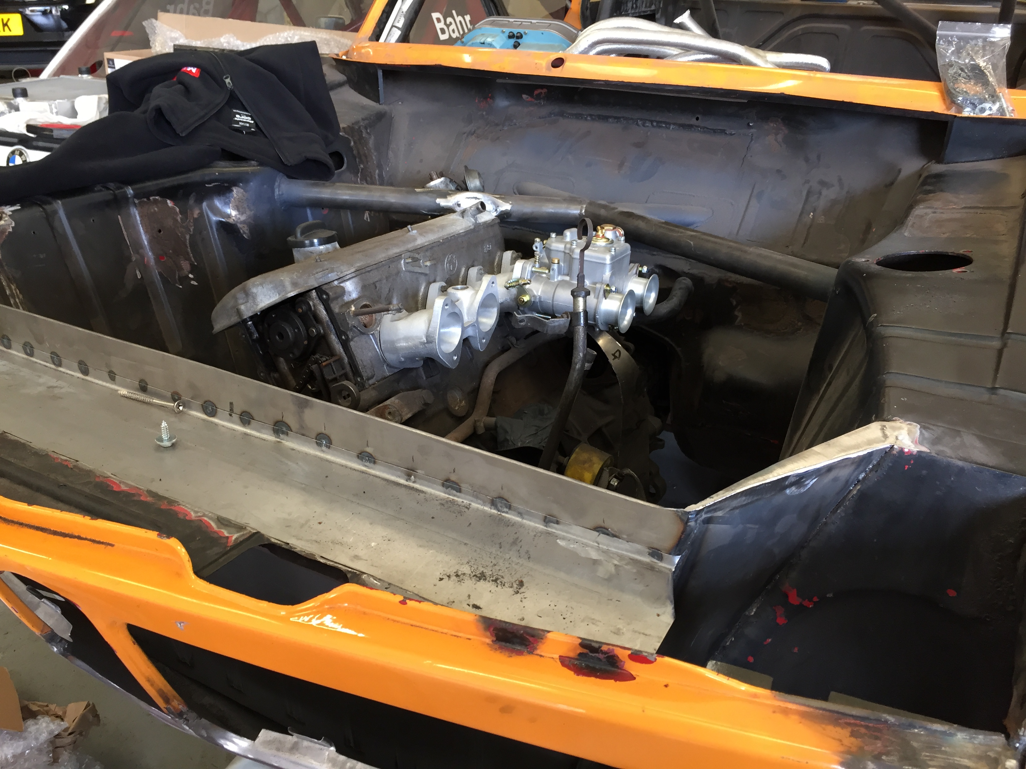

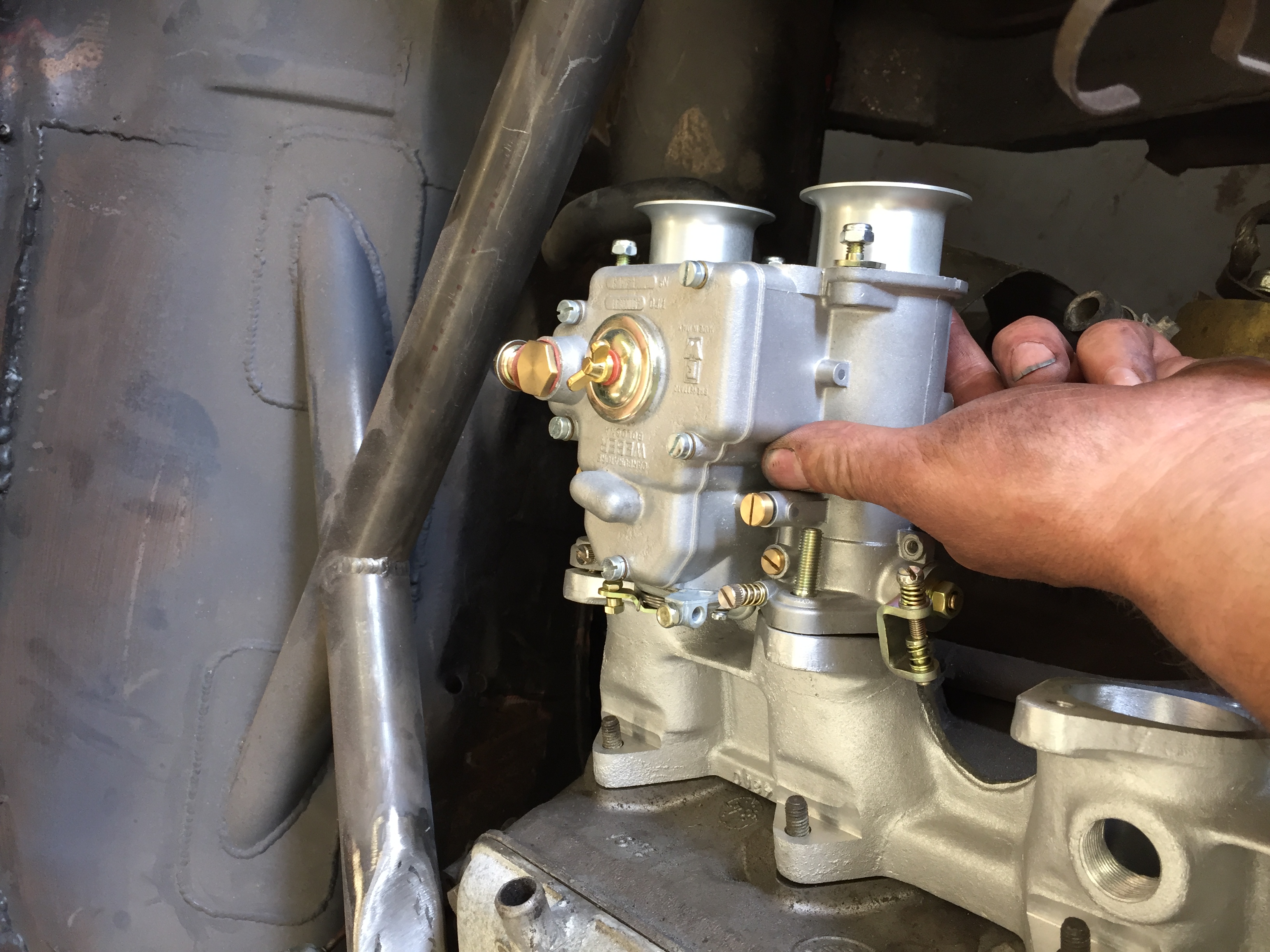

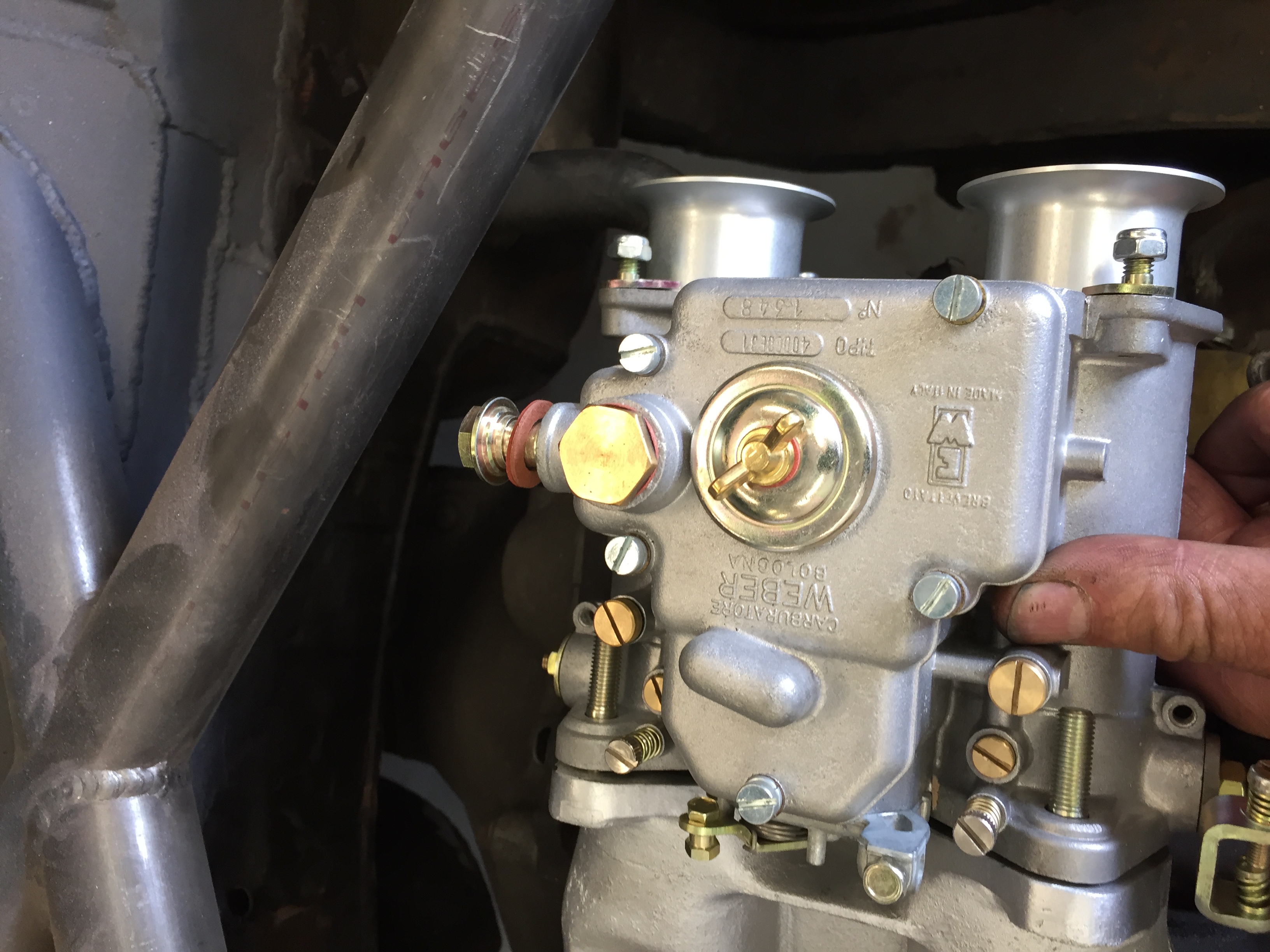

          , the E30 is currently eating up most of my time and money, But we have now replaced the missing sheet metal from the slam and inner rad support panels, replacements not being available i just opted to make something which looked similar, i also order up an inlet manifold so i could check for carb clearance around the strut brace, the carb itself is a borrowed 40, it will most likely end up on a pair of 48's. next on my shopping list for the car is probably the exhaust manifold
