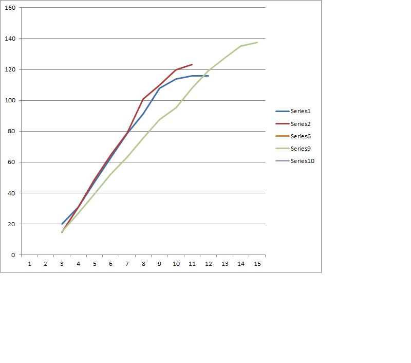

          ive been trying really hard to make the big valve flow, at ultra high lift i have achived it with some style, ive got it upto over 137cfm@10", however, its at huge cost flow throught most of the lift range is well down, and it will need a cam lifting to 600 thou which is nearly 100 thou more than any off the shelf cam!
          im going to have another look at filling the bottom of the port in next

            Re: Graham's bmw 2002 race car.
            Hi Graham,
            Is the problem with the flow on the red and the blue curve is at 115 / 120 cfm, the air cannot go around the short side. If you continue the graphs at higher lift will the curves continue to rise but at a slower rate. If that is the case then I found that widening the width of the port at the short side radius helped get the flow around the corner without effecting the high lift flow. If you could keep the lines increasing at the same rate then you could see nearly 140cfm at around 12mm lift.
              Hi Graham,
              absolutely, the blue tops out at 115cfm red at 120, the problem with the bmw port is its rectangular and already as wide as the valve, so widening it further may not work, but its something i will have to try
              when i was using daves superflow i found airflow on the blue line stalled dead @115cfm, but with my bench running @28" (i convert the results to 10") i do get a slight increase if i lift the valve further but not much, i can see this is going to end up with a custom cam and welded up port

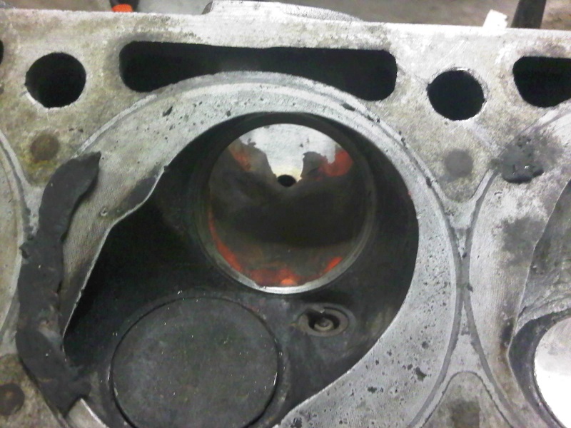

                          right been at it again with the flow bench, if you have been following you will know ive hit a wall flow wise, essentially what ever ive tried i cant increase the average airflow over the valve lift range,
                          my instincts are screaming the short turn is all wrong and needs raising to give a longer radius, but that doesnt work, only lowering it more, which increase high lift flow at great expense to low lift, raising the port between the guide and manifold face works at high lift, big valve was fantastic and megga valve lift, like way more than ever practical,
                          the one part of the port i had ignored all along was the long turn, its quite concave, but i figured the air would ignore it like on a pinto, i was wrong! i filled that section and gain a whole heap of air flow both with standard and big valve, my guess is the air was following the concave section of port and simply crashing into the back of the valve rather than going round it. i wont know for sure until i get home and put the numbers in a spread sheet, but i think i have made progress, even if in an ideal world i still need a cam that lifts to 600 thou
                            • 25239
                            boy did filling the long side of the port work the big valve previously lost out massively everywhere but the very top end, what i did was also put back a bit of material on the short side which picked up lower lift flow, there is still work to be done, but clearly with welding the big valve now becomes viable

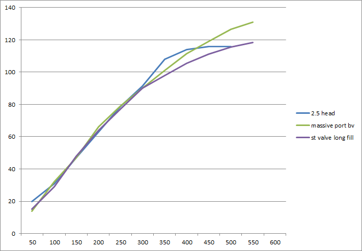

                              blue line is best conventional port, green line is big valve with long turn filled, im sure with work it can be better still, infact i dont thinki used the best set of flow figs for the big valve
                                • 25239
                                same valve same port, just with long turn filling, the filler is worth 10cfm through most of the lift range
