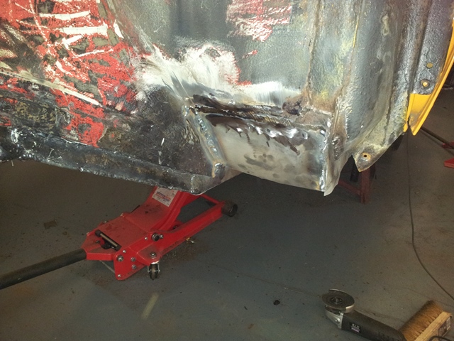

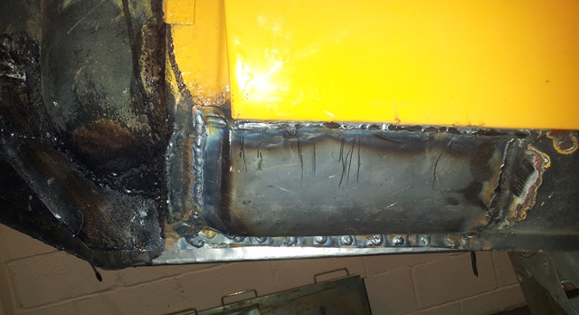

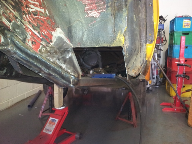

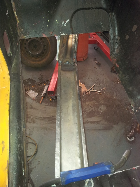

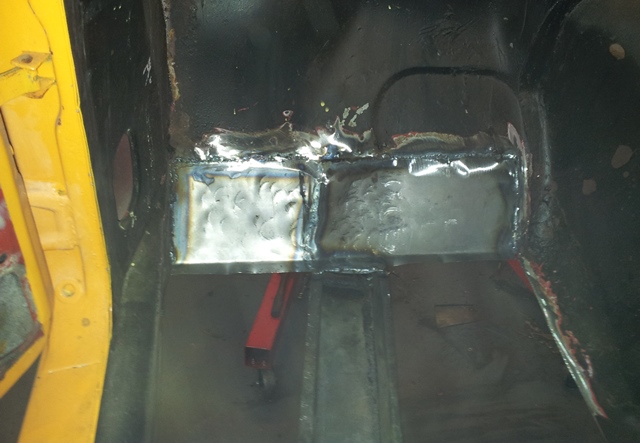

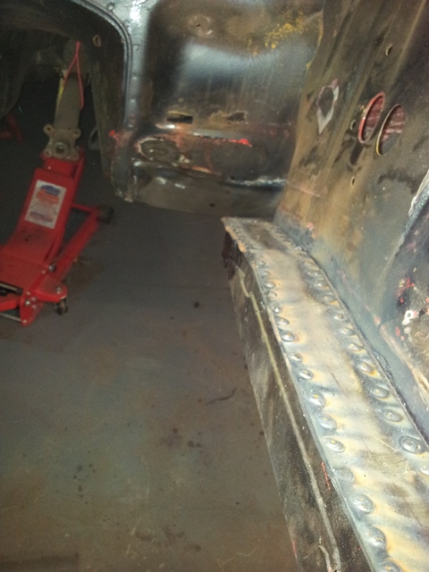

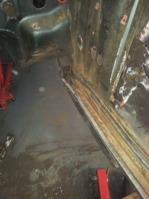

    work has gone a bit quiet, so ive dug the 02 out and cut out the grot from the n/s chassis rail/floor/sill.
    whilst i have no money to actually spend welding doesnt cost me anything so is time well spent.
    not the neatest work ive ever done, but ive cut pretty deep so as to take out anything even remotely iffy. almost all the joints are butt welded, it takes longer to do, but is neater, lighter and saves creating moisture taps, everything is getting a healthy coat of worm poison.
    folding up 18 gauge to make a chassis rail using nothing more than a hammer and an RSJ as an angvil was something else!
