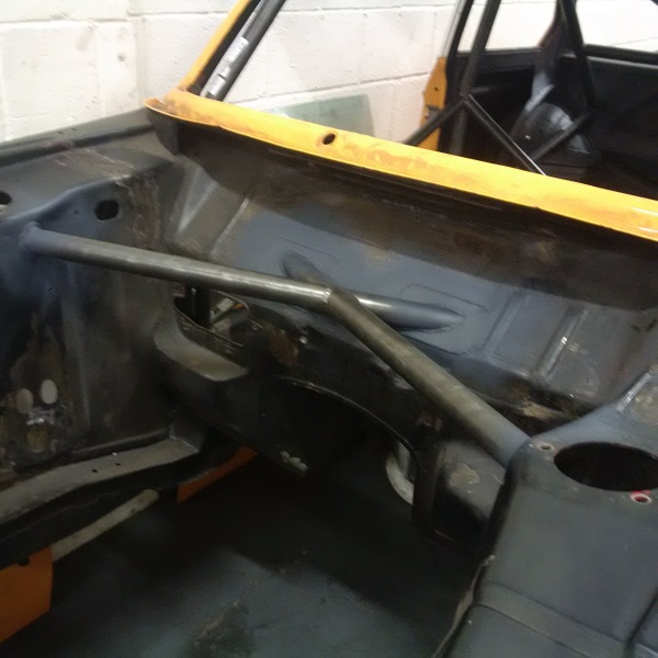

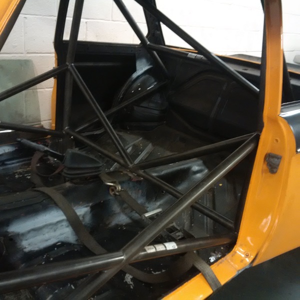

          well funny you say should say that, nothing with the engine, im in the process of building an s14 for a customer, and my head is saying build a short stroke screamer of 2.0 s14 for the 02. serious bucks though, but the is sort of some progress, in just over a week its going to off to have a cage fitted, i have had the cage for years but never got around to fit it, so i have a chap doing it for me, his unit is close enough to mine we can simply push it over to him ( it is sitting on a pallet with wheels attached)

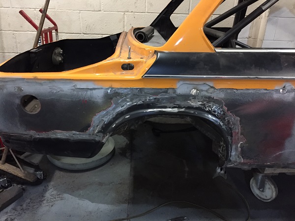

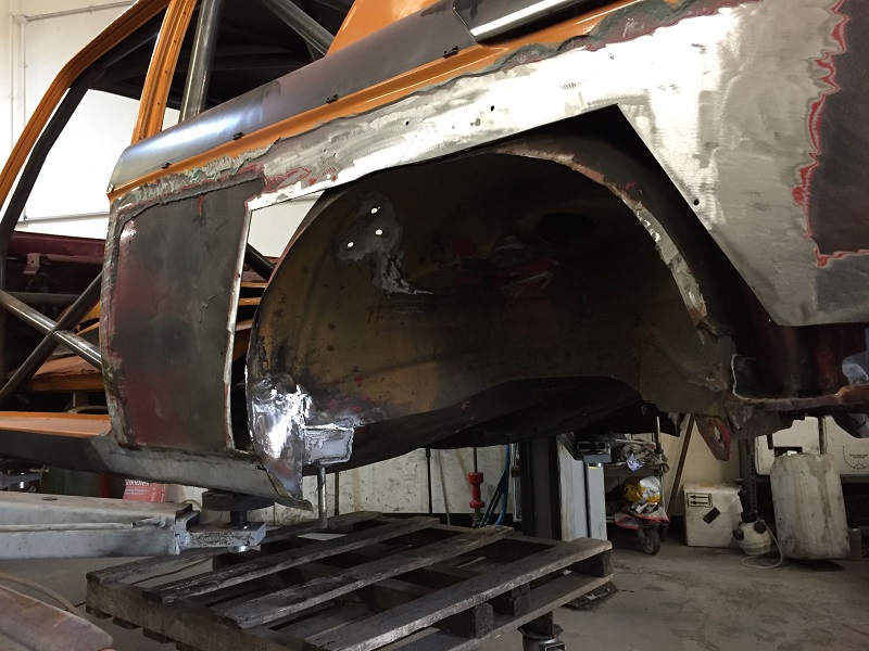

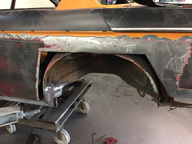

                we have a bit more progress, the really wide rear arches have come off, thats revealed standard arches with the lips removed ( to suit turbo arches) whoever did it thought didnt weld the inner and outer skins back together, they just filled the gap with filler! we have now cut (the n/s) quarter away so we can but weld an arch repair section in

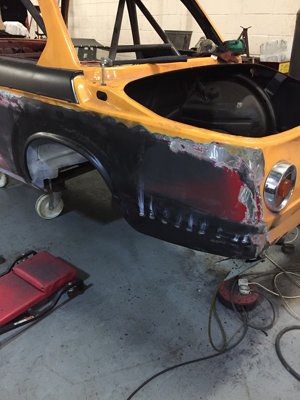

                            back on it again, o/s this time, arch repair section and lower quarter repair panels butt welded in

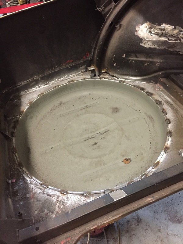

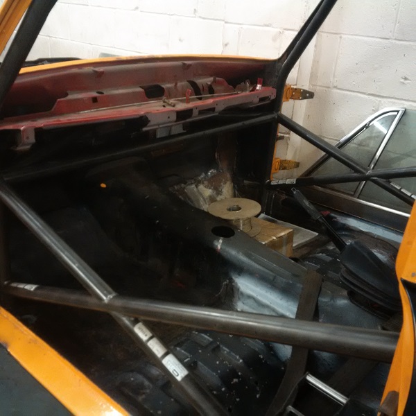

                                had young Sam doing some more today, rear lower quarter fully welded in, the inner and outer arches now welded together and we have welded a spare wheel well back in. Some one had previous cut it out and replaced it with a riveted in Alloy sheet, the repro wheel well was expensive and even then didnt have a lip so we had to fold an hammer one into it.
                                there we a couple of reasons why i put the well back in, firstly it does add a bit of structural strength because a 2002 has absolutely no form of chassis rail or structural member rearward of the rear suspension. Secondly i want to to look fairly correct, the other hole in the boot floor was where the OE fuel tank goes, again it was covered with an alloy plate, if i had a standard tank i would cut teh bottom off it an bolt it back in, so again it would look correct, but i havnt got one, so either the alloy plate will go back or a will fab something in steel which will resemble the top of a tank
