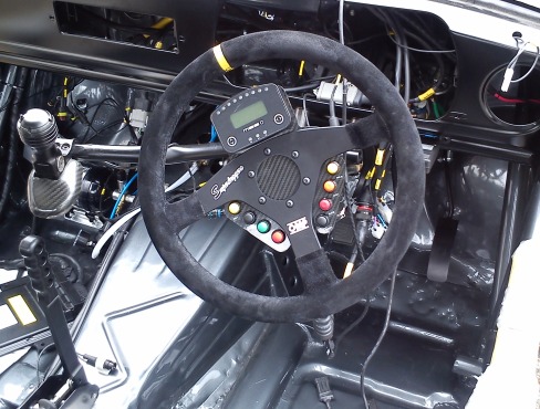

    And here is a photo of the drivers position. Starting to get quite busy in there. There are only two disClick image for larger version
Name:	SBD.8.July.14 small.jpg
ID:	2013365plays in the car, one is the small display on the steering wheel and the other is the gear indicator. The ECU monitors everything so no need for instruments.
    The gearstick is the little stumpy thing next to the left hand side of the steering wheel. Its actually out of Colin McRaes 2002 Focus !!

      Re: Fostek's R&D department
      With all the buttons and display etc on the wheel, what way are wires dealt with in order to achieve full lock-lock without snagging, or wires hanging etc ?
      9.85 @ 145mph 202mph standing mile
      https://www.youtube.com/watch?v=Ss_c7fML3rw
      • katana
        • May 2012
        • 3289
        #123
        Coiled cable is the usual way - its only gonna be 1.25 turns either way so will cope.
          You're spot on about the coiled wire. If you look very carefully the coil is just visible below the steering wheel and the coil goes forward to the connector with the red marker round it.
                What are the button on the wheel for? are they momentary buttons
                  They look like the Dash2 buttons used to move through the various screen options.
                    Buttons on steering wheel are: left and right turn indicators, headlight flasher, horn, windscreen squirt/sweep, launch control, that sort of thing. Basically the stuff the driver might need to fiddle with on the fly, saves him having to look down at a switch panel. None of the steering wheel buttons are related to the dash (which is an MBE Dash) but the dash itself has buttons to scroll through the different pages, should you need to.

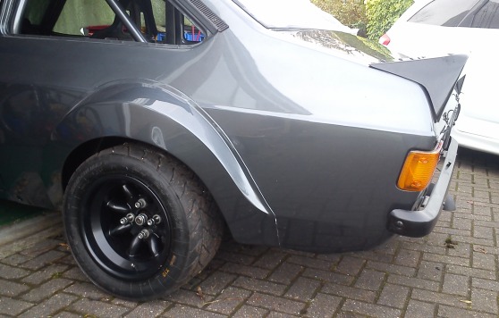

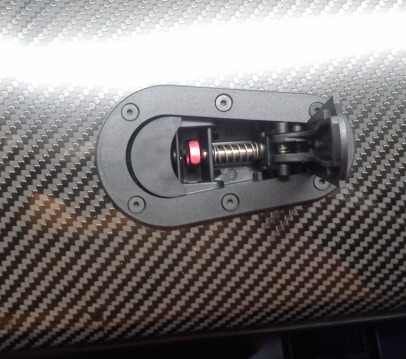

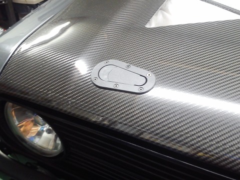

                        Sorry folks, I know we are overdue on updates but just not getting much time on the car. Here are few recent bits.
                        Main thing is that its down on proper 9 x13" wheels and the spoiler, doors, Click image for larger version
Name:	Bonnet catch - 2.jpg
ID:	2014020Click image for larger version
Name:	Bonnet catch 1.jpg
ID:	2014021Click image for larger version
Name:	DSC_0694 - small.jpg
ID:	2014022Click image for larger version
Name:	DSC_0690 - small.jpg
ID:	2014023boot and bonnet are all fitted.

                          #132
                          Happy first birthday. This thread -)

                              #134
                              Is it a modified Ascona 400 rear spoiler?
                              • mick32
                                • Sep 2004
                                • 354
                                #135
                                hi i love the rear spoiler is it a one off or are the available for sale
