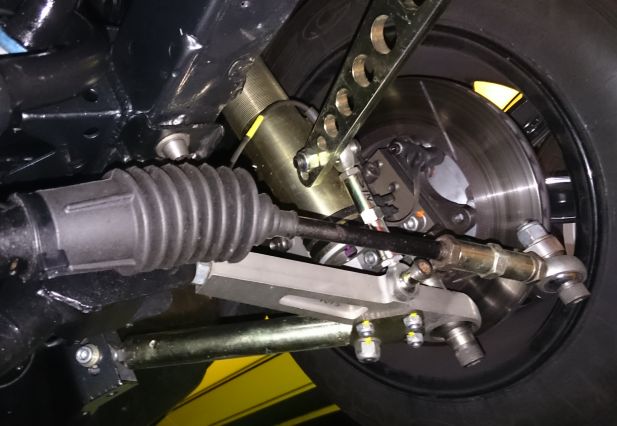

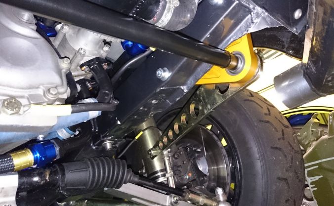

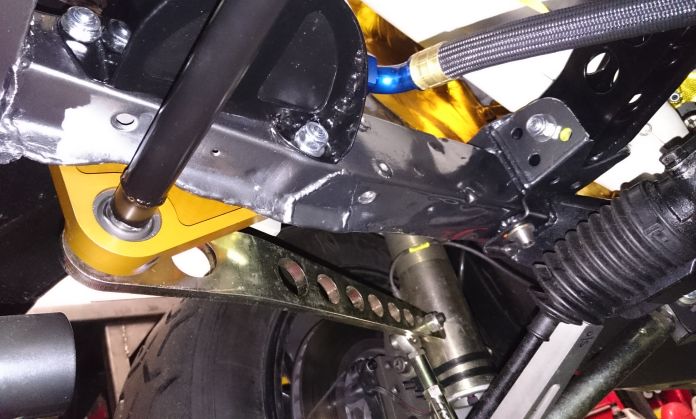

        And some pics of the Anti-roll bar. Its mounted on spherical bearings rather than rubber/Poly bushes to ensure it doesn't bind up.

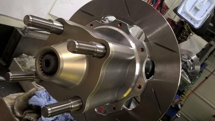

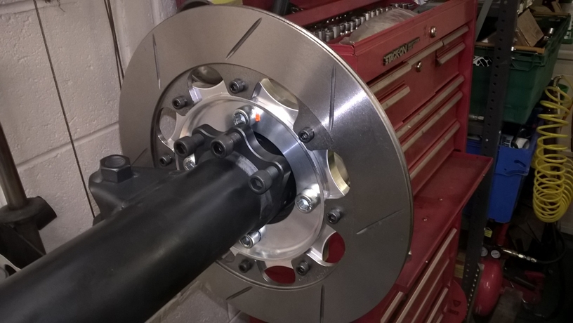

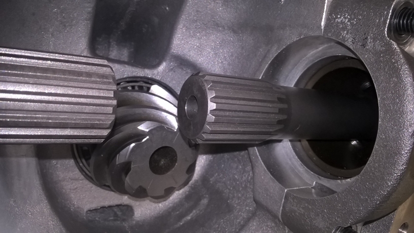

                  The new axle is well under-way. Well actually, this is the "proper" axle which was destined for the car all along - the one that's currently in the car is a bit of a test mule. This one is truly 1-of-a-kind - the casing was done in the final days of Fostek and I'm not sure I could do another one now if I tried, being a bit out of practice! The tubes (and bracketry) are all made to fit this shell, and are made from very thin wall 4130, welded as an assembly, then heat treated, before final machining and fitting into the diff housing (which is Alloy).
                  Here you can see the hubs, flanges, bells, discs etc all taking shape. Some big weight savings were made here - the hub assembly for example is rotational mass as well as un-sprung mass, so it's worth going to town on. Those studs are titanium: nut guns are banned!
                  Hollow halfshafts & pinion... Although it just occurred to me I need to think of some way of stopping the oil running out the shafts! It took nearly a year to make these - they're certainly well travelled - having been through no less than 7 different operations/companies; Rough machining, gun drilling, splining, heat treatment, more machining, shot-peening, straightening. They even shot-peened inside the gun-drill hole! I'll be most upset if one of these breaks.

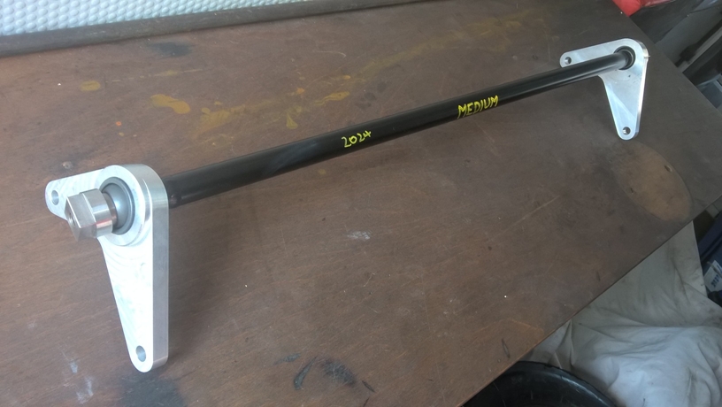

                  Also knocked up a couple more anti-roll bars. The front suspension is all a bit new to me, and I have no idea what rate of roll bar will be required. The one on the car (lets call that the "medium" stiffness) is approx the same rate as a typical GP4 Escort tarmac type ARB. Then there's one which is 25% softer and one 25% stiffer, which should be enough to give us an idea what's required...

                    very very cool tom a core plug could be a very simple effective way of keeping the oil in or out the shafts depending on which end you it it to

                      Why the hollow shafts?
                      Is it a significant weight saving?
                        probably not a significant saving, but if you look at every little bit of weight you can save it adds up,
                            About 500g per shaft I seem to recall. Obviously you can bore a bigger hole, but you're weakening the shaft, so it's a trade-off.
