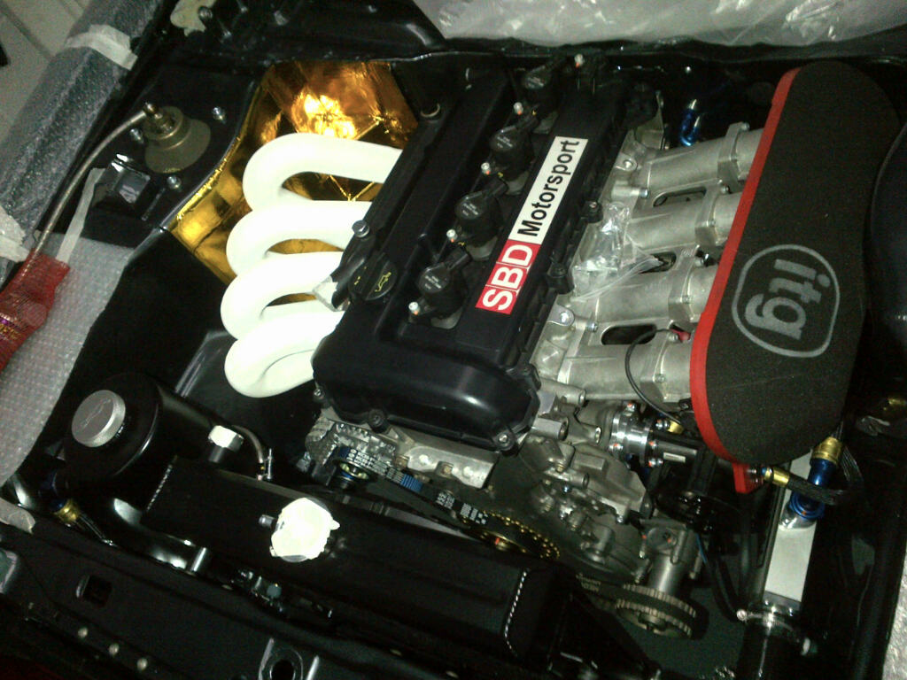

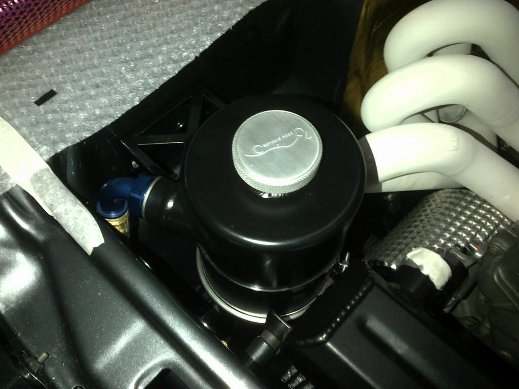

Dry sump tank and radiator are now in for good. I had to weld a temperature sender boss in the oil tank, then it's been painted matt black to help radiate heat (needs some gold leaf on the side nearest exhaust, still) I was particularly happy with the mounting bracket (thanks Flintec) - laser cut and CNC folded from aluminium sheet, welded, powder coated, bolted to inner wing... You would not believe how strong and light this is, just what I like
Now all that's left is to sort the oil tank breather. That got a bit complicated because of how close the top of the tank is to the underside of the bonnet, now ordinarily I'd have about 35mm to play with but 2 things gave me a headache; I misunderstood how big the breather hose has to be in order to not cause a restriction, and also that I've got something "different" up my sleeve with regards the bonnet, meaning there's a lot less space than I'd first thought... Never mind, nothing a bit of turning and welding won't sort out! Watch this space...
So apart from the fly-by-wire throttle motor, and maybe a strut brace, that's the engine bay pretty much complete...

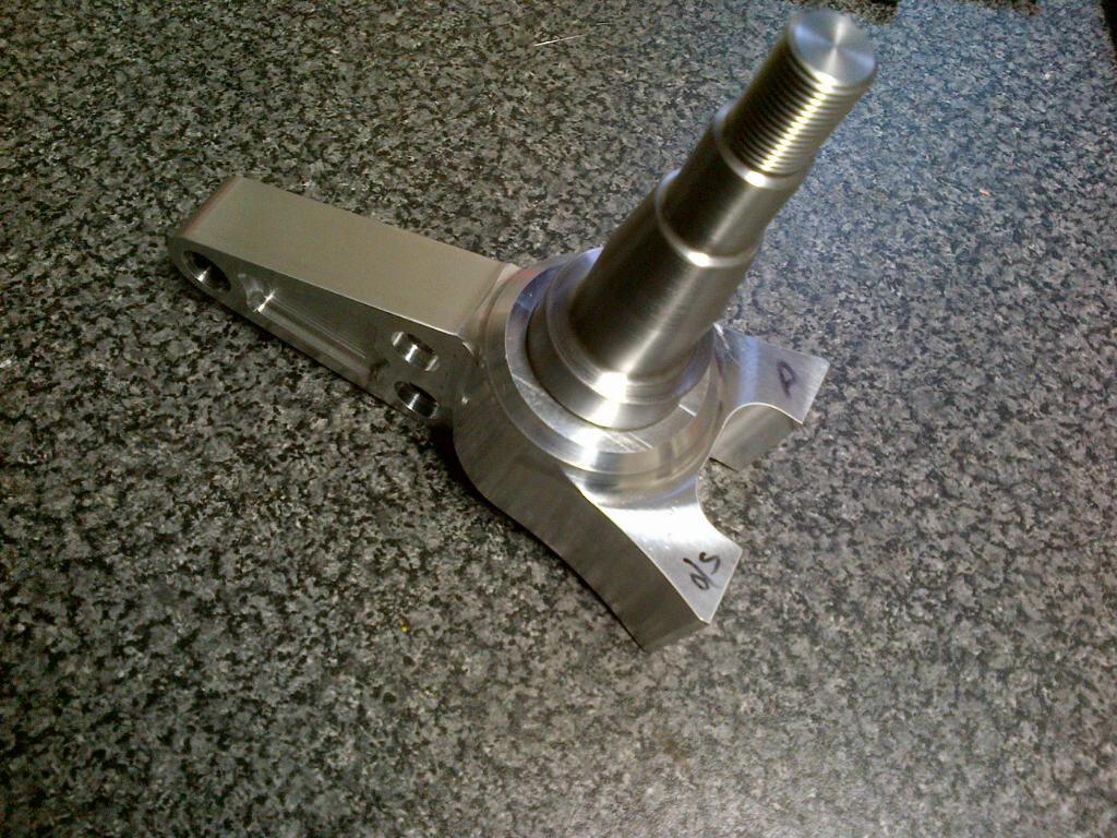

Anyway, some shiny bits arrived. I can't give too much away at the moment, but I think you can tell that this is an upright, complete with stub axle;

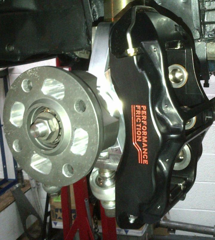

And here it is, mocked up on the car, just to check a few dimensions, measure the required disc > bell offset and a few other things.
I'll write a bit more about the braking system when the rest of the components are here, but in case you're interested, those are Performance Friction ZR40 calipers, 6-pot, monoblock construction (if there's any machinists reading this; how on earth do you go about machining the bores in these things? right angle head?) Anyway, the caliper clamps a 280x30mm thick cast iron rotor. The pistons look a bit of a funny shape - but what you are actually seeing there is a titanium cap, which is sitting on the end of the piston, separated by a ceramic insulating disc (the yellow band you can see if you look closely) which prevents heat getting from the pad into the piston and then brake fluid. Due to the fact the pistons are smaller than you find in a typical 4-pot, it means the "effective clamping diameter" is much closer to the edge of the disc... In round figures, these calipers on a 280mm disc will give the same clamping force as a typical 4-pot on a 304mm disc. The setup is intended for a Japanese race series called Formula Nippon (that name makes me chuckle every time). Apart from Formula 1 carbon/carbon brakes, which you're not allowed in UK rallying, I don't think you'll find better brakes to fit under 13" wheels. And to be honest, they don't really fit under 13" wheels - I'm probably going to have to make my own wheels to fit round these...
The hub, by the way, is a perfectly normal off-the-shelf GP4 hub, it's just I was a bit upset at how heavy it was so I showed it some love from the mill. Shaved not far off 3/4 kg off the pair! And the funny green/grey colour is a hard-anodised finish - looks a bit rough in the photo but it's actually a lovely colour; most anodising is decorative, i.e. it's meant to look pretty and has a dye in it so you can chose a colour that you fancy. This hard anodising process is a different process, you don't get to chose the colour, (the finished colour is a function of how long it's been in the solution and the grade of the parent alloy) but it comes out so hard you can just about take a screwdriver to it and not scratch it.
