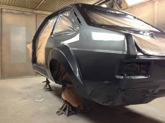

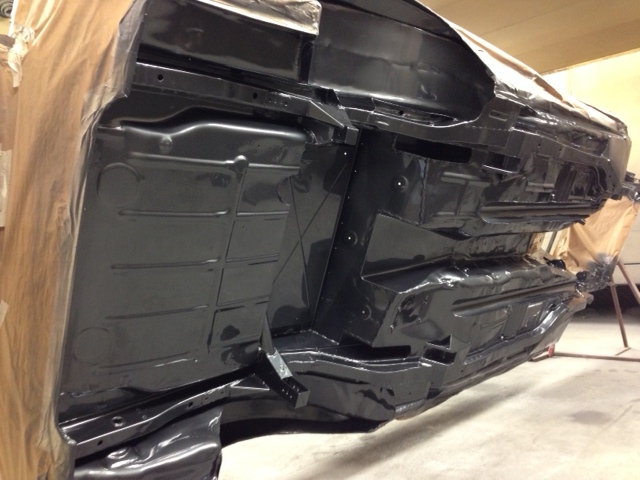

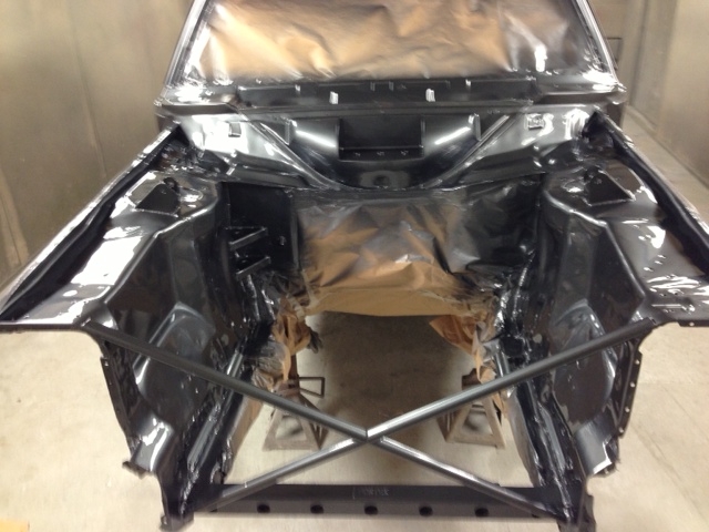

    It's taken about 4 years to reach this point; I'll not bore you with all the fabrication/bare shell pictures - given that this car is going to compete in National Tarmac Stage rallying, the bodyshell has to meet a fairly strict set of rules in terms of what you can/can't do to it, cut out, replace etc. So by mk2 Escort standards, it's not that trick, good old fashioned engineering here. The pictures start with the shell in the paint booth...
    I actually started with a semi-prepared shell; It had been built to Historic Spec (BDG, ZF etc) for Alister McRae to use in the BHRC a few years back, but for one reason or another that never happened. It had already had the cage fitted, tunnels, 4-link boxes etc. The tunnel needed modifying because I wasn't likely to use a ZF box in such a modern car, likewise we made a few tweaks to stiffen it up, remove some weight, and distribute weight as carefully as possible. Exhaust tunnel was also in the wrong side, so rather than cutting it out, I just mirrored it, so there's now twin tunnels, which a) adds rigidity to the floor and b) means you could run a different engine later if you fancied...
    Again, externally, no need to re-invent the wheel. Rear arches are Gartrac boreham jobs, fronts are also Gartrac but +1" each side to cover the JEMS wide track front end (more of that later) and the front spoiler was made specially to include some ducts, in an attempt to keep the front brakes from melting. The colour is Jaguar Gun Metal Grey in case you are interested.

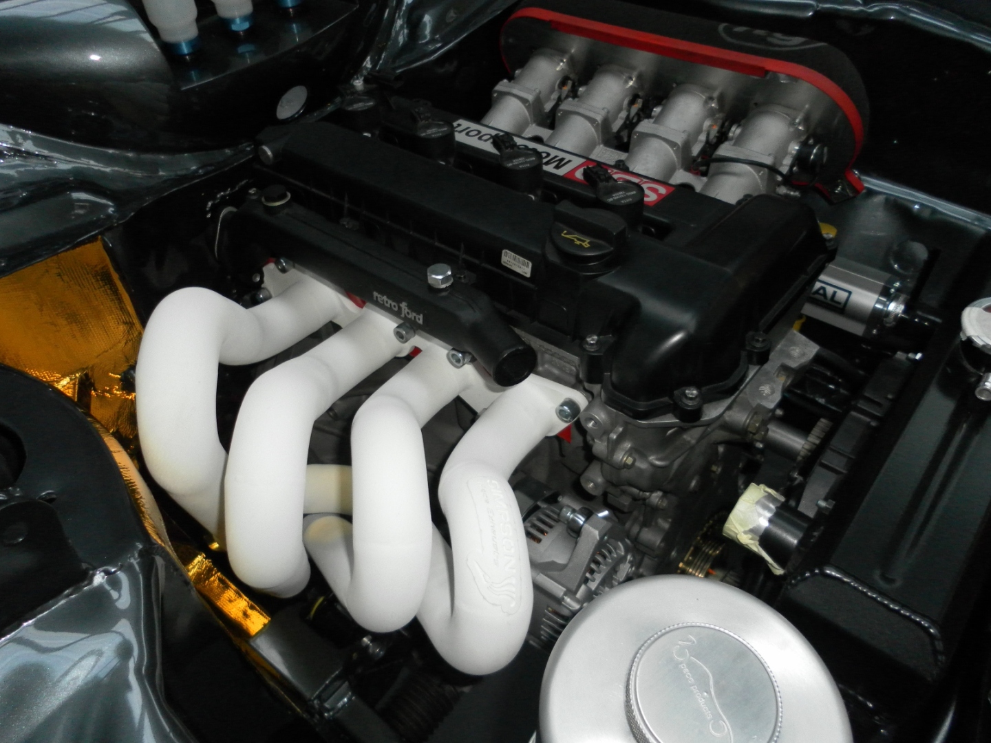

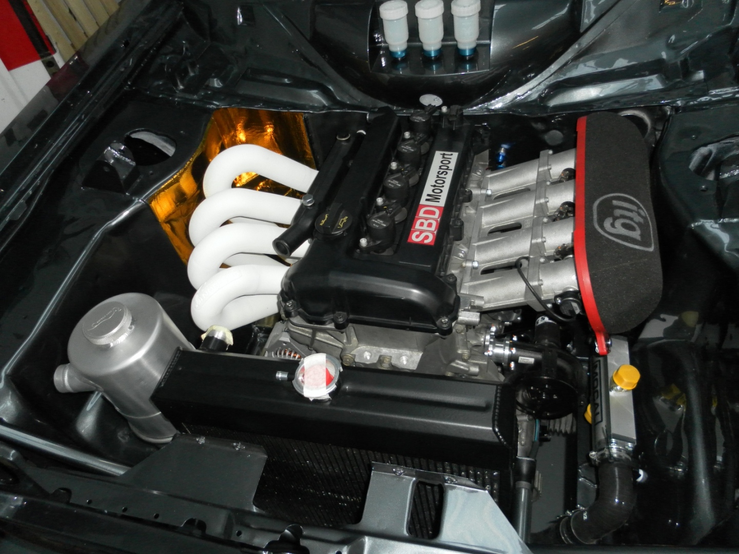

    Engine: pretty obviously a SBD Duratec, not just any one though, this is Matt Downer's old engine, and prior to that, an SBD test mule. I've had the pleasure of sitting next to Matt on several rallies, and thus I didn't need any convincing that this engine is more than capable of taking on any other 4-pot N/A engine currently on the market.

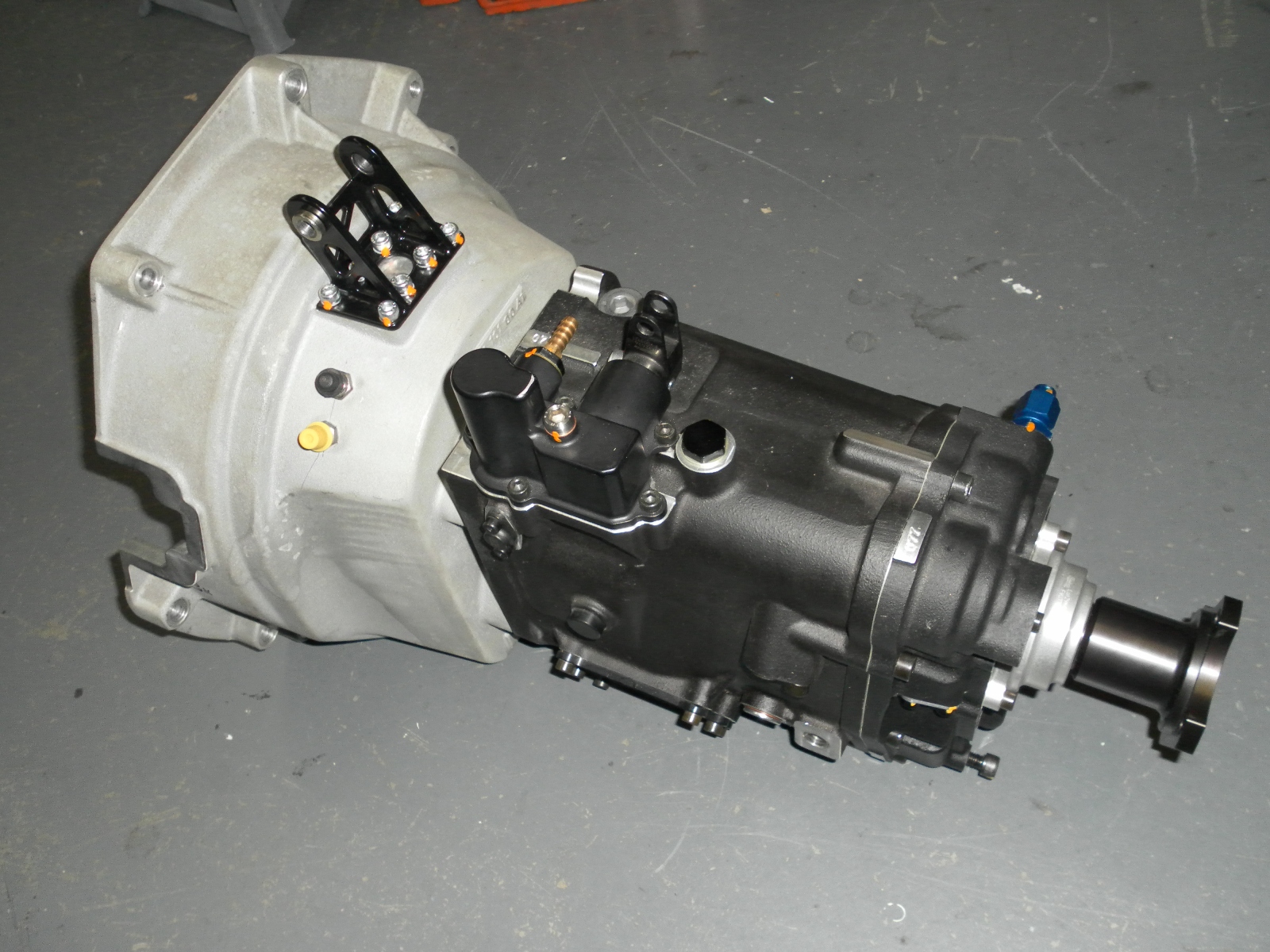

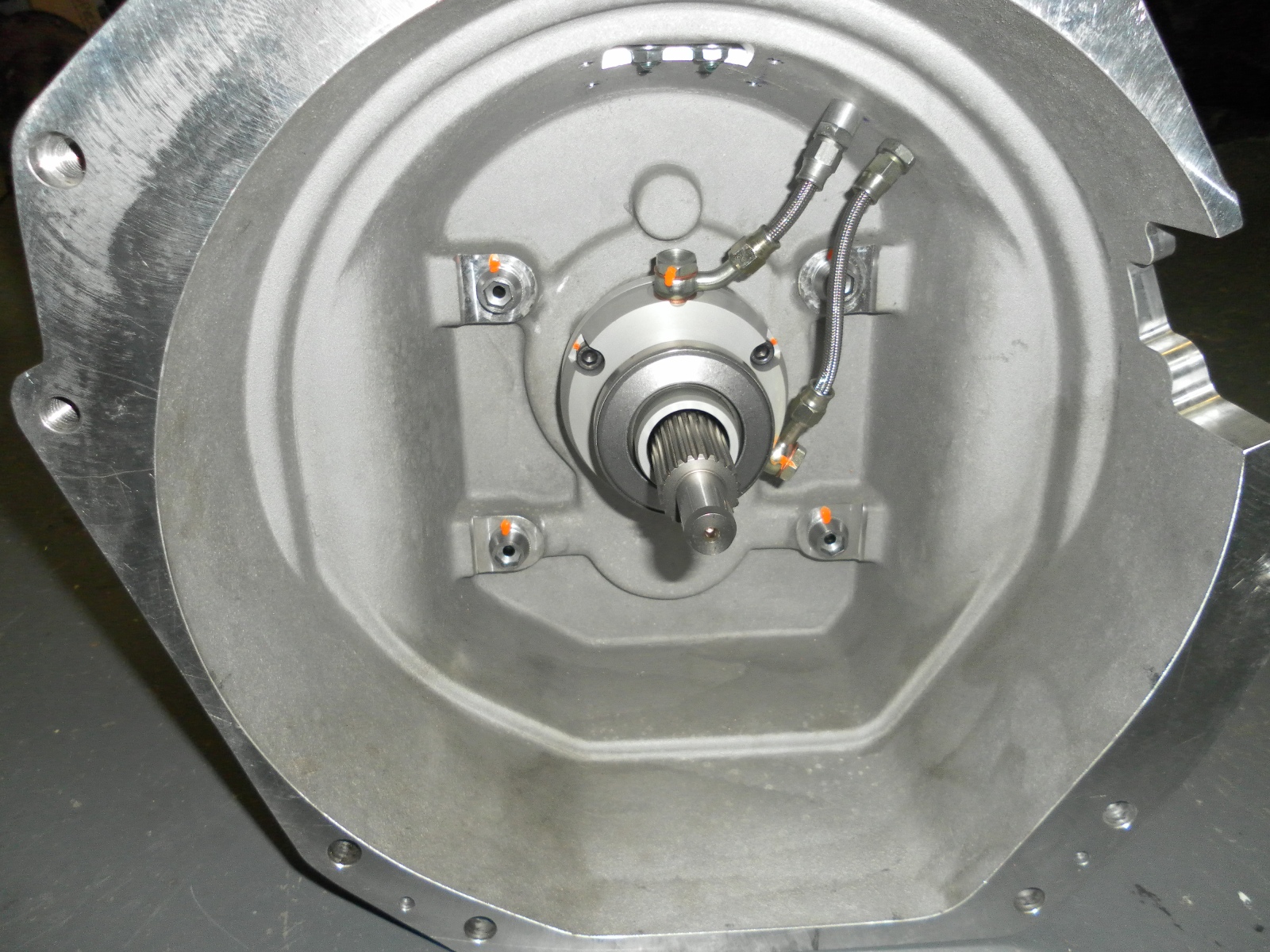

    Mated to this is a Sadev 6-speed sequential. Chosing a gearbox wasn't easy, but this thing ticks all the boxes for me. No need for a gearstick, some compressed air and electrickery takes care of chanaging gears. That's all for the moment; more photos as the build progresses...

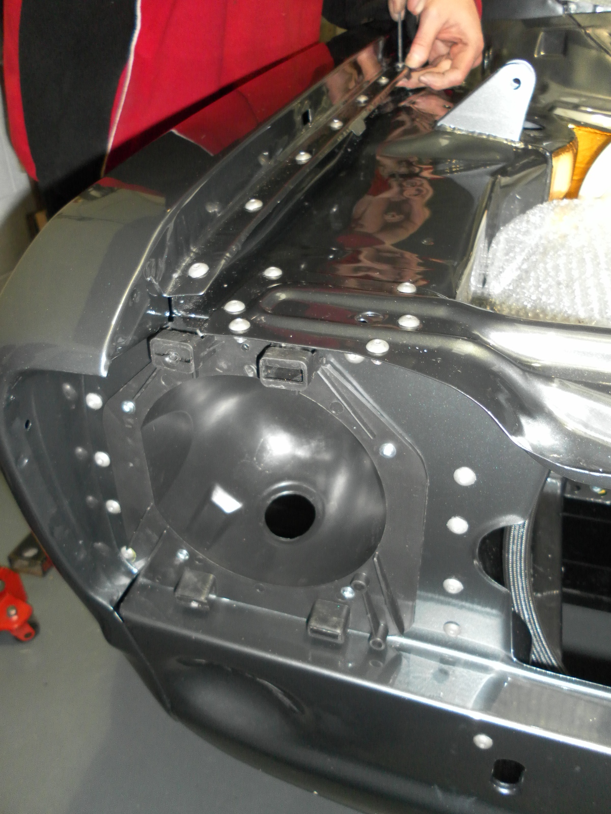

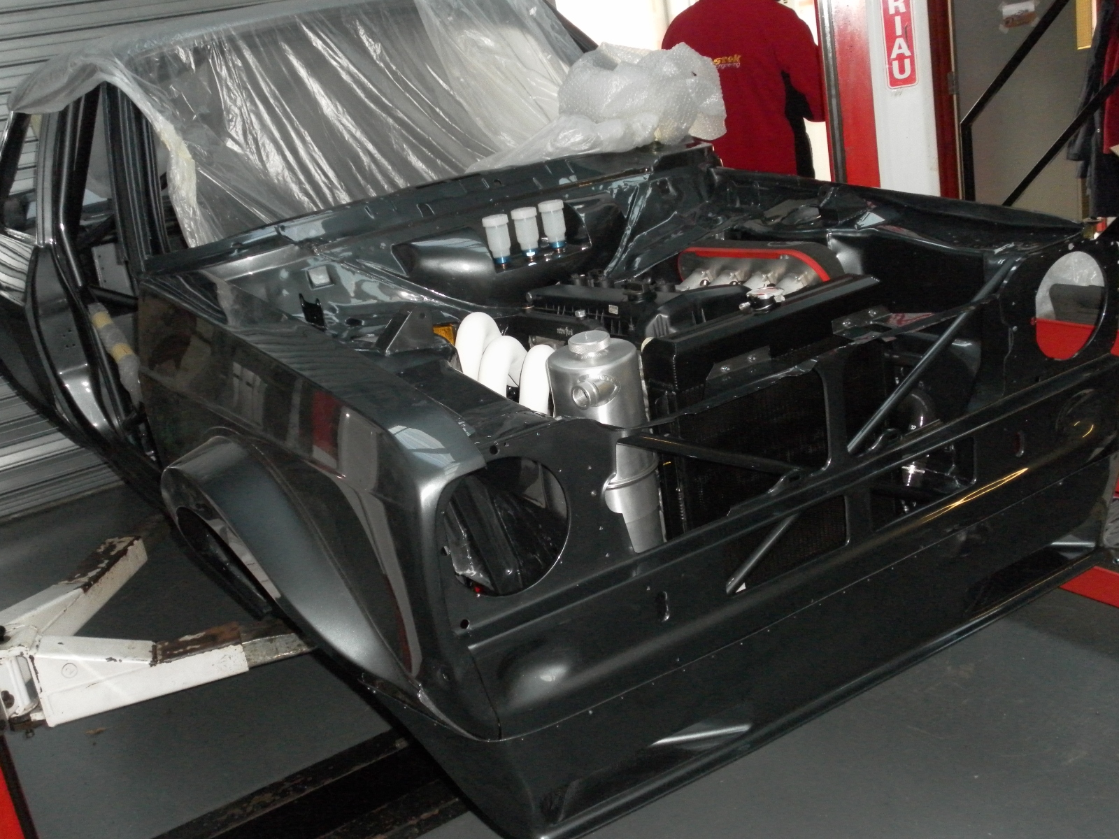

                          Front panelwork is now on for good. The wings, arches, spoiler, front panel and slam panel were all painted off the car and are now bolted-on rather than welded. Apart from anything, it makes installing the engine (well, everything in the engine bay) easier with the panels off, and it means the paint sprayer could do a more thorough job of painting those parts you'd miss if all the panels were on. It looks a bit OTT but I wanted to retain the sort of strength/rigidity that the original spot welds provided. There's about 120 bolts holding the front end together! Don't worry, they are all Aluminium bolts (m4 thread) so weight is negligible. If the car is ever in a prang (pretty likely) then it should just be a case of replacing a panel, no need for taking the whole car to a bodyshop.

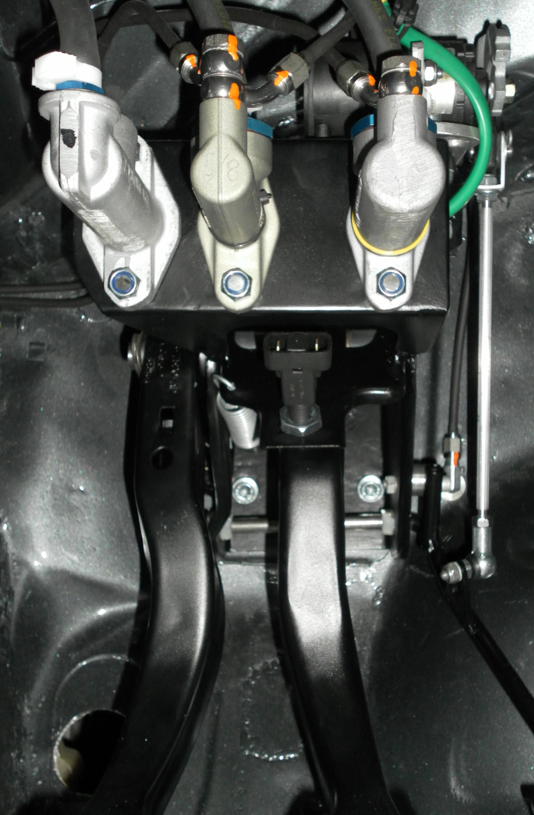

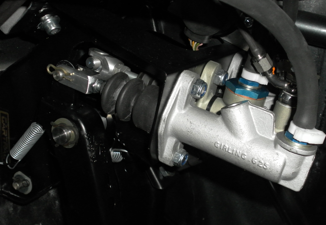

                          Pedal box and brake plumbing is all in for good. The pedal box is a good old fashioned Gartrac job, although it has had the Fostek treatment and is now stiffer & lighter. I did look into using floor mounted pedals, but it just won't work for us, ergonomically, so it had to be underslung like the standard box. To be fair, the Gartrac job is brilliant, I love the thought and design work that has gone into them, and they work very well. I've gone for AP master cylinders rather than the normal Girling type, partly due to them offering better pedal feel, but also because they have a much bigger choice of sizes/bores which can be handy for fine-tuning the hydraulic system. The clutch cylinder is standard issue Girling job, not too fussed about that, it's only used for getting the car off the start line.
                          One thing worth mentioning, (and this was an idea I got from Andy Pipe's TS thread) is that I actually fully plumbed/bled/setup the braking system on the bench prior to fitting in the car. I reckon one of the biggest causes of unsatisfactory brakes in a competition car is the pedalbox either being badly built, or just not set up properly. There is a lot can go wrong! By doing it on the bench, I was able to bleed the whole system and piss-fart around with master cylinder pushrod lengths, bias bar float, pedal height etc etc - the idea being that you want the bar itself 90 degrees to the pushrods when it's under pressure. This invariably means the bar will sit slightly skewed when at rest, but that's fine. This sort of fine tuning is just a pain in the arse when the box is in the car! Another thing I noticed (might be obvious to some people, but I'd never noticed before) was that it was just not possible to PROPERLY bleed the system unless I opened a front and rear bleed nipple at the same time. If you just opened 1, it would seem to bleed ok, except what was actually happening was that 1 MC was running out of travel before the other (only just, but it would be enough to trap air). That's just the sort of thing you wouldn't spot with the system in-situ. So once happy the pedalbox was setup properly, it was all fitted up... Apart from adjusting the front>back bias, it shouldn't need touching now.
                          The throttle pedal looks a bit strange - and that's cos it is. We're using SBD's new fly-by-wire throttle system, so the pedal itself is now really just a sensor, telling the ECU what the throttle demand is, and the ECU then decides how far to open the actual throttle. That's a little aluminium rose-jointed link connecting the pedal to the throttle pedal position sensor mounted on top of the pedal box....

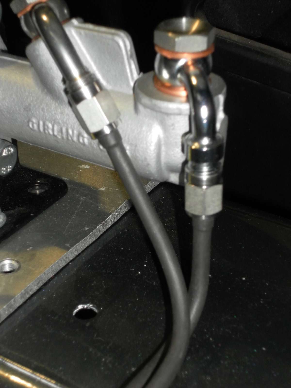

                          The brake lines are a bit different too. I've never been a fan of running braided Aeroquip type hose throughout the car; just no point (although it is simple) - I'd rather use solid lines everywhere apart from those bits that actually need to flex... So what you can see here is a bit of a concoction of Goodridge stainless fittings, banjos etc and good old fashioned kunifer pipe, with some black heatshrink over the top to make it look neat.
                          I discovered an INCREDIBLE method for straightening the kunifer pipe (wibbly wobbly brake lines are my pet hate) - it involves a vice, mole grips, and a big hammer - check this out: http://www.youtube.com/watch?v=LvGEKaaPf5E
