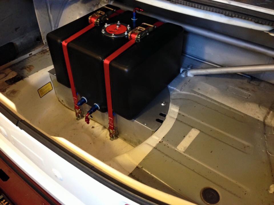

                All strapped in nice and tight. Eyebolts at the front also clamp down the ally base and one of the rears doubles up as diff hanger bolt through the bracing. Next to bolt down the swirl pot and pumps, and finish plumbing it all in..

                  #143
                  Re: DW's Sapphire Cosworth race car
                  Does the tank come with the straps or is it your idea....i think its a very cool way of doing it.....cheers mark
                    #144
                    Cheers. I had straps already so just used some M8 eyebolts for the floor and welded up some long M10 eyebolts for behind the tank as they go through the diff xmember, in fact one also acts as a diff mounting bolt going through the brace that Graham made.
                    It will be easy to make metal straps later if required but I prefer this method as its very tight without harming the tank.

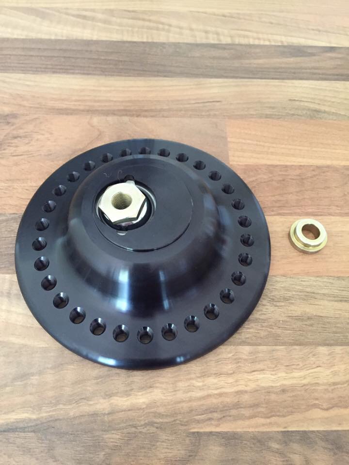

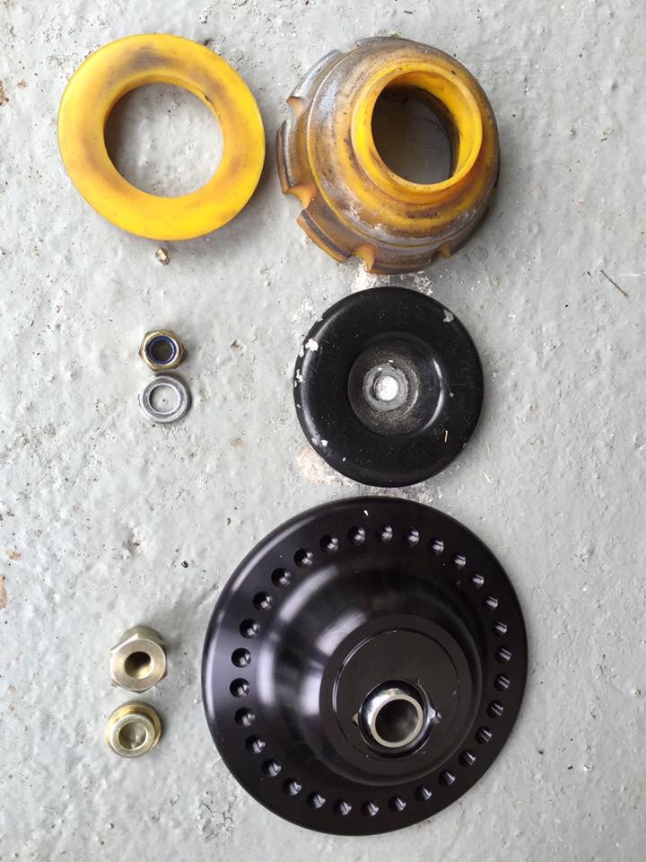

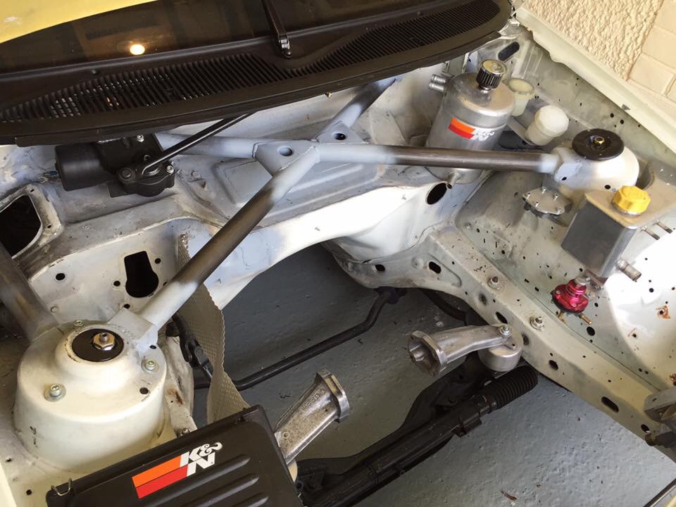

                        Been a tough couple of months but I'm finally getting time (not much) on the cossie again.
                        Am upgrading the front suspension, adjustable TCAs, comp struts and forward anti roll bar etc and these turned up today;
                        New comp brake top mounts. Fit beautifully and I know the adjustment isnt as great as some but I will have other means of adjustment too.

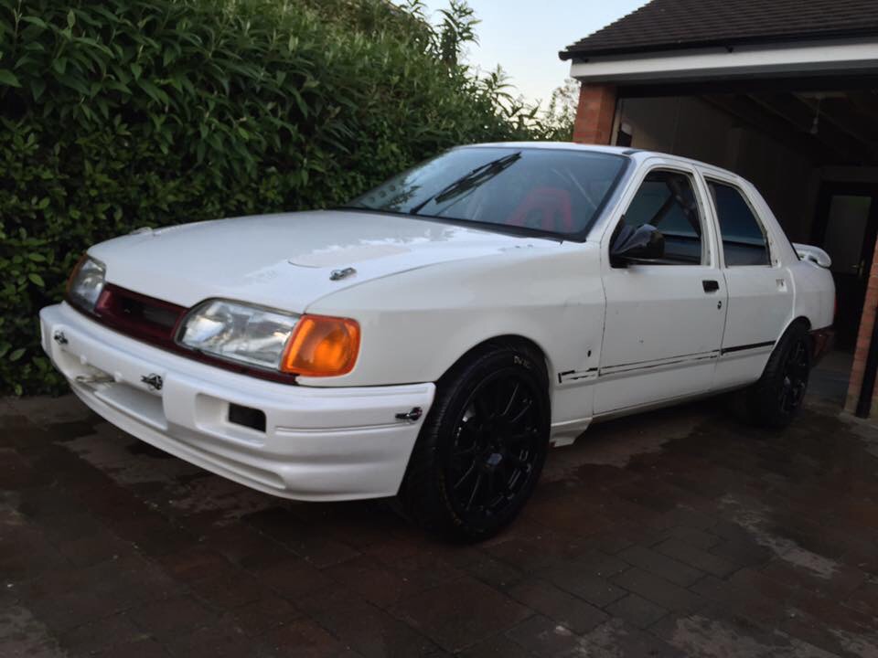

                          Also got the car outside and gave it a good wash and started flatting down some of the panels just with 1000 & 800 grit wet and dry and soapy water. There are a few dents that will come out easily and I'll try to get the adhesive off this week from the black mouldings.
                          Overall im pretty happy with it so far and its mainly the sunroof and a bit of arch stretching to do and then into paint hopefully

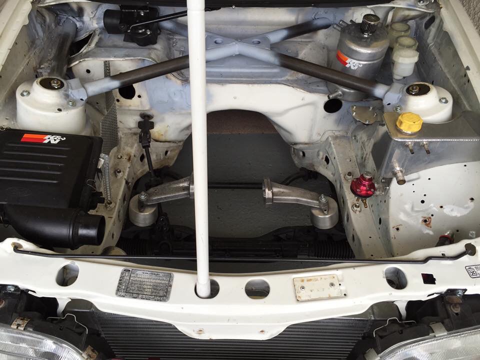

                            Compression struts on, not adjusted up yet. Gonna do a basic alignment tomorrow.
                            Next is the front mounted ARB which should arrive tomorrow

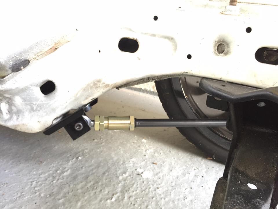

                              Nice kit Dave. You got a bladed anti roll bar to go with them?
                              Screaming 1300 mexico rep
                                #150
                                Yes mate
