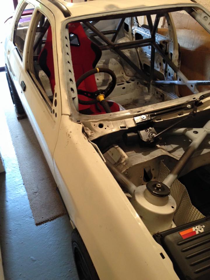

    Tonights effort..

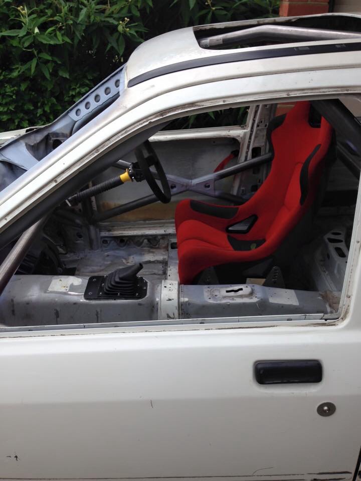

        Can you tell me more about your gear lever gaiter surround? I need to do something similar.
        Did you fab it yourself or was it a purchase?

          Re: DW's Sapphire Cosworth race car
          Originally posted by IainRS17T
          Good to see it coming along David.
          Iain
          It was a std cossie gator and we made the rest with aluminium plate. It fits to the tunnel with M6 rivnuts

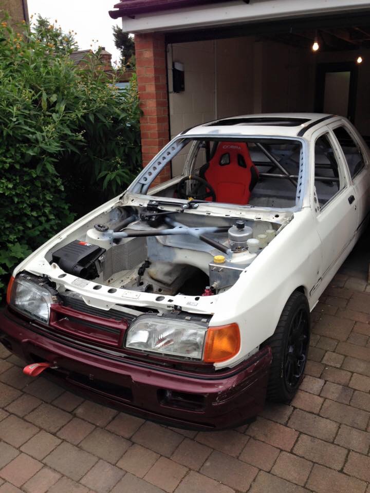

            #95

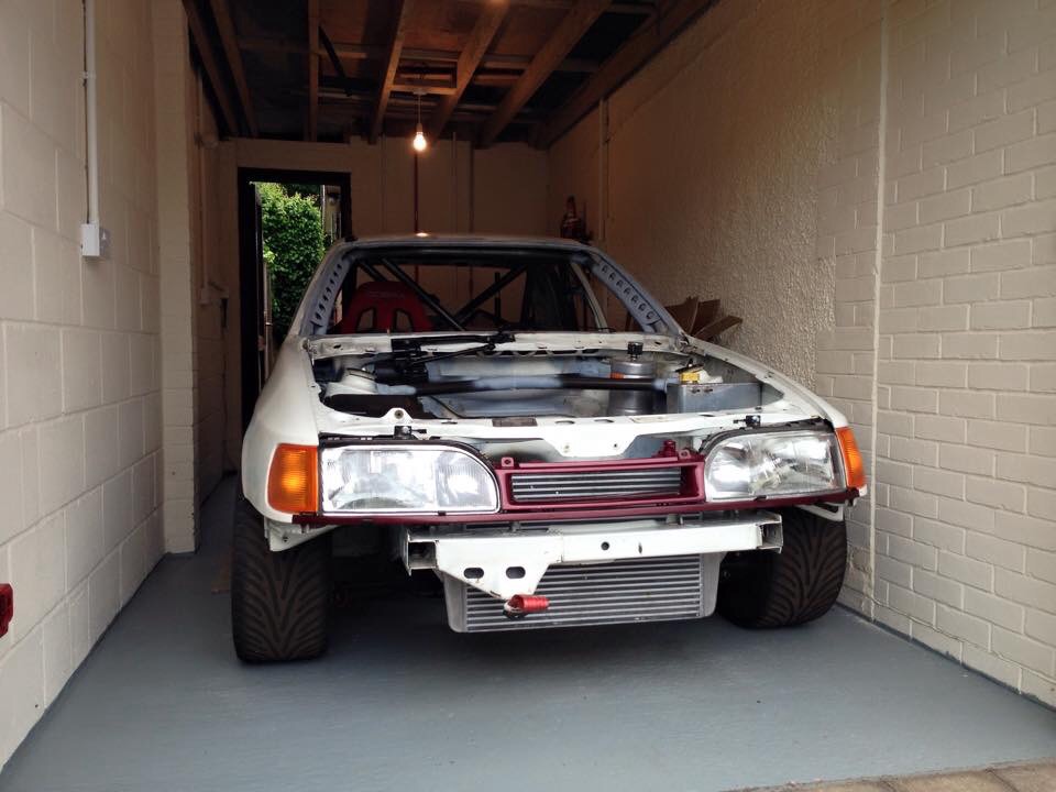

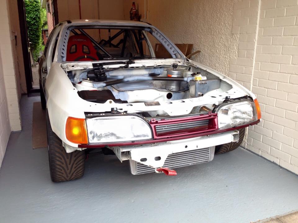

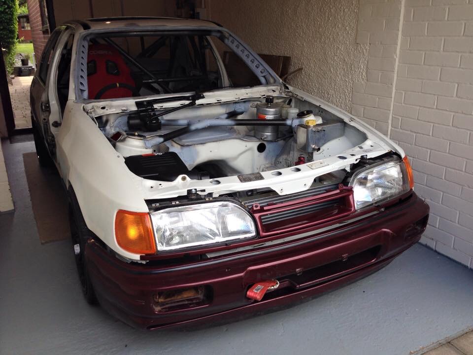

            Stuck the std cossie bumper on for now but wont be using this as its fecking heavy! Gonna order up some new lightweight panels next week hopefully
              Cheers David, I best get my scrap metal box out then!

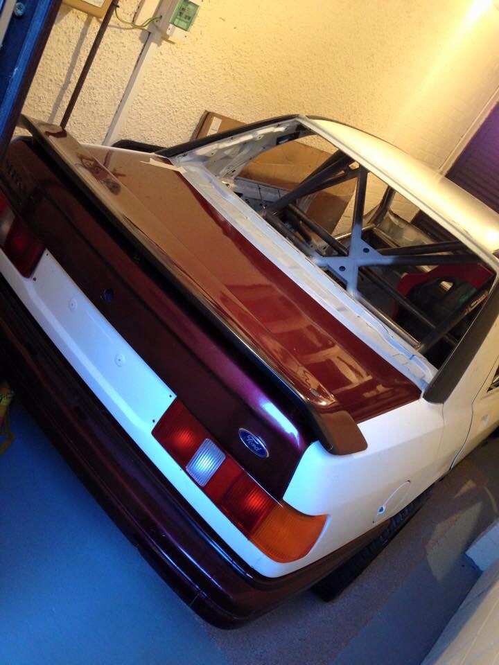

                  Using my steel bootlid until a fibreglass one can be fitted. I am going to cut out as much internal skin as pos so that it is fairly light. This will serve as a good spare too as it will be fitted on pins and be interchangeable with the glass one

                          Front doors done, rears coming off for lightening next..
