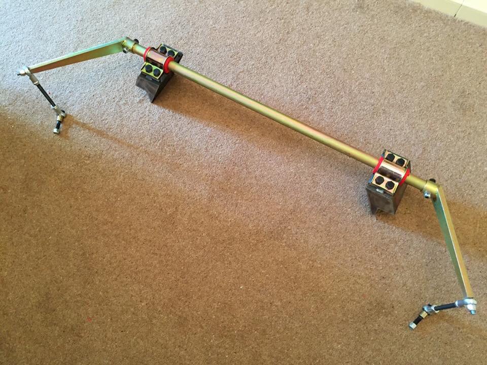

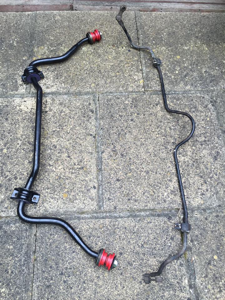

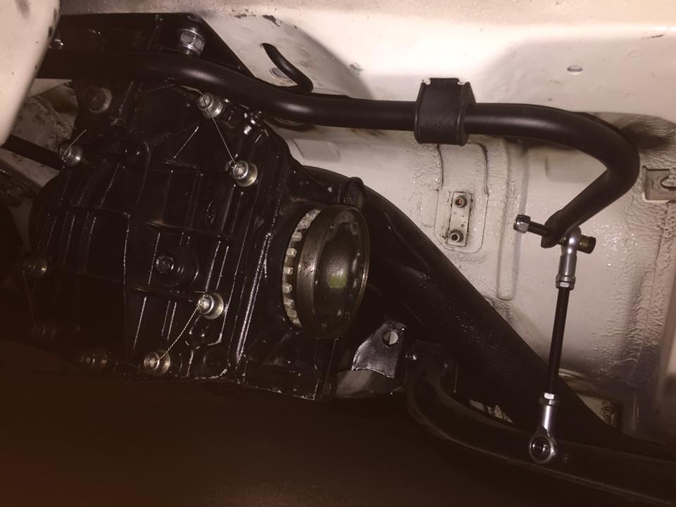

        Fitted my 4x4 anti roll bar that I had in stock, have modified it to accept the drop links that I will be making this week (not the mocked up ones)
        Old 3 door ARBs now surplus to requirements

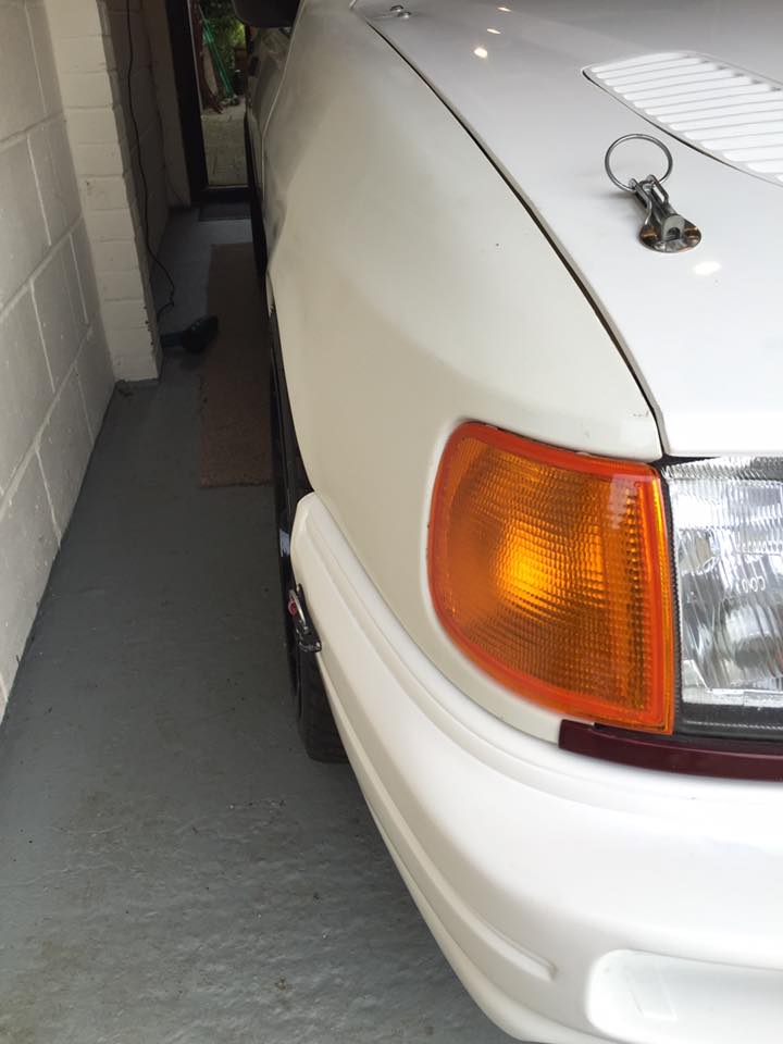

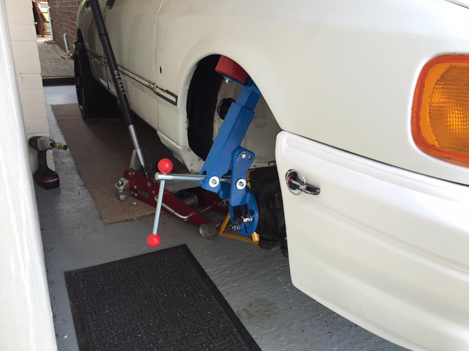

              Got one arch rolled nicely to cover the tyre. (pic is before starting!) Other front should be straight forward but I'm sure it will be a struggle to get the rears out as far as I need. Fingers crossed.

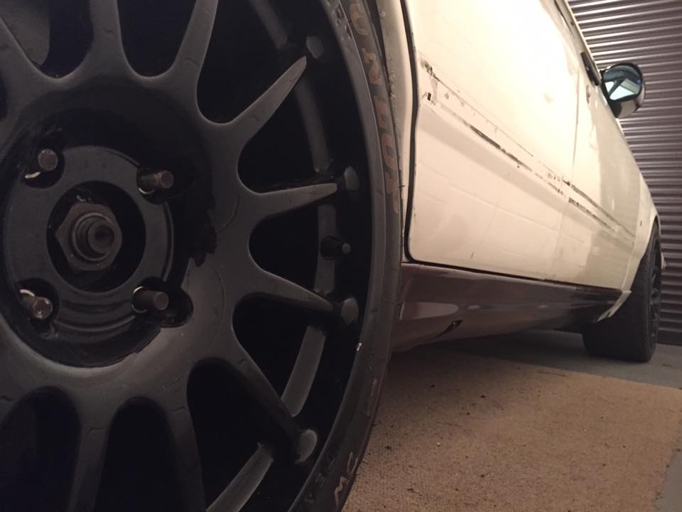

              Also fitted a good pair of side skirts as the white ones had seen better days. Just got to finish removing the adhesive from the door mouldings, hoping thinners or petrol might do it easier.

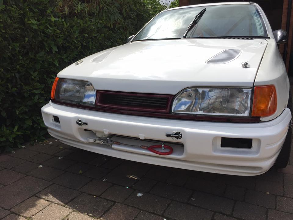

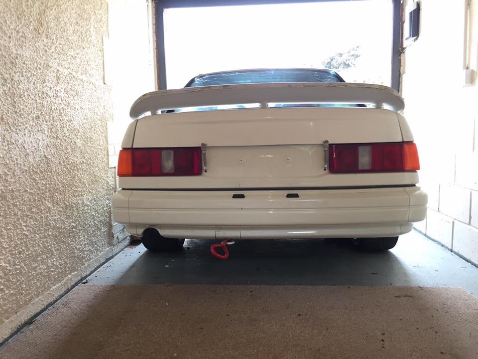

                Fitted the tow hook using a D shackle for now to save chopping anything about, still not convinced these will stay. Will unclip easily from the bumper in use.
                Have also acquired a set of inters, just got to sort the wheels out now, namely the 15mm too much offset on the rears. Will probably involve ordering a set with around ET35 to use as rears while keeping the ET23s on the fronts.

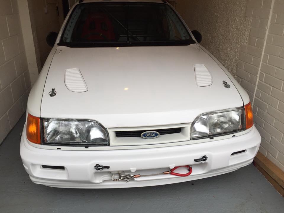

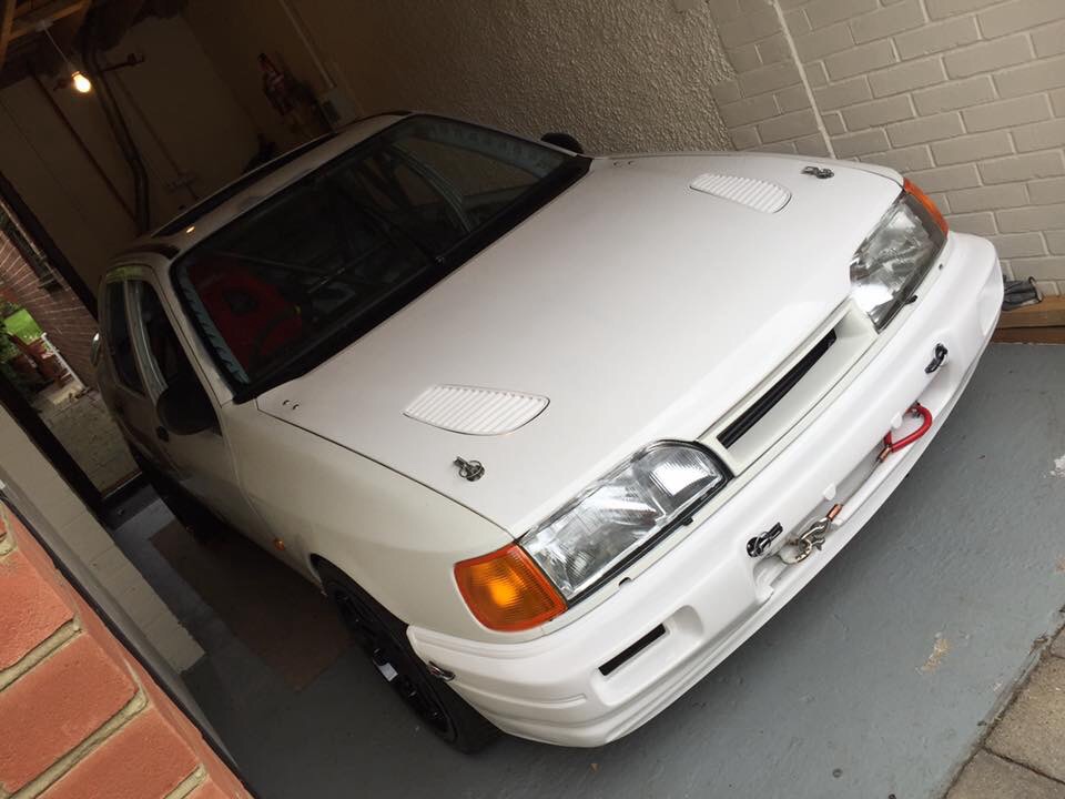

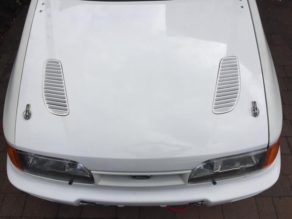

                  Had a bit of sun today so cleaned up the grilles and gave them a coat of paint.
                  Looks more like a car again with its Ford badge
