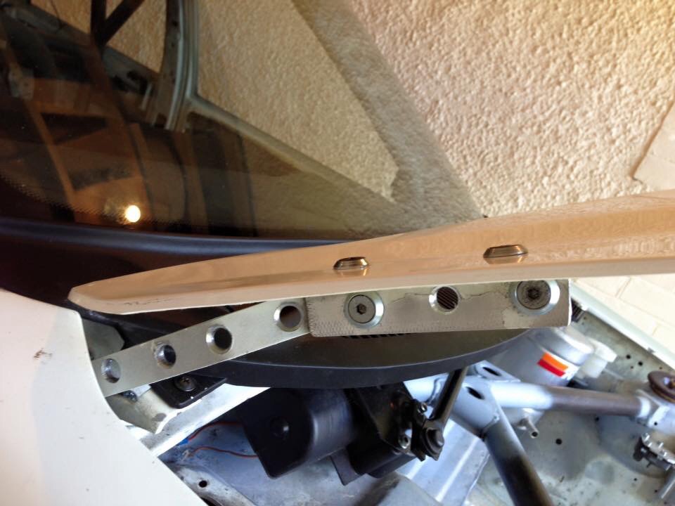

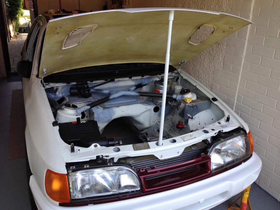

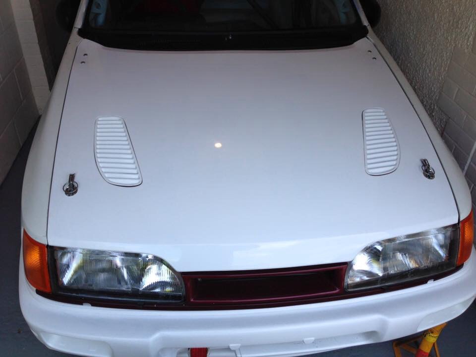

    Bonnet pins done, lightweight hinges etc. Doesnt line up too bad!

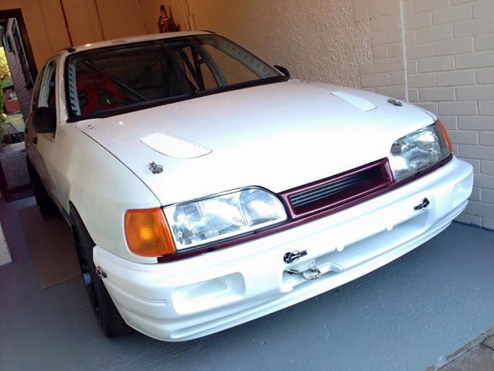

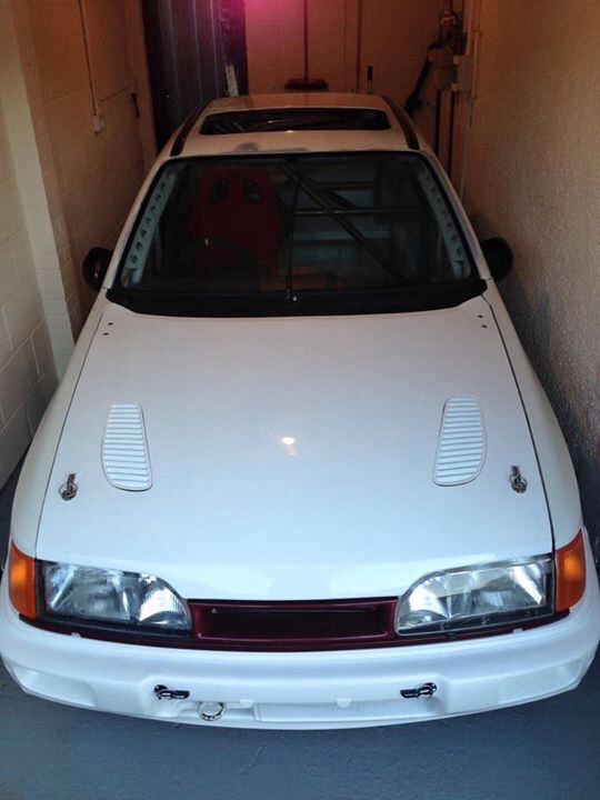

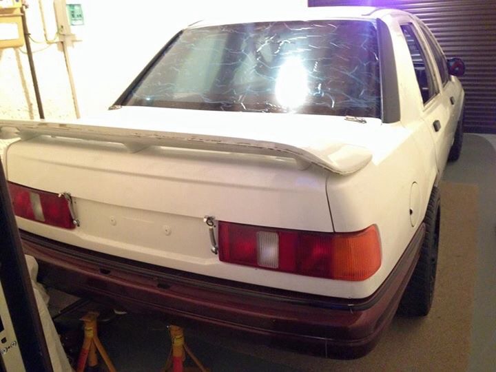

                Fibreglass panels, bonnet pins and boot springs all fitted and Rouse spoiler bolted to bootlid
                All of the panels fitted very nicely with minimal fettling
                Just gotta whack a couple of pins in the back of the rear bumper now..

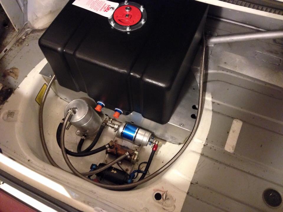

                      Been quiet lately but i have a new tank and will post some updates this weekend as the fuel install is almost complete. Just need to sort the poxy sunroof apature and get it in paint asap!

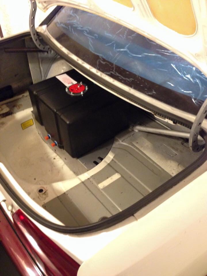

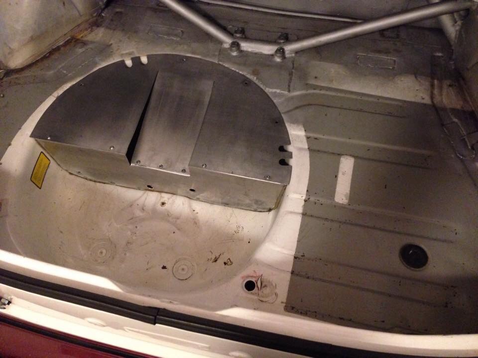

                            My new Jaz foam filled tank arrived and as it has a sump in the centre I made a matching ramp in the middle of the tank stand so it sits perfectly. The pumps and swirl pot (which is probably ott with the sump now, but better safe than sorry) are gonna be on the open half of the wheel well now rather than under the cover so that they are easier to get to and any small leak could be spotted straight away.
                            Straps going in today, loads of new fuel fittings on order and will mount all of the pumps etc in the week

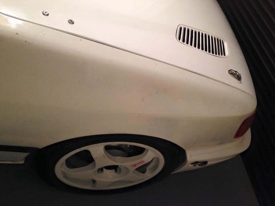

                                Got some nice oz wheels on the car. They are too narrow for the race tyres unfortunately but I'll either keep them as for rolling around to prevent ruining the slicks in the garage or I might even sell them on which would be a shame as they are my favourite rims. Unless someone can band alloy wheels lol..
