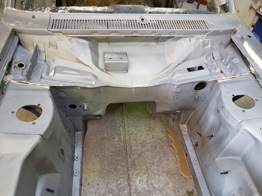

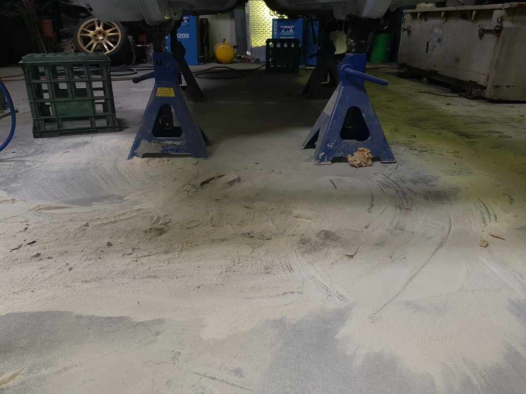

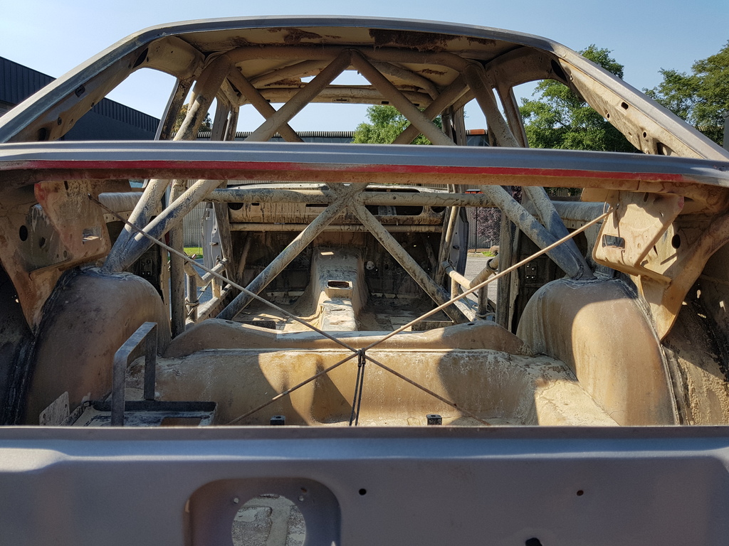

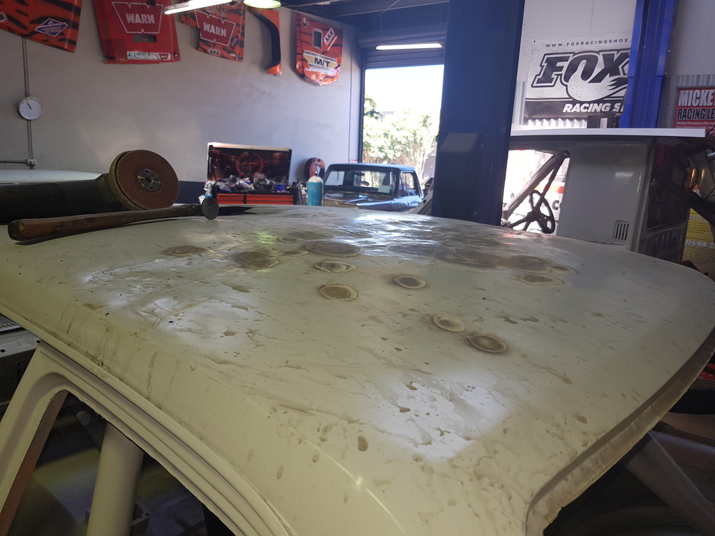

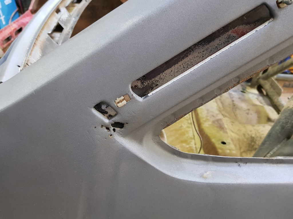

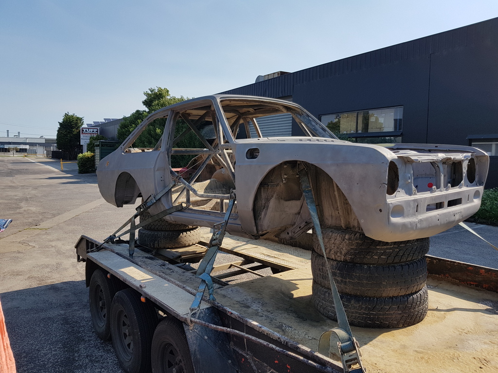

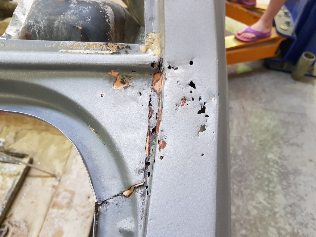

    After.... A few issues have been uncovered but it wasn't as bad as we were expecting so I'm pretty happy.
    I really wasn't prepared for the mess that was made and the amount of time it took to clean it all out
    Pics show the mess and also some of the rusty bits. All before the primer was applied
    Here's a quick video showing it after being blasted

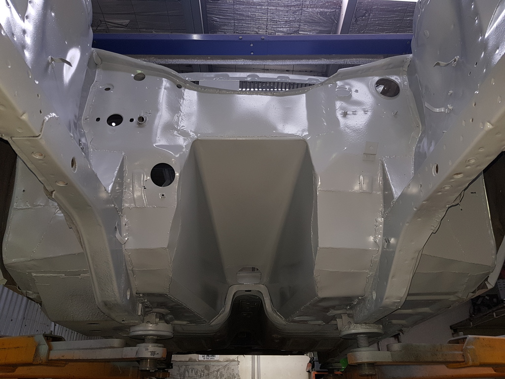

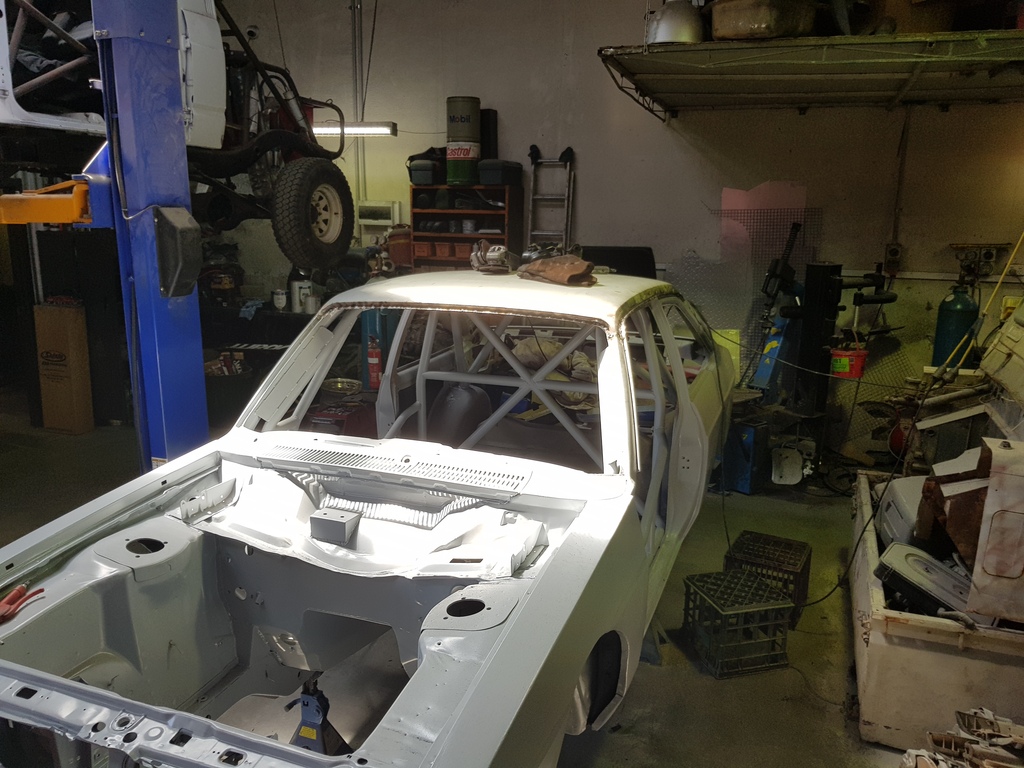

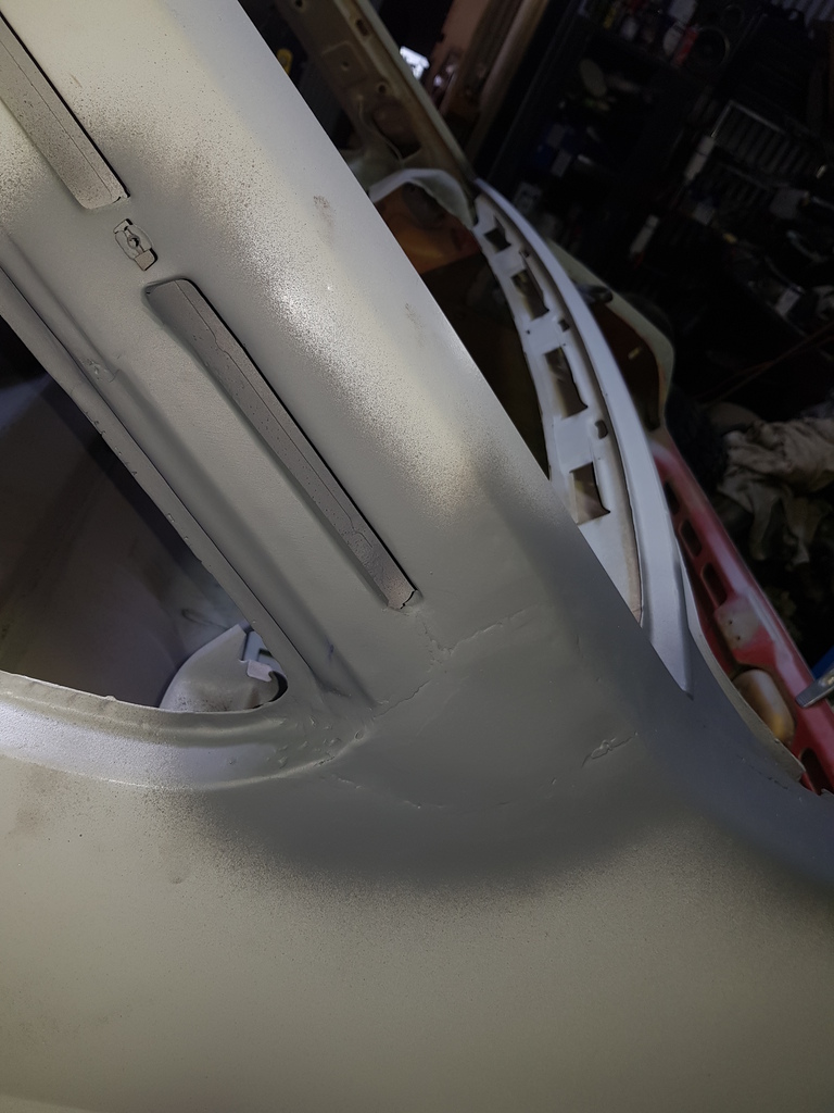

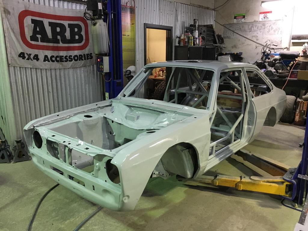

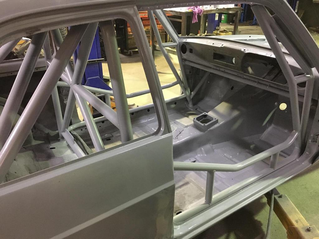

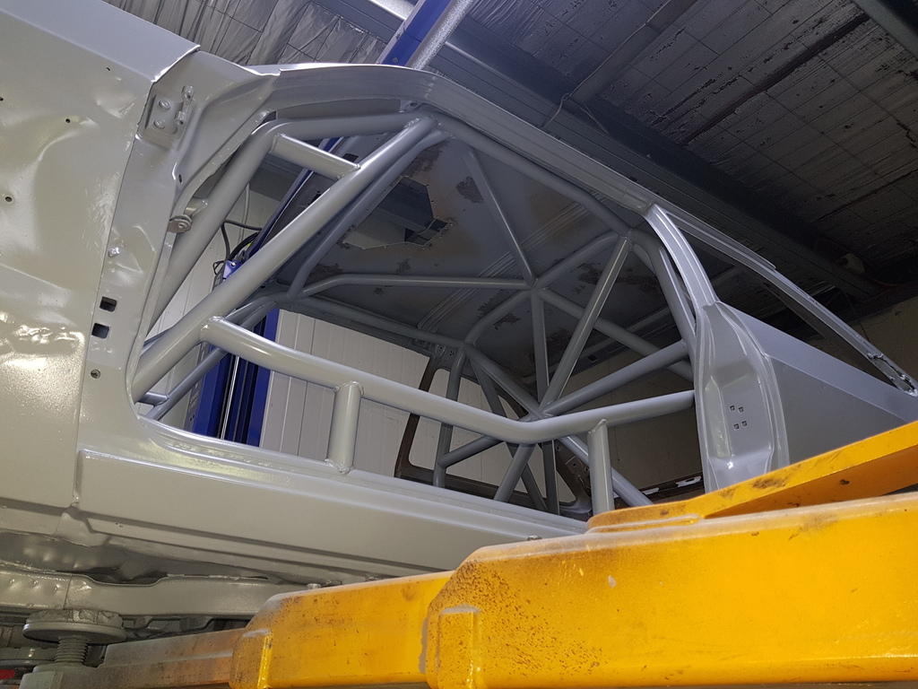

      And now in primer. It's looks so cool seeing it all one color.
      Now the easy bit of panel and paint can begin....lol

              Sorry for lack of updates...Mental time of year!

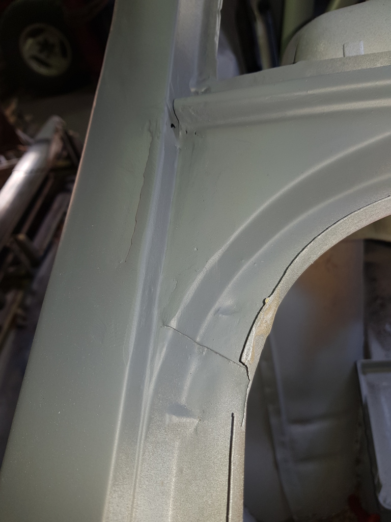

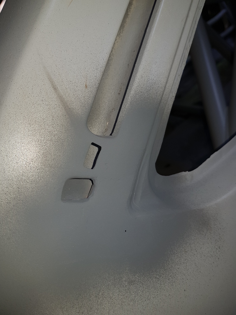

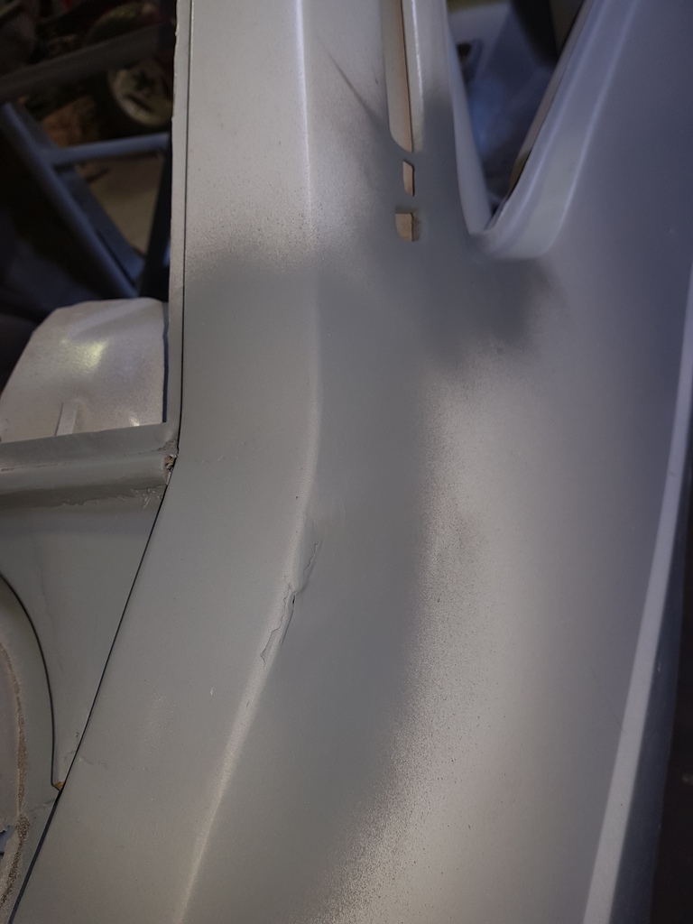

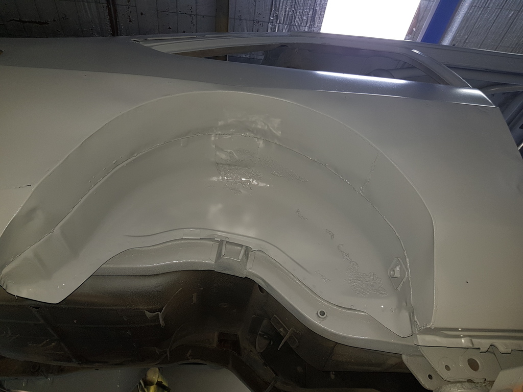

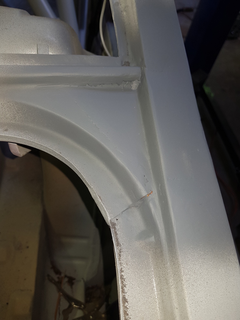

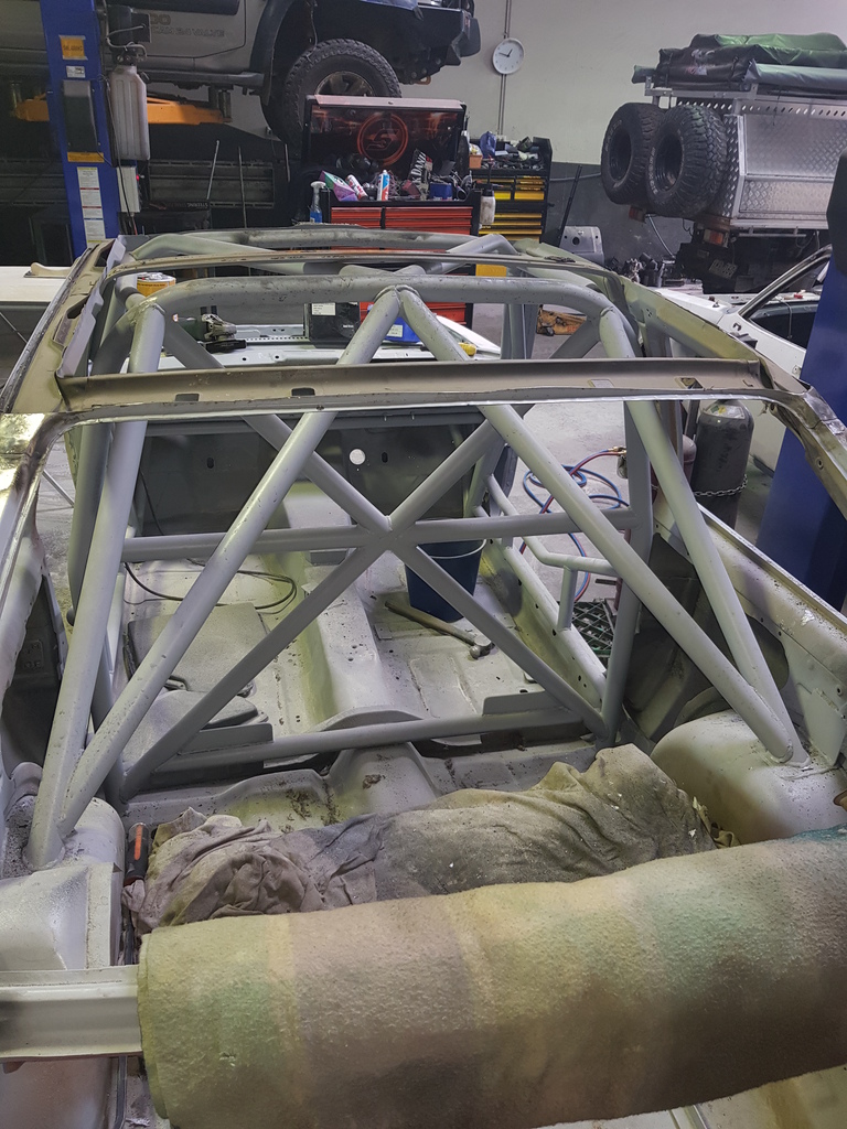

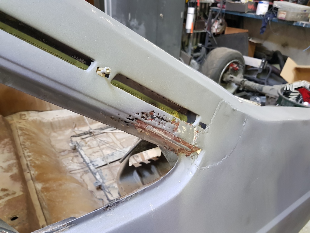

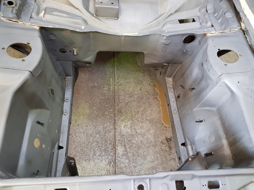

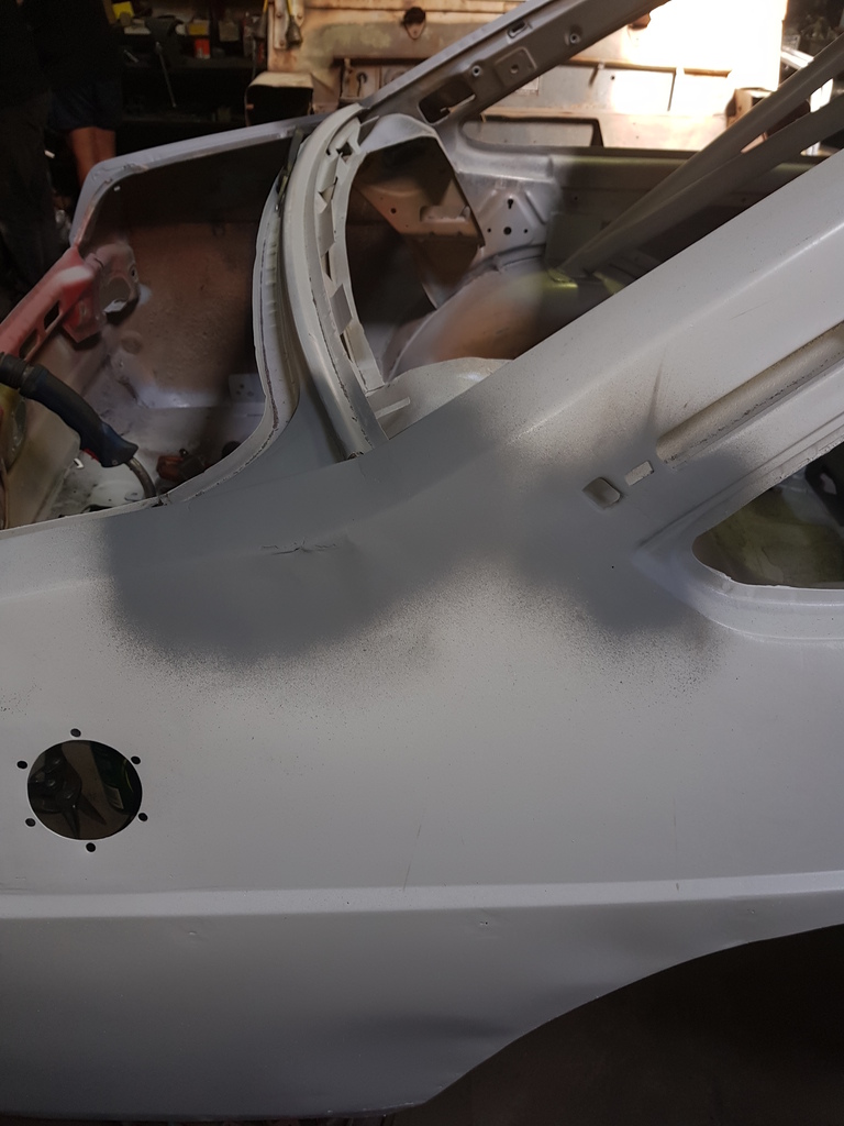

              Rust repairs now done and ready for filler
              Hope to have a big update next week..
              Few pics

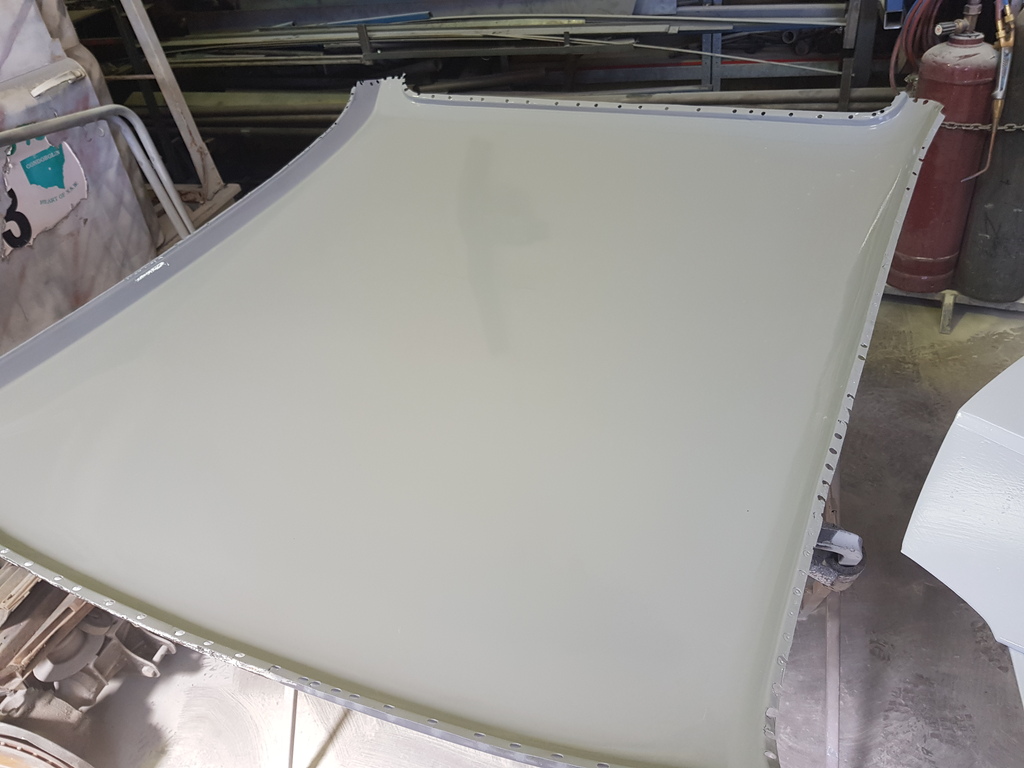

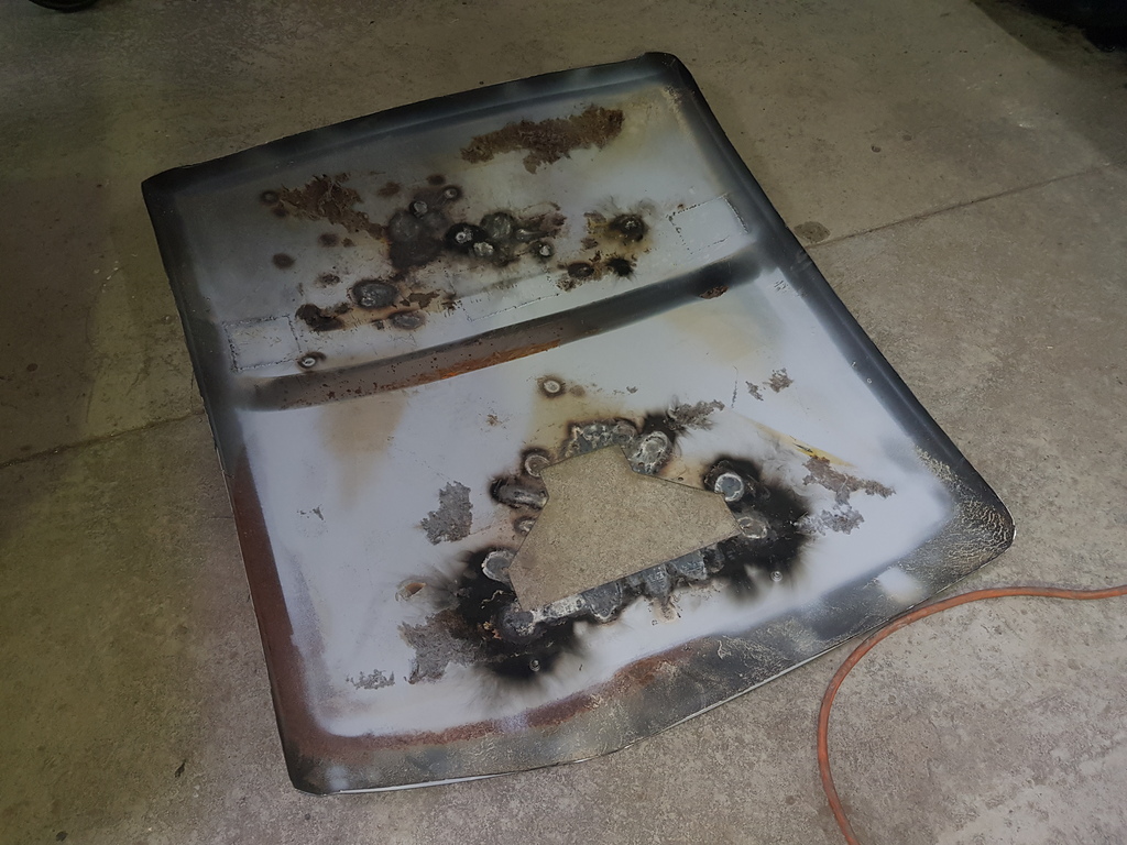

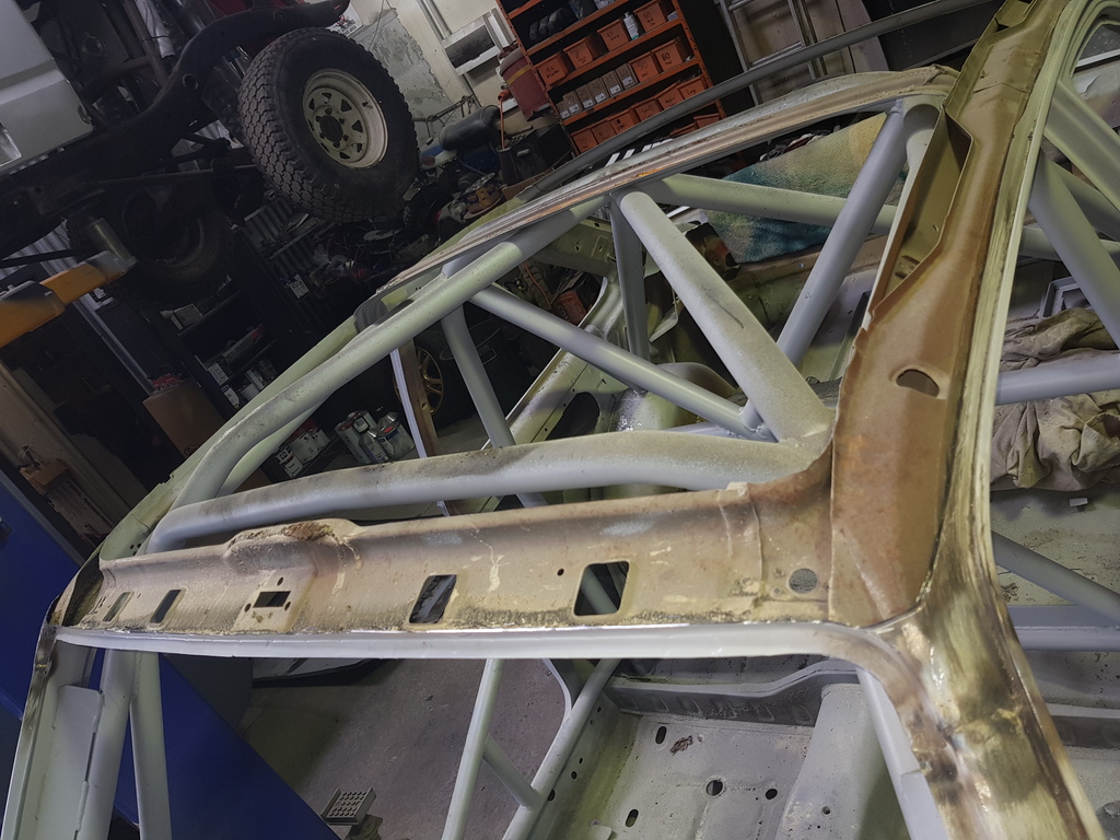

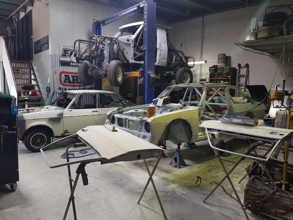

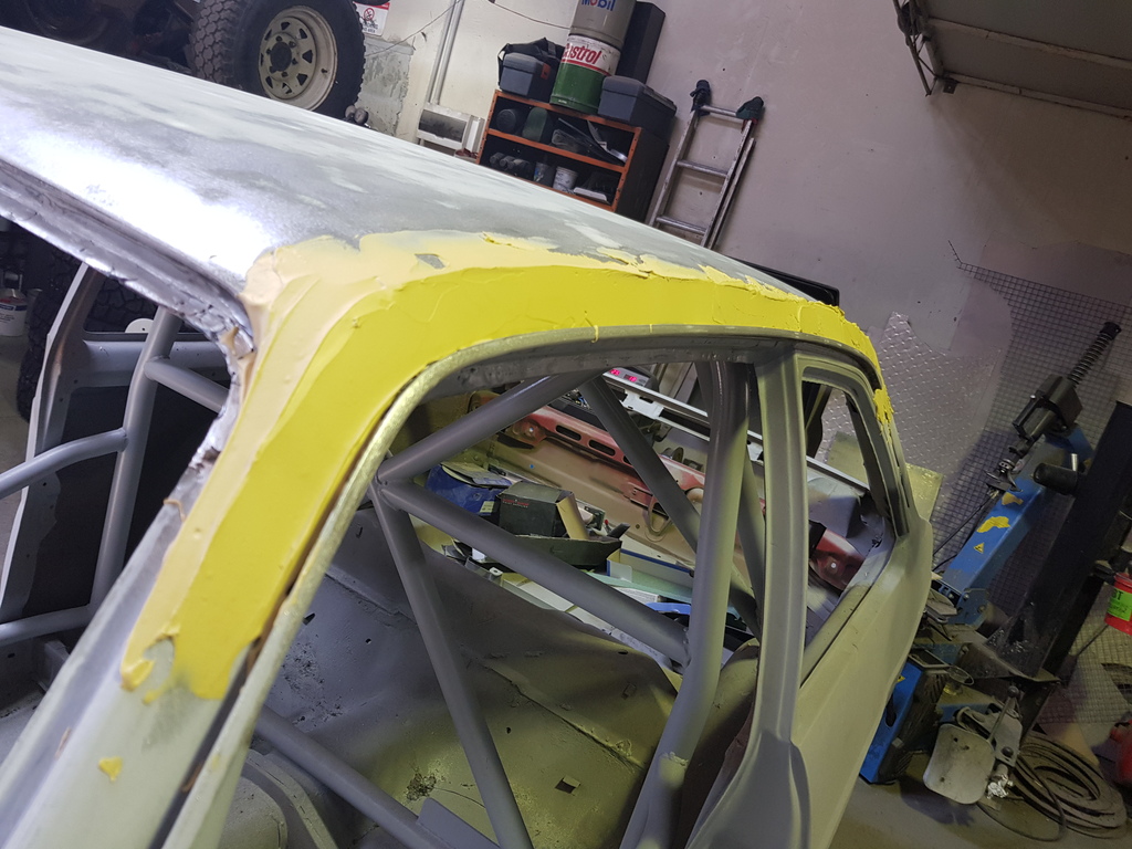

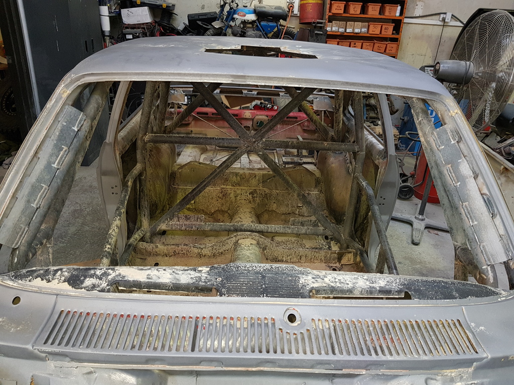

                So lots happening and time for an update

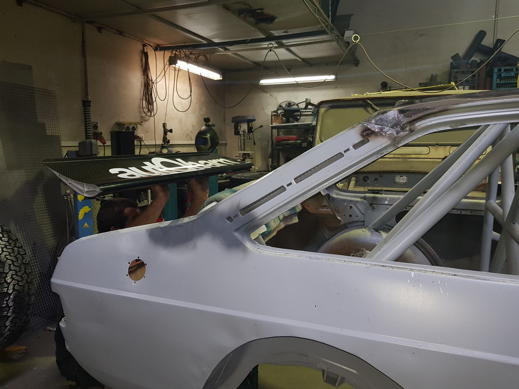

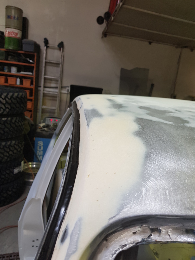

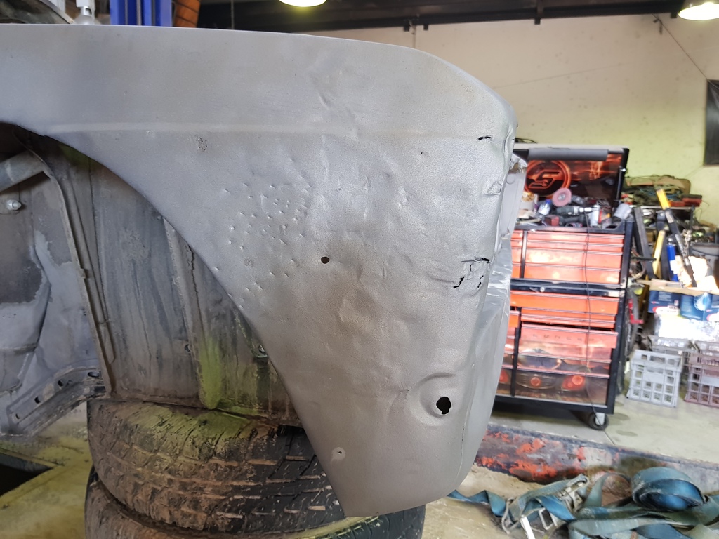

                The sandblasting really did a number on the roof so after 2 days of heating and shrinking we had enough so I bought another shell and we cut the roof off and will do a transplant

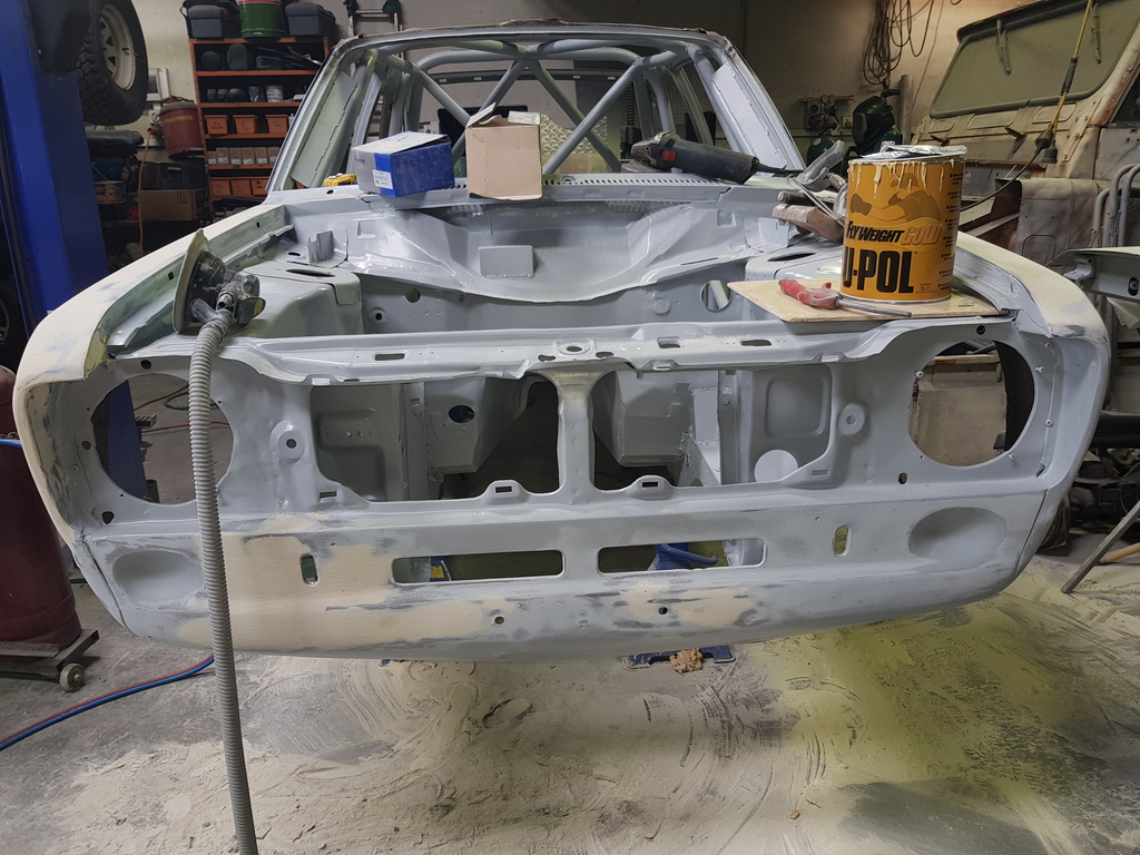

                Body work is going well too

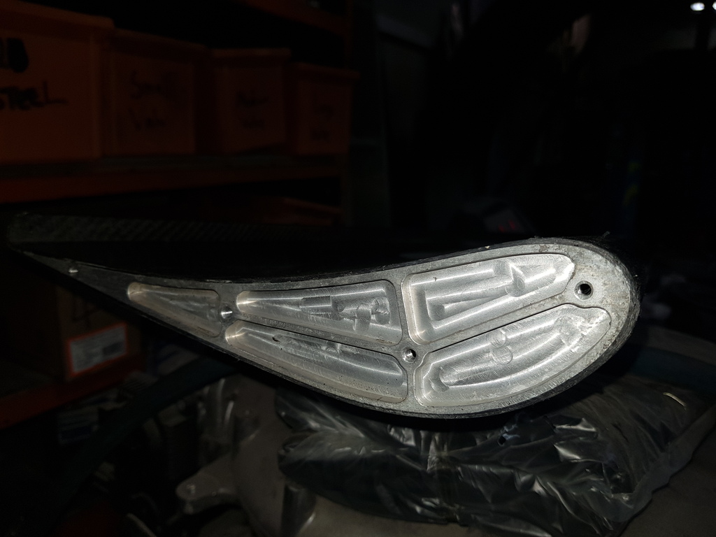

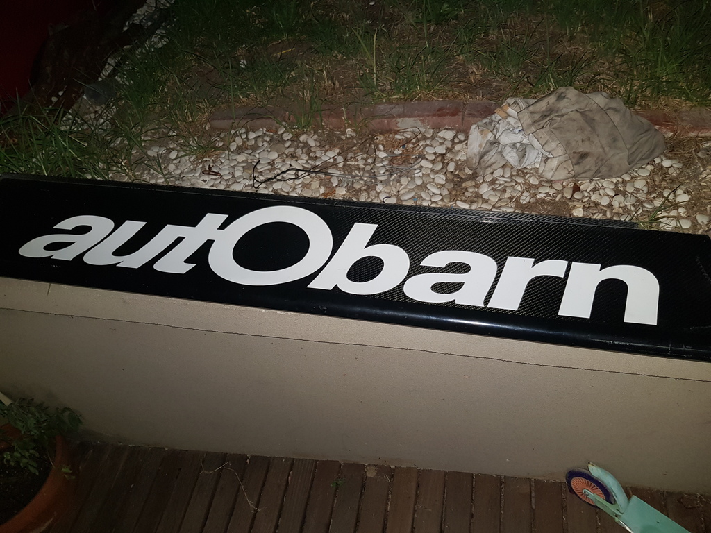

                I picked up an old V8 SuperCar Spoiler that I'll use for the rear wing

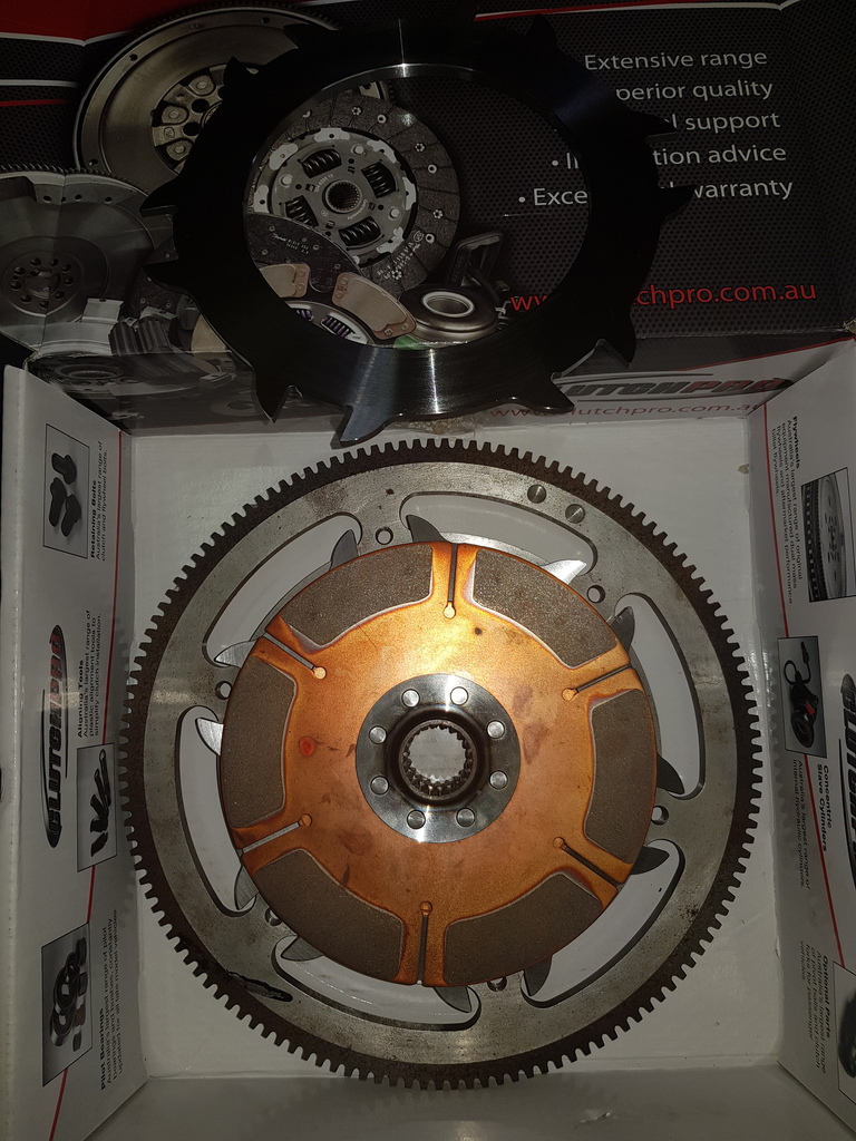

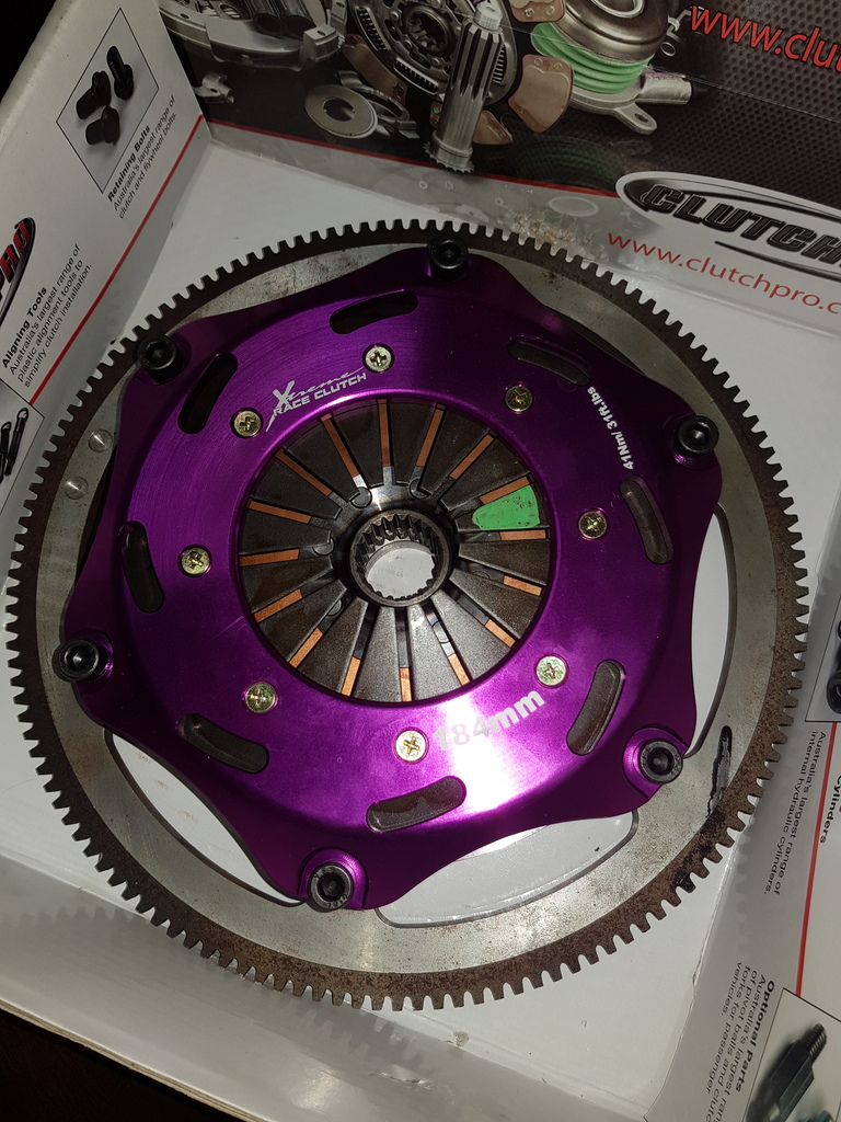

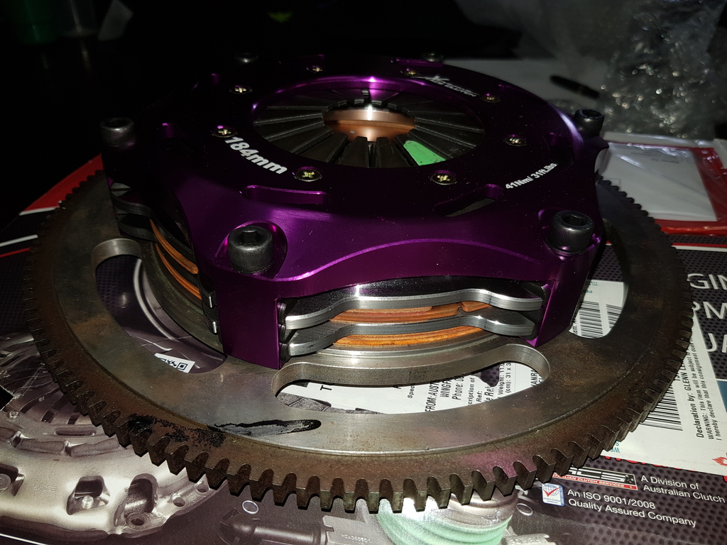

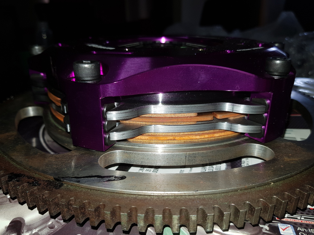

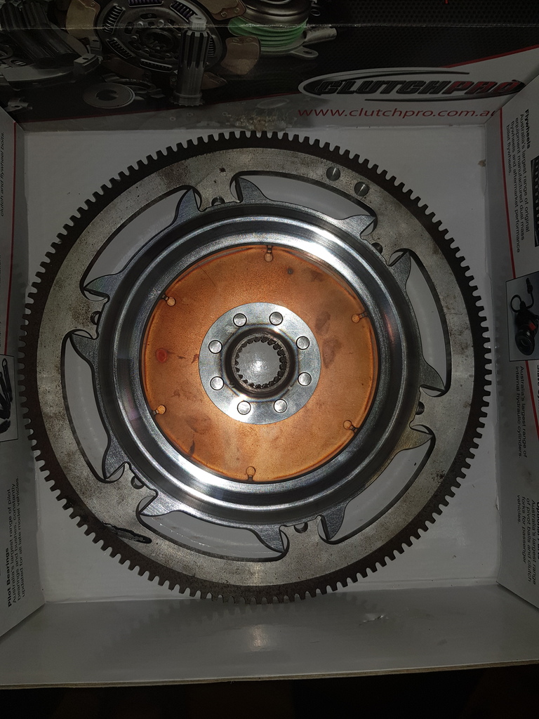

                Clutch has turned up too so another piece of the puzzle sorted. Very nice bit of kit

                  Nice one matt...i hate sanding filler...i can never get it right..lol...looking good..nice result on the spoiler..looks the part...and youve got a whole car ready for when you need spares!...keep moving forward...cheers mark

                      Hey Mate, we have a Car Show my club runs (Small Ford Sunday) in 2 weeks that I am hoping my will be at all finished so we are pushing hard
                      Do you have any measurements of your side mounts (horses heads) for your rear spolier. I'd love to copy it as I'll get it laser cut from Alloy I think

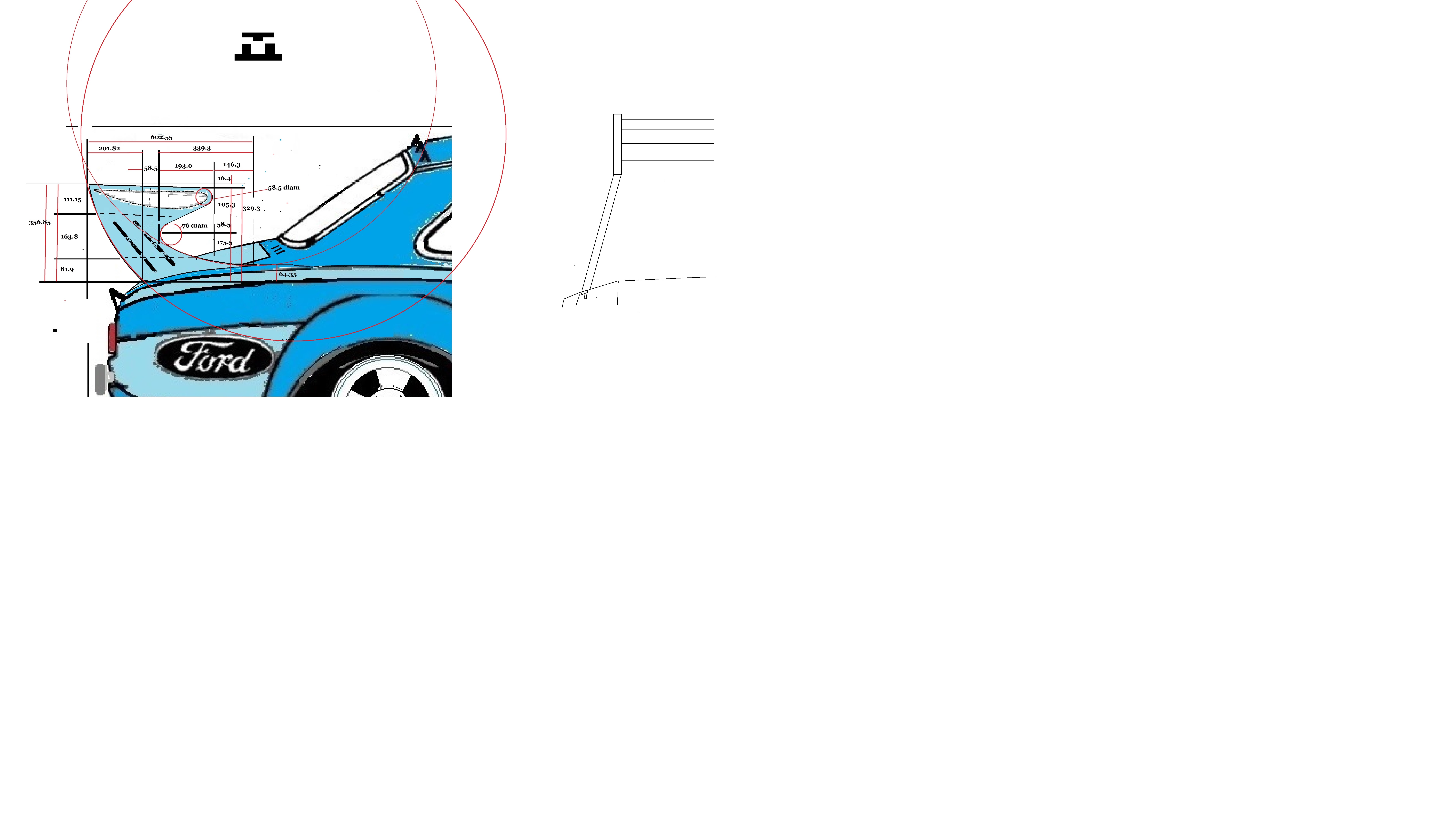

                          Matt
                          wow..be great to get there...good luck..
                          This is the only drawing i have....
                          but might help...make a cardboard template and adjust to suit..
                          cgeers mark

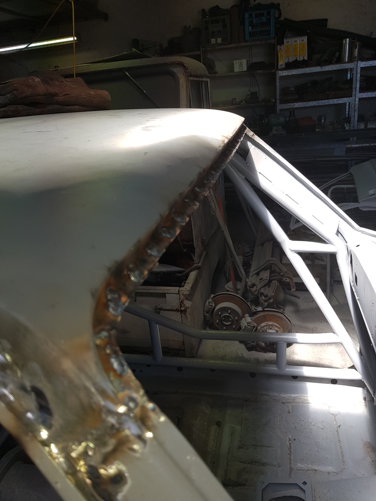

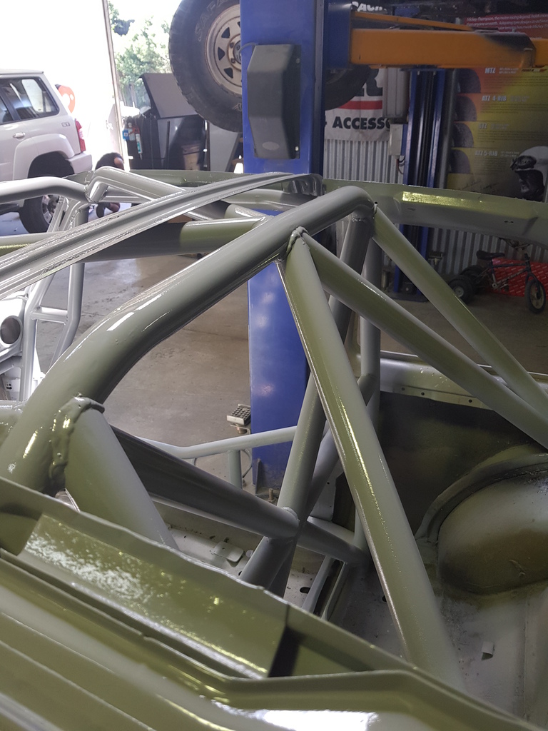

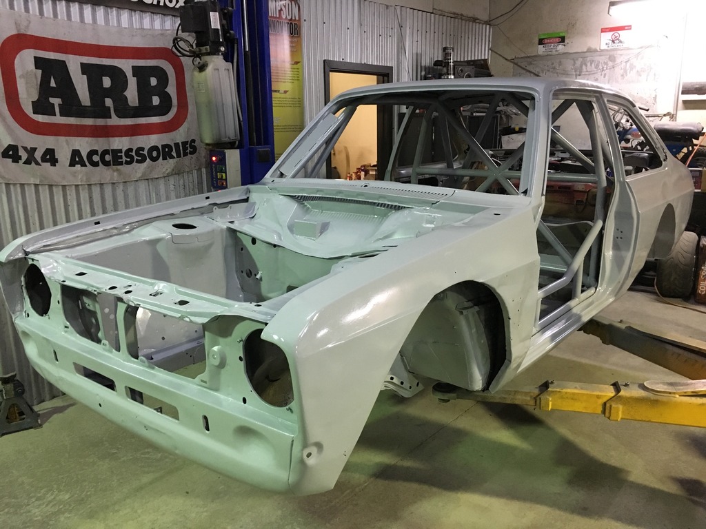

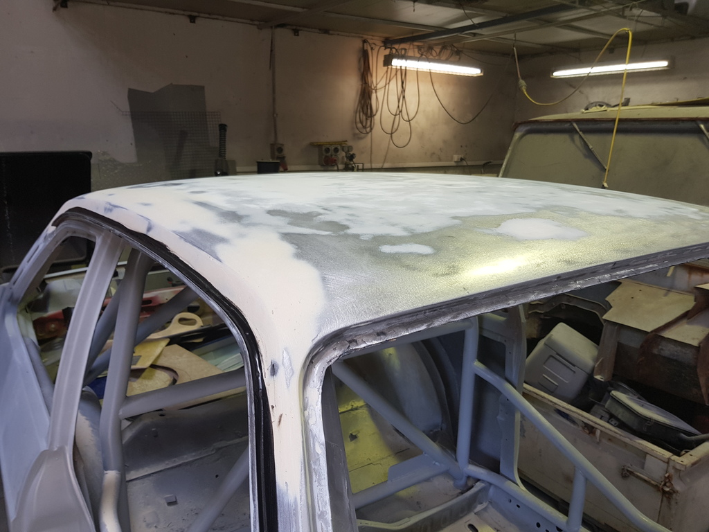

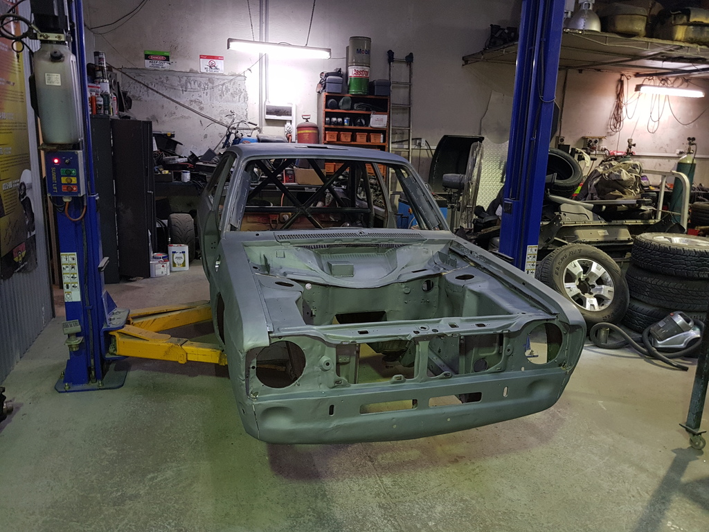

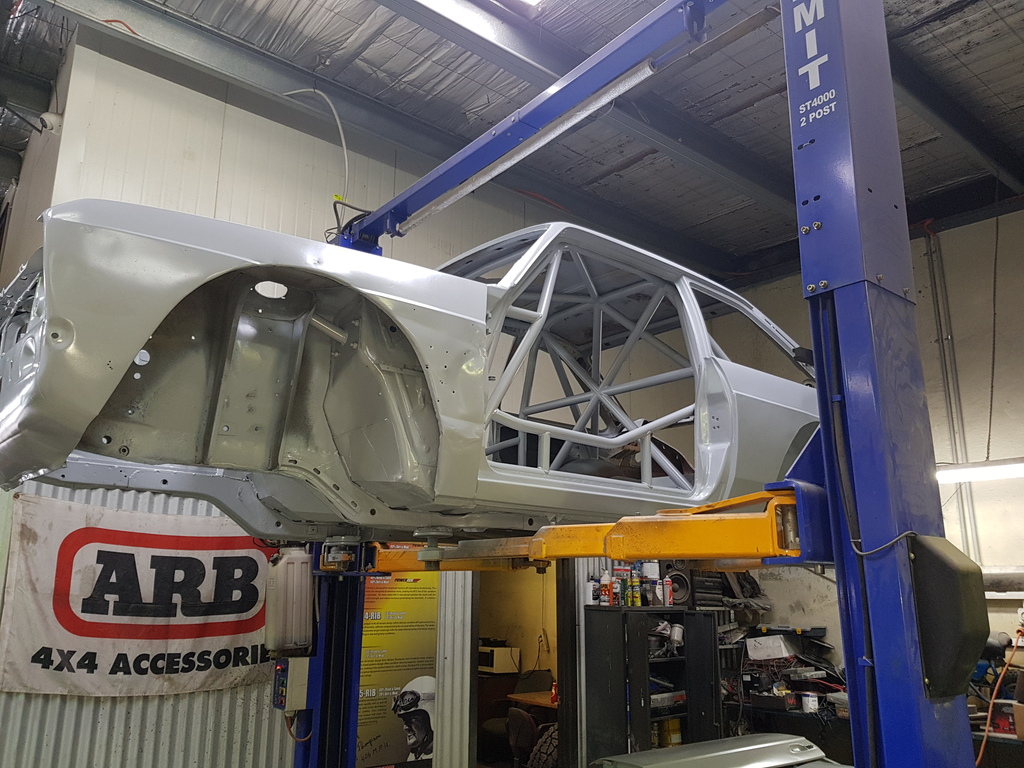

                            All guns firing now

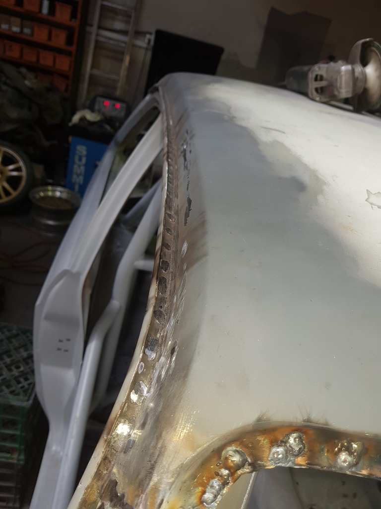

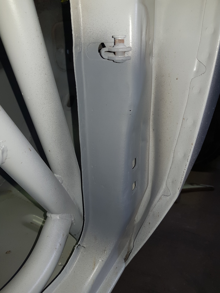

                            Were painting the interior grey so whilst the roof was off we painted the top of the roll cage and the inside of the roof
                            New roof was then mig welded back on using the spot weld holes the ground back
                            Then filler over the top to smooth it all off with sikaflex over the welds to smooth them off and stop and liquid getting in their
                            As it sits tonight

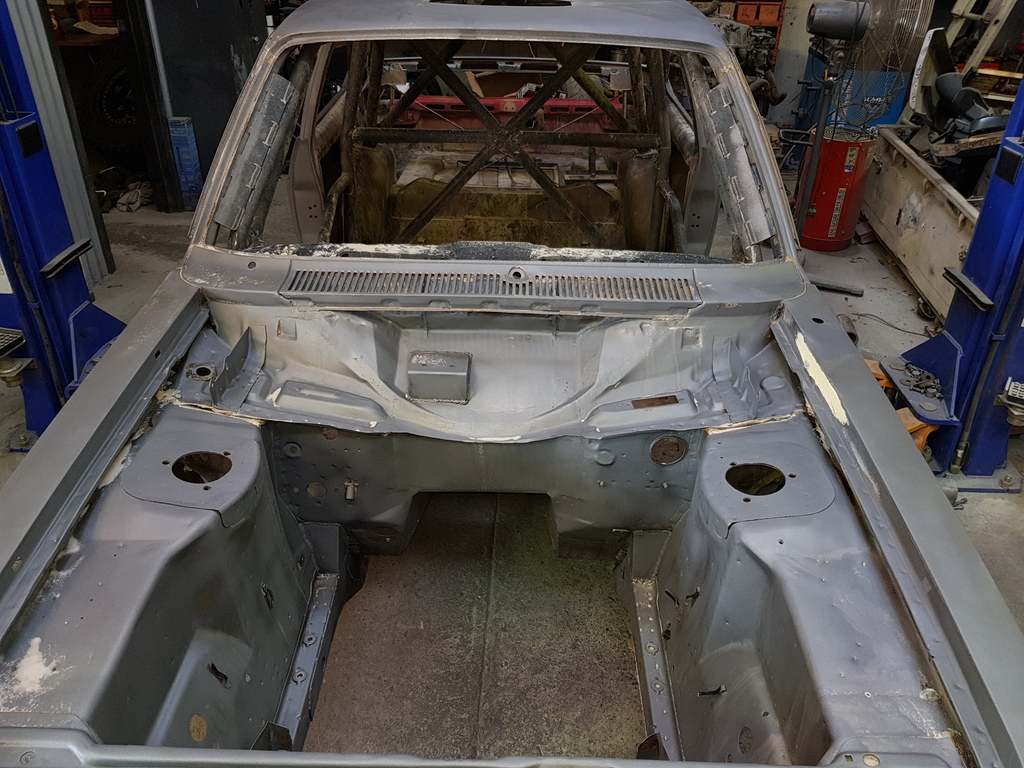

                              We'll be painting the engine bay tomorrow with top coat so will update again then
