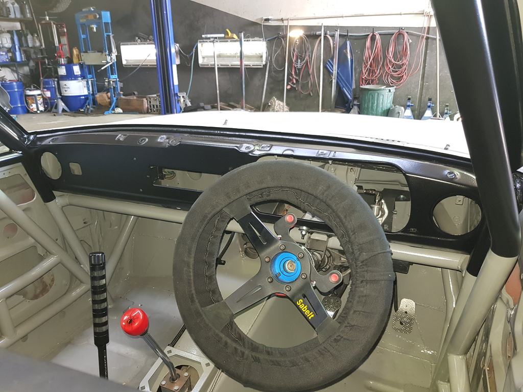

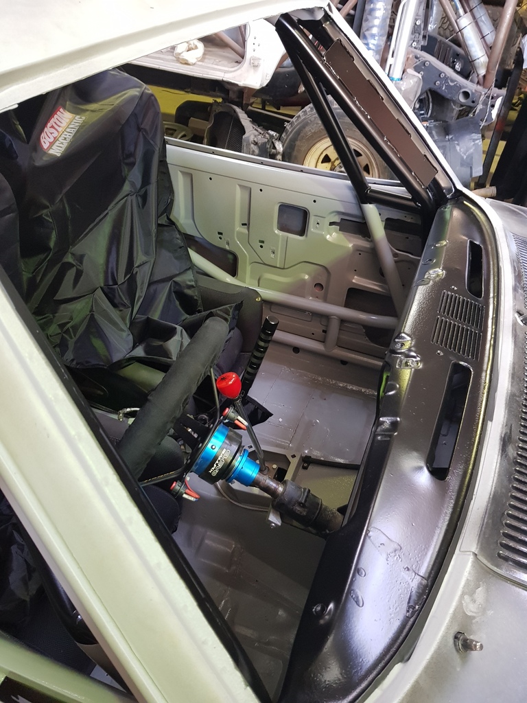

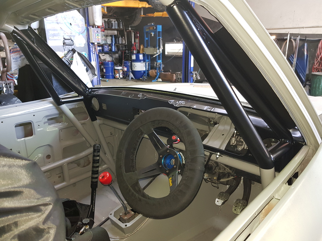

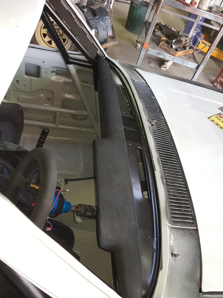

    Next up is to paint the front dash and also blend in the front of the cage to avoid the glare and also make it disappear when sitting in the drivers seat. You can;t believe the difference this makes

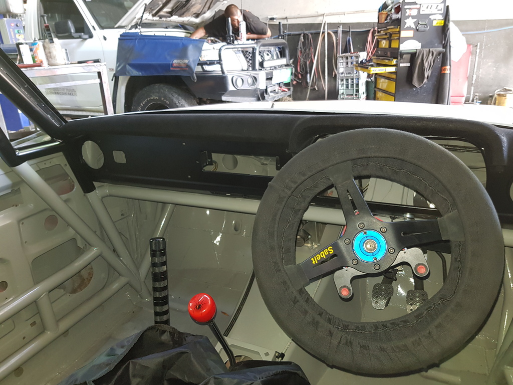

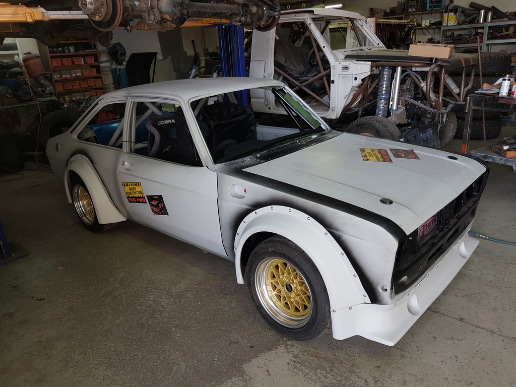

        Wheel alignment all done and wheels pointing the right way
        Flocked dash looks awesome too!!

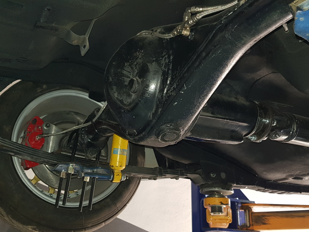

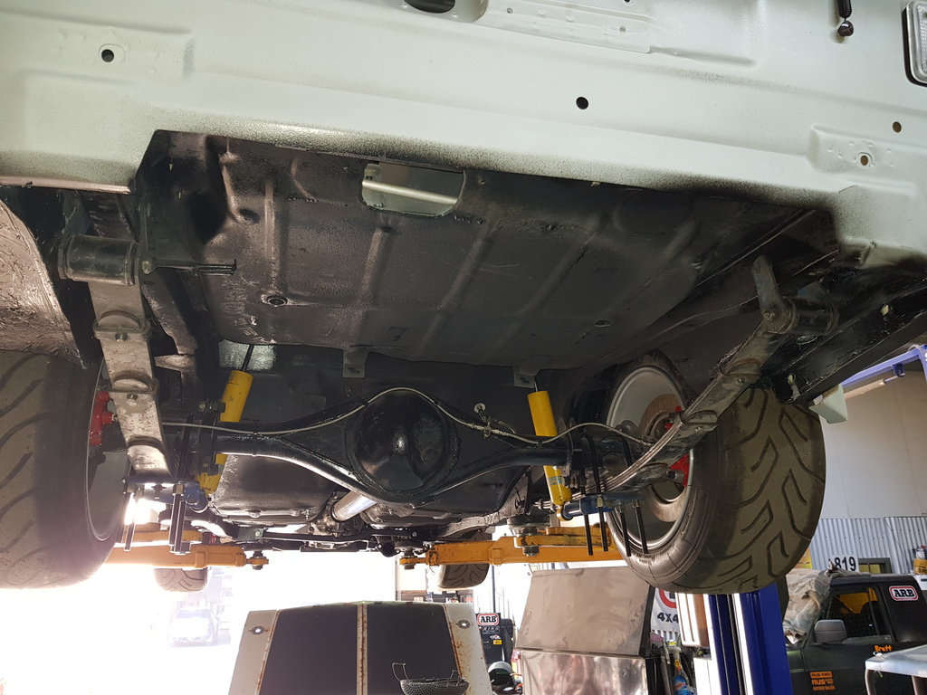

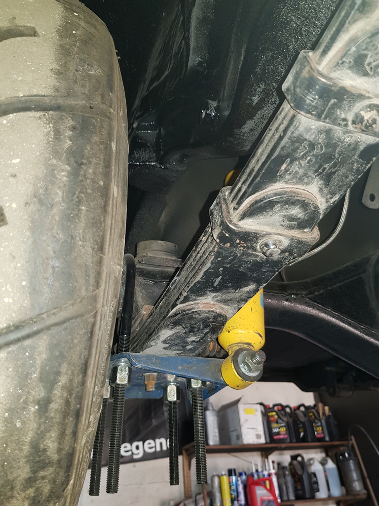

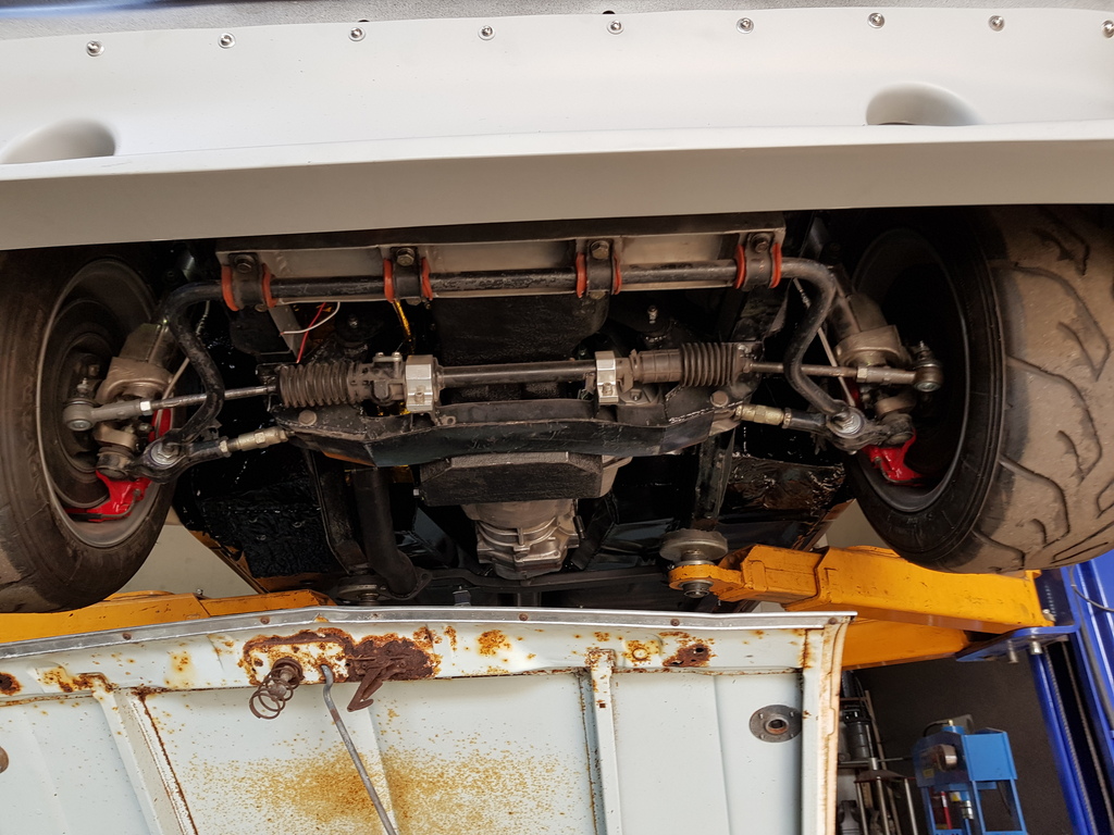

              Had the car upon the hoist so took a few pics

                Like your approach to the brake plumbing, I used banjo fittings and they are a pain.
                  I thought of using banjo's. I'm not sure why we went these to be honest
                  It ended up well though
                  Matt

                        Nice one...have you left the "u" bolts long to fine tune the ride height...looking almost ready for paint now...cant wait..
                        Cheers mark
                        • Matt75
                          • Mar 2011
                          • 797
                          Cheers mark
                          Little bit but mostly haven't got around to cutting them off

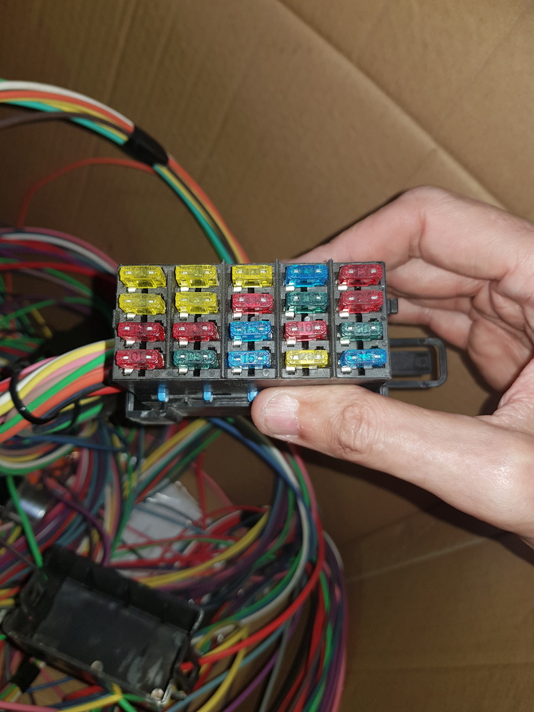

                                Been a bit slow of late bit still progressing

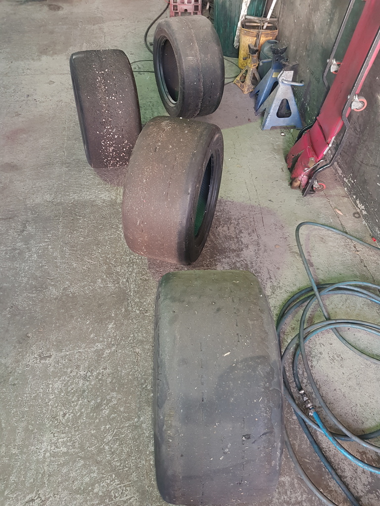

                                Picked up some 245/50R15 slicks for the fronts and I'll get some 275/50's for the rear

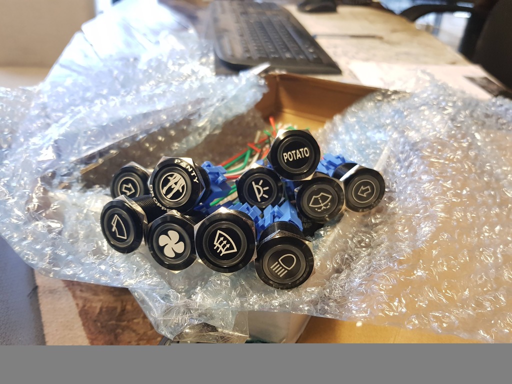

                                Next job is the wiring. I've got an EzyWire kit to hopefully make things easier

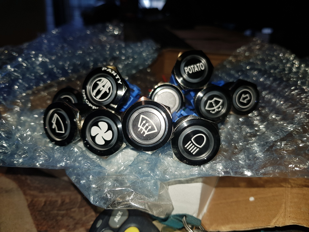

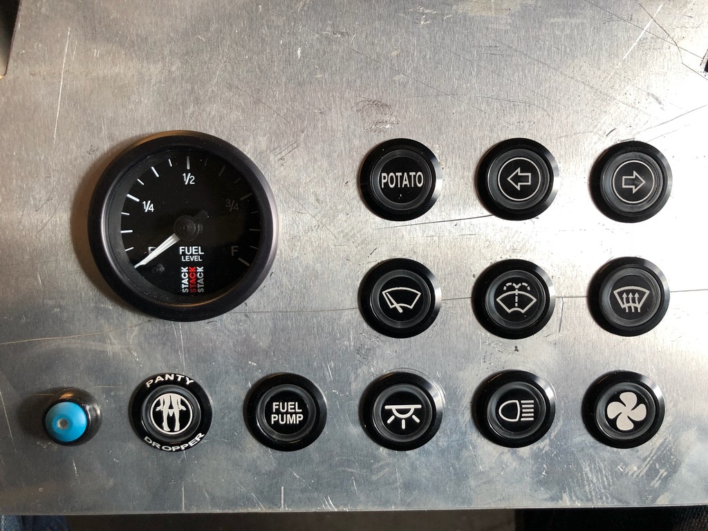

                                Got some billet switches made up. I've always wanted a potato button for some stupid reason so here it is. This will be the horn. The panty dropper will be the start button!!
                                Then we made a switch panel to mount this all on the dash board to the left of the steering wheel

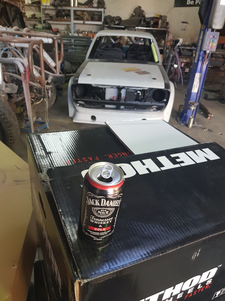

                                That's enough for now so a drink is in order!
