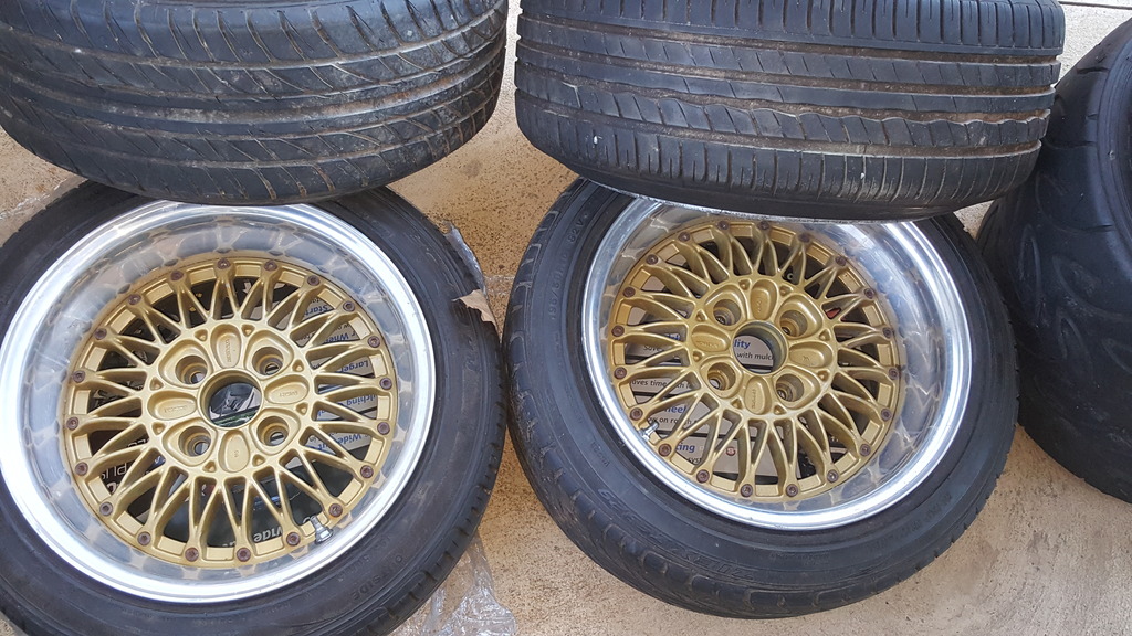

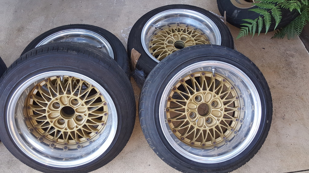

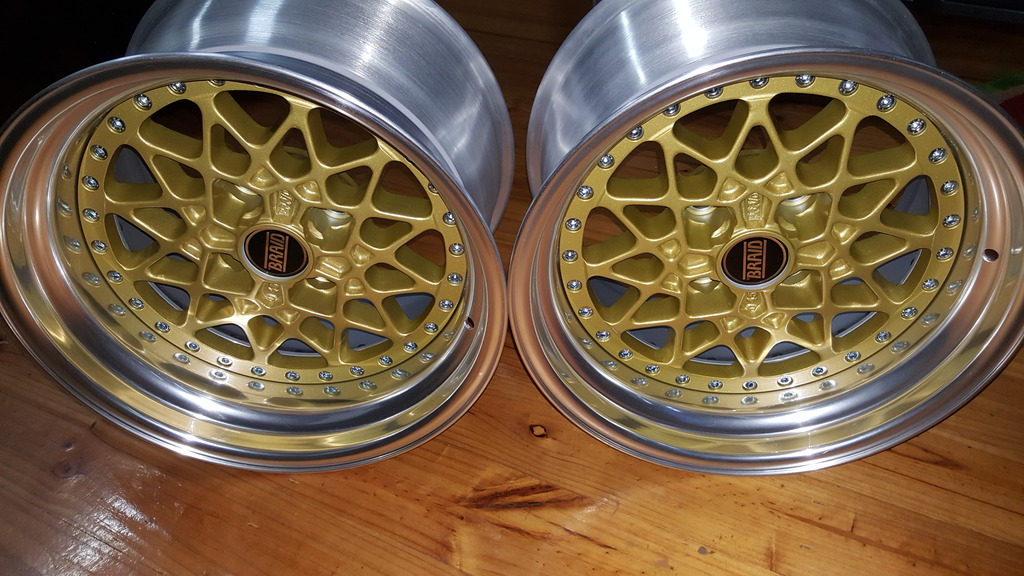

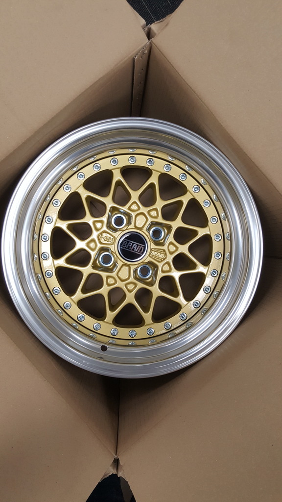

      #17

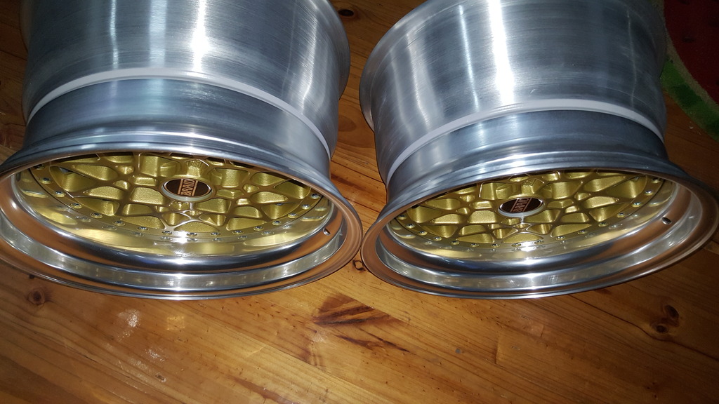

      The part hunting is still going strong. With the above tip, these turned up - 15x8.5 & 15x9.5 so big rubber required
      • Matt75
        • Mar 2011
        • 797
        #18

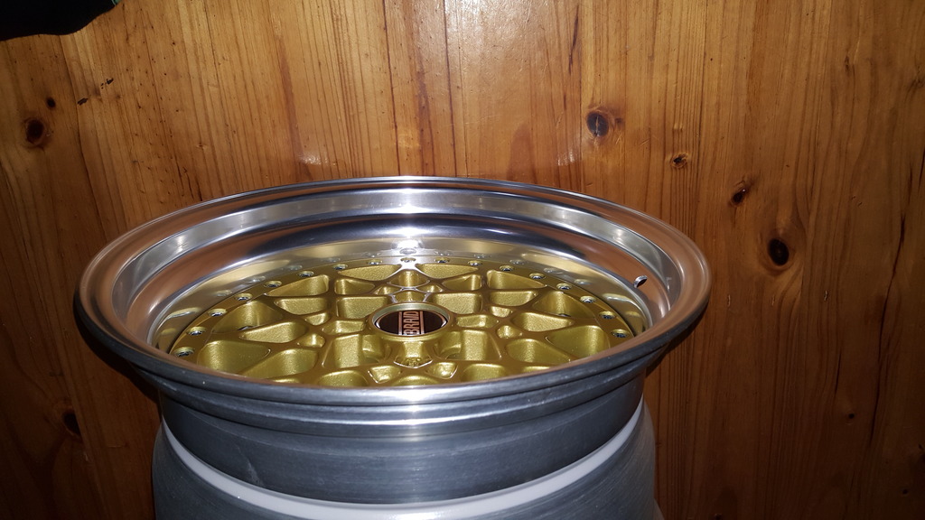

        And as I'd already ordered them these turned up too. 15 x 9 & 15x10 so will need even bigger rubber than those above

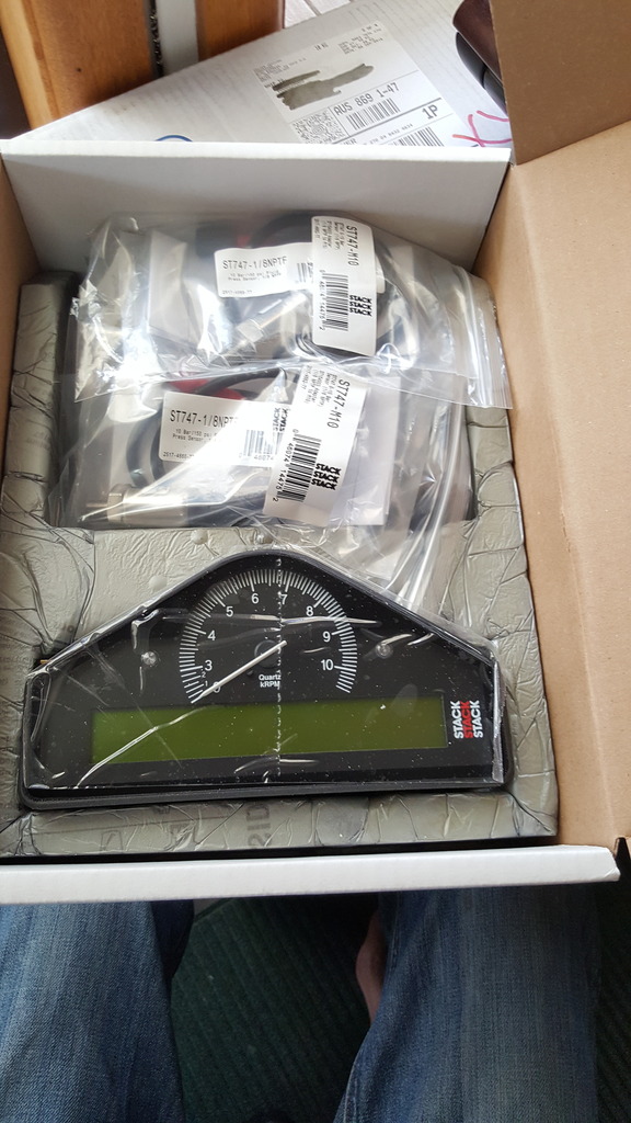

              #21

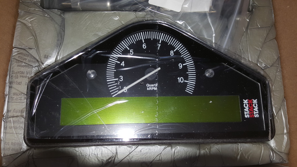

              Stack Dash turned up today too. It's awesome bit of kit

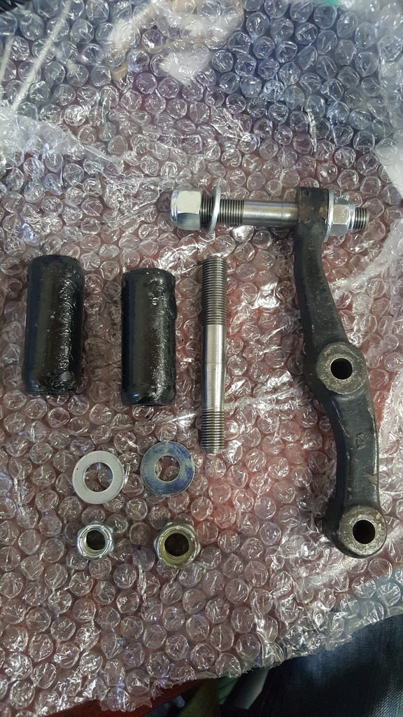

                  #23

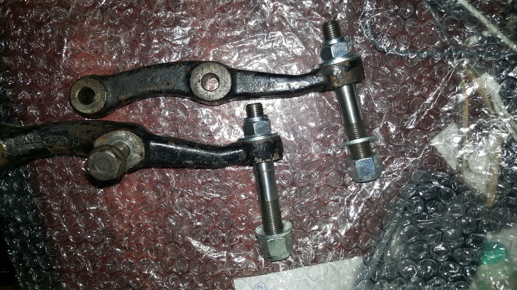

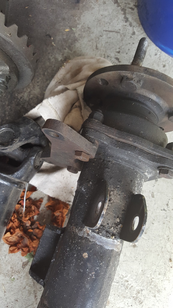

                  Got some front end stuff today. I'm going to go to rod ends instead of tie rods so had these pins made up so i can adjust for bump steer. The black dealies are the adapters for the steering arm (M14) to the rod end 1/2").

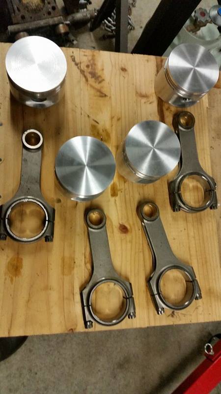

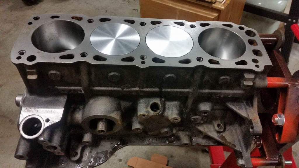

                    #24

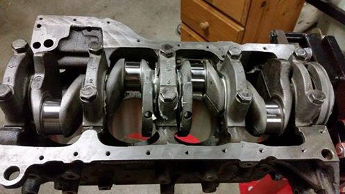

                    Bottom end complete

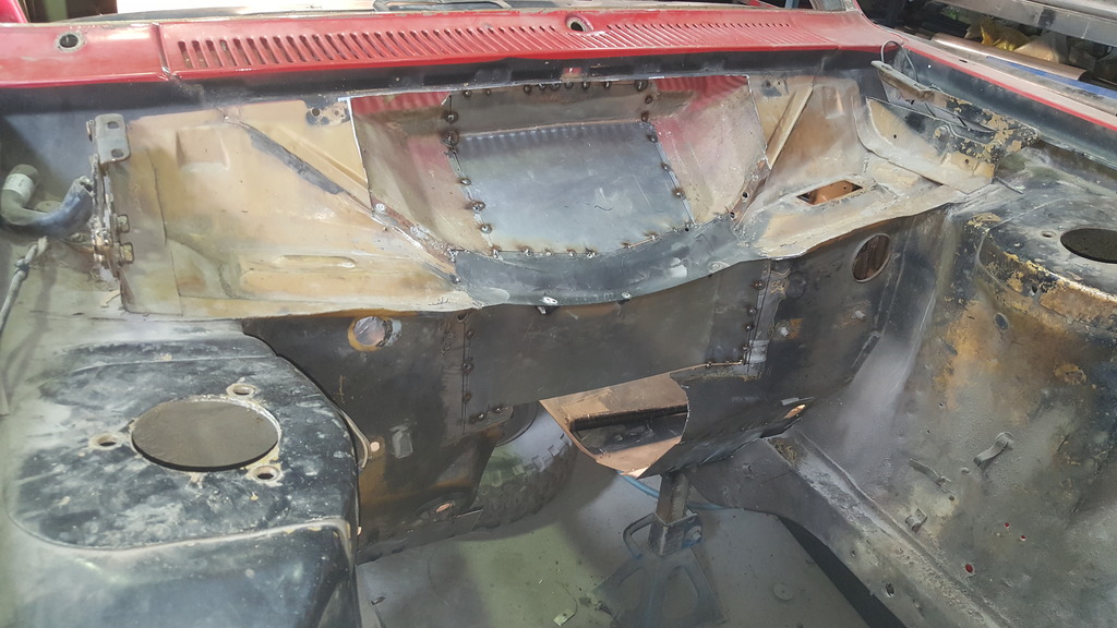

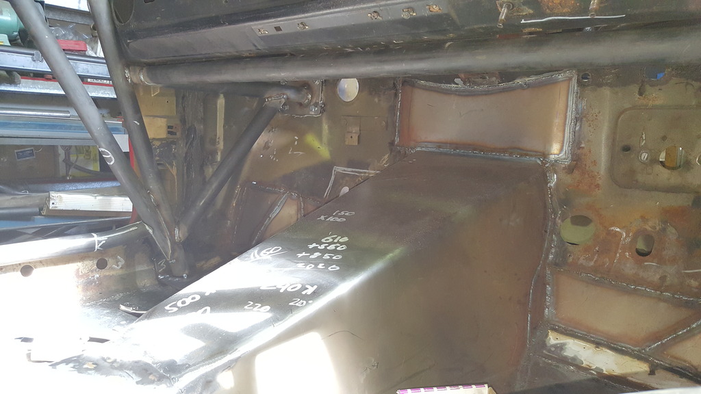

                      #25

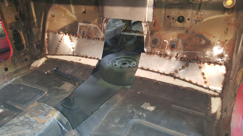

                      Back to the shell
                      • Matt75
                        • Mar 2011
                        • 797

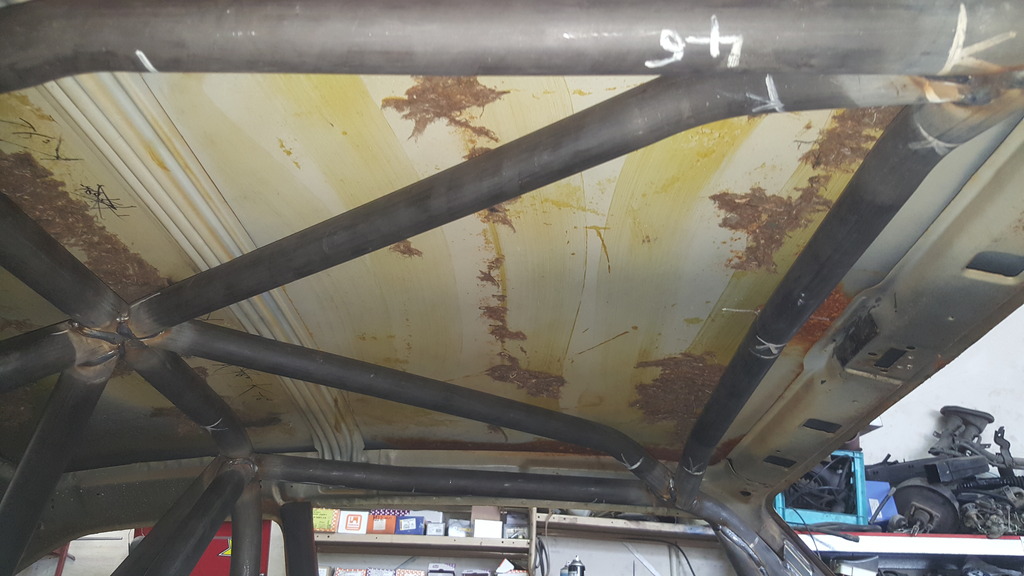

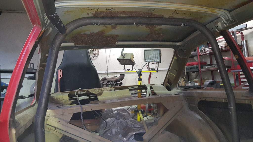

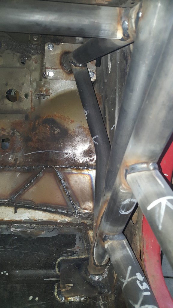

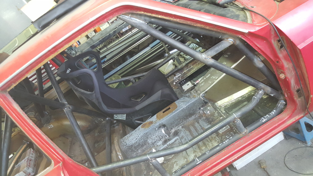

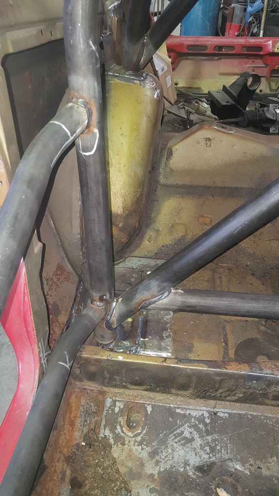

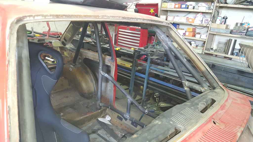

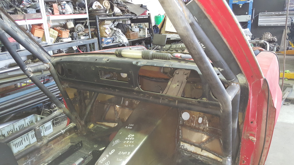

                        #26

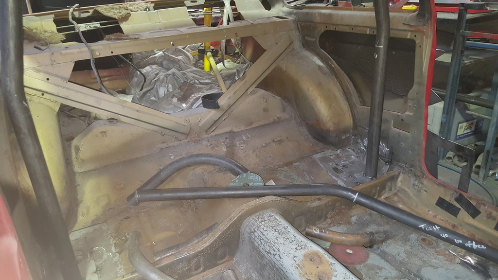

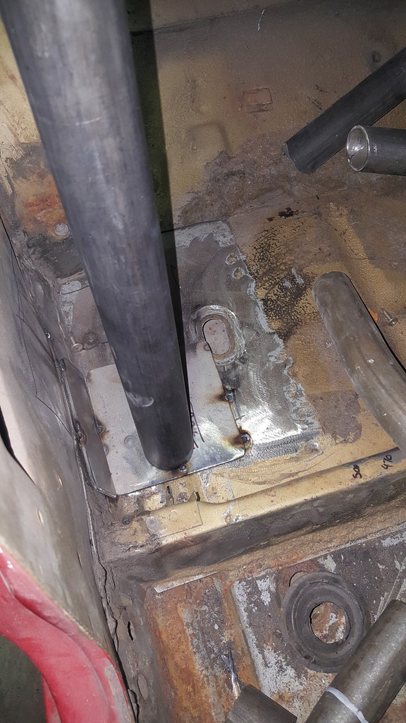

                        Starting on the Roll Cage
                        • Matt75
                          • Mar 2011
                          • 797

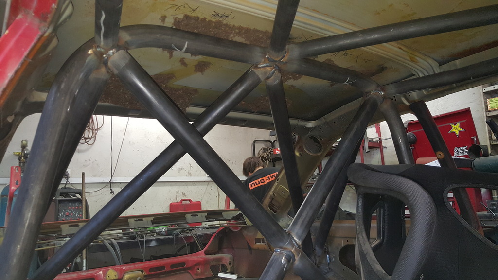

                          #27
                          More pipe...

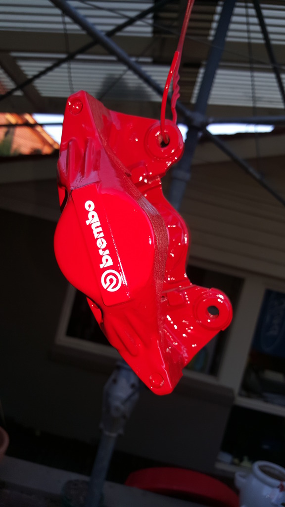

                            #28
                            Few more bits and pieces

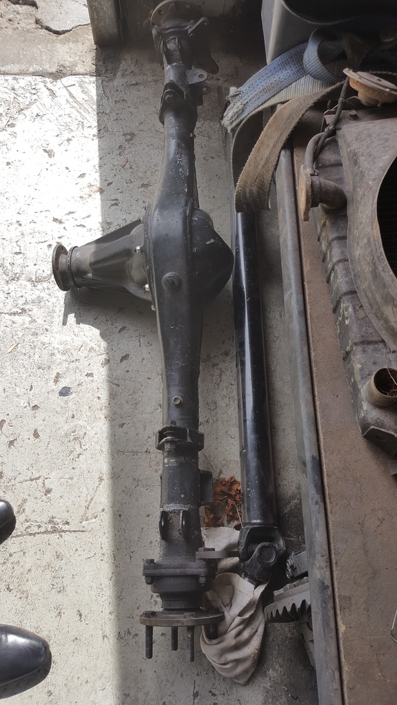

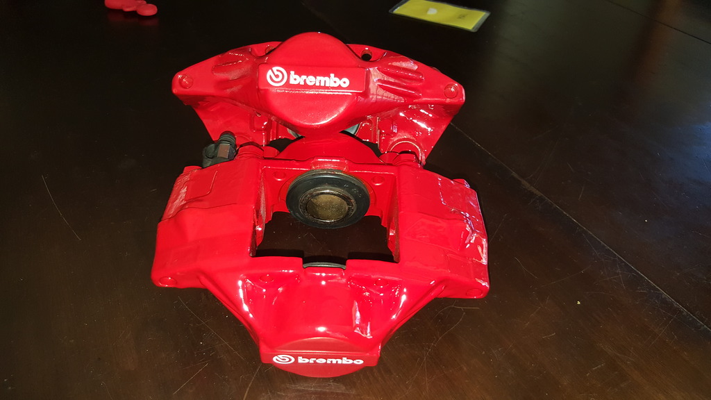

                            Hilux diff with 5.3 LSD!! May be too low but we'll see for now.
                            I'm running Brembo rears to match the fronts so just gave them a paint and new stickers
                            Matt

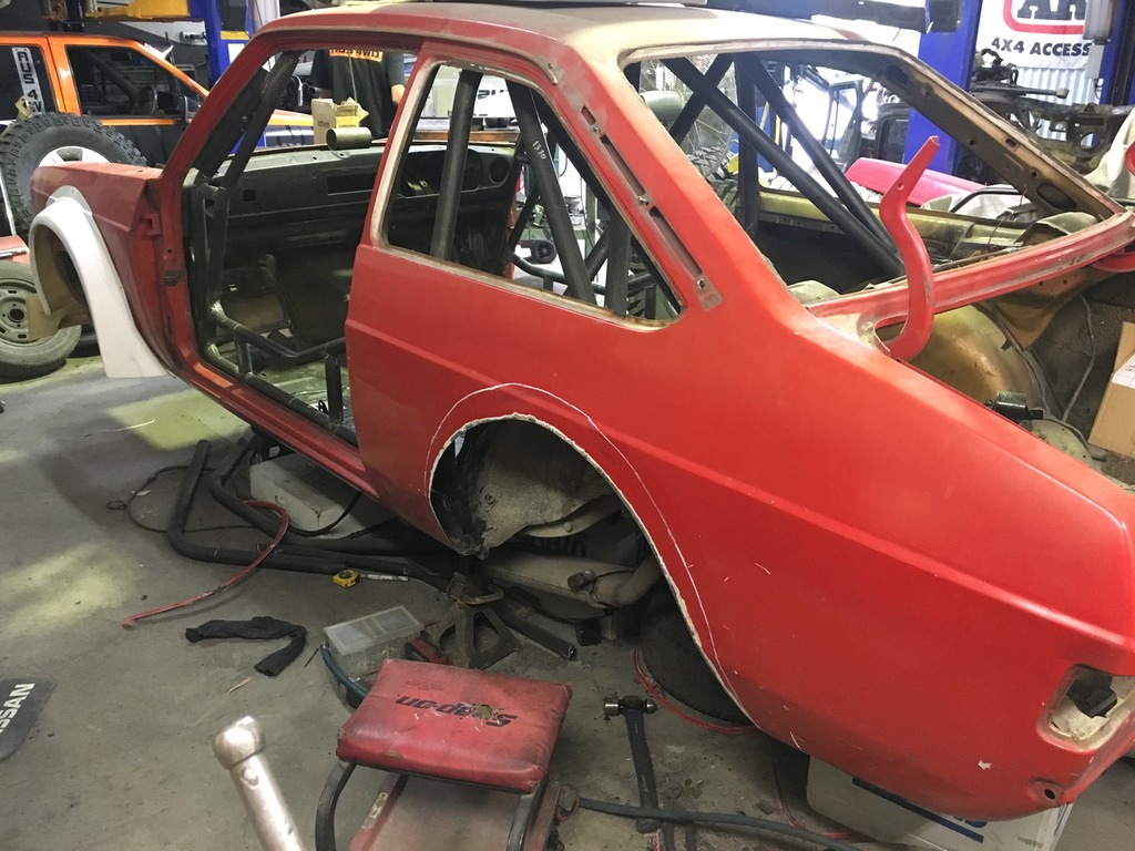

                              #29

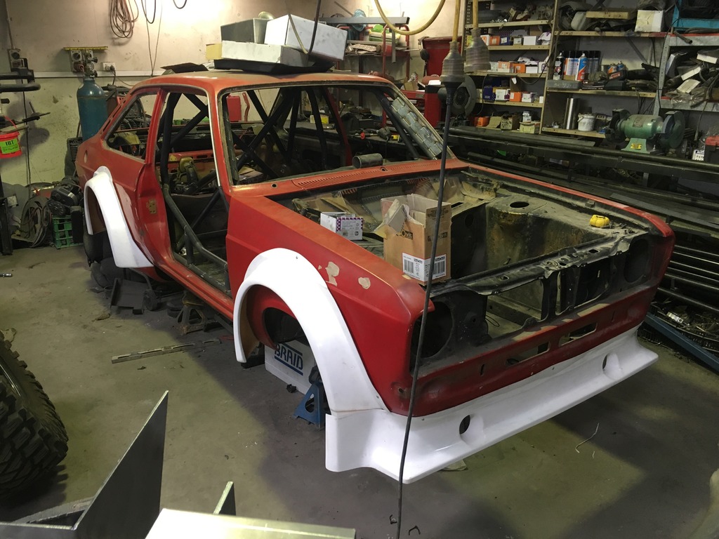

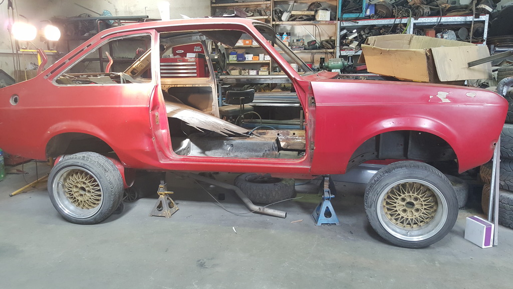

                              Few pics of the arches screwed on.
                              To say I'm excited is an understatement
                              • Matt75
                                • Mar 2011
                                • 797
                                #30
