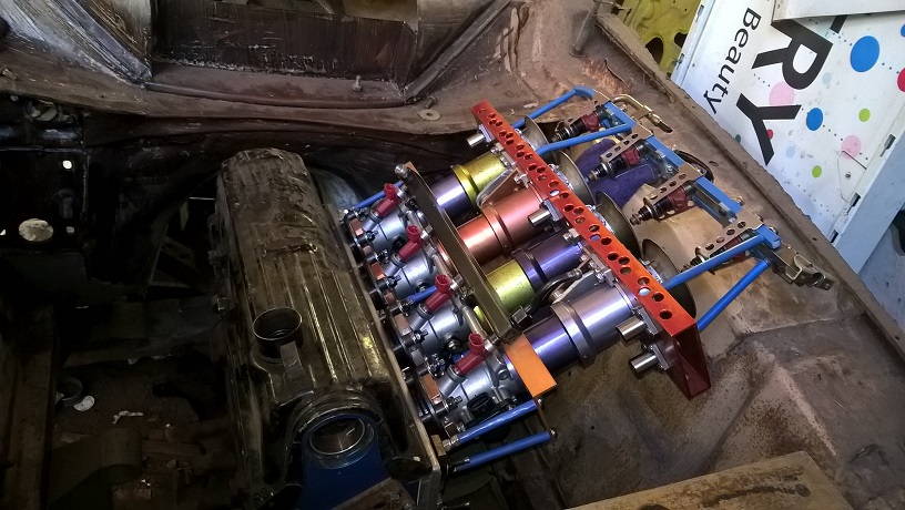

        Very nice...all coming together nicely..i have a problem with the strutt brace..there is no room to fix on the passenger side strut top because the velocity stacks from the engine are in the way...so been looking at alternatives ...may be come lower then up...

            cheers matt ..heres the problem... i could come forward and i could go lower to bulkhead..????
            not a lot of room...ive already cut the bulkhead to clear the throttle bodies...

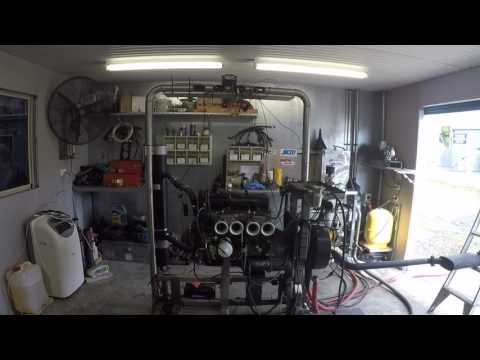

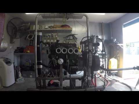

                      Exciting day with a disappointing end
                      Got the engine on the dyno and did the run in with everything going great.
                      The engine then hit a hole around 6,500 and power dropped off massively and we couldn't work it out. We tried engine timing, jetting changes, cam timing, new exhaust system even but nothing made an differences with different results happening on each run.
                      In the end it refused to start and after lots of head scratching the culprit ended up being the hall effect sensor in the dizzy so we packed up and hopefully we can get it sorted out on Tuesday.
                      We got 180hp out of it so far so that's a good start but there should be a bit more in it hopefully
                      Here's a few vids of the running in and then a power run. It reckon is sounds great
                      Matt
                      Running it in
                      Power run
